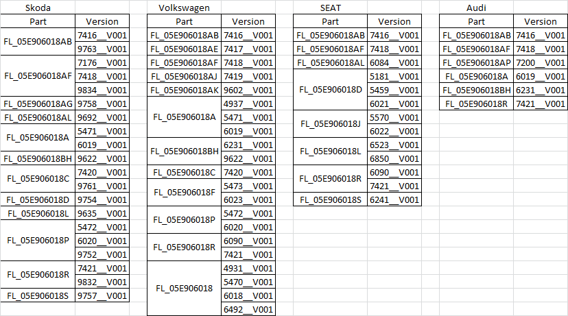

List of updates available for DADA and DACA 1.5 TSI Engines,
in Karoq used ECUs 05E906018 ending P or R or S or AT, same as for VW T-Roc and Seat Ateca (no data guarantee :cool: )

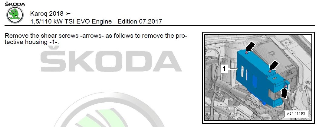

Can you please tell me where to find the ECU number on my Skoda Karoq? The number I have found doesn't seem to correspond to any listed. Thanks
Engine ECU is mounted at engine bay, unfortunately under protective cover with non removable shear bolts, so you can not see the numbers printed on its label.
So the only easy way how to find out what ECU you have there is to use the diagnostics as even VAG ETKA catalogue can give wrong results...

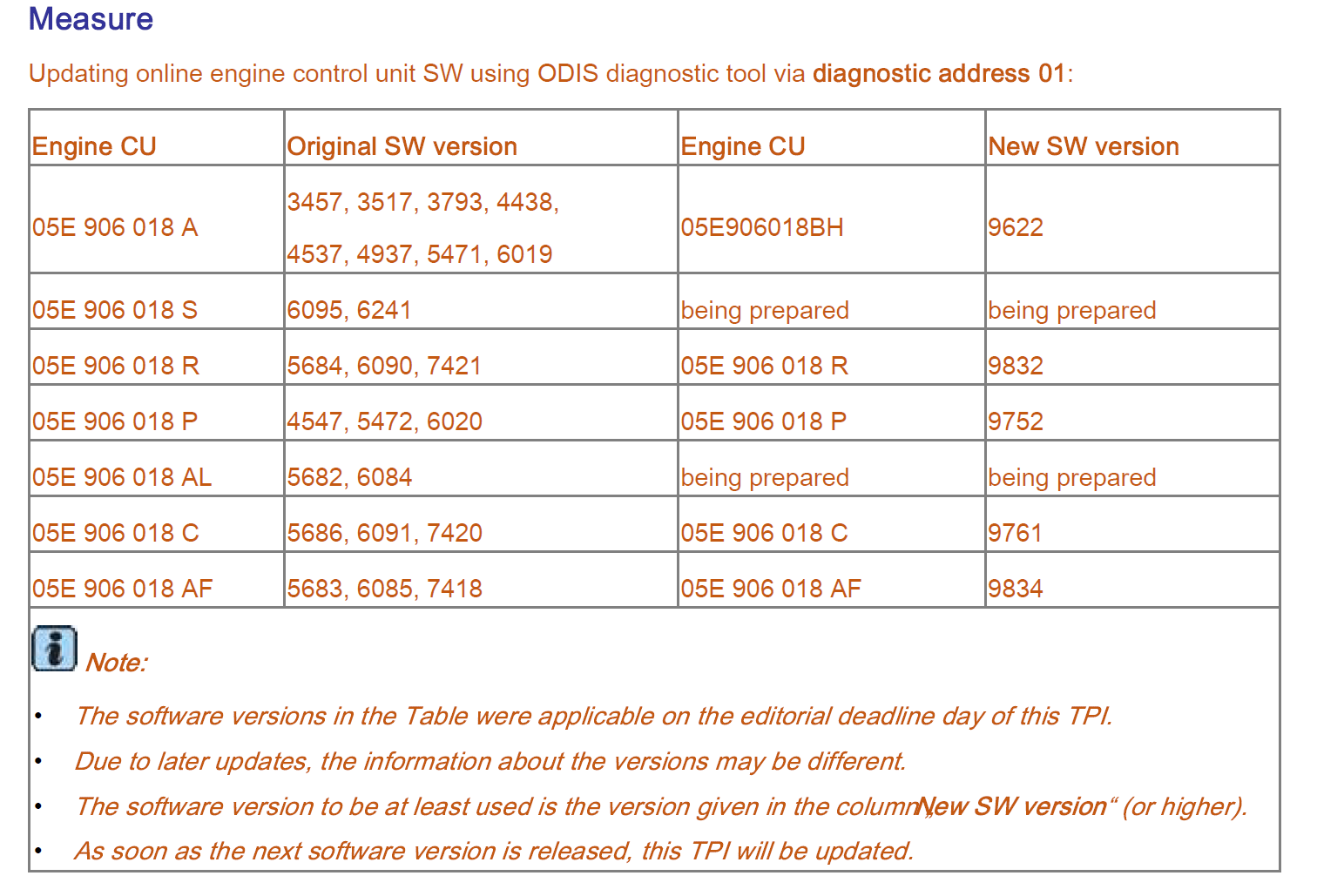

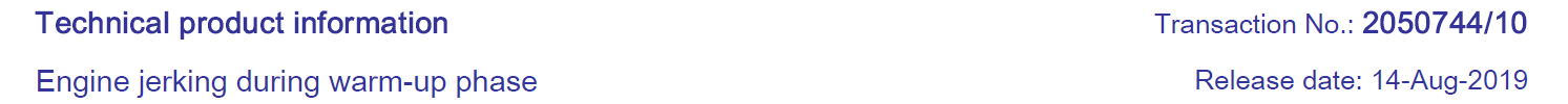

Just had a look at the relevant technical service bulletin for my MY18 Octavia on erWin.  The key bits are here:
So, looks like kifir's update was the correct one for MY18.  As rayx suggested, CO version changes from A to BH.

Just talked with my service guy and showed him this TPI.
I have MY2017 A3 Stronic, ECU #05E 906 018 A, but he told me he needs a code named 'SVM' indicated in TPI as it is needed for my Audi engine to be updated. I was told, he has to enter this SVM code in order to get the updated software from the system. He says he cannot see any bulletin related with my engine while checking it regularly.
Any idea what that SVM code could be or where can I find it?

@Paul  Yes, erWIn is paid access only (€7+VAT for 1 hour).  Can't quote the exact wording (my 1 hour has expired) but a node called something like "What's New" in the maintenance section.
@dnzbdr Sorry, not familiar with the SVM term.  I did a quick search of my PDF of the TPI and see no mention of it.
@rayx saw 'A' on your first excel sheet, thought I was going to be happy at last. False alarm then 😞
The xls list only show complete overview of data files which are released for each brand. Does not mean all are the latest ones, so you can notice, some ECU have more then one SW version available, other just one, usually the latest one but it could be too the same what is already applied in the car on the production line few months ago.
What is currious, same ECUs used abroad the VAG brands, but currently Skoda seems to be the first one to test all the healing updates ...
