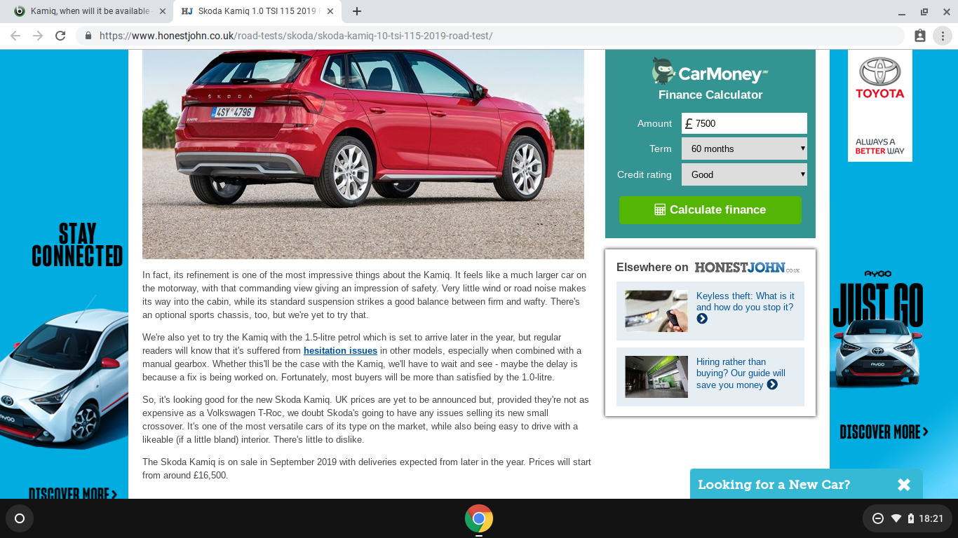

Honest John journalist while road testing a Skoda Kamiq is prepared to go where other Motoring Journalists might be scares to tread.
Questioning if New 1.5 TSI's for 2020 might have the issues that models before might have.
