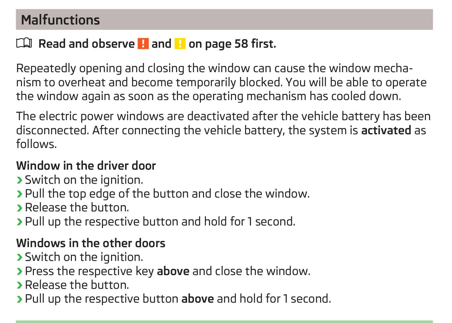

There might be a reset function, where you hold the button down for a few seconds after the window reaches the bottom and then the top. Well, there was on the Alfa.
Somebody who knows will come along...  :biggrin:
The switch on my driver’s door for the driver’s window does seem to be a bit hit or miss.
Had a few Passats in the past, and they were much more positive.
To reset lower and then raise the window, once closed hold switch up and that should reset the one touch function.

Just been out and tried the below procedure and they seem to be working again now so will have to monitor!
still hasn’t got rid of the 01555 code though.

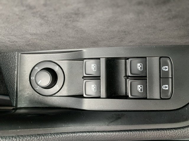

That’s not the right switch unit for mine as it has the mirror adjuster and both rear child lock buttons instead of a single one to disable the rear window buttons
C63CCF4D-E335-4C77-90CF-055895209F8D.jpegIf anyone can find this one part number I’d like to know anyway!
Edited by SkudMissile21
