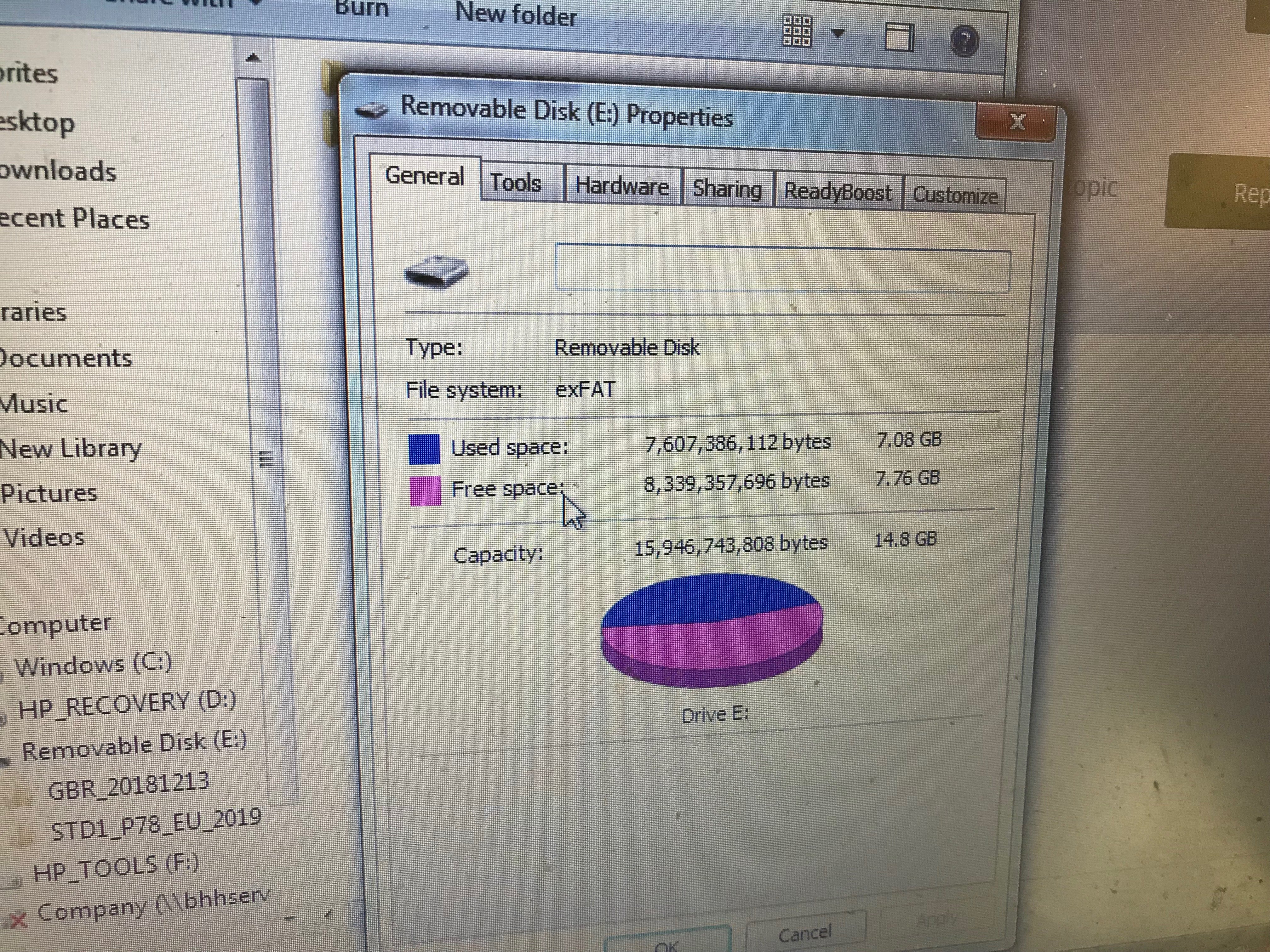

Interesting, my next question is the image below shows the 2 unzipped files using 7.08 GB on this SD card. What about next year, or the following years' updates. Not a lot of room left for these on an 8.0 GB SD  card, or are Skoda expecting me to fork out for a new SD card each time the capacity is too small?
You need a card with part number 5E0 051 236 for your unit. The letter which follows will dictate the maps version the card came with, but shouldn't be relevant as you're going to overwrite the maps anyway.
What is the cluster size on that SD card?
Mine originally used 16KB clusters and the 2017 maps wouldn't fit, so I reformatted it to use 4KB clusters and even the 2019 maps fit with space to spare.
