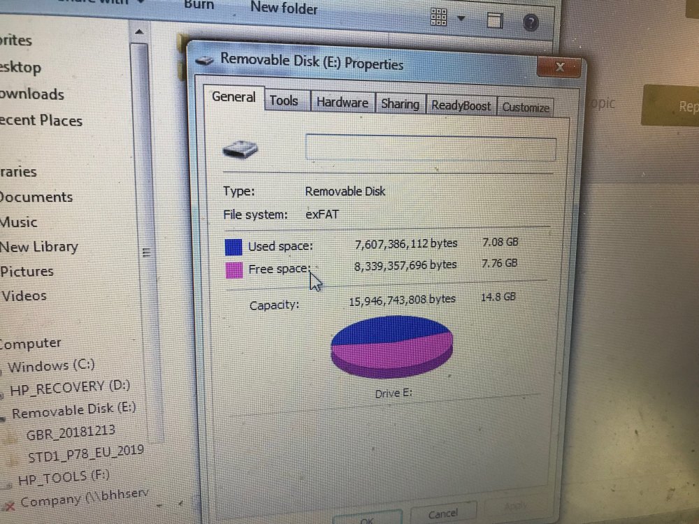

Can someone confirm my SIM is the right one to update my Sat Nav system for my Skoda MK3 (64 plate) Elegance? I bought the SD card from my Skoda Camberley service centre. The reason I ask is the front label refers to various Skoda vehicles, as well as Octavia (5E) Part/Order number 5L0 051 236C.
The reason I ask is I can't get the downloaded sat nav update to upload to car.
Downloaded the map and radio icon zip files to lap top, extracted files to another folder, transferred from this folder the unzipped files to my SIM, but not recognised by vehicle. I have formatted the sim started with default FAT 32, then NTFS and even Ex FAT. I am at a loss, hence my query ref. SIM?

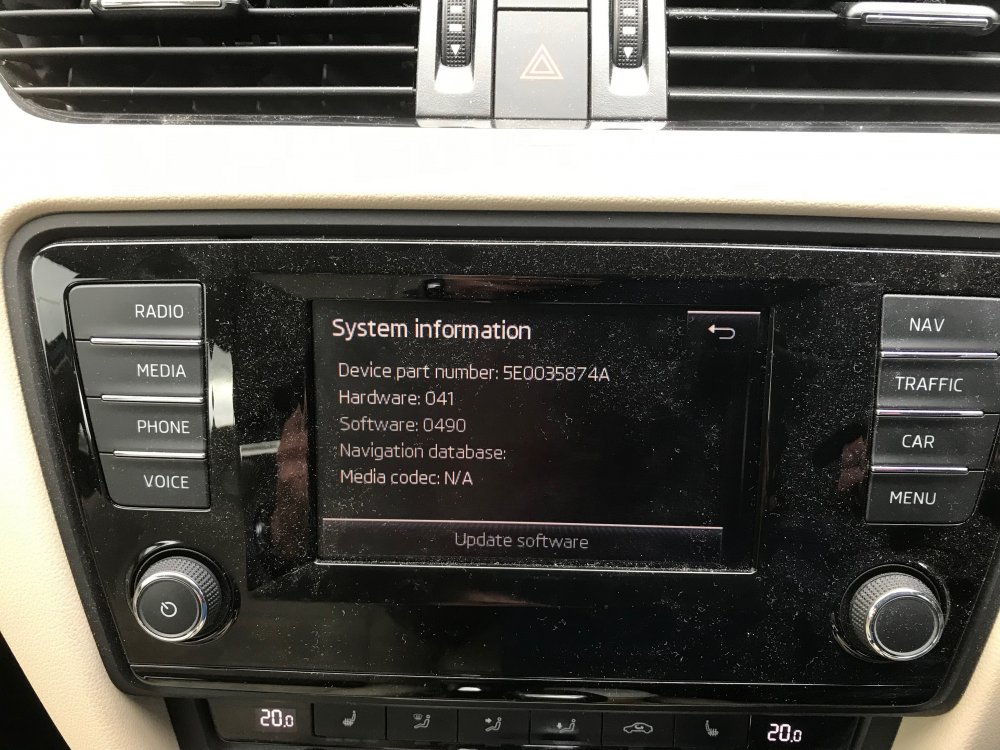

Next, what system do you have? Some versions need an SD card inserted to work and others can use any media to upload it once
Amundsen I think, Glove box has a CD slot and SD 1 + 2 slots...
Do you have access to the version information screen where it lists the part numbers etc. If so take a pic of it
I *think* that 5L0 051 236 C part number is a 16GB card for an MIB2 Amundsen unit.
I'm pretty sure your 64-plate model will require an 8GB card for a MIB1 Amundsen unit.
If the SD card is 16GB in size, it's likely the wrong one.
