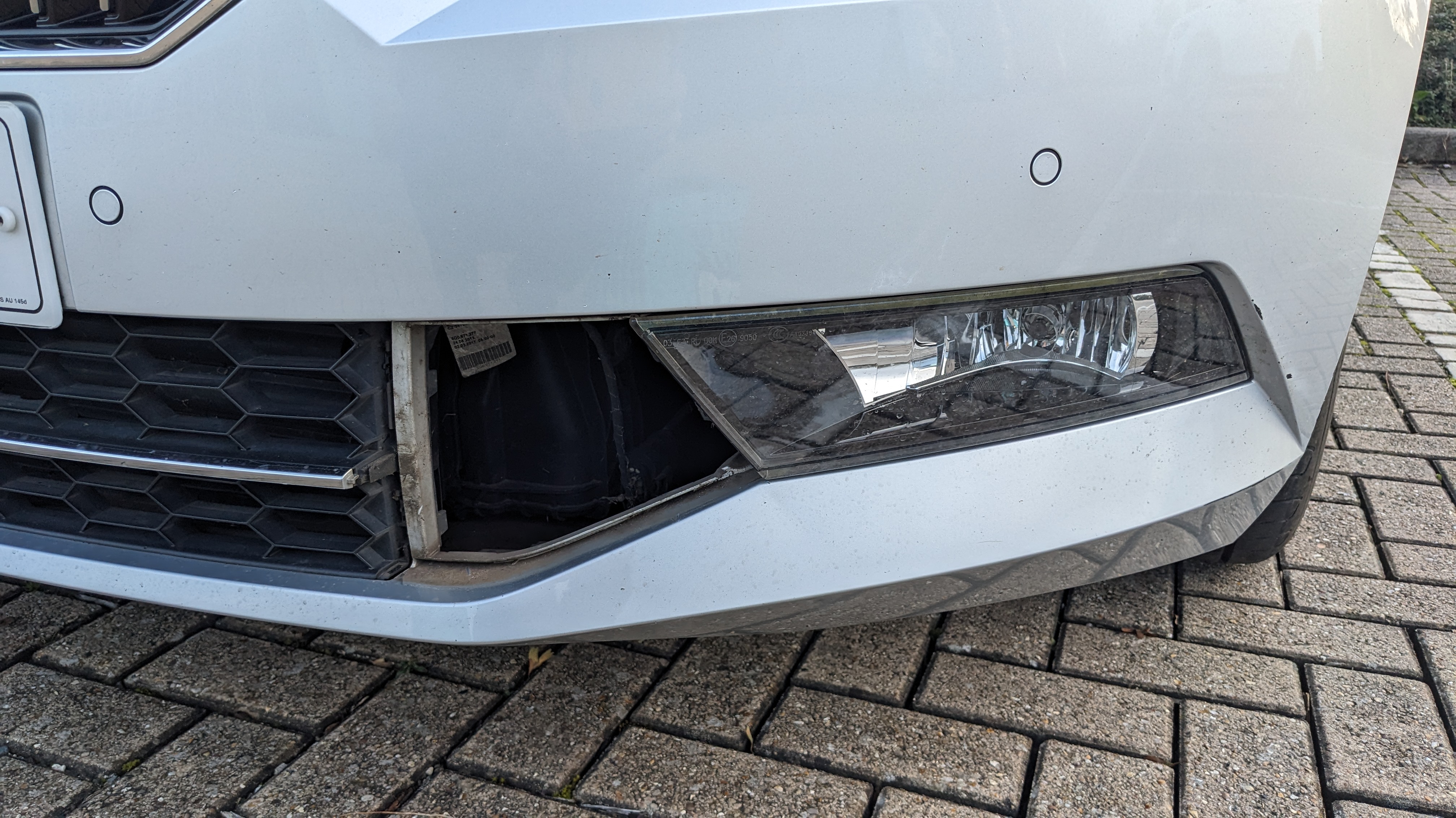

Hit a pheasant at 70mph causing one of the small lower grilles to eject 🤬
Any suggestions for its replacement? I see aftermarket ones for around £30 but are they any good?PXL_20231029_155827354.thumb.jpg.ce2de15bcf49ed5606e8e4194013788c.jpg
@D402 - u can get genuine replacements from Kopacek, however don't forget to order the chrome piece too as it is a separate part.
The sell for approx. 13 to 20 euro each grille piece, plus 40 euro for the chrome piece.
Yeah, ridiculous about the tiny thin piece of chrome costing so much!!!
There r two versions, one for the normal non-AWD, and one for AWD version, which requires additional cooling, hence more holes.
- 3V08536669B9 - left grille (without holes)
- 3V0853665A9B9 - left grille (with holes)
@JR RSThat's brilliant, thank you. I'm lucky the centre chrome strip survived, €107!

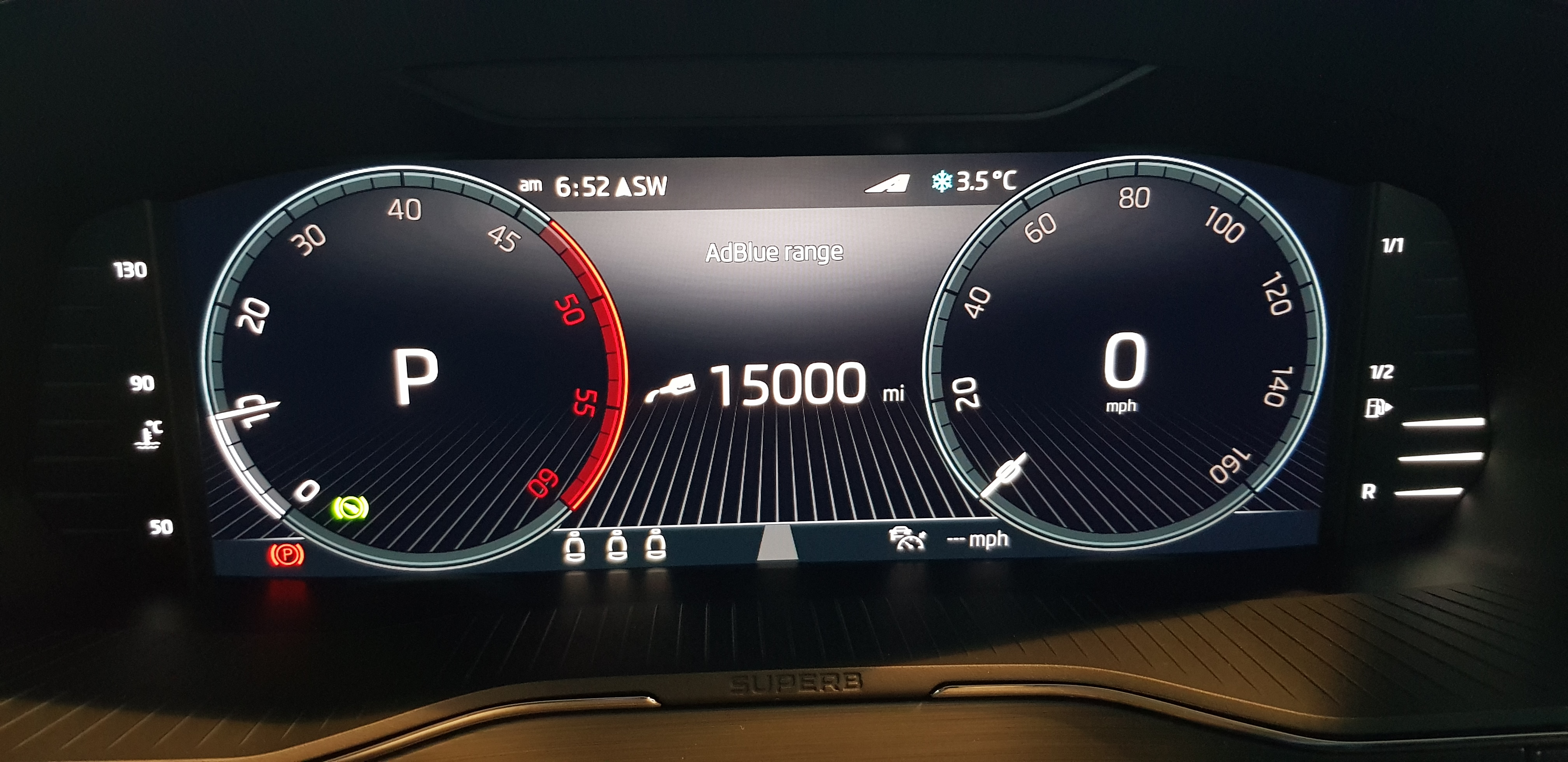

Filled the Adblue tank for the second time today, that should take it up to 60k. It was full when I picked it from new and showing a range of 15,000 miles. It appears to be calibrated for a maximum display range of 15k miles but in reality it lasts for 20k each refill. Car was one year old earlier this month and just coming up to 40k.

I have the 150 TDI EVO engine with DSG7.

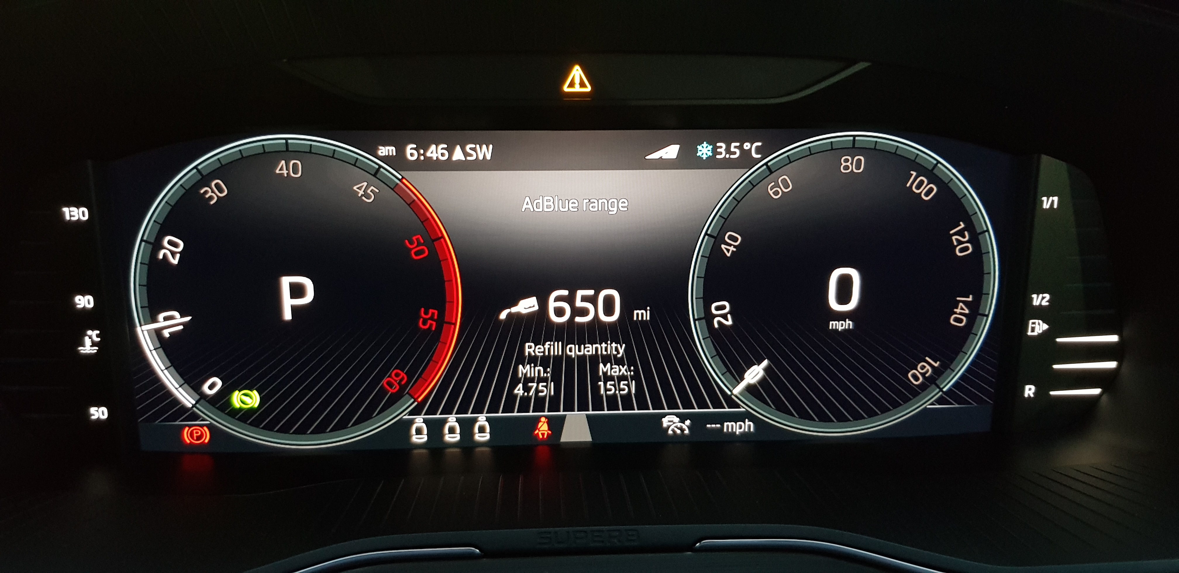

The display shows how much Adblue (or DEF) you can/should put in, the car display suggests 15.5 litres:
I know TDI150 is like a camel but 15,5l for 15000miles seems really low. Great performance! Happy for you.
My average AdBlue consumption is 0.12l/100km over 100000km. TDI190 (+dead weight due to Haldex system) is a bit greedier, espacially if one has lead sole with gas pedal… 😂

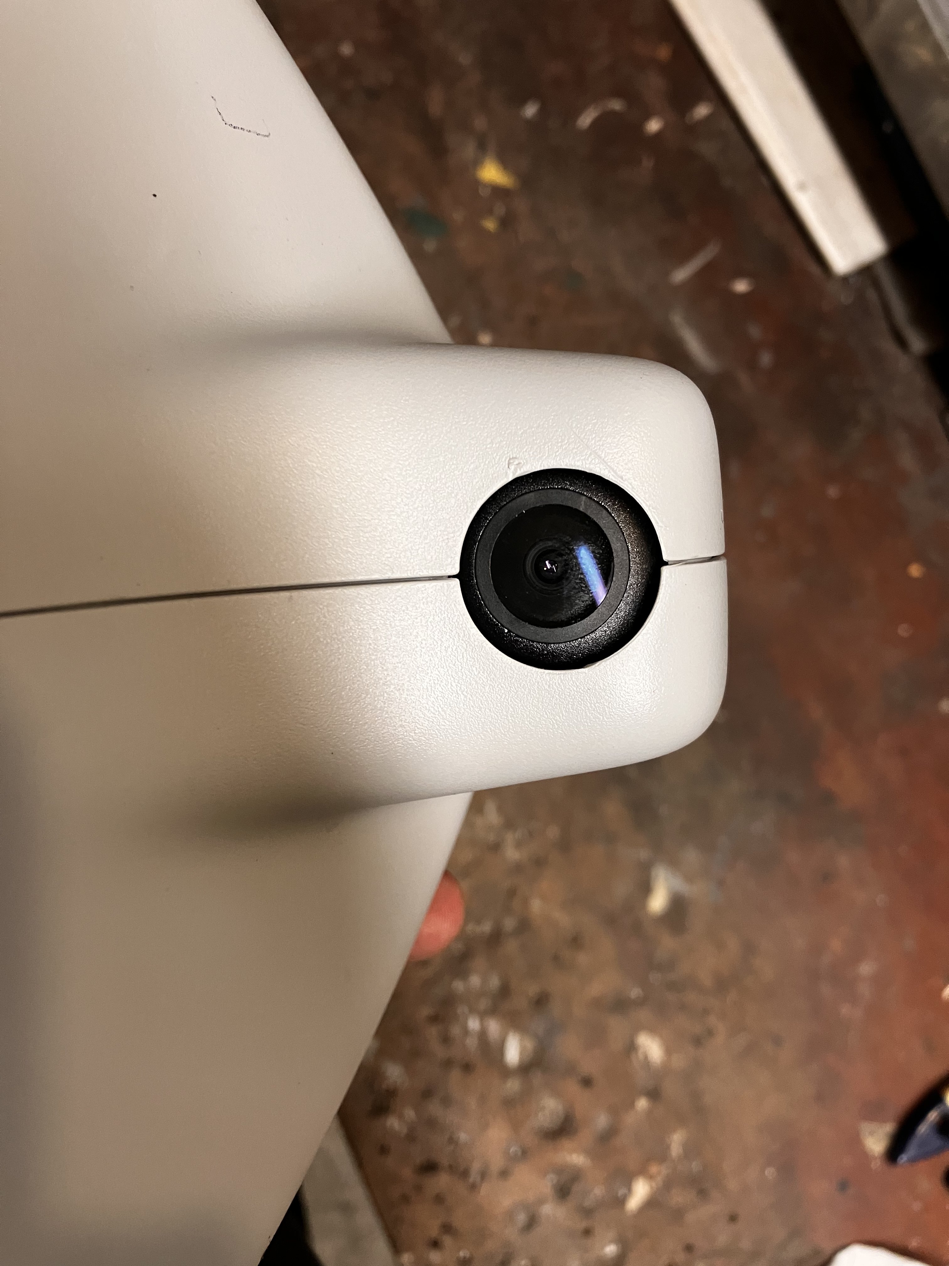

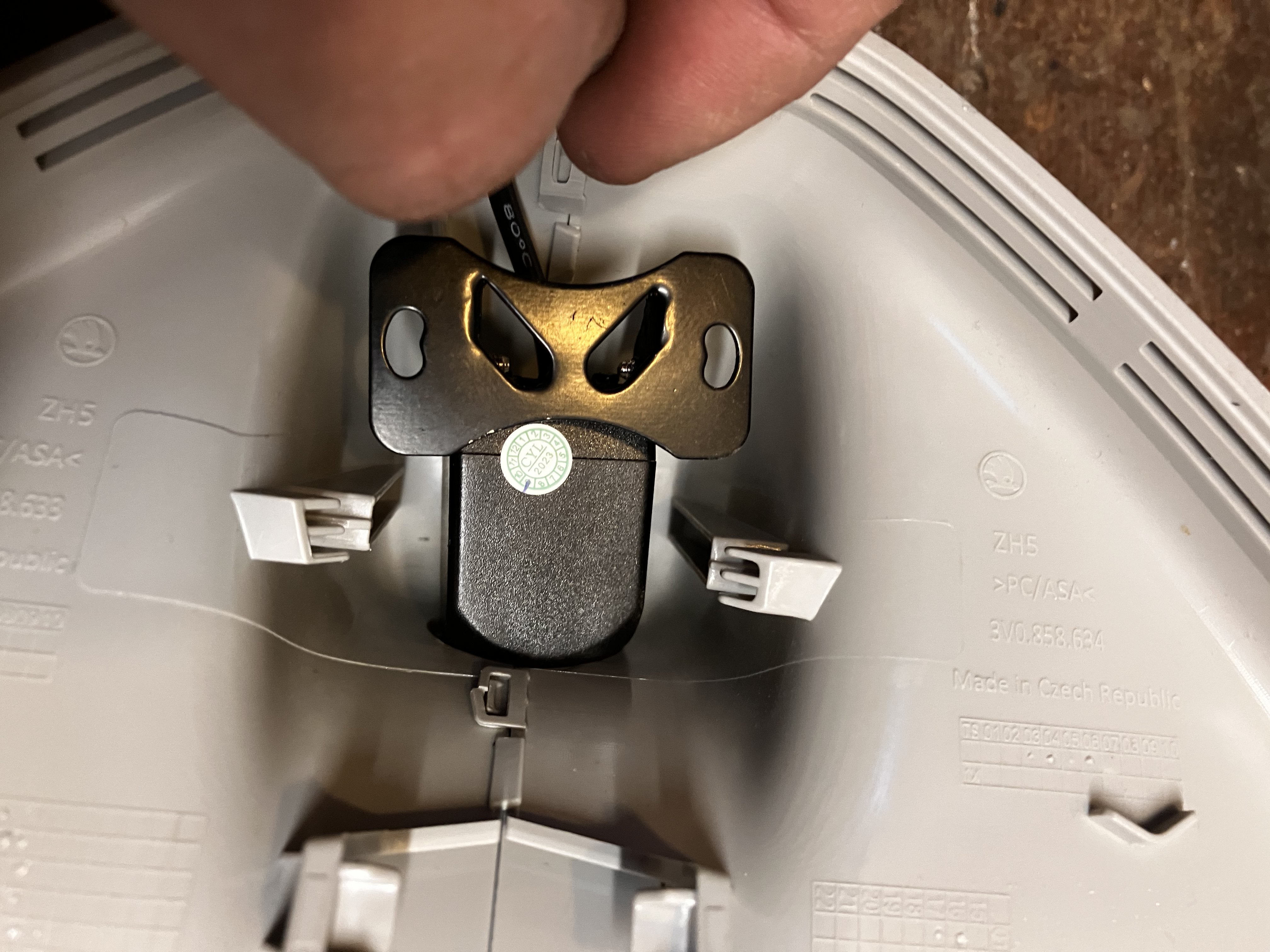

In the next days, I plan to order black inner rearview mirror housings to make a housing for the rear camera so that it looks OEM. I had a quick look with my original parts. It seems feasible. The hole for the rearview mirror has nearly the same size as the camera lens.
