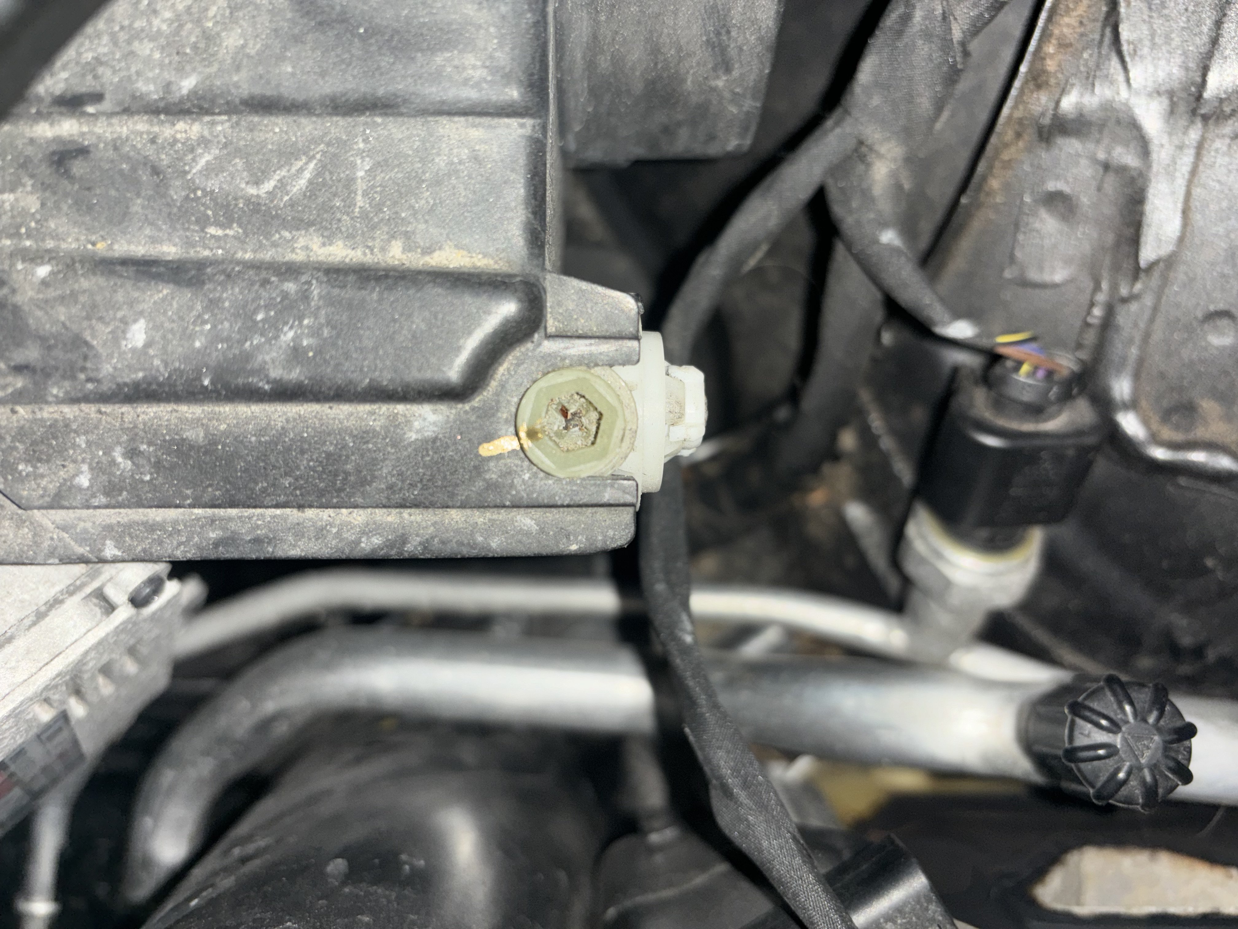

Tomorrow i'm hoping to do half a turn adjustment on each headlight as it's still far too bloody low, i'll do it without maths and hopefully it wont blind people, if it does i'll turn it back a quarter turn and see how it goes.
What I plan on doing is getting a marker so I can draw a line at the top of the screw and on the screw itself, that way I have a reference point as to where current settings are and can easily go back.  I just need to find something thin and permenant, something like a yellow pen will do as long as it's visible on white and black plastic

Also I just adjusted my headlights 1 full turn and seems a bit better
Note to self and for anyone else
Turn screw ANTICLOCKWISE to HIGHER
Turn screw CLOCKWISE to LOWER
Weird that clockwise isn’t higher but there you go 😩
What I done to mark it’s original position was mark it with a gold permanent pen, on the black plastic and on the screw itself (btw what size is the screw nothing would fit so used a philips screwdriver which wasn’t great)
If I find it’s too high I can turn it clockwise half a turn, then if it fails MOT turn it another 180degrees clockwise to original value
Edited by Danoid

Just make sure your car is unloaded and preferably on level ground too, otherwise you'll have a wonky beam that doesn't align. It's good if you can mark on a wall where the beam should be.

It isn't a screwdriver you need but a 7 or 8mm Allen key.
I tried a 6mm and that was too big, 5.5mm too small hmm
Hmm, try a 7/32 key instead, it is marginally bigger than a 5.5mm.
It won't stay like this for long anyway. Without a tester or coding tool, the new height will not be saved. The adjustment is always made when the headlight has previously been moved to the basic position using a tester. So the new value (height) is not saved.
