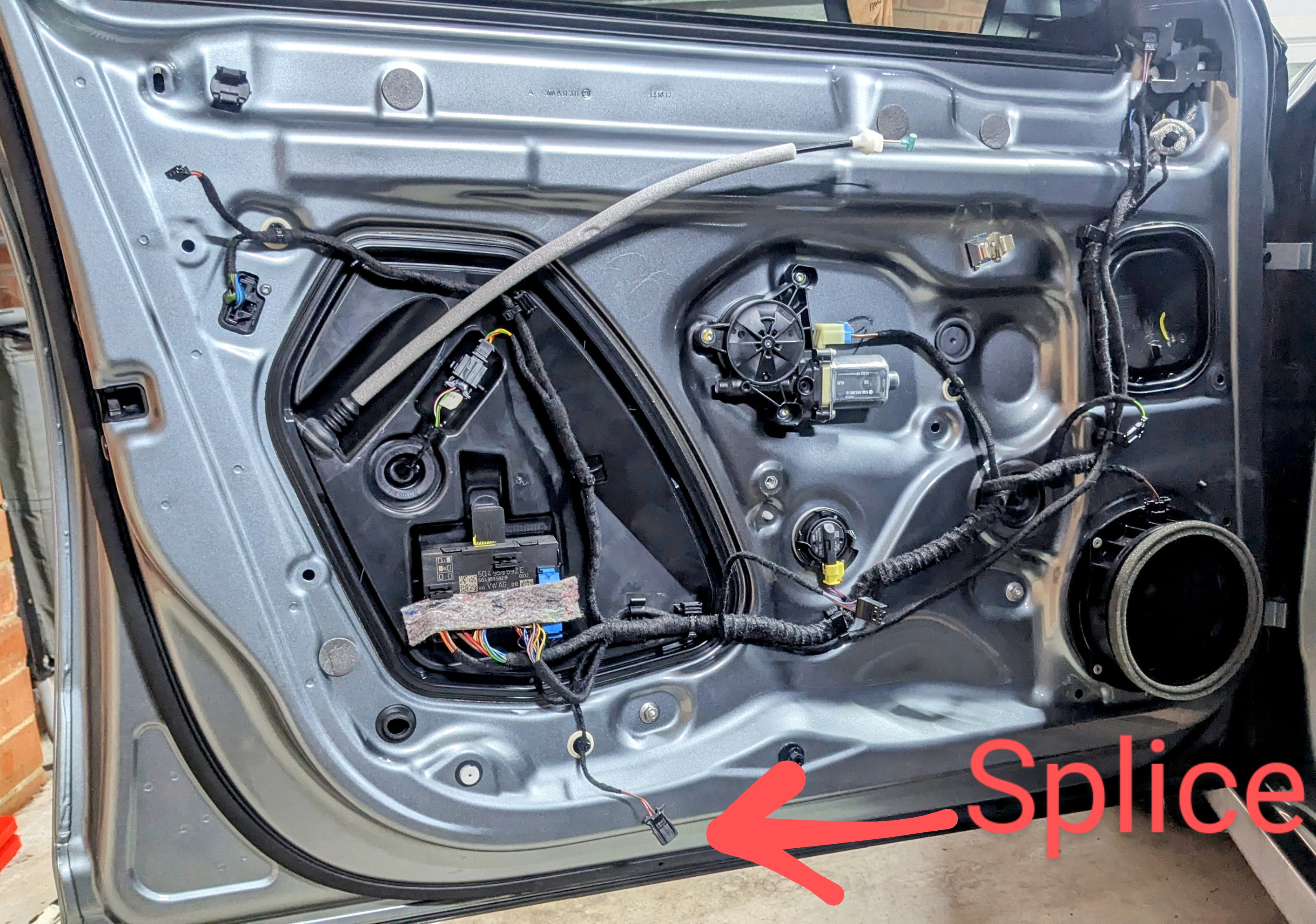

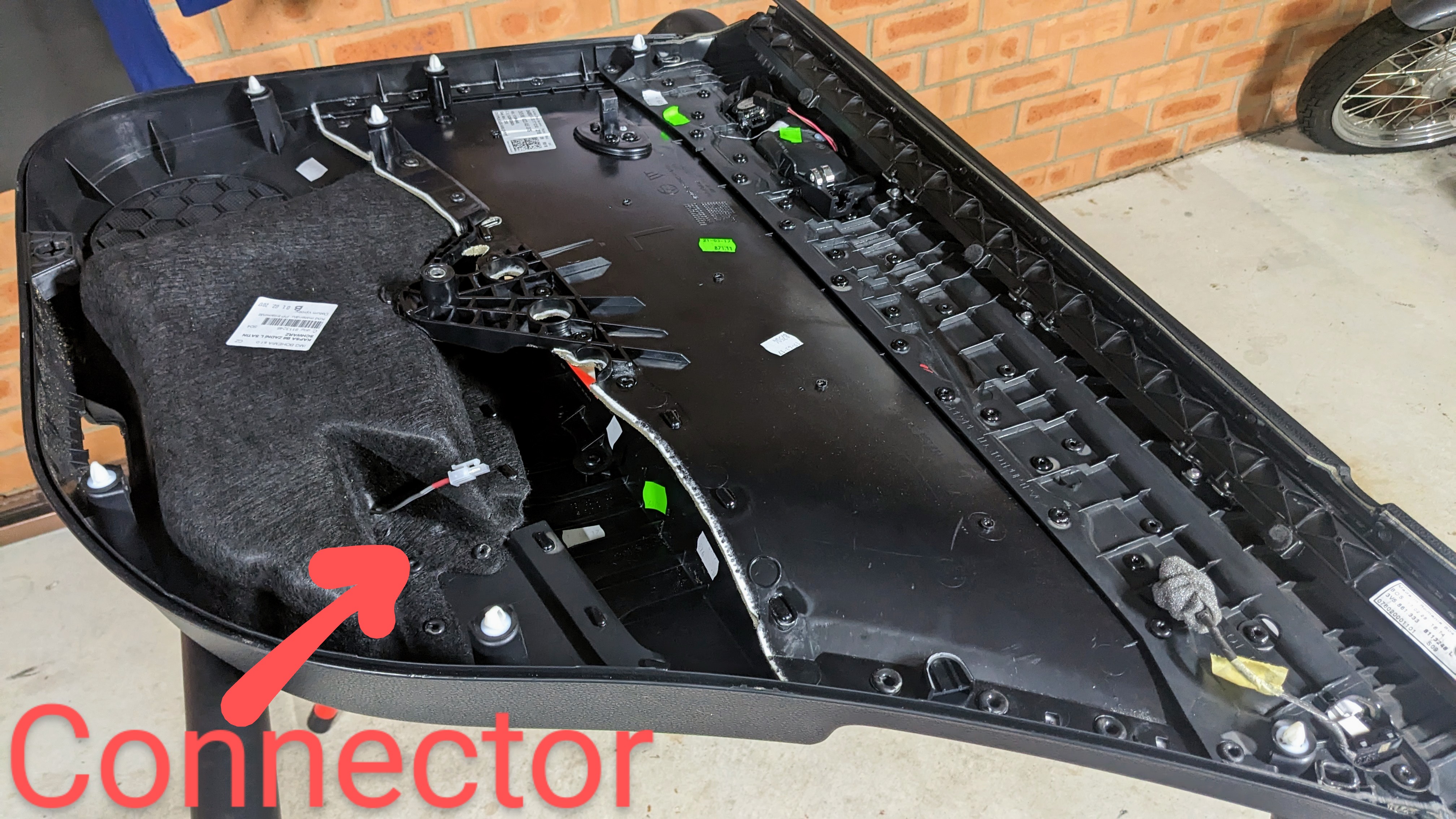

It's something that I made up myself.
I bought slim 2.7mm LED strips from AliExpress, cut them into 12mm length, soldered the wiring & plugs, then stuck them to a grove inside the door pocket, along the top edge.
I spliced into the door warning lights for power.
It involves removing the door cards, so u can drill a tiny 3mm hole in the corner of the door pocket.

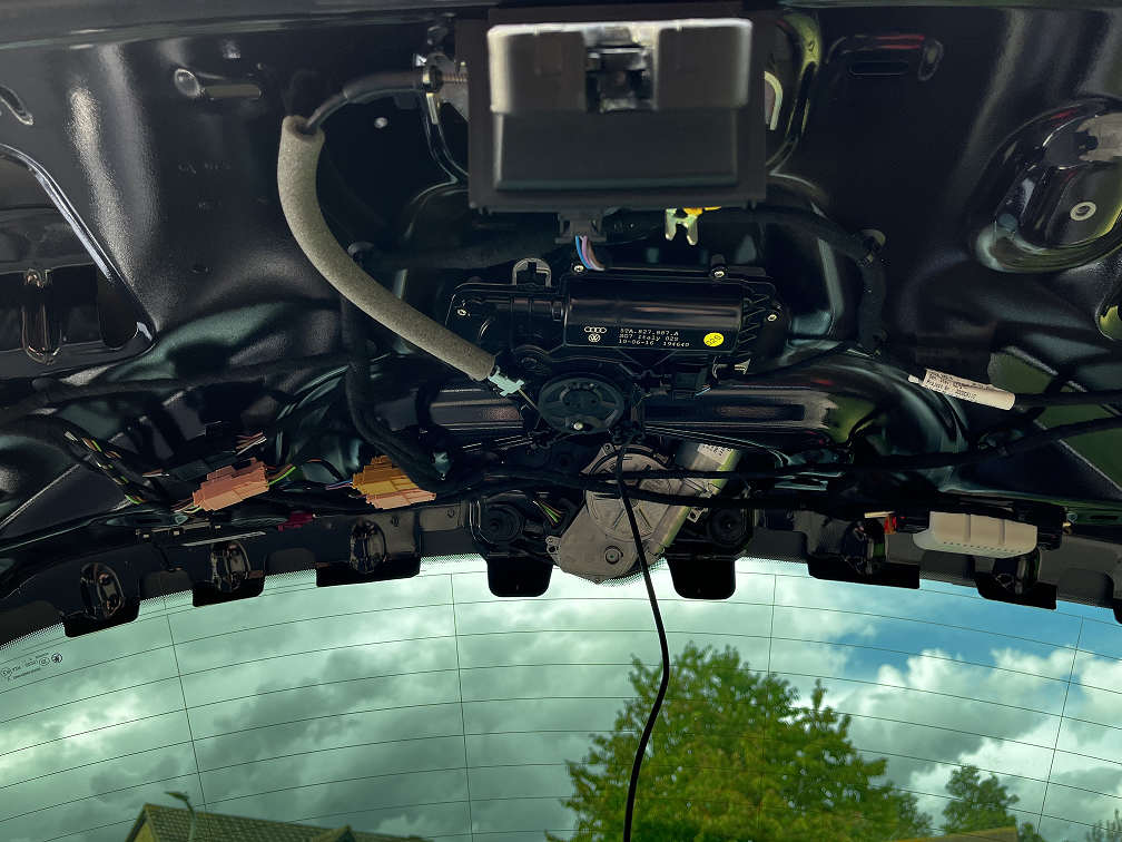

I just hope u don't have curtain airbags as the wiring u've run through the roof liner will foul the airbag in the event of an accident.

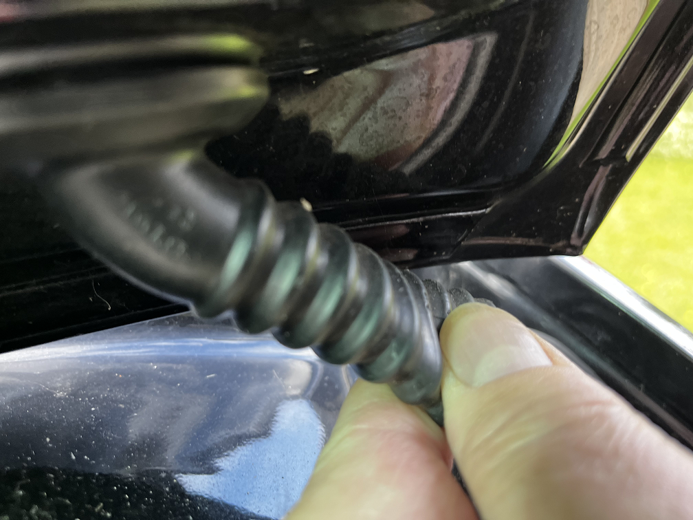

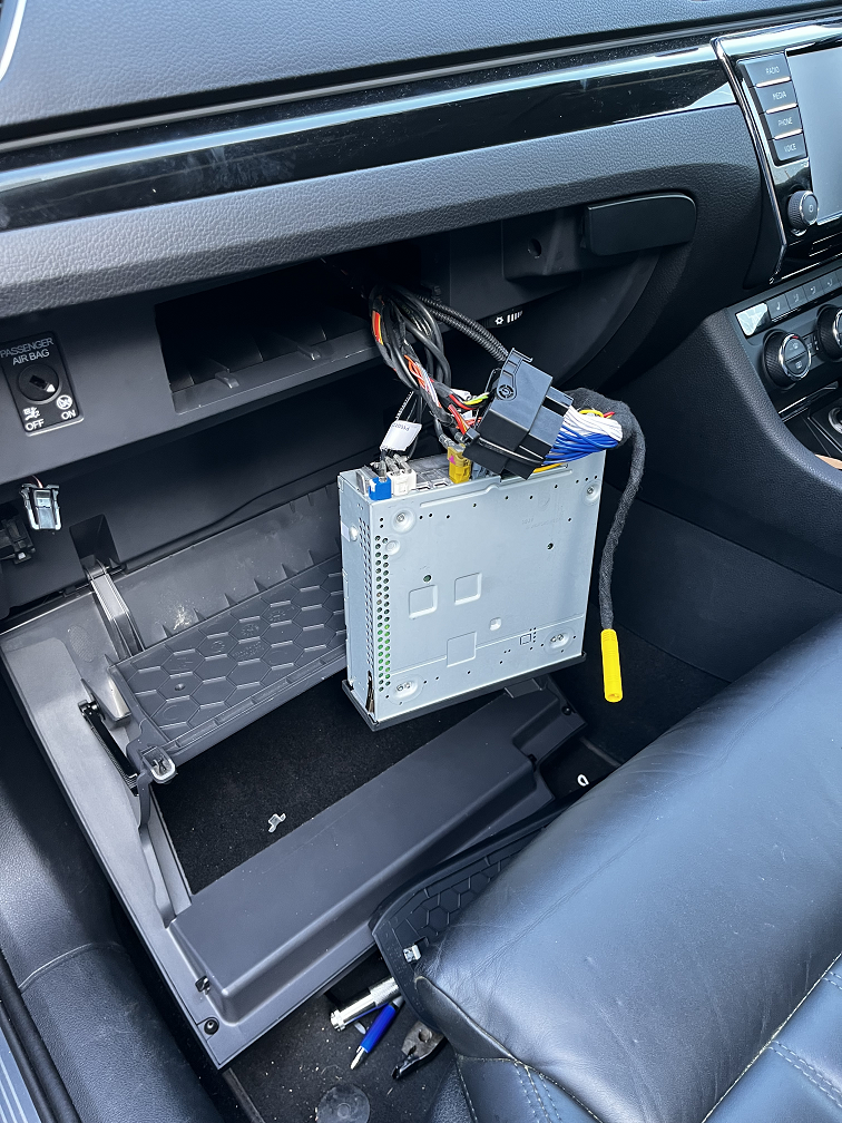

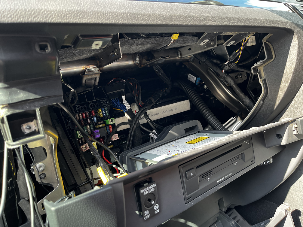

Thanks. I do have curtain airbags & to avoid them I ran the the camera cable above the head lining just left of centre & then sharp left to get to the L/H A pillar. It's not obvious from the photos but this route keeps it away from any curtain airbags. Looking at the uncovered C pillar there's a surprising amount of cabling going up into the headlining on both sides.
New trim clips arrived late today so I'll get the last bit of the tailgate trim on tomorrow. Then a damn good wash & polish I think.
