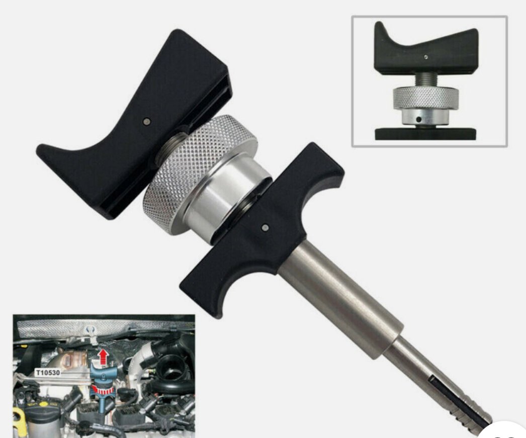

These coil pack pullers are a lifesaver for removing those packs.
We didn’t find pulling the coils themselves bad at all; but unplugging the connectors is about as frustrating as it gets and sorry to say I broke one of Rob’s. It still clipped into place but several bruised thumbs, swearing and YouTube videos for technique meant the job feels like a pig just getting to the plugs.
