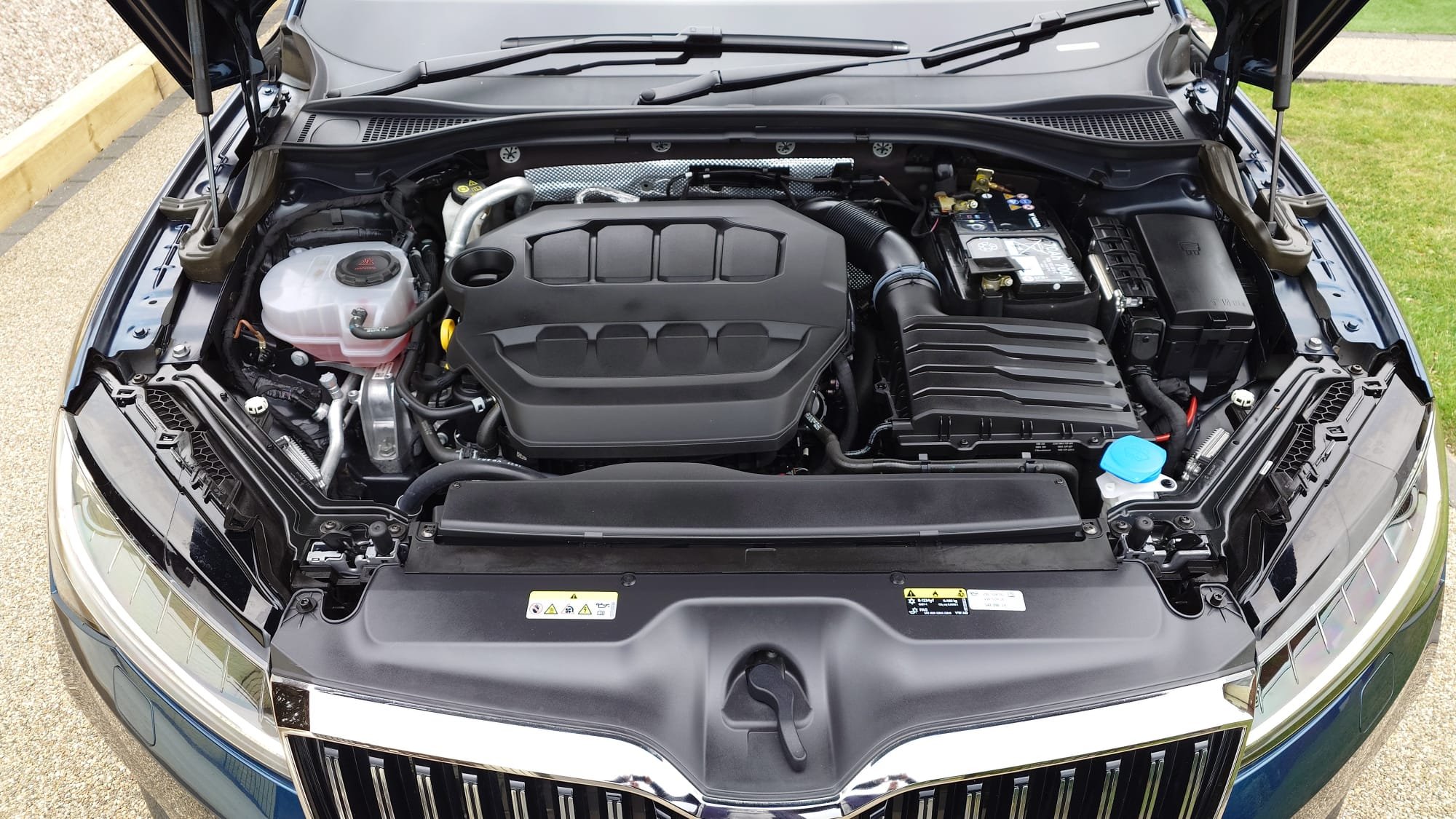

Today an engine bay detail.
Mine engine coolant reservoir is much darker, what could be the reason? I will take a picture of it ...
Bear in mind mine is less than a year old and has only done 5000 miles.
Nice one! How long did it take you? Been meaning to do mine for ages...
Edited by doluck
Added some thoughts
Not long, about 25 minutes, it wasn't that bad to be fair for 5k miles.

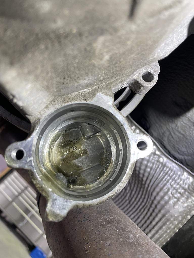

Oil change today, nothing special to report but the front active shocks are slightly misting. That'll be £600 + fitting before next mot for bilstein b6 damptronics as mot history says this is the second pair leaking already.
At the back, i also changed the haldex fluid, checked the filter and replaced seals. Happy to report that was unnecessary as there was nothing on the filter and barely a few bits in the housing
Quite confident now that the recommended interval of 30.000 miles WITH filter cleaning is correct for haldex 5. Main dealer does not clean this which led to a burnt out pump for me only 7000 miles after i paid through the ass for them to service the car

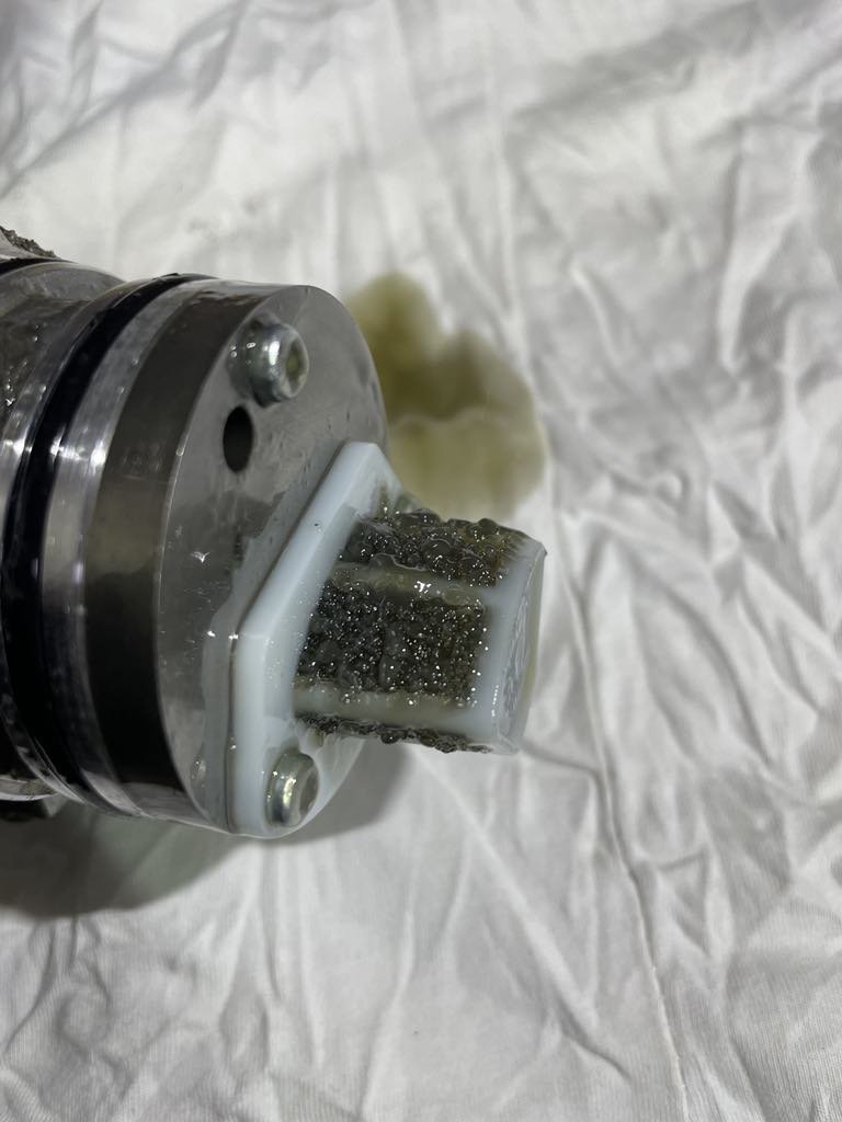

I do mine every 18 months regardless of mileage due to where i live ( channel Islands) i only take the car away once maybe twice a year and driving on an island is pretty much like city driving it's through the gears all the time. This is how the haldex filter looked on last change approx 7000 miles away

this is enough of debris.. strange.. you ofter driving off road?

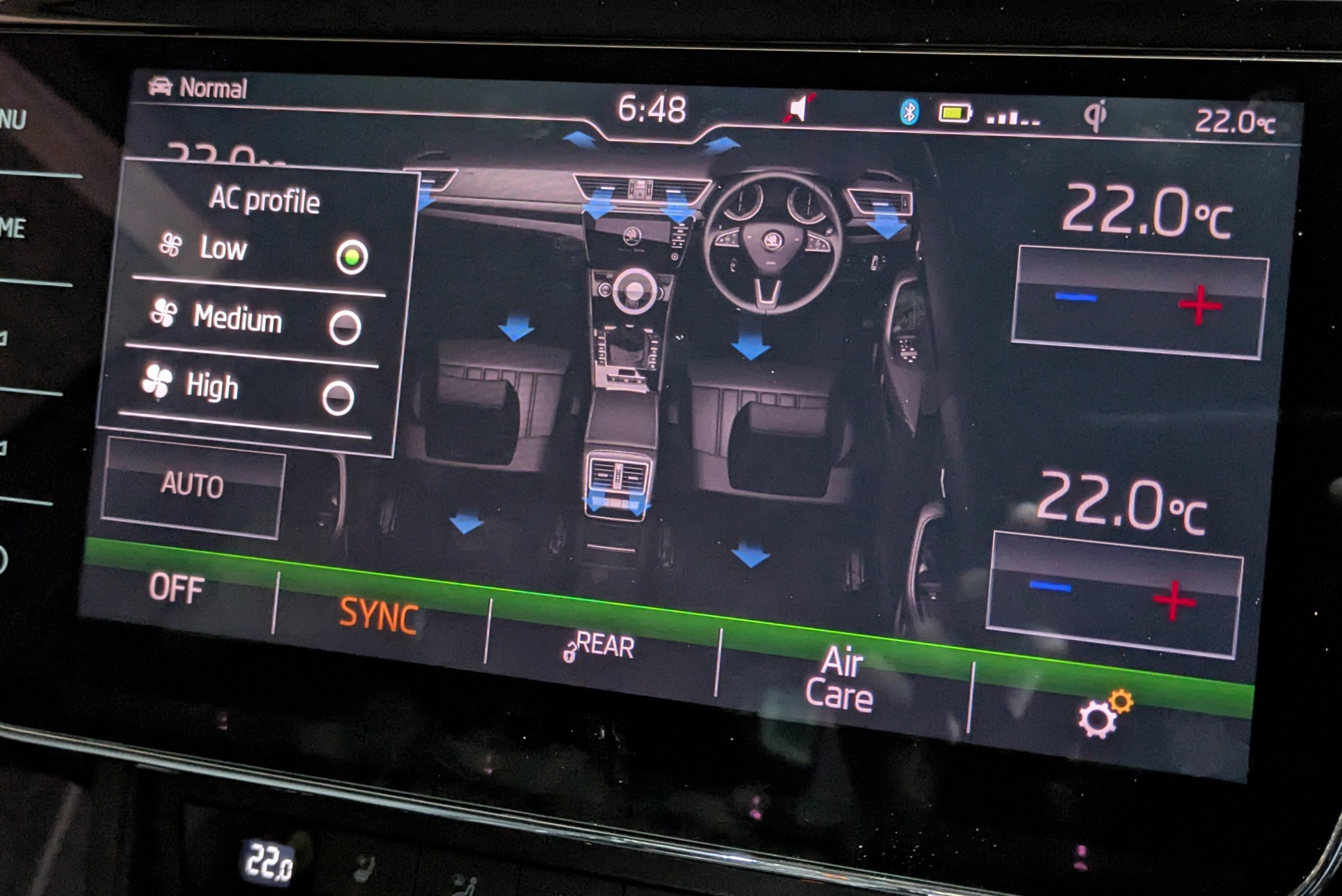

Any way to fix the AC PROFILE settings lost after MIB 2.5 upgrade with 9.2 screen and VC.
AC PROFILE MENU under climate control menu had 3 settings low medium high. This option is gone after this retrofit.
Mine still has those options after doing the MIB2.5 upgrade.
I used the AIO G11 to G13 firmware.
