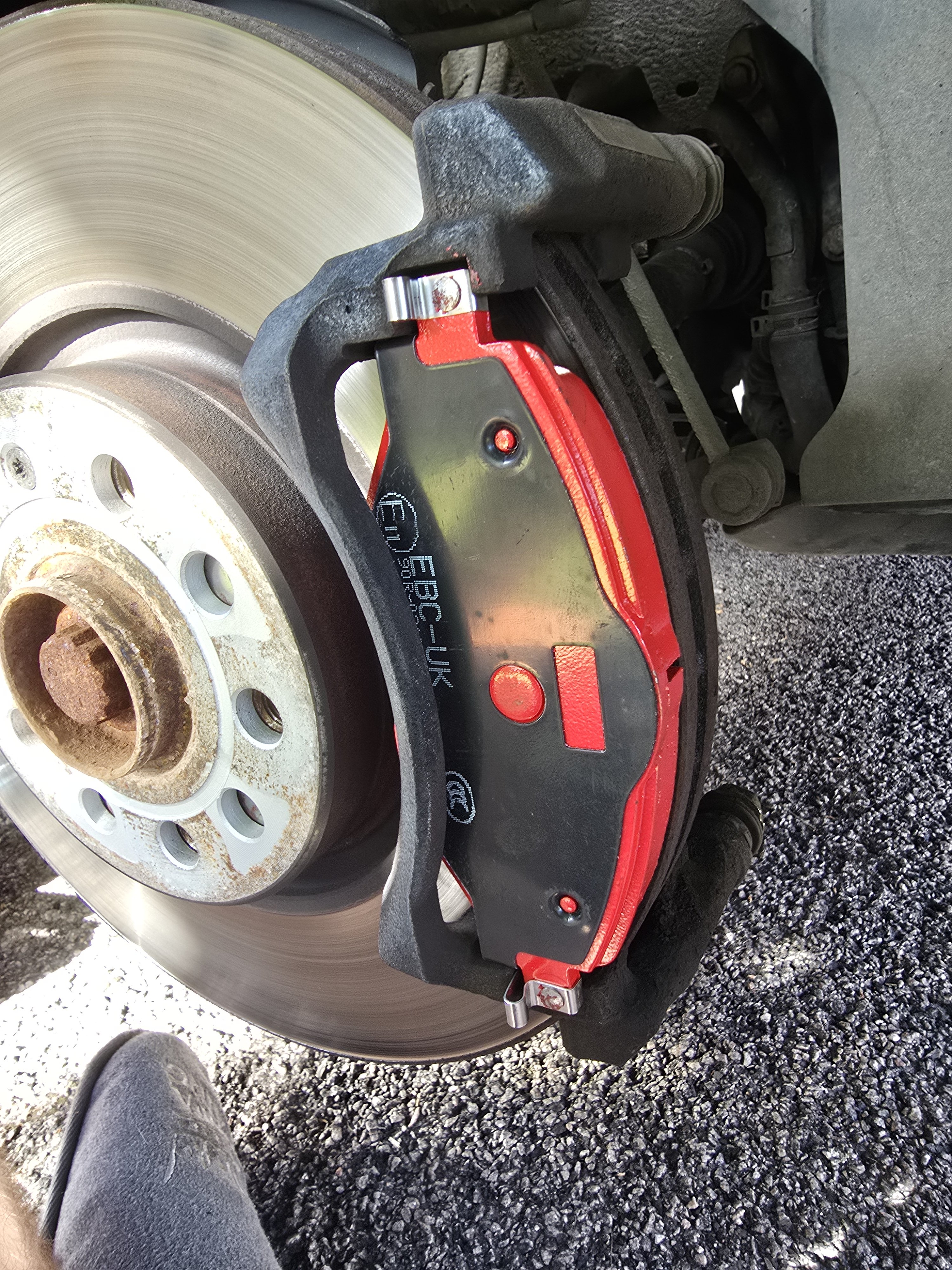

New front pads today. Turns out there is no brand on euro car parts that doesn't produce a **** special version to sell on there, so all of them squeal like train brakes, eat the discs and fade after 3 roundabouts around milton keynes.
Things to note:
Despite not being listed as compatible, ebc redstuff dp32150c fit just fine (32127 for 280ps). Mine didn't come with new screws and wear sensor so be aware. They're £88 on ebay.
Rear pads need a bloody 7mm allen key. It's not part of any kit whatsoever. Halfords sell one.
Front pads need a 17mm, ideally thin spanner to hold against the pin while unscrewing with a 13mm socket or i assume a t40 torx bit.
**** pads leave a lot of caked dust that just layers on top of itself. Gotta keep poking until it's shiny.
The brake wear sensor seems to be universal fit between pads, but it's skoda/vw specific on the connector side

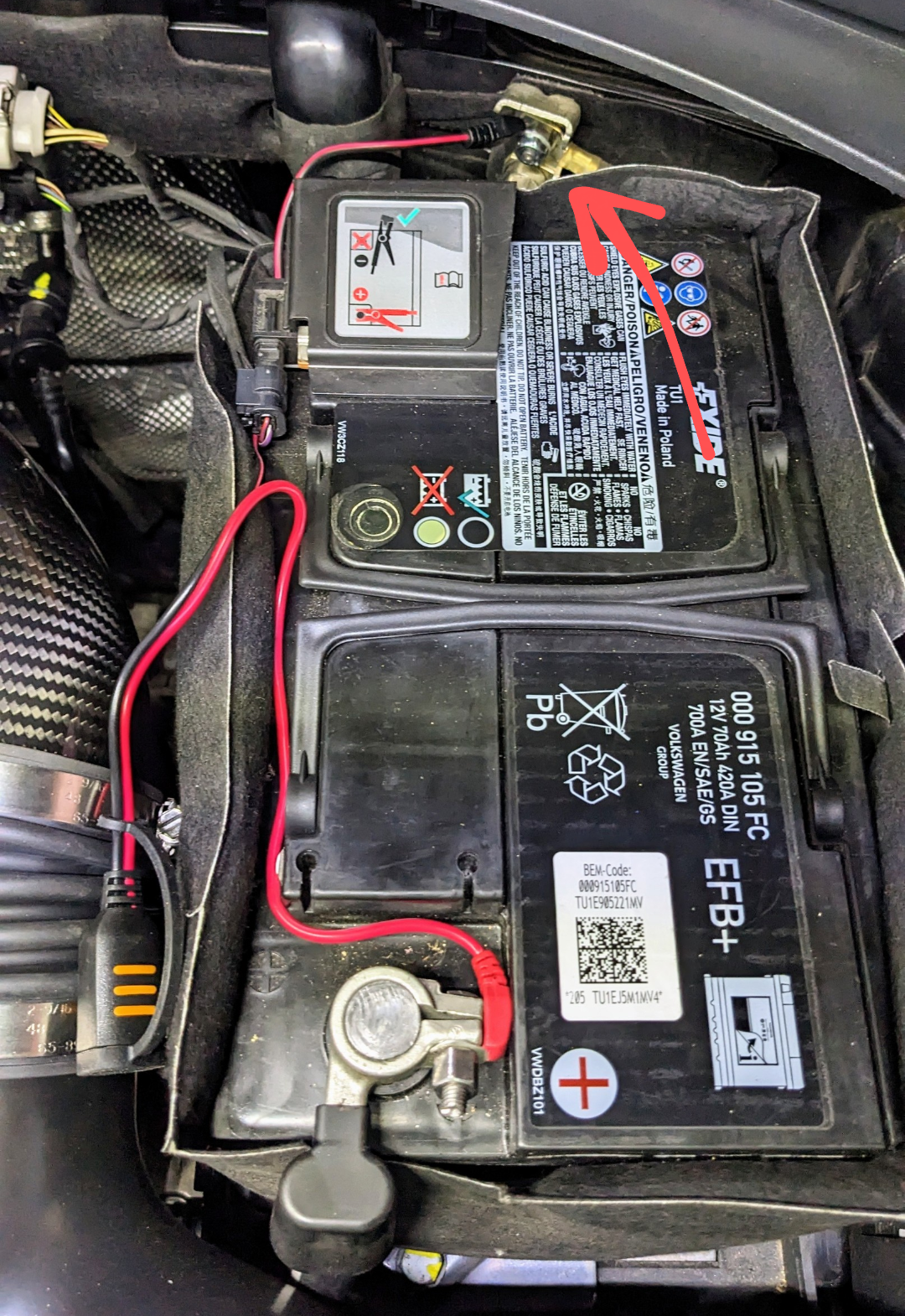

I've had a random message on the maneuver brake system for a few weeks. It only appears on cold starts. I'm gonna make a VCDS scan to see what it is, but I've already booked an appointment by my local dealer to get this sorted for sale.
Hi,
My local dealer made following diagnostic: Battery is a bit weak. This is what raises the error message on cold start in the morning by cool temp.
I'm then not very surprised since I drove my Mk3 for less than 200km over the last 6 weeks. Additionally, the dual dash cams draw a bit of current and even generate a "8531970 - Quiescent Current - U1406" fault code in VCDS diagnostic.
I've measured only 11.99V after a 20km drive, back from the dealer. I forced it in 5th gear, to have higher revs to improve battery charging (without forcing a DPF regen).
I intend to load my battery a bit so that the buyer has no worry with it (he should pick my/his Mk3 up on saturday). 2 days later, it has dropped down to 11.58V.
I was then asking myself if there's a special procedure to load the AGM battery? I have to say I never had to load a battery on any of the cars I owned.
Just plug the battery charger on the battery + & - (engine & contact OFF)? Or is there something special to do?
Yeah I know, I could read the manual... Sorry.

Yes, don't clip the -ve terminal to the battery, clip on the earthing point in the engine bay, so that the battery condition module will be aware that the battery is being charged. If you attach it directly to the battery, the module will not be aware of the fact you charged it, and so could behave as if the battery is flat as the module would not have been aware of any current flowing into the battery.
Thank you Graham, I've actually noticed that there's a spécial part on the - terminal, where to connect the battery charger.
I had in mind to respect this point.

U need to connect the Negative end of the battery charger to the car chassis, not the negative terminal!!

No thats it, as long as you connect the +ve to the +ve on the battery, you’re good to go.

Battery reloaded over night. It's now 12.59V. No more error message upon cold start this morning.
