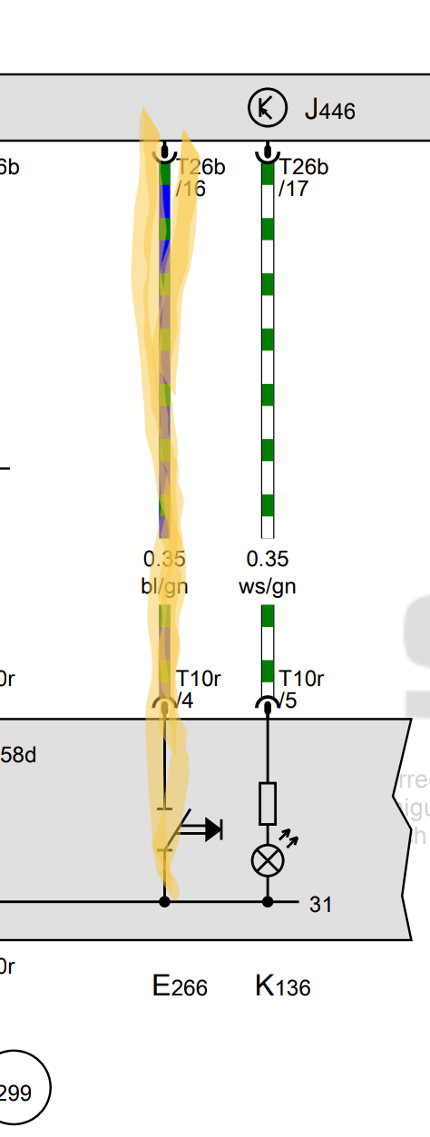

Well it would seem in running the cable for the camera through the rubber gaiter by the boot hinge, I have damaged some cabling for the interior lights.
Lights work ok until boot opens to full height then they go off. Have to close boot and lock/unlock for them to work again. I assume the BCM notices the break and cuts power to all interior lights and the lock/unlock reboots it.
With boot part open I can wiggle the rubber faster gaiter and they go off so pretty certain the break is there.
Found the red/blue wire in the wiring diagram and ordered some 22Awg wire and some crimp terminals.
So sometime soon I will pull the trim off and trace wire in the loom to either side and try to find somewhere suitable to splice a new wire in.
It does mean pulling yet another cable through the already very tight rubber gaiter!

No. Im pretty sure I damaged a wire when pulling the cable through for the camera. It was really tight getting it through the rubber and I got a bit angry and pulled hard on it. Not ideal.

Wirings there
4 hours ago, AMD87 said:
Verkabelung dort
You have This Wire? The Button for PDC ist No Coding

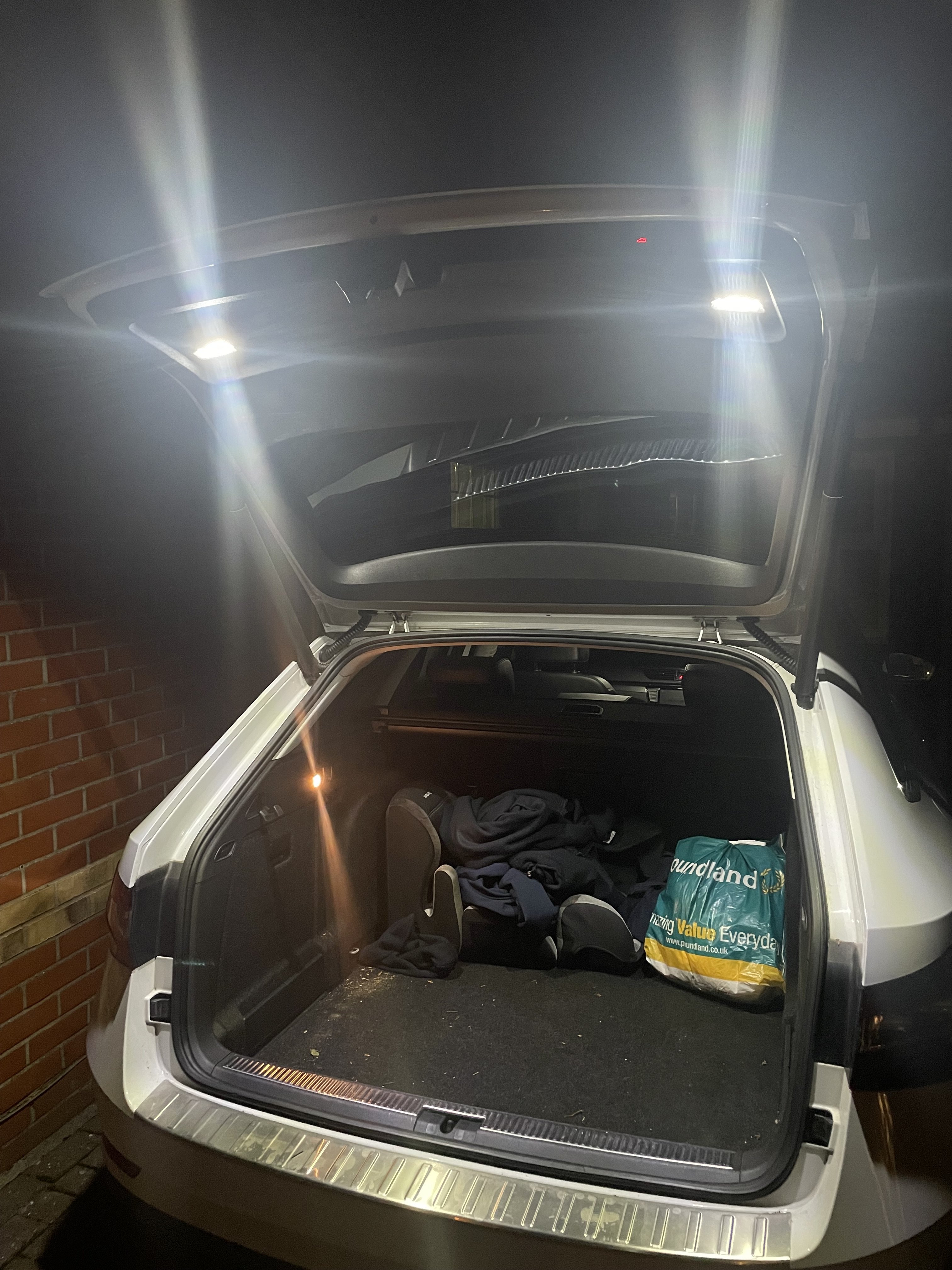

Fought my nemesis again this afternoon. Pulled a new wire through from plug under tailgate trim right back to plug behind trim on the left of the boot.
Seemed much easier to navigate the route this time. To get through the rubber gaiter I taped the wire to a plastic chopstick, removed the rubber from the bodywork both ends and pushed it through.
Lights now working well. Just waiting for the AliExpress super bright ones to be delivered.
A couple more AliExpress upgrades today.
The LED lights in the tailgate are very bright. All the light in that photo is from them.
