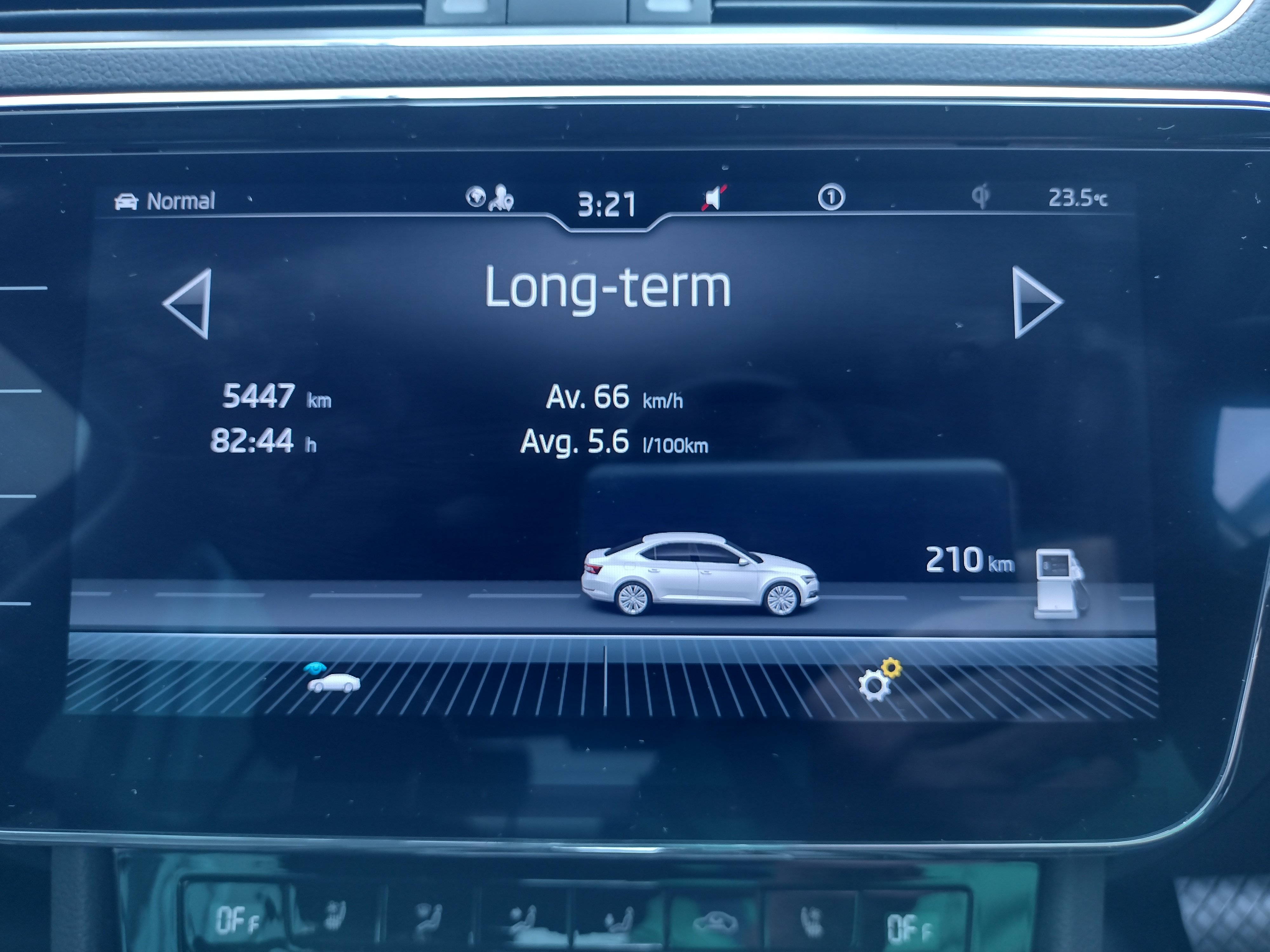

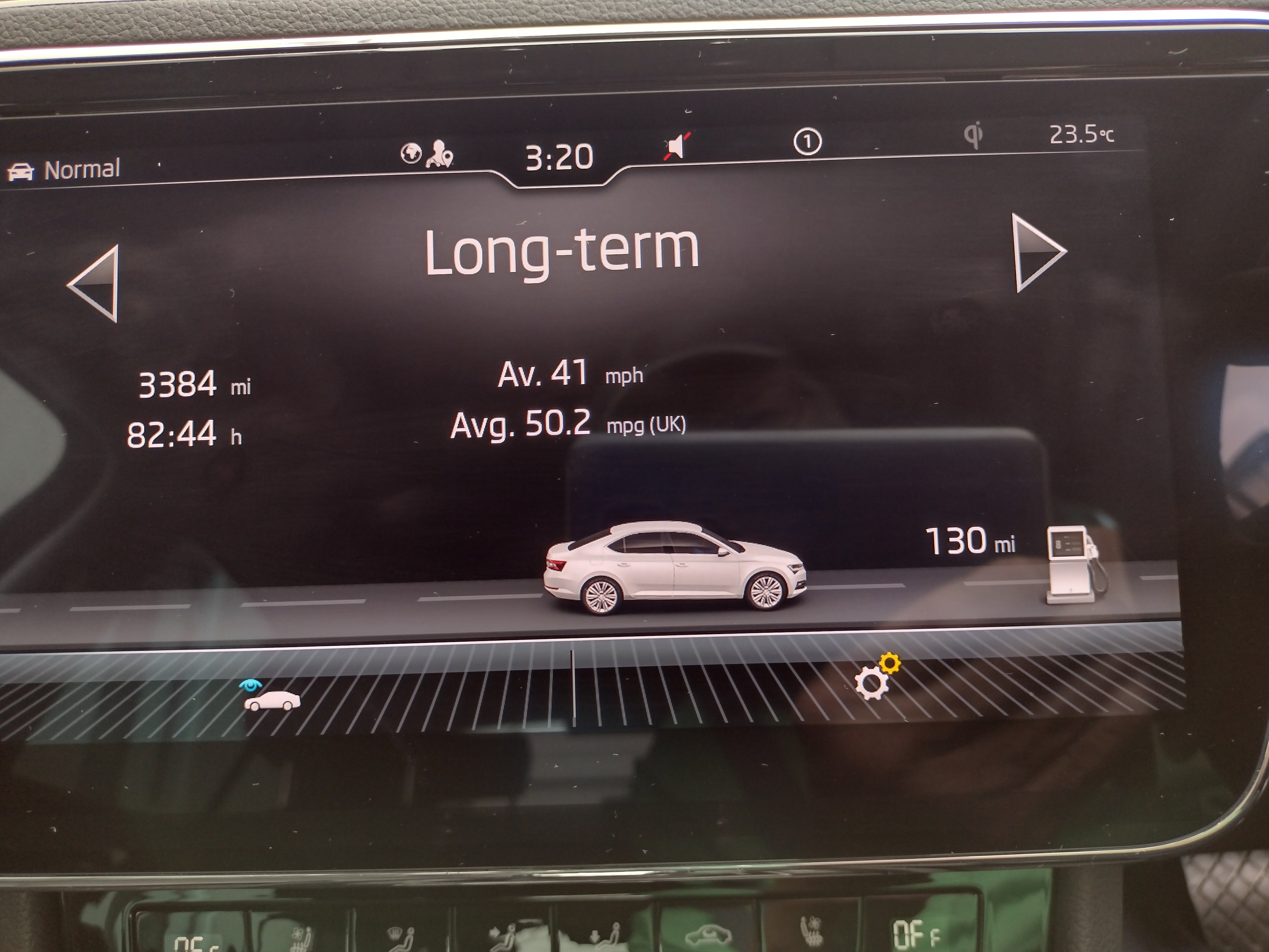

Recently we've been on 25 day trip to Lithuania to visit SWMBO's family and friends by car. We went on the Harwich-Hook of Holland overnight ferry, stayed overnight in Bielefeld, Poznan and Bialystok before arriving in Klaipėda for 13 nights in an apartment we rented. We then went on to Vilnius for 3 nights before heading home, staying in Warsaw, Dresden, Arnsberg and Calais before taking the ferry to Dover.
The car behaved itself all the way and just needed petrol. The outward journey went smoothly with no delays, though we ran into some heavy rain at times in Germany and Poland. The return journey wasn't so good, as there were long delays around Wroclaw in Poland with roadworks and around Essen in Germany, where the A40 was closed for resurfacing, where we got a bit lost in the town.
The results of our trip are as below. The mpg suffered on the way home in the holdups as it was showing just over 55mpg when we arrived in Klaipėda, having shown a best of 59mpg driving through The Netherlands with their speed limit of 100kph. The mpg would have also been reduced a little by lots of small journeys around the cities where we were staying in Lithuania.

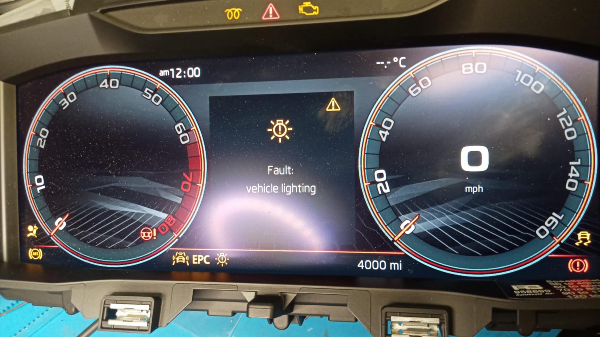

Dash works 😎 also does let you roll back the mileage so I should be able to get it to match mine when I get round to fitting it
With the right tools it has always been possible to adjust the mileage

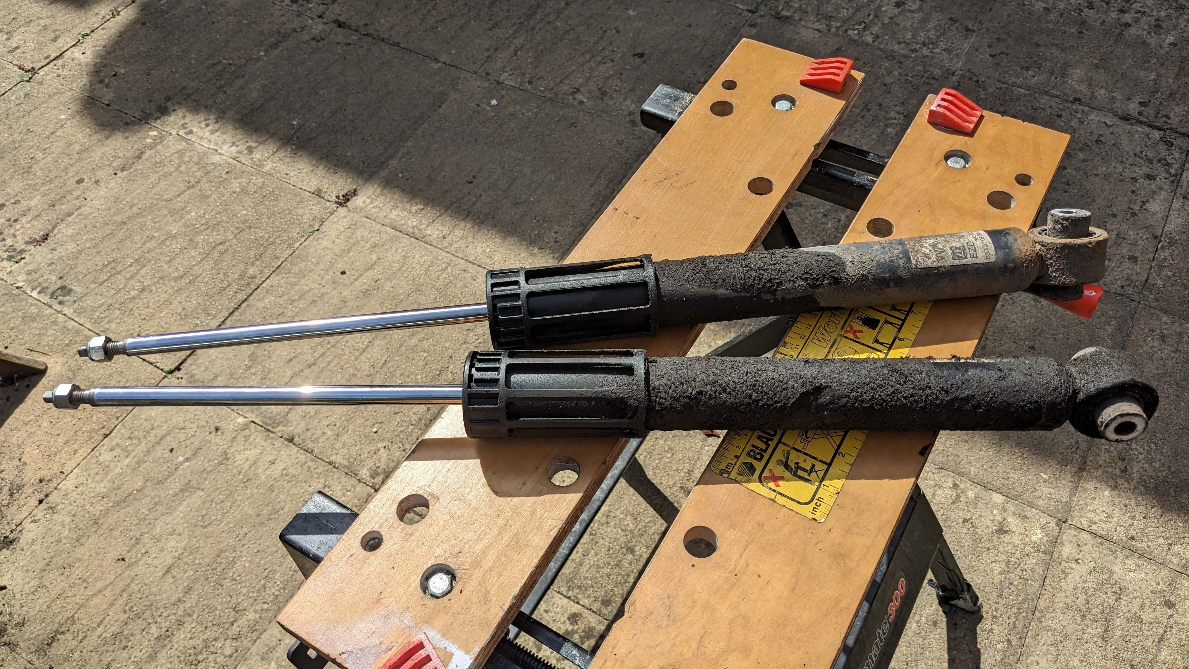

Replaced rear shock absorbers. There was a bit more than 'light misting' going on with the old ones, and not a lot of damping! Car feels much more stable now and road noise is reduced.

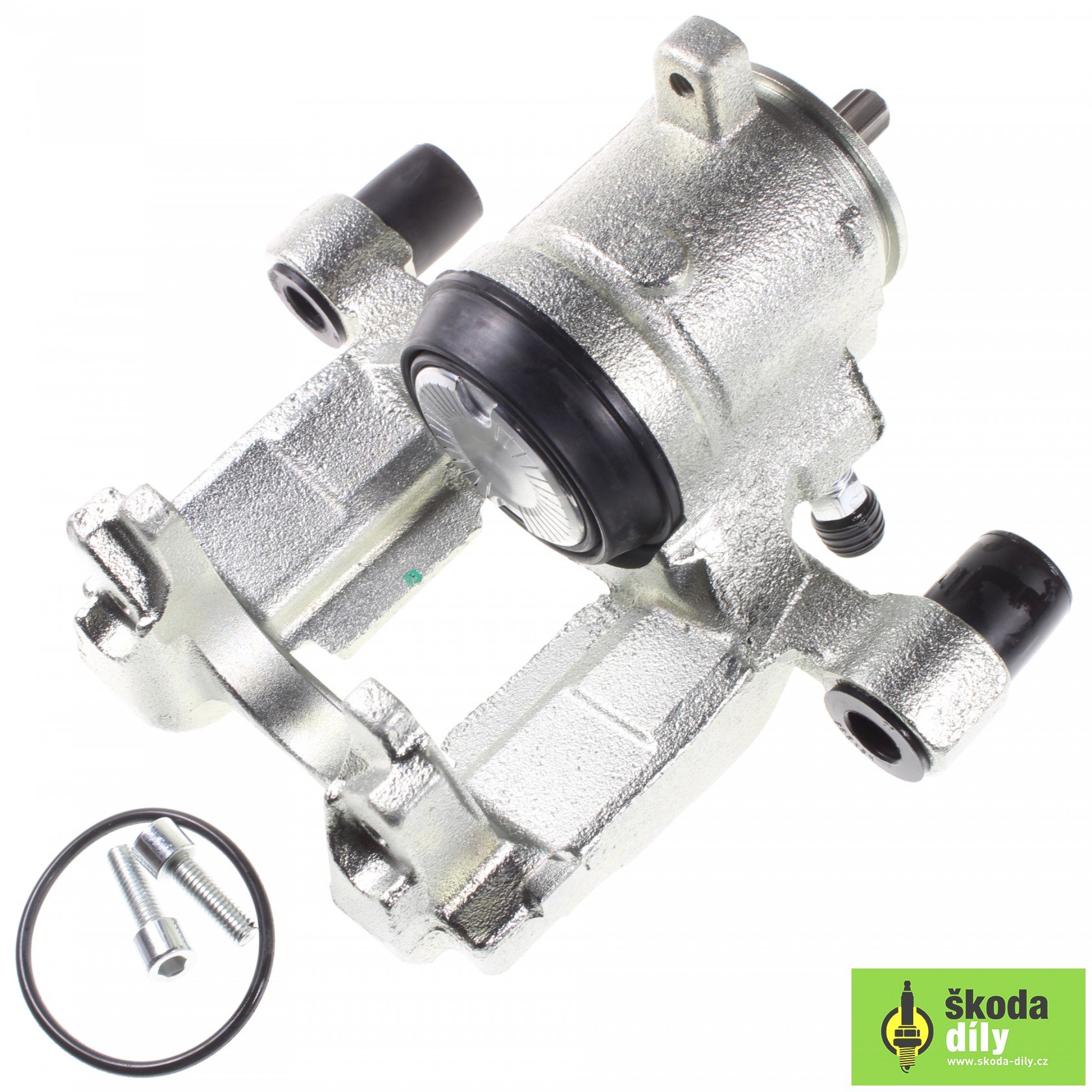

Forgot to mention about the brakes ... the slider pin section of the caliper bolts were bone dry, with a solidified hint of a dab of grease put long time ago. Once properly cleaned with scotchbrite and greased, the movement within the support was like .... night and day.
I was surprised because usually I see this in much much older and more "traveled" vehicles ....
I recommend to all of ya that have passed some years or mileage, set aside some time, especially if your swap tires, to remove bolts and verify, and ensure are in proper maintained condition!
It is a simple job, does not require specialized tools, just some patience and care.
any pics of the said place?
i strongly believe my brakes need this treatment.....
Don't have pics, but it is easy to explain .... on the rear of the calipers, you must access the bolts. You can see the "end" of the bolt in the outer area of the caliper, one above it, one below it.
There are two plastic covers, then the bolt is accessed, in my case was a hex 6 or 7.
The bolt is actually a threaded pin ... here is what it looks like:
https://www.skoda-parts.com/spare-part/251615219sad-set-of-guide-cases-european-union-27191.html
and the pin slides back and forth in the rubber, which if greased it allows sliding, if is not, it restricts or inhibits proper movement of the caliper ... that is all 🙂
