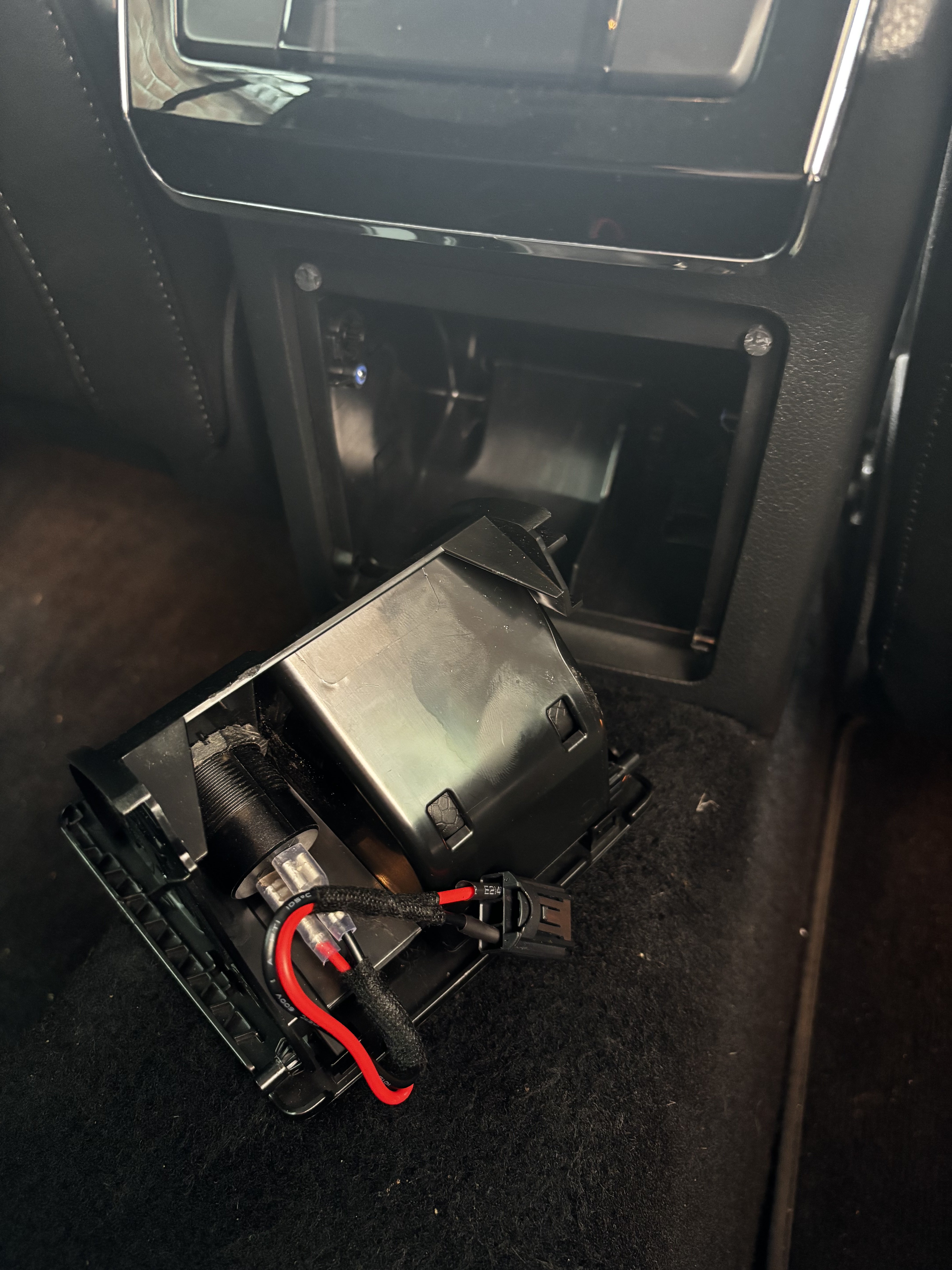

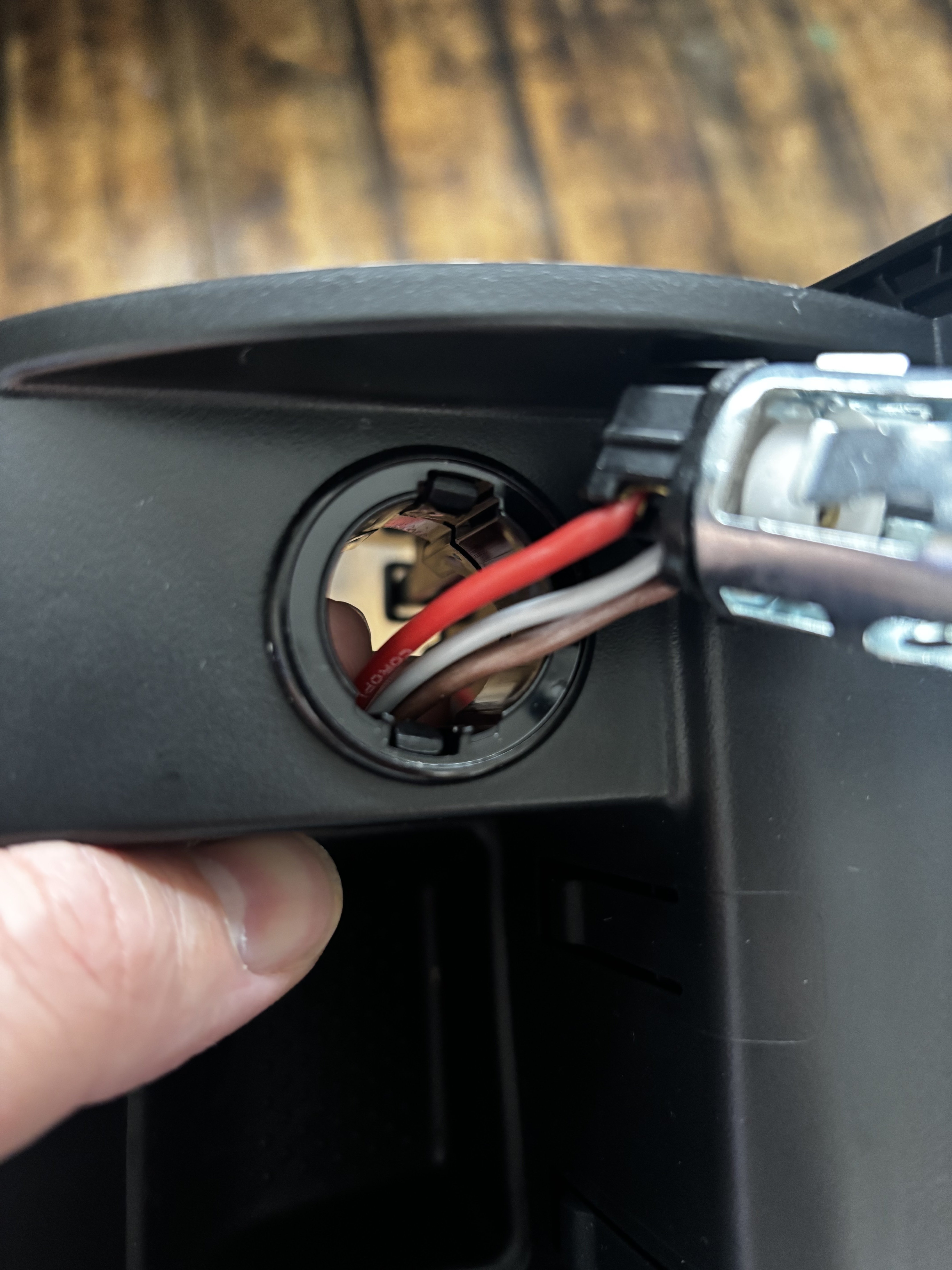

Just installed a 12v USB C and A socket replacing the 12v Cig lighter socket.
Was able to reuse the connections to the car, removing the existing and then soldering the new wires from the adaptor and making good. Just tested and all works fine, had to trim a little the back of the unit where the new socket went as the lock ring catch along with trimming down the lock ring also.
Also didn't destroy the old one getting it out, there are 2 tabs which you need to press in to get the inner metal socket out from the plastic surround and then you can remove the plastic surround, as this is held in by the metal socket.

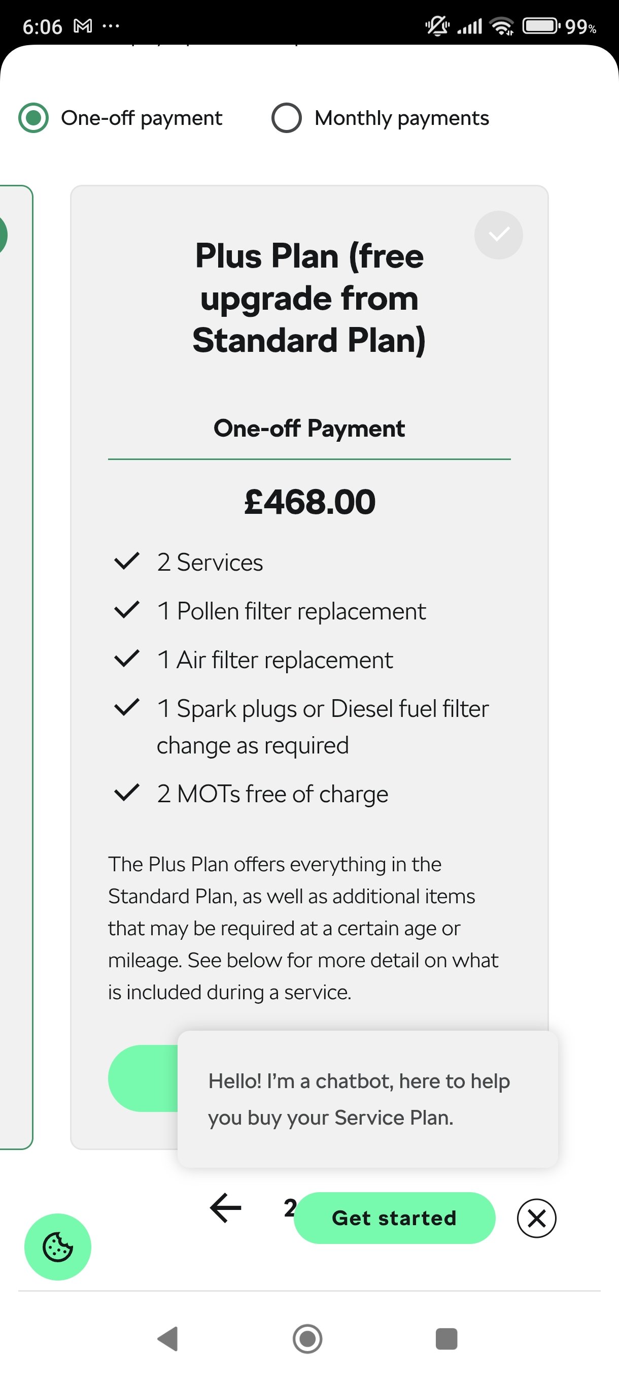

Not yet but I shall buy the 2 year service plan on offer until 2 December. 468quid for the Plus package which has 2MOTs, pollen filter, air filter and spark plugs (probably mileage dependent).
That's stonking I think...If you trust the main dealer lol
That is a good deal.. is that being offered by the dealer direct or something? VWFS still has it for £708.
It is VWFS.
16 hours ago, KeteCantek said:
It is VWFS.
£50 more because mines an iV??
Seems like it. Not sure why, odd. Mine is just an old 280 4x4 petrol....
But wait till you see Audi prices for basically the same drivetrain. E.g. A3 vs Golf/Octavia. They pay so much more😂😂

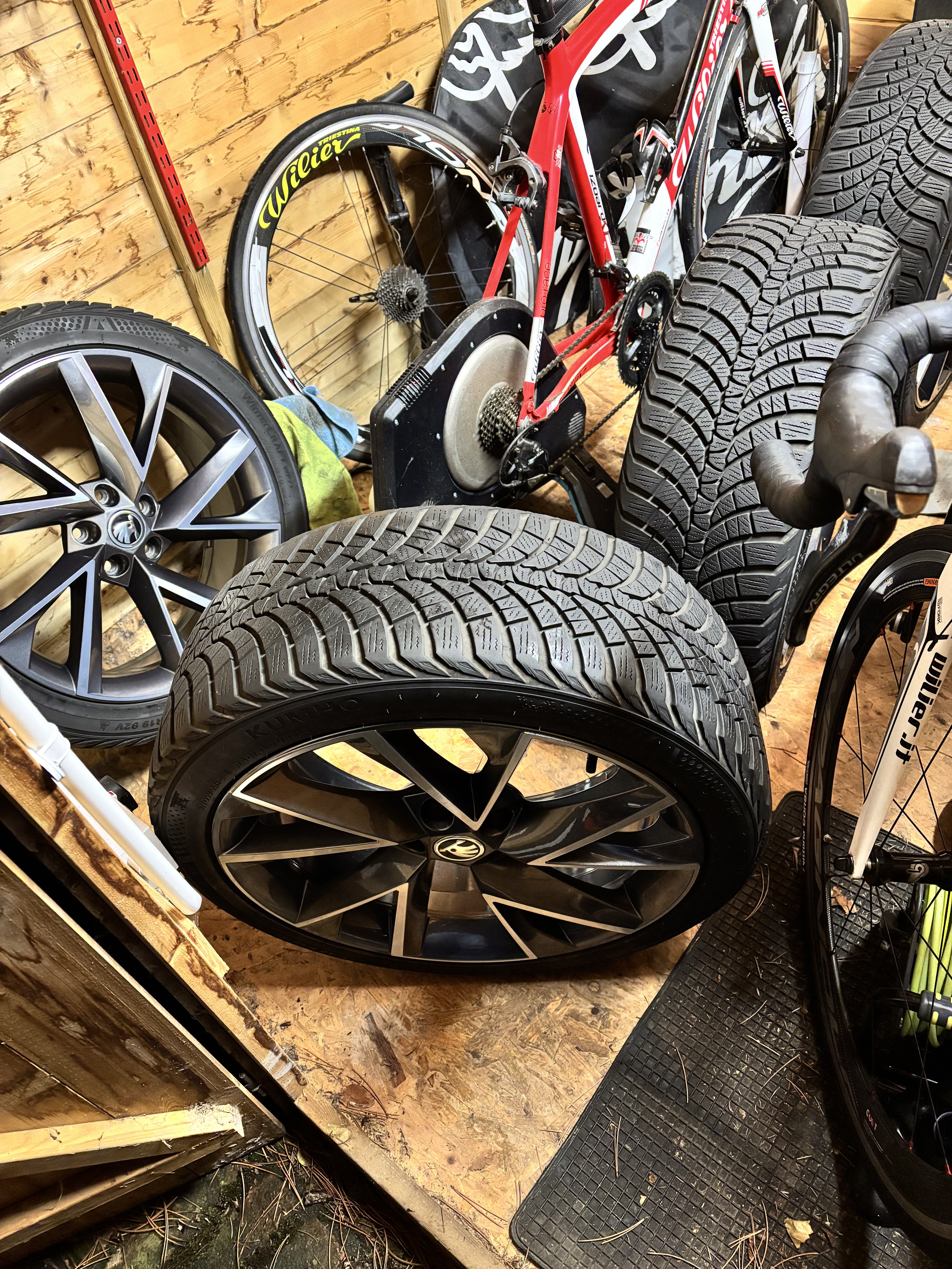

Winter wheels coated with Carpro CQuartz and left to cure in the shed pending switchover this weekend.
Not fussed about the job but anything that makes them easier to keep clean is good by me.
Now to dig out time to polish the whole thing and get some on the paint.
