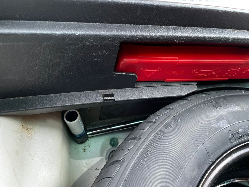

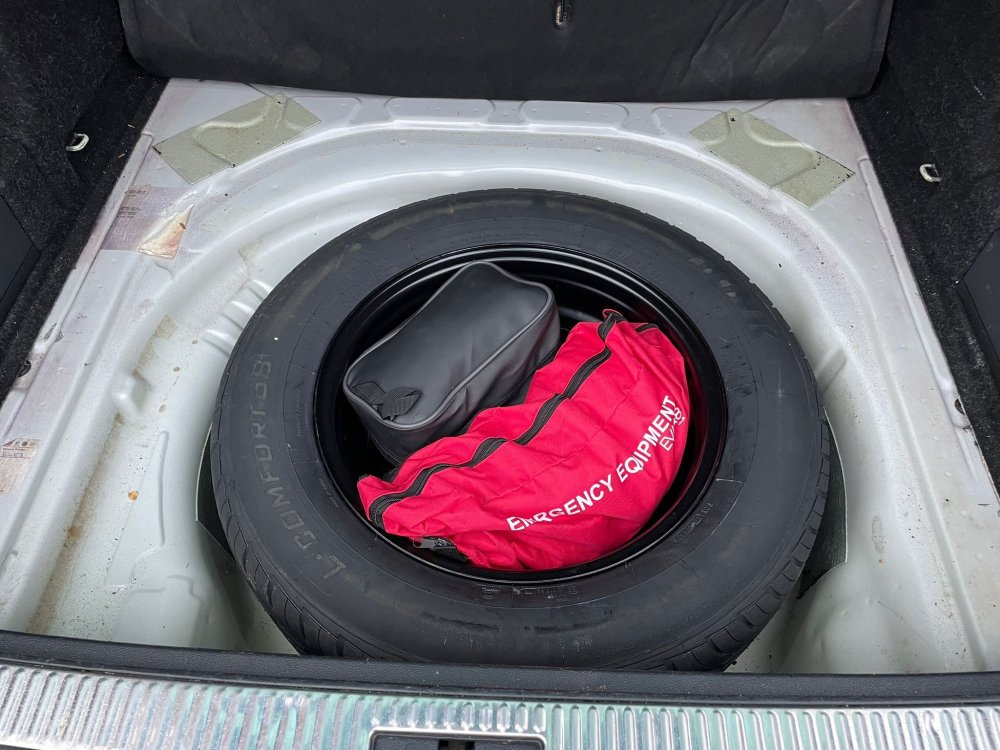

Now all set up with a spare.
I got this wheel: https://www.ebay.co.uk/itm/364188522719
This Jack: https://www.amazon.co.uk/dp/B08FTH8N1T
This breaker bar and socket: https://www.ebay.co.uk/itm/403816977765
and this mounting screw: https://www.amazon.co.uk/dp/B0FP91RLPK
I know its a budget tyre but its a cost effective way of having a full size spare. If I were to get a flat on th front I would put swap an alloy from the back to front and then put the spare on the rear.
It just its in wheel well without needing to trim any plastic away. And the breaker bar tucks in under the plastic trim before the wheel goes in. Im thinking it may rattle a bit in that position so will put some foam or sound deadening between it and the metal. Floor is flat over the top of the wheel too.
Annoyinly the jack is about 10mm too long to fit inside the wheel for the floor to sit flat, but it does fit in the side cubby along with my fire extinguisher, and then the first aid and emergency kit fit in the wheel. Happy with that.
The floor does feel a bit soft over the centre of the wheel, and I assume the OEM foam insert goes some way to supporting the floor. May make up a circle of Plywood to fit in the wheel to help support the floor.
Also does anyone want the standard foam nonspare wheel insert before I take it to the dump? Is it worth trying to sell?
@Binx1310 Just a quick observation: are you 100% certain that that spare wheel will fit your Superb? The seller only quotes it as being compatible with the Karoq?
Hope so! I bought it based on another post on the forum. It’s the right pcd and offset different by 2mm. But half an inch narrower to fit under the floor. Rolling diameter is less than 0.5% different from current wheels.
Going to do a test fit later in the week.
Factory spare wheel for the mk3 Superb (non-272/280) is 6.5Jx16 205/55R16.
U've got a 6" wide wheel.......
Edited by JR RS
My purchase was based on the info in this post. Hopefully will be ok. There are posts of people putting karoq alloys on Superbs too. Will do some careful test fitting on Friday.
At that tyre width and sidewall of the standard spare, it’s 6% smaller circumference. On the tyre size I have it’s less than 0.5%. Granted the rim is 0.5” narrower but the tyre is wider and taller and more similar to the alloys and tyres I have. For the rare occasion it will be used for relatively short duration I’m sure it will be fine.
Not debating the overall tyre size - just stating wat is factory fitted spare tyre.
I myself have a full size 19" tyre.
Yea was looking at getting a kerb damaged version of the 18s I have but it would lift the floor by quite a bit and it’s a tight squeeze in the well. Happy with what I have. Will do a test fit Friday and make sure.
If the circumference is smaller, then it will certainly keep flagging a warning about low tyre pressure, as the wheel will be rotating at a different speed to the others. That system relies on the fact that a deflated tyre will make that wheel rotate faster than the others, and the system will flag a warning.
Yes. Went for as close a size to my alloys as I could get for that reason
How do they get over this with the official spare as it’s quite a bit different?
Do they? Is the official spare smaller in diameter? I think they might only be smaller in width, load and speed rating.
That said, I have always had mine supplied from the factory with a full size tyre on a steel space saver rim.
The size JR RS mentioned above is nearly 6% smaller in circumference.
True, but my cars came with 19" rims, but also don't forget that the dia quoted is the rim size, not actual tyre diameter which should in an ideal world match that of the standard normal running wheels.
my 220 came with 19x8" ET44 235/40R19 from factory.
factory spare was 16x6.5" ET45 205/55R16 from factory. it's a full-size steel rim, not the crapy bicycle tyre!!
yes, i did get a TPMS warning whenever the spare tyre was on, which would in turn disable ACC and Front Assist.
i've had 3x punctures in the first couple of years of ownership.
super annoying.
hence why i got a full sized 19" tyre as a spare now.
