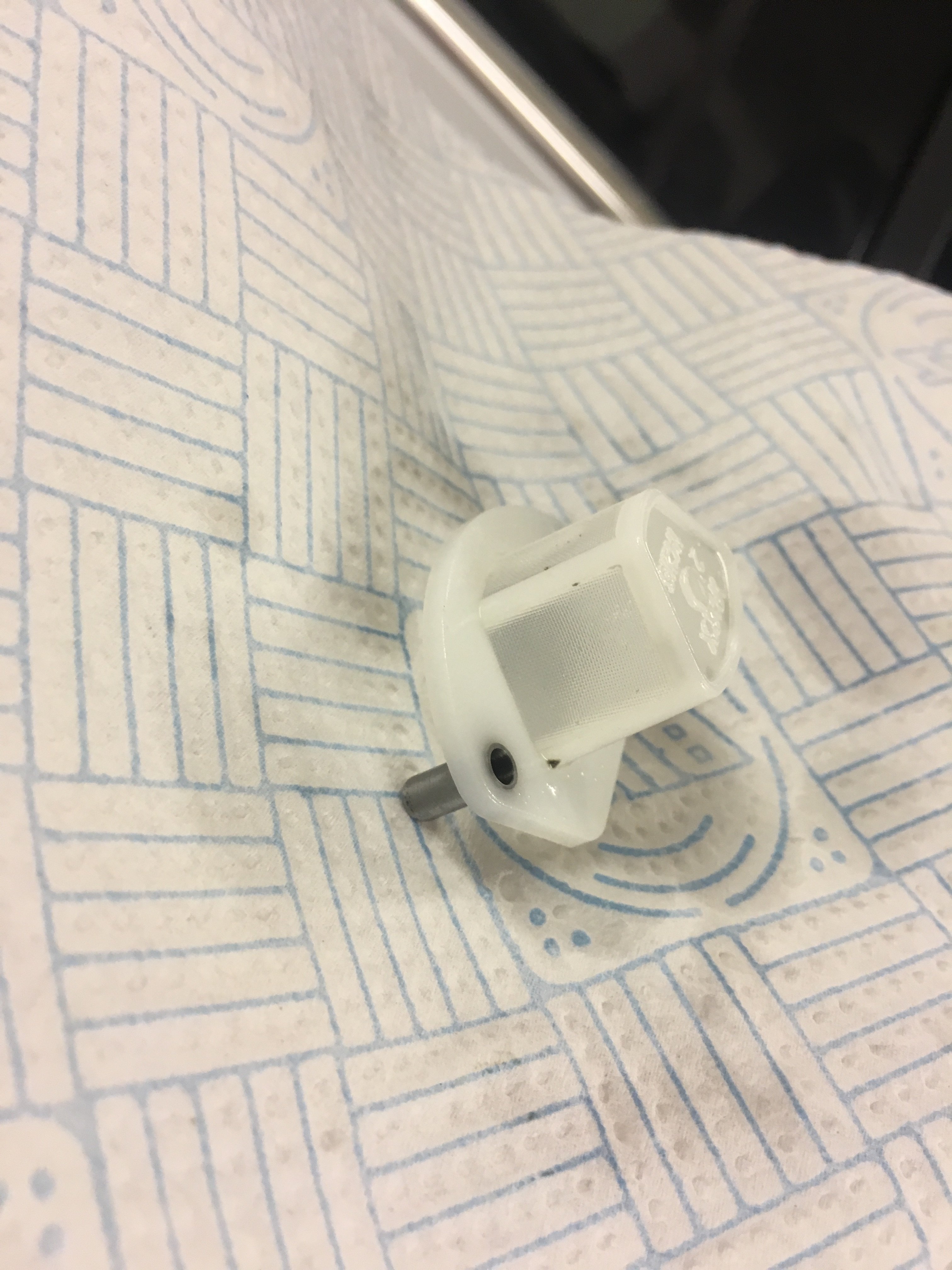

Decided to change the Haldex oil today. Car history is that at 2 years / 20,000 miles the Haldex clutch pump failed and was replaced under warranty. I presumed that at that point, the Haldex oil was changed as well. So I’ve left it until car has reached 3.5 years and 40,000 miles to change it again, ie just 20,000 miles and 1.5 years since it was last done.
Rule 1 is to always check you can get the filler bolt out, before opening the drain bolt! Filler is round aluminium with a rather small (5mm) hex socket which is easily rounded. Sure enough... A trip to TPS got me a new one for a few quid. I then tackled the old one with chisel and hammer! Got the little B***** out eventually.
I wanted to remove the pump to clean the integral gauze strainer and had previously bought new O rings that seal it. To remove the pump one first has to get enough slack on the wire and I came to the conclusion that to do that, it was easiest to undo the 2 8mm bolts that hold the electronic controller on. One could of course undo the connector but it is at the back so you can’t see it and unless you know exactly how it comes undone, it’s impossible. Anyway, easy to de-mount the electronic box. The wire is attached over the top of the Haldex by two plastic pegs that are easily pulled out.

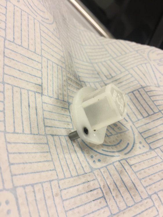

With the wire free, the two 8mm bolts that hold the pump on, can be removed and pump extracted. Wow, what a lot of gloop on the gauze! And second point, hmmmm, not much oil coming out so maybe I was wrong to presume that the oil was changed when the pump was replaced (even though the dealer’s “service advisor” said it was).
Gauze filter can easily be removed. This is what it looks like when it’s clean:

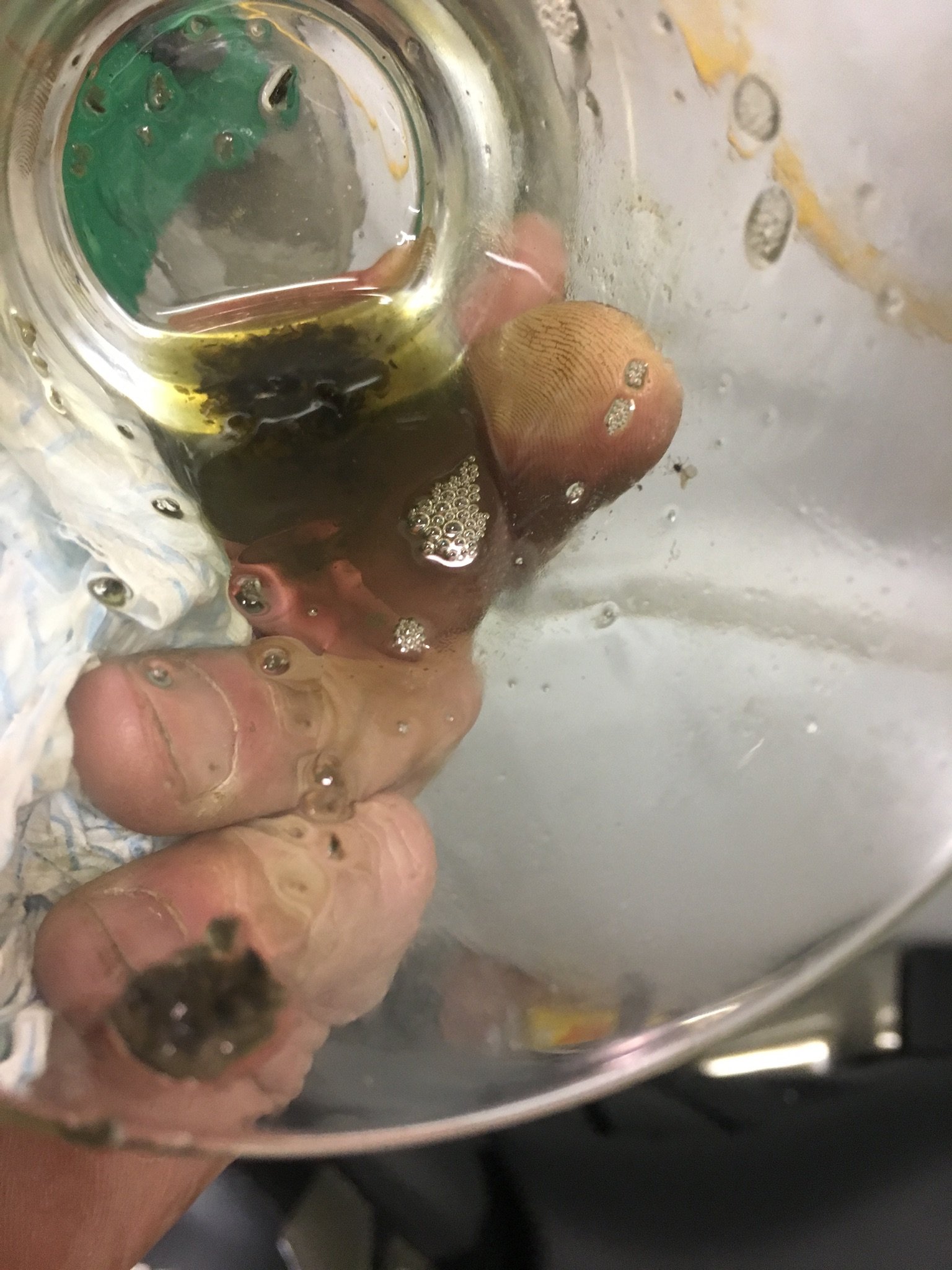

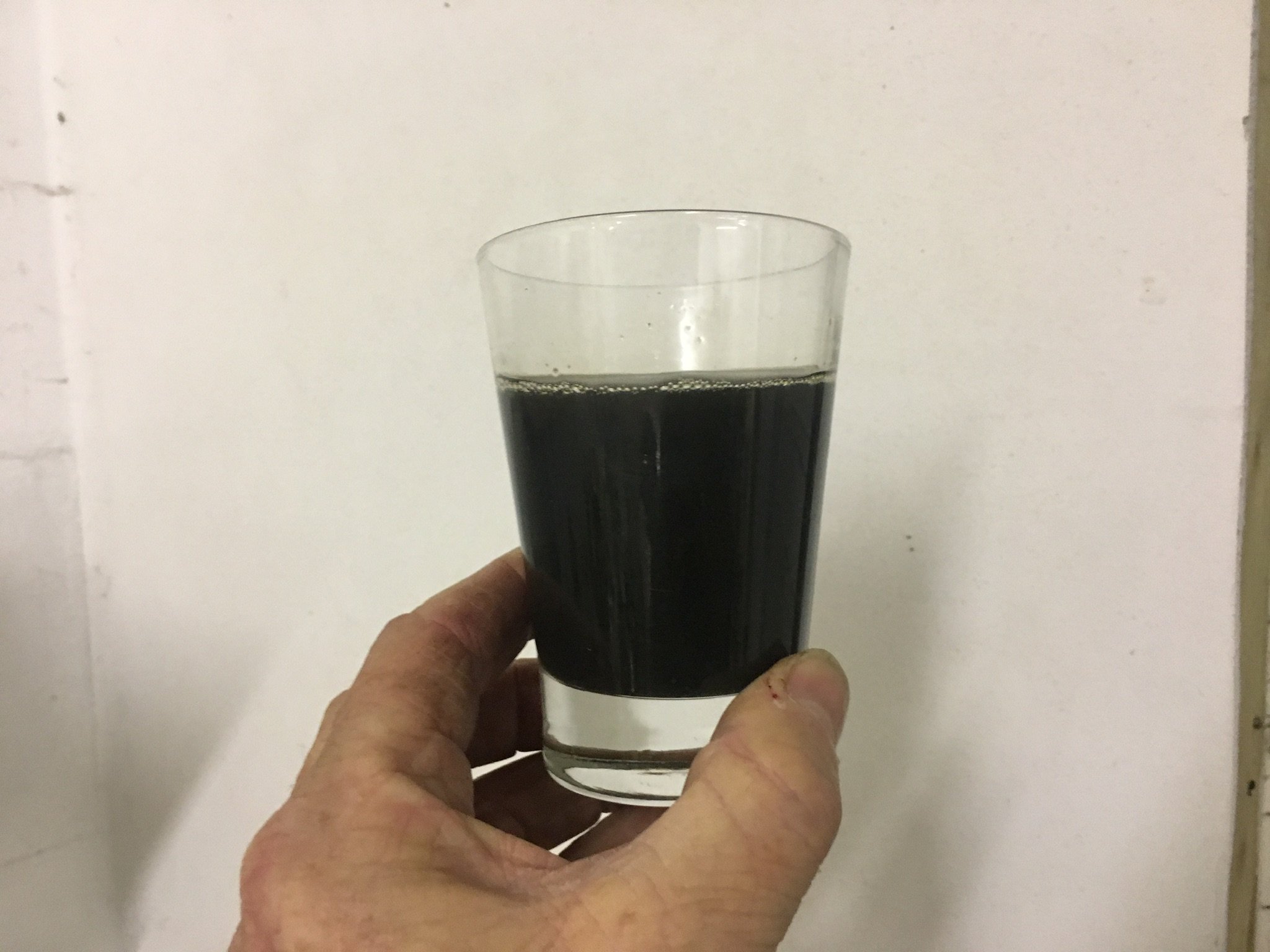

Drain plug was then removed and the majority of the oil flowed out. Well really, it glooped out in lumps. An amazing amount of gloop which presumably is fibrous material from the clutch. I collected a small proportion in a glass. Lovely and yummy!
And having poured the oil out quickly, these lumpy bits remained in the glass, just a tiny proportion of the total gloop:
No idea how the Haldex was still working with all that rubbish in it! So I think the moral is, don’t neglect Haldex servicing if your car is a keeper. Not difficult to do (access underneath being the main issue for an amateur without a lift), haldex fluid was expensive at £40 but not significant in the great scheme of things. If you take it to a dealer, they won’t take out the pump and clean the pump gauze. As always, if you want it done properly, do it yourself!

Just to finish off then, everything cleaned up and put back together after blowing some compressed air through the filler hole. Oil filled to overflowing. I then ran the procedure detailed in the link in my previous post to run the pump (it transpires that the engine has to be actually running for this to work) then topped up the oil again - it took quite a bit more since presumably the oil had filled the pump body. Filler bolt secured and that’s it, job done.
It will be interesting to see when I do it again in 20,000 miles or so, whether there is the same amount of black gloop in the oil.
