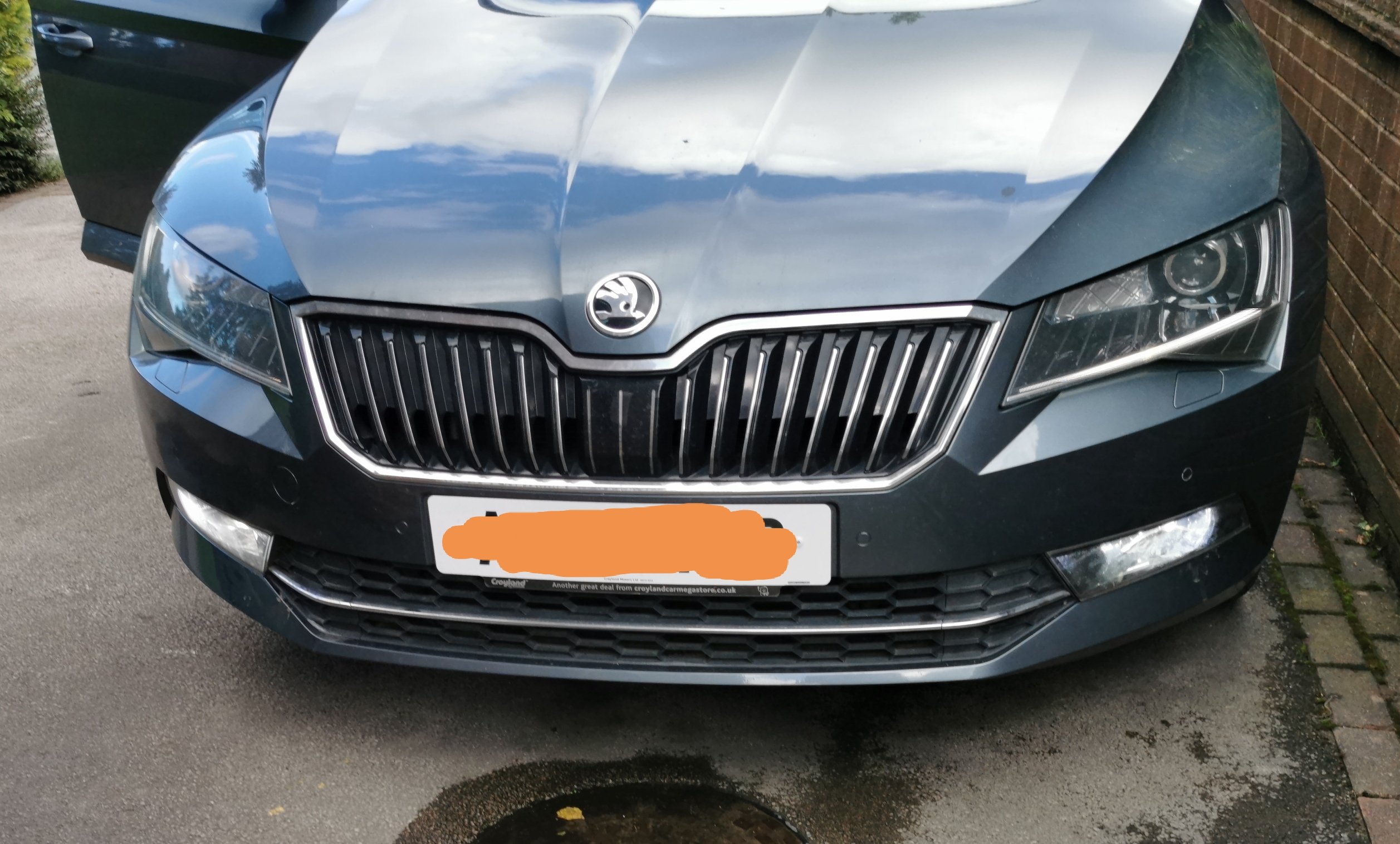

Got rid of the yellow fogs today,and changed air and fuel filters. Also fitted some new Uniroyal rainsports all round. Oh,and some new Bosch wipers front and back too 😀

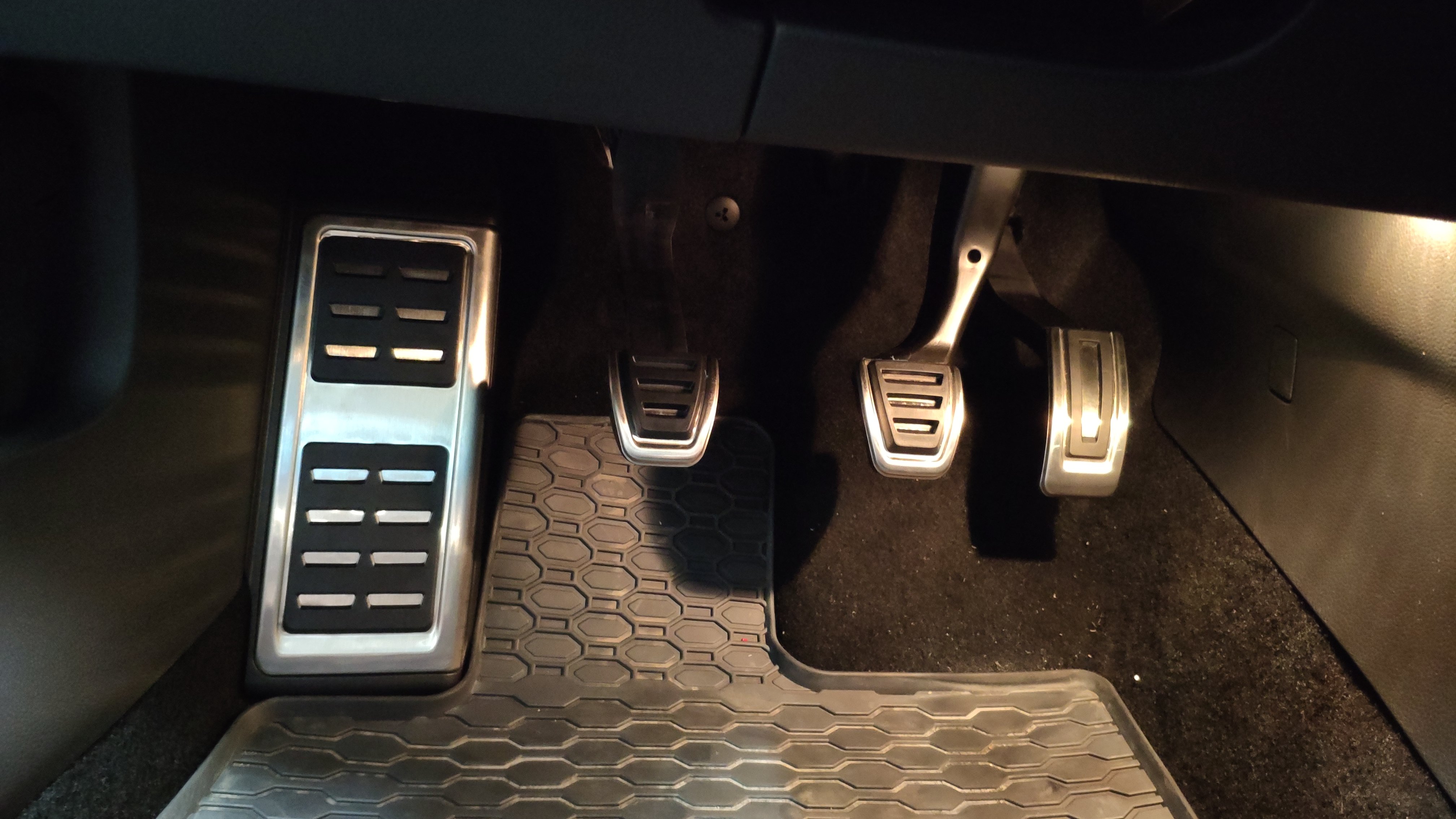

This week I swapped the pedal and footrest covers with stainless steel/rubber ones (a tenner on AliExpress!), the door courtesy light with an led projector (though I may swap with one that projects the logo) and started swapping interior lighting with led. Will continue on with boot lights, rear footwell led lights (all standard white) and rear led turn signals.

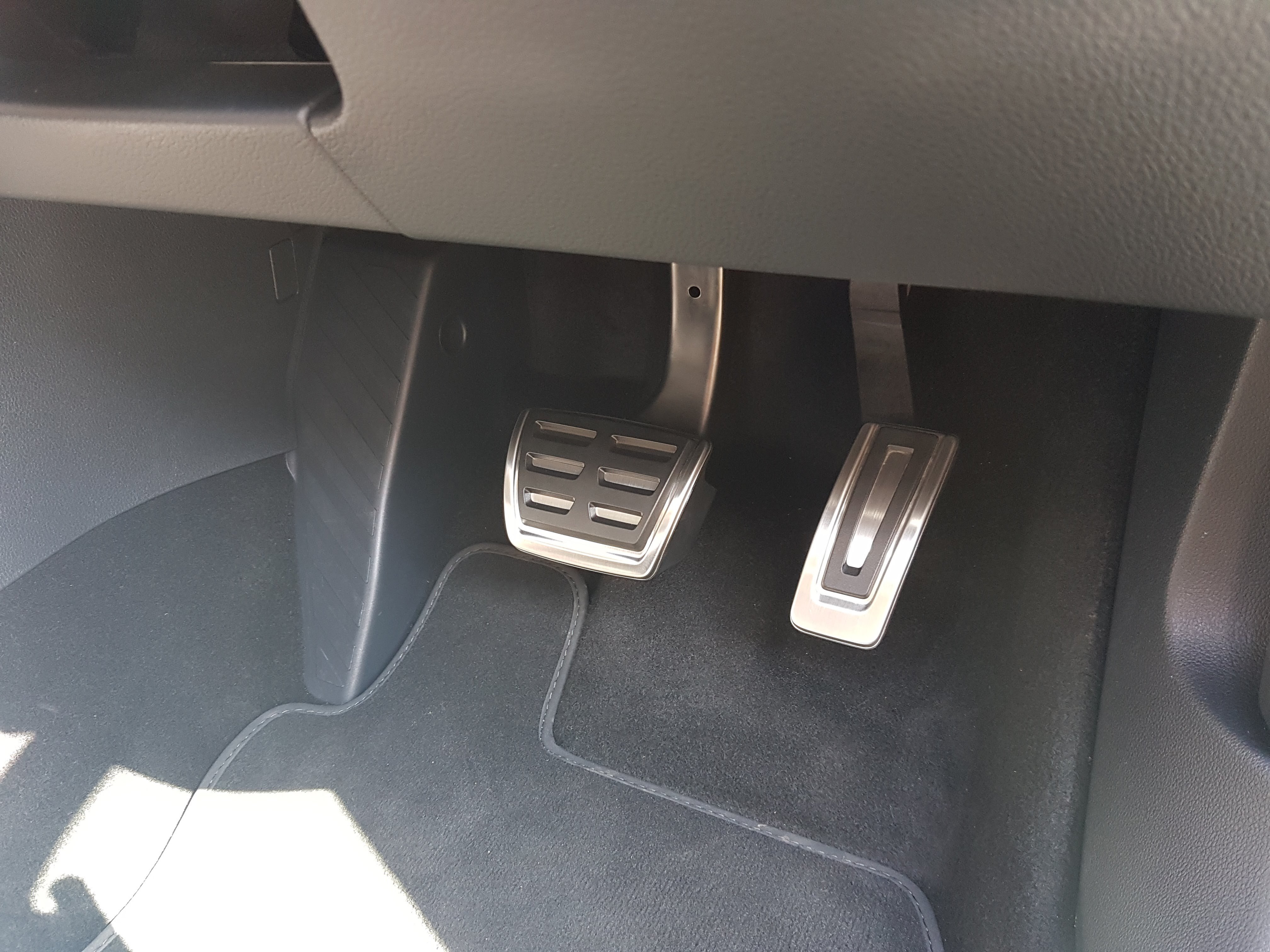

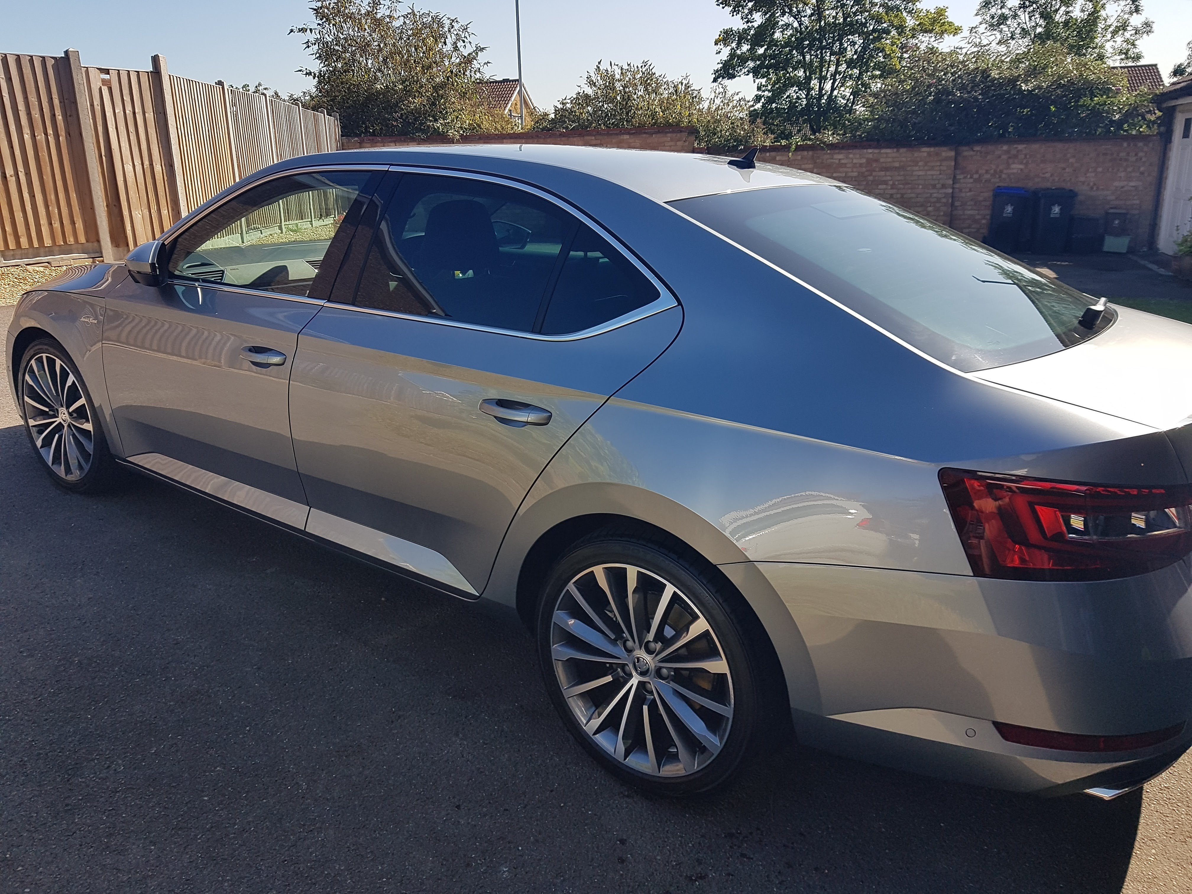

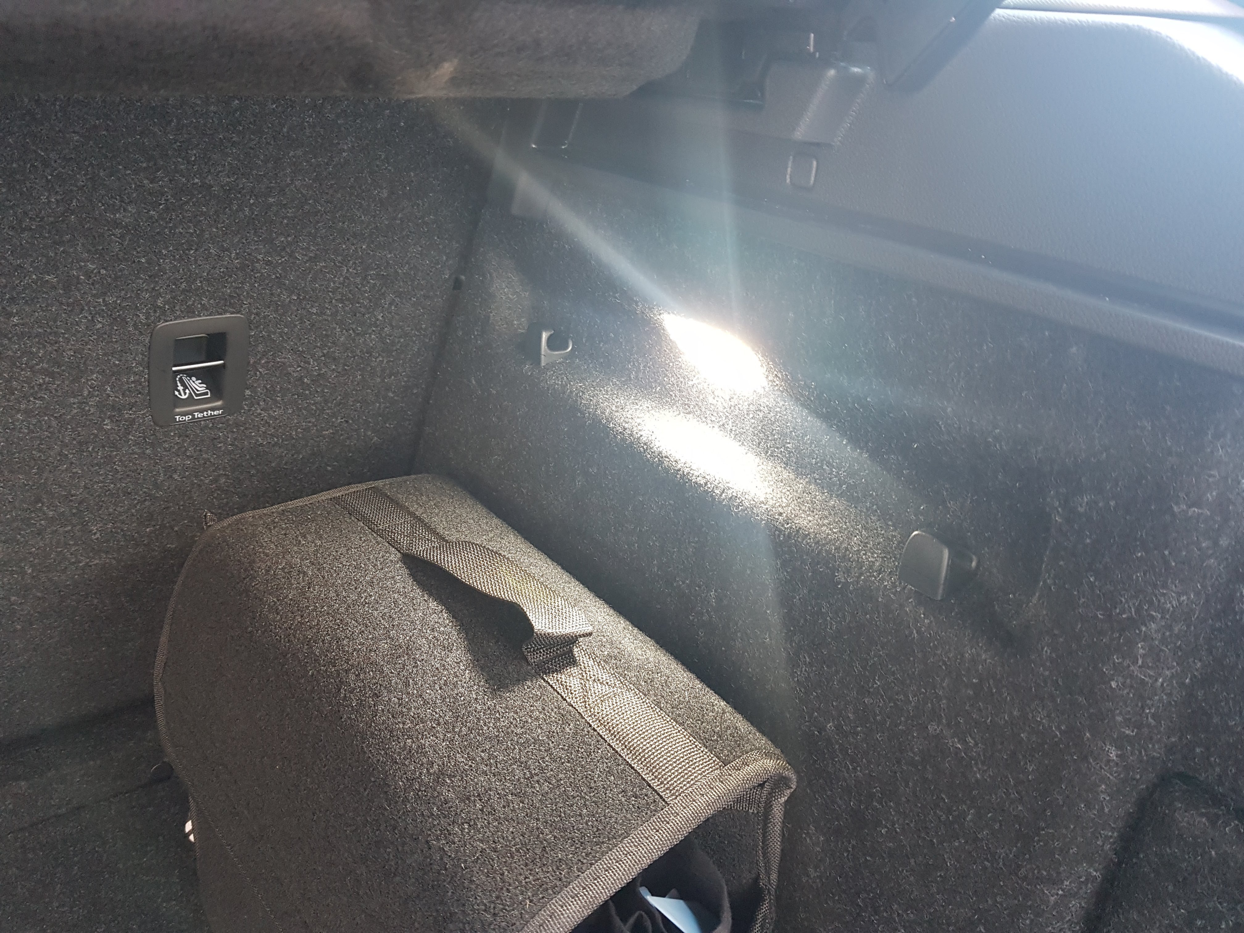

On 21/09/2019 at 16:46, AidanF said:
Fitted pedal covers and LED boot lights from Superskoda.
Boot lights were a straight swap out, no modifications needed and make a huge difference over the originals.
Can actually find things in the boot at night now 😁
Brake pedal cover was an easy fit, accelerator a bit more tricky, but softened in boiling water it went on without too much trouble.
Then gave it a good wash and mini detail 😎
Jus a heads up for those changing pedal covers. The gas pedal is unnecessarilly tricky/hard but I found a REALLY easy way to do it. Just glue some strong tape under the lip of one of the long edges, fit the other side and when pushing the tapped side down pull on the tape to lift the lip open and it will slide right in. Then yank the tape out if it didn't come off already. Took me 10 s this way.
Also had a minor battle with my gas pedal. Left it in boiling water to soften the rubber, slid on the top right, then right side, then just pushed hard down and the other side and it popped on easily.
Yeah, I saw that. That's why I decided to share my method. I fought with it several times over several days 👿 then had this idea and it worked right away.
