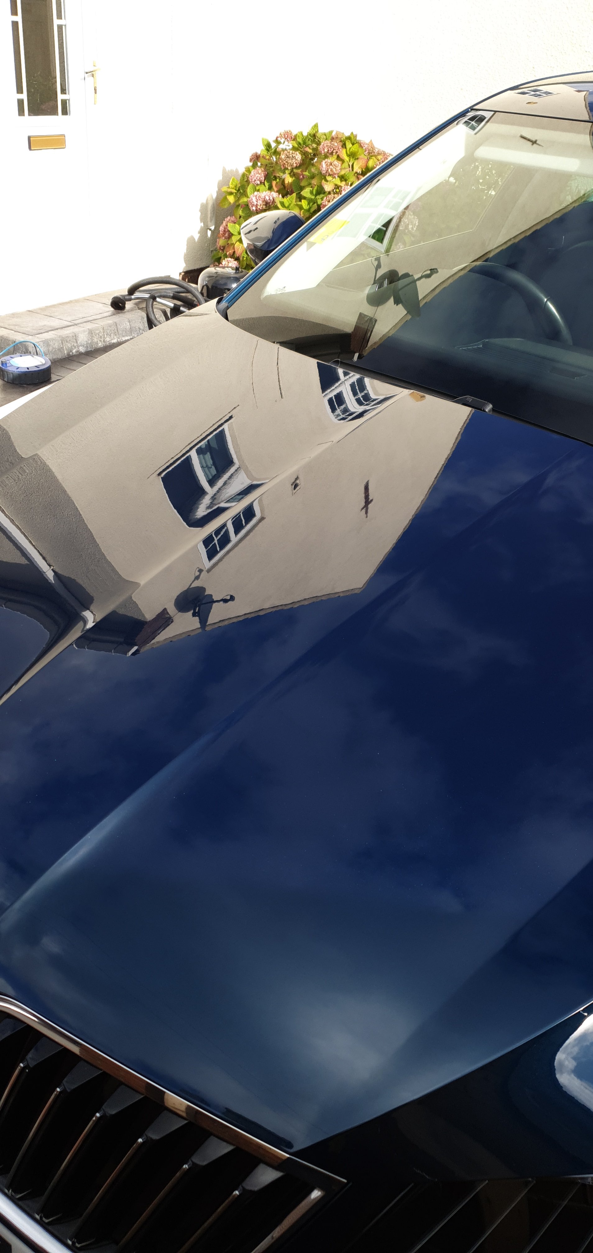

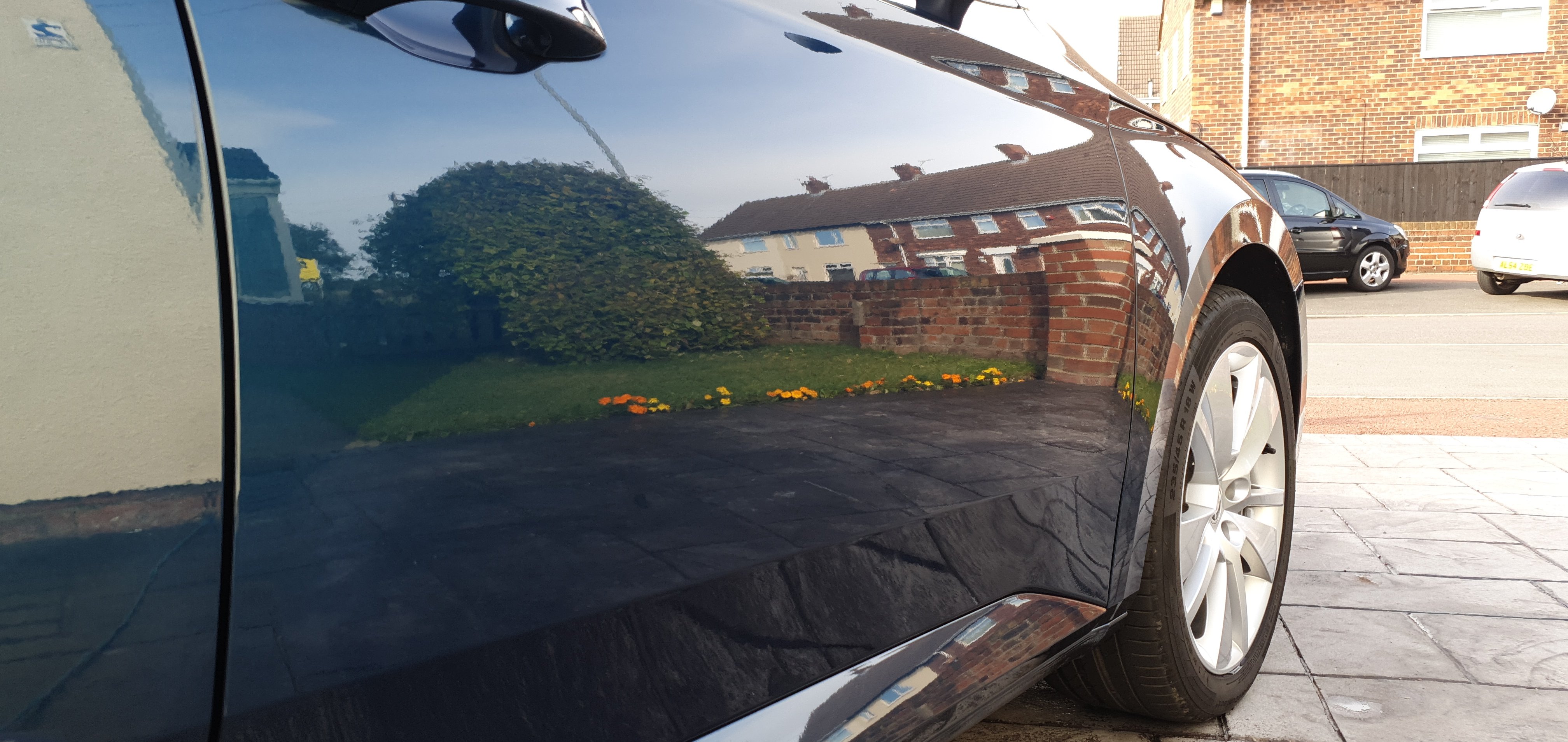

Over the last couple days, I've been cleaning, polishing and waxing the new motor. Time constraints mean I couldn't do it all in one day.  Came up looking so much better though, really got the metallic 'pop' come up nicely. Also manged to reduce a few of the more noticeable marks on the paint.
Washed, tardis, iron x, clay, menzena polish on the rough bits, then Primo Finish to enhance it. Waxed with definitewax's Blueprint. Then tires, glad and interior tided up.  Found a few bitts that need more work, but very happy with the results for now.

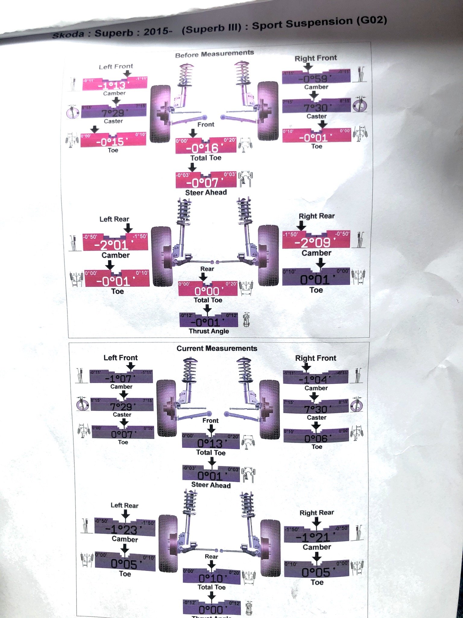

Little suspension tweak today. Needed it 92A75B2F-8E1A-4F39-BE9D-A800CC61B2F0.thumb.jpeg.6d90bcbc51f95d932915cf9f4652da6e.jpeg0C174013-0793-45FA-B168-64764256E4FE.thumb.jpeg.8d74bc2417d3523b28f7755606287987.jpeg

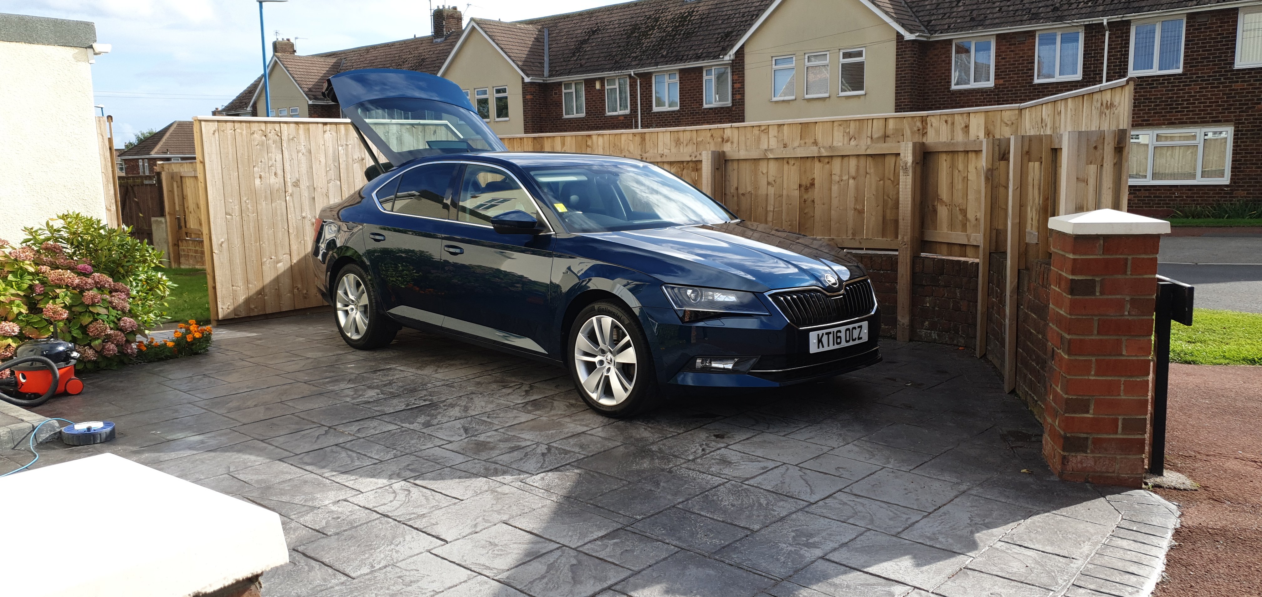

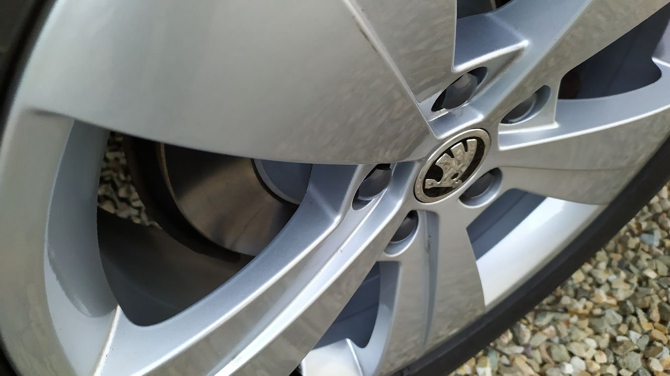

A good clean today, followed by removing the offside rear wheel arch liner and adding more sound insulation left over from a previous job. While the wheel was off gave it a good clean and de-tar on the inside of the rim.

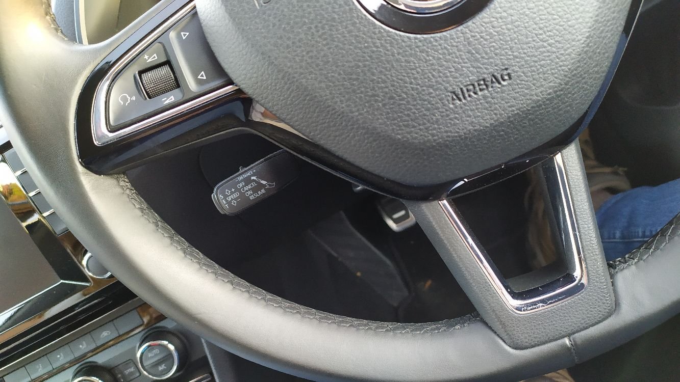

Took care of a slightly shiny steering wheel with a Magic Sponge. Amazing, looks like new, nice and matt. Three or four light passes with a moist sponge, don't be too aggressive as they are quite abrasive.
