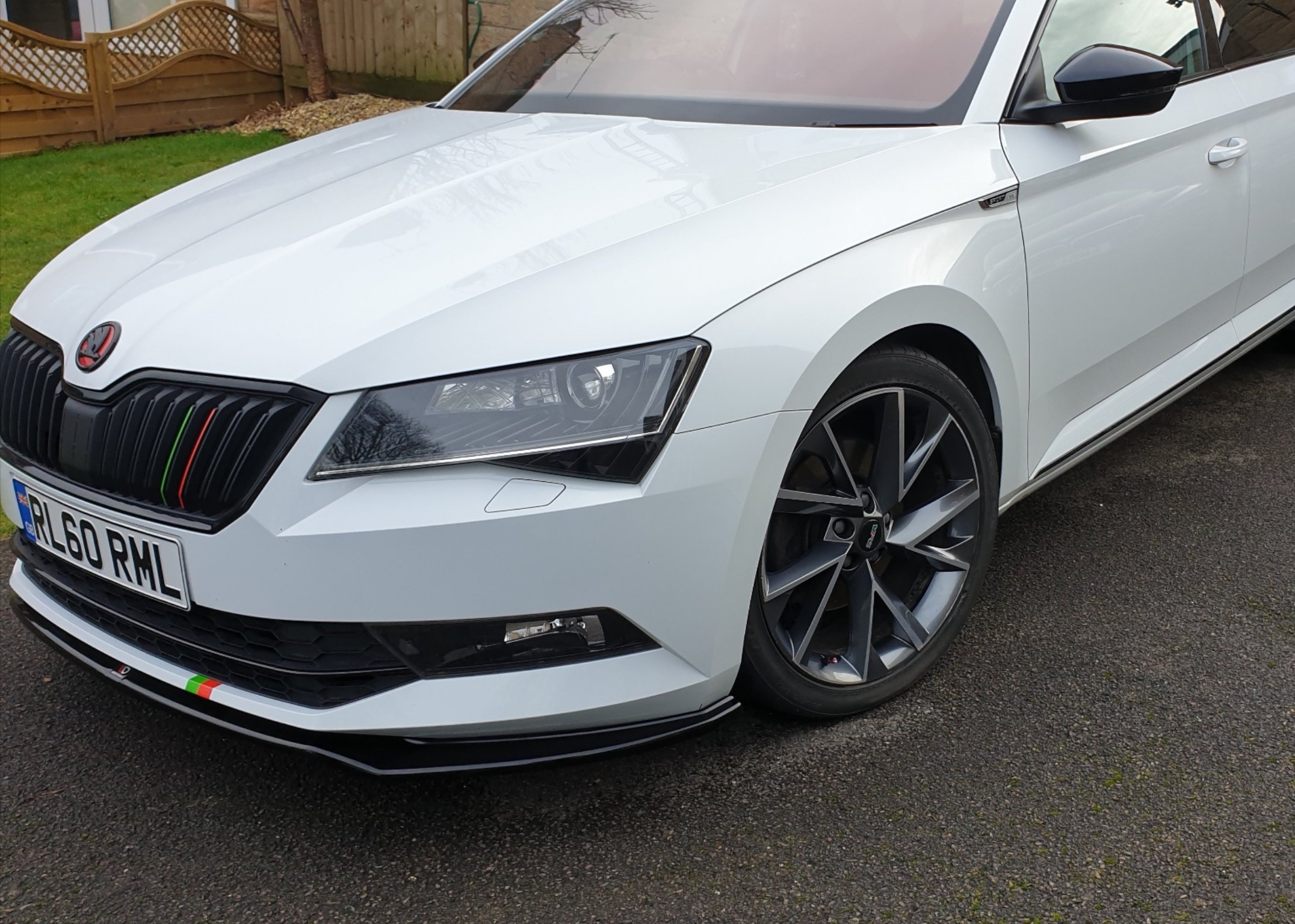

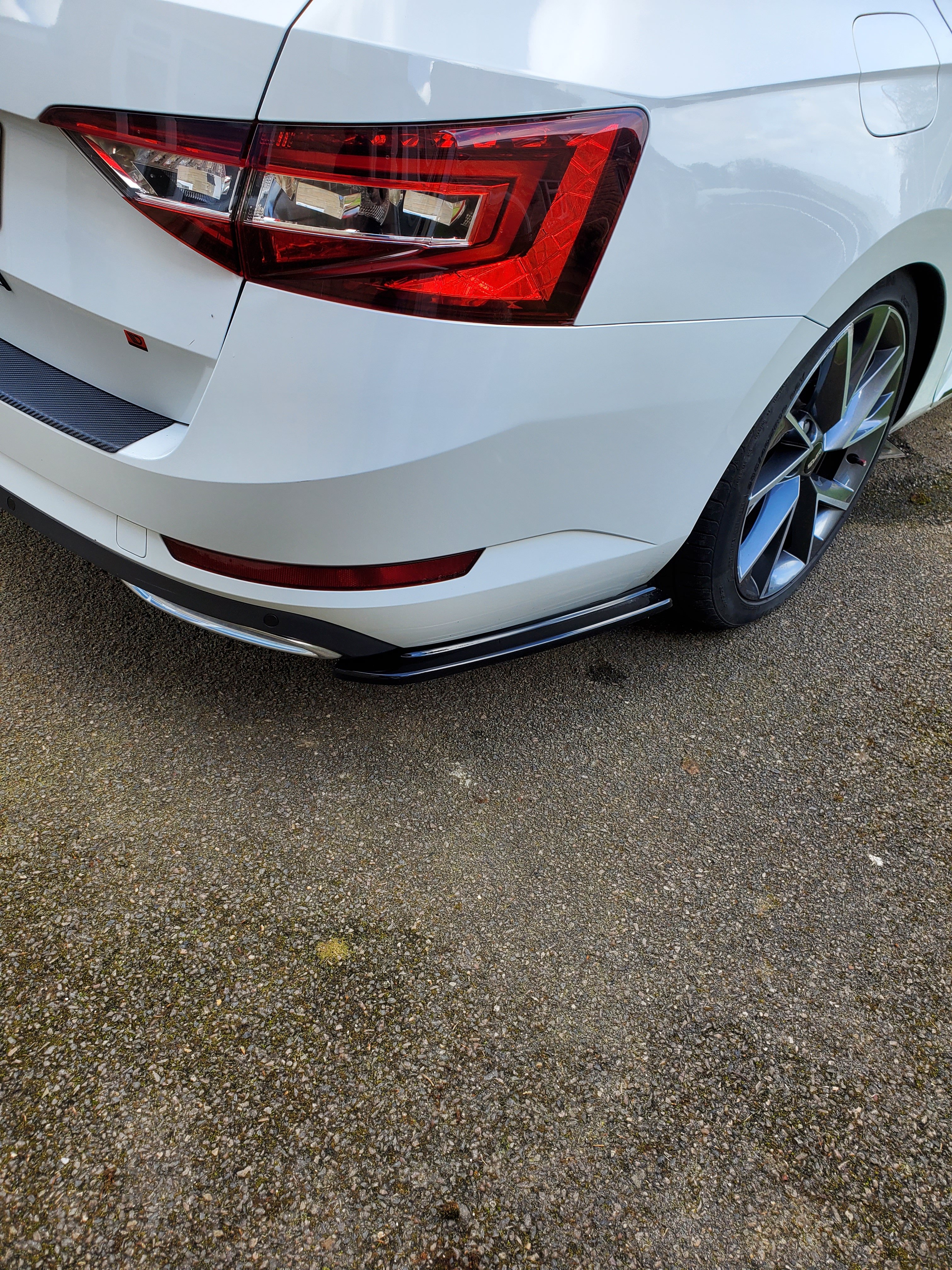

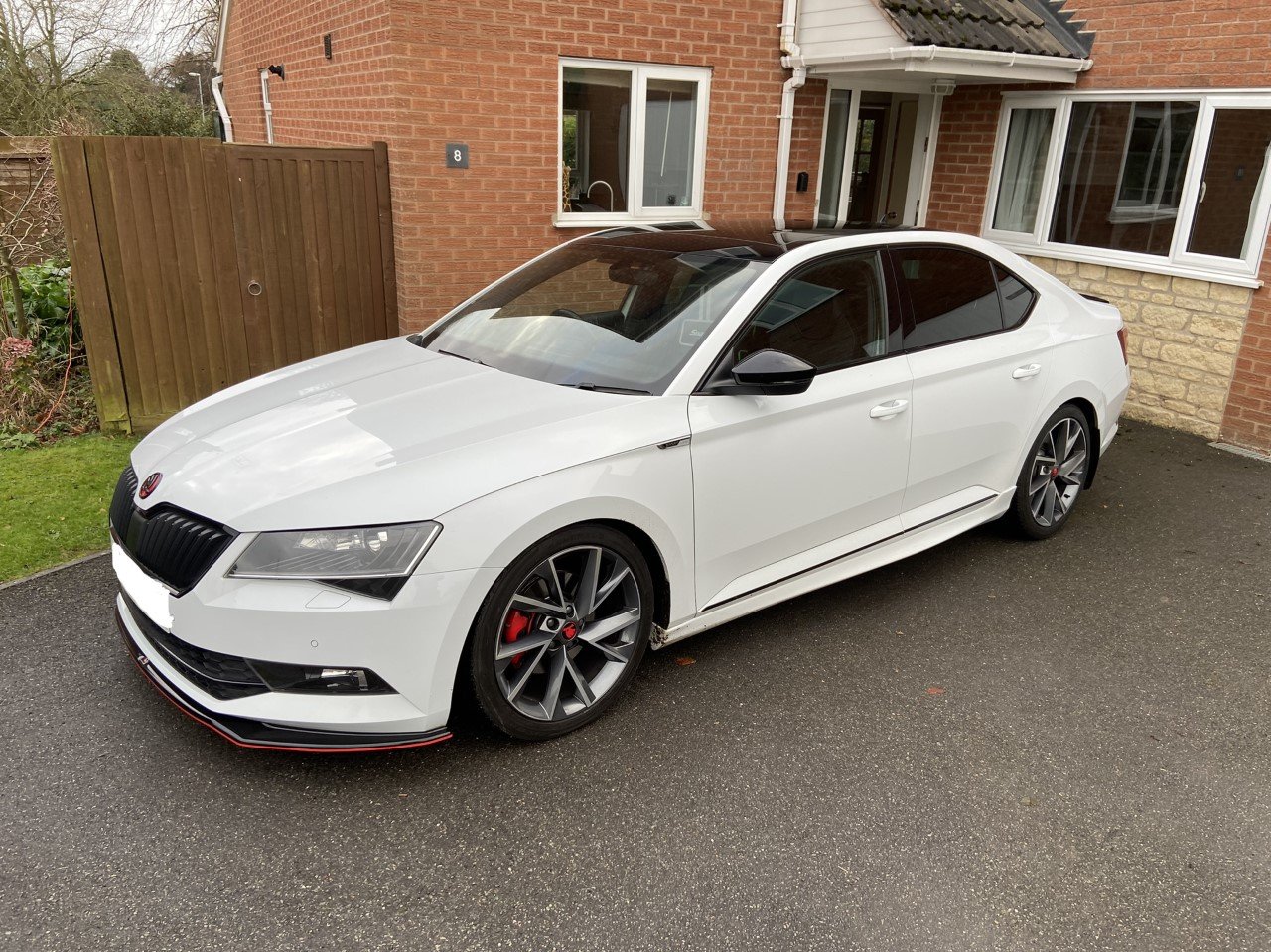

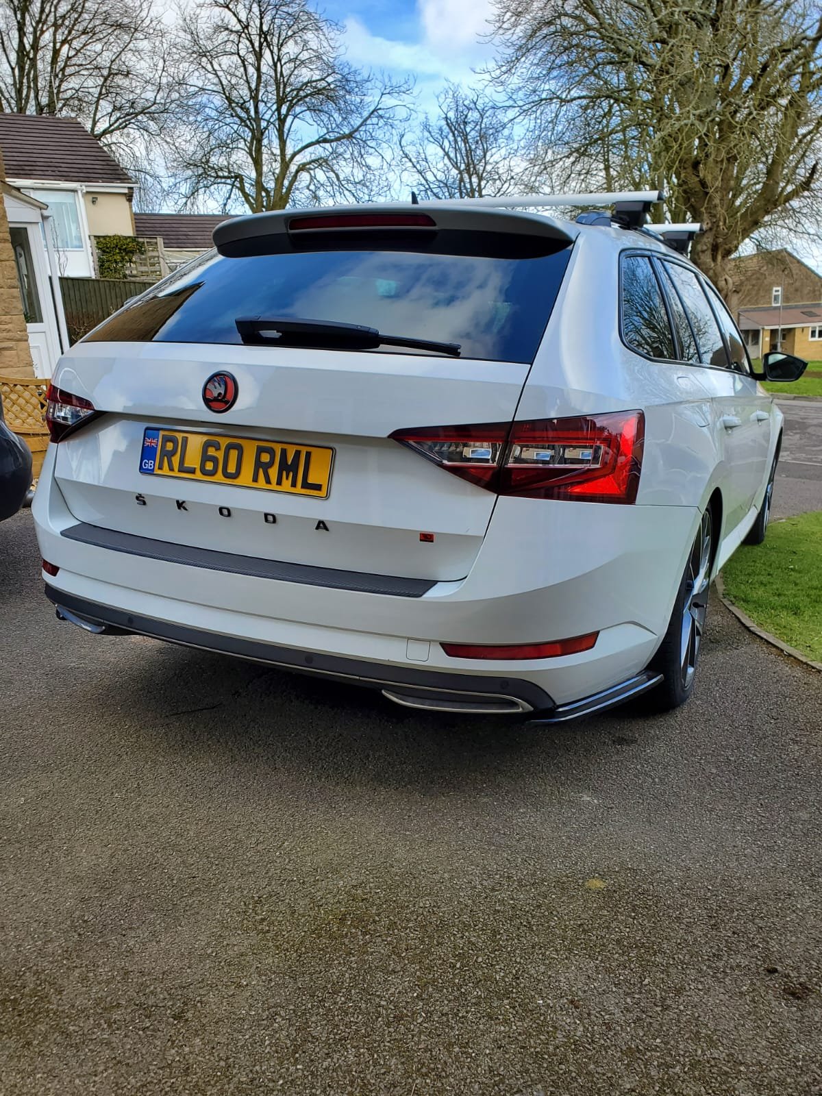

Re badged the rear and fitted Maxton skirts

U need the matching side skirts now....
Oooooh!! like that. Any more pics?? Have you got the full sideskirts and splitter too?
Thank you. Yes front splitter done, and sidekicks and red calipers will finish it off.
Ah yes! I remember this car now!! Which skirts are you going for??
Not sure, not that keen on the Maxton ones, even though the rest is Maxton! ?!
Rieger!!
9 hours ago, dohboy78 said:
Rieger!!
+1 for Rieger

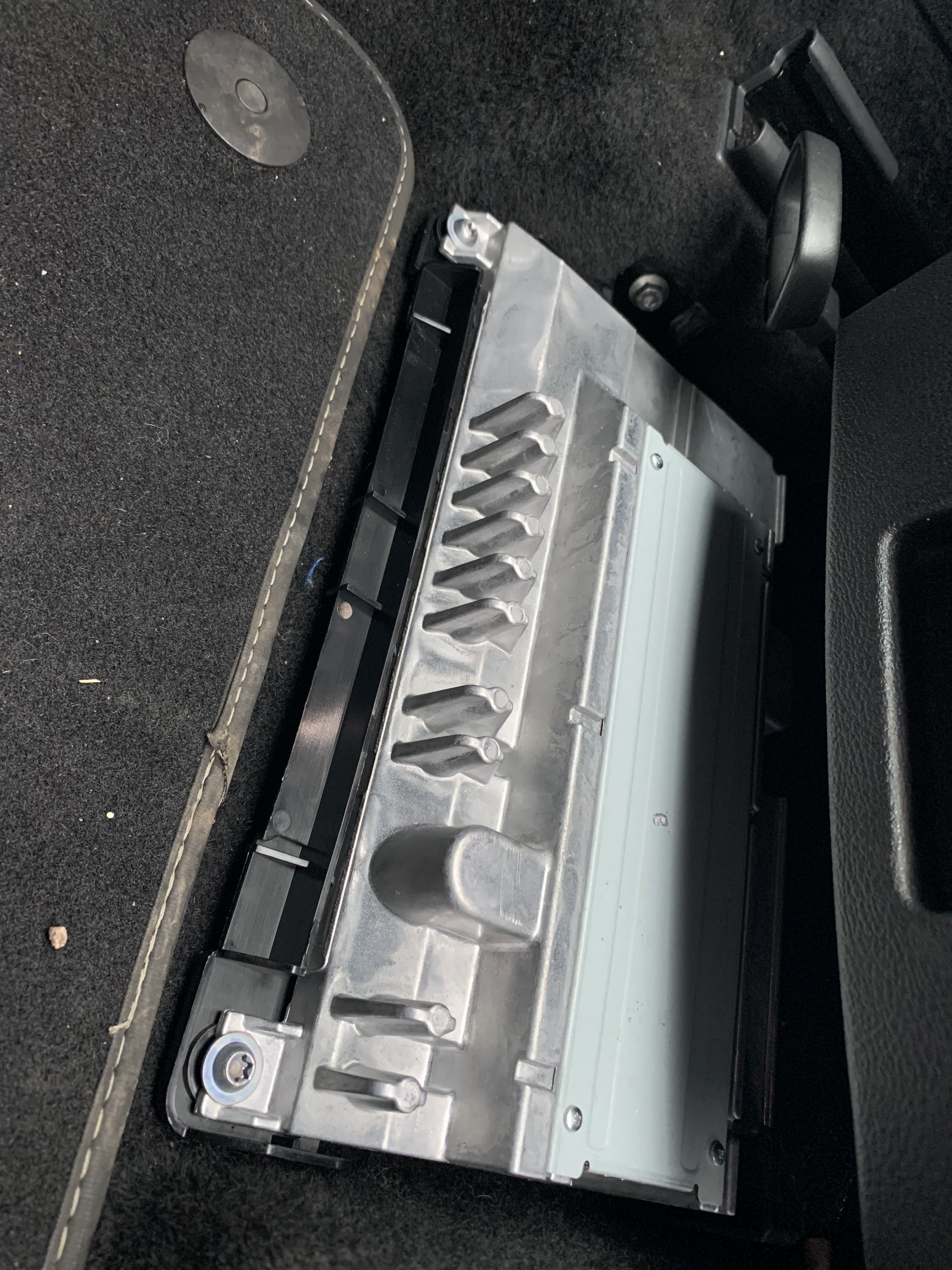

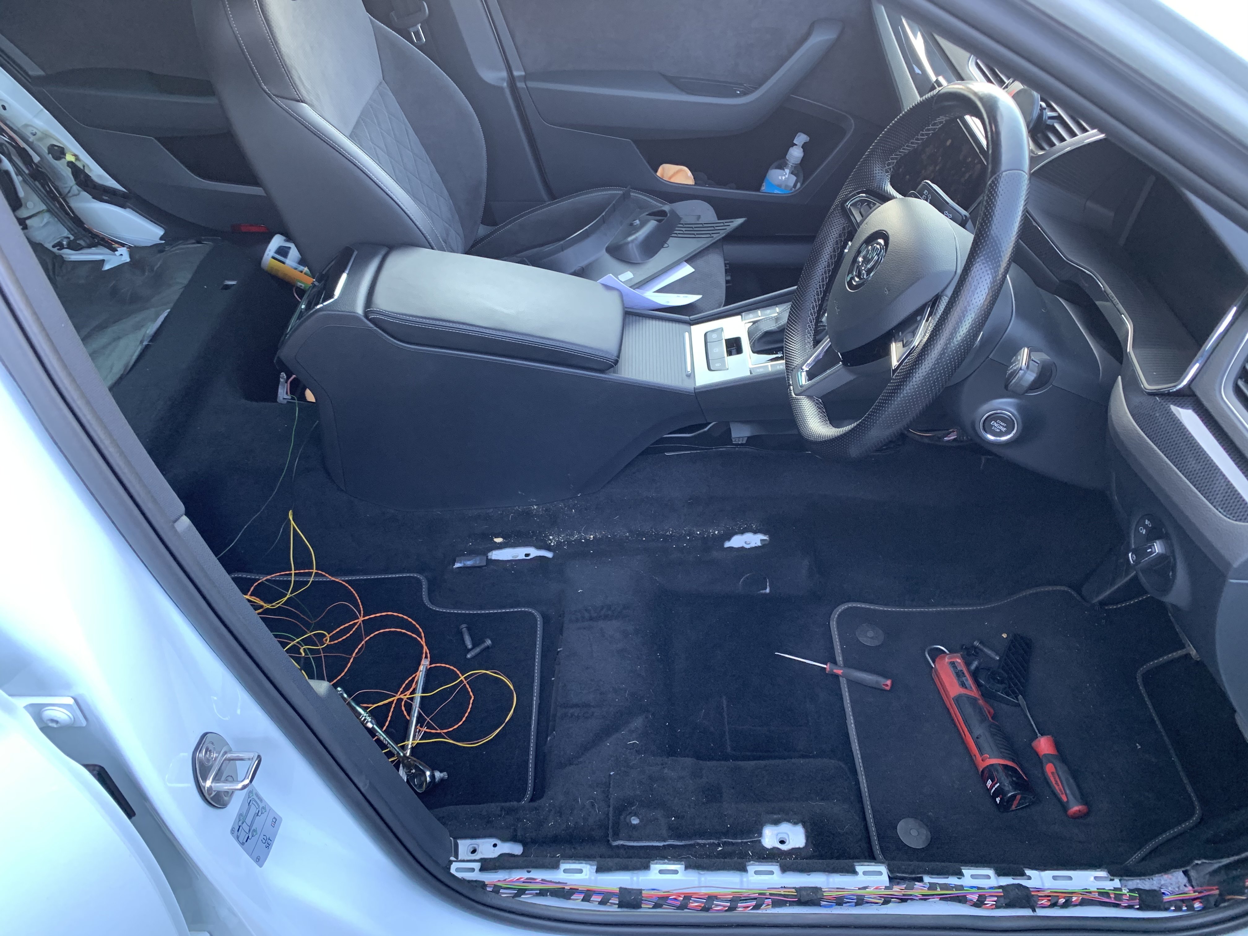

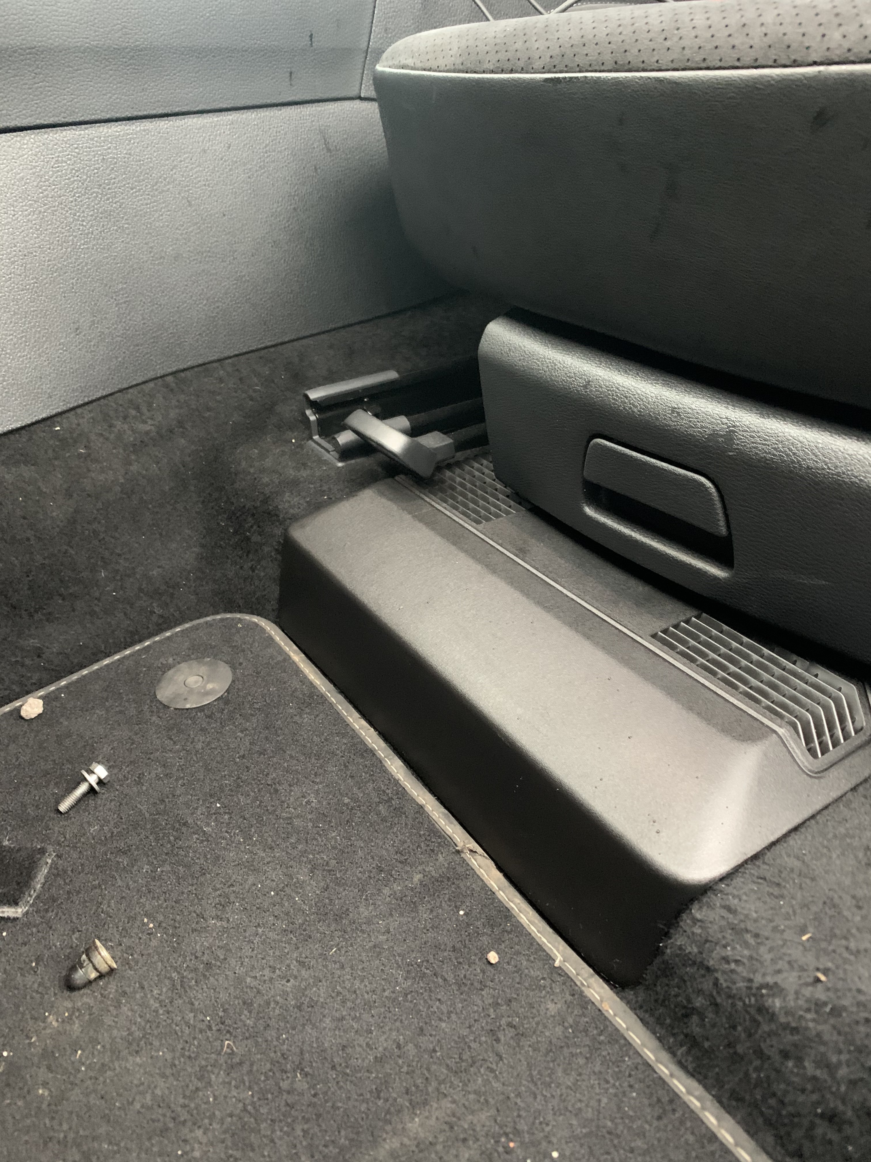

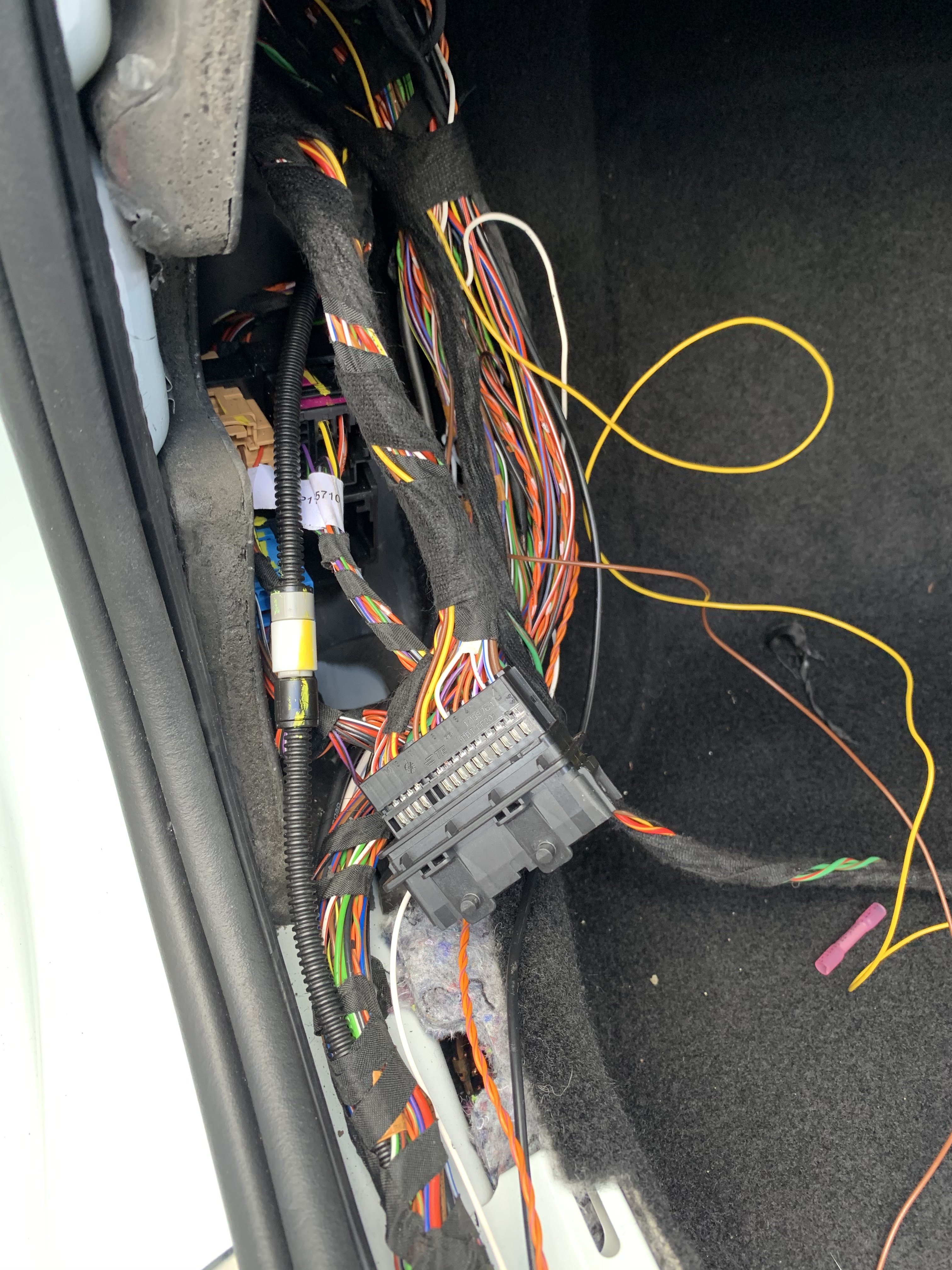

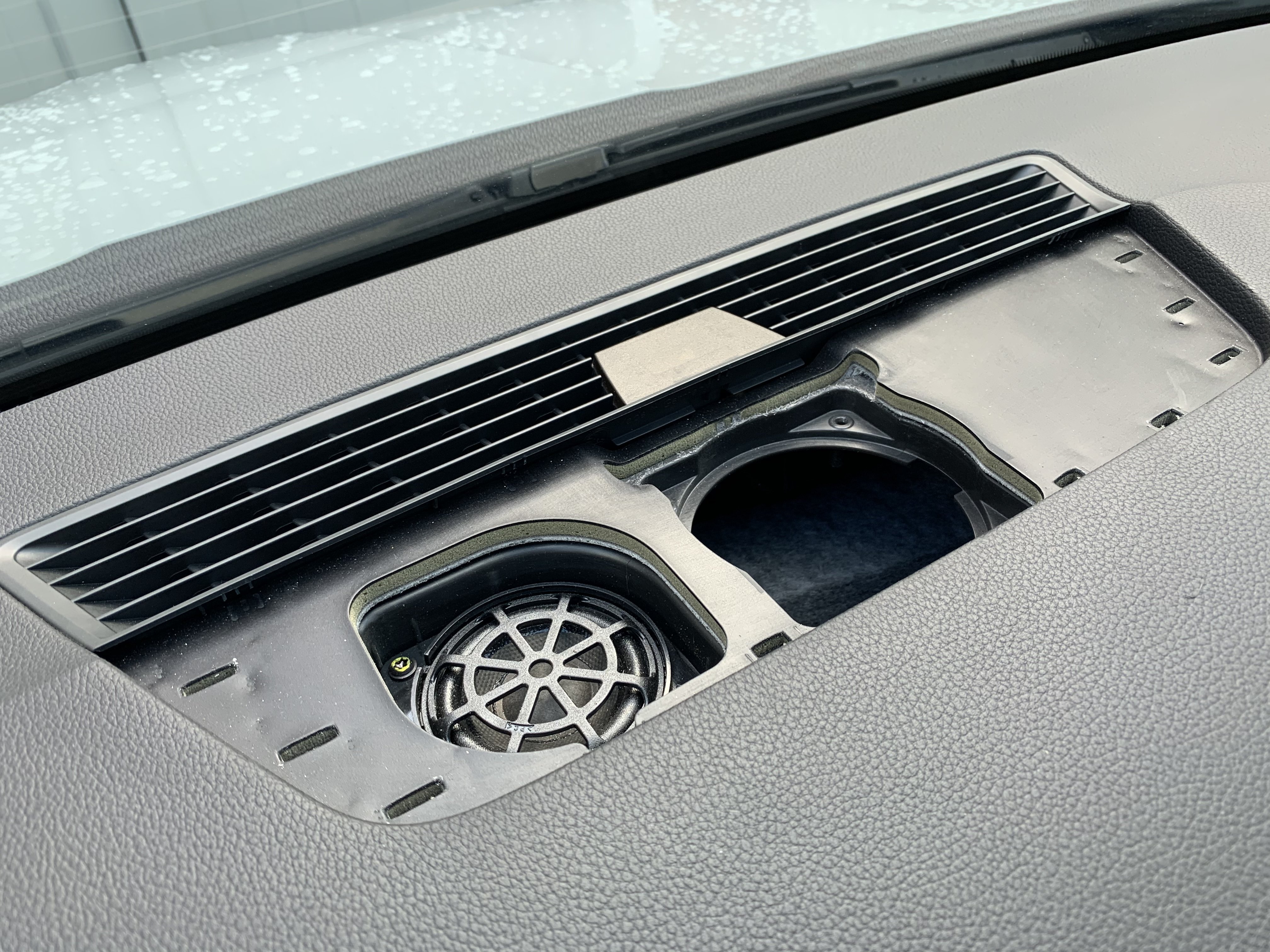

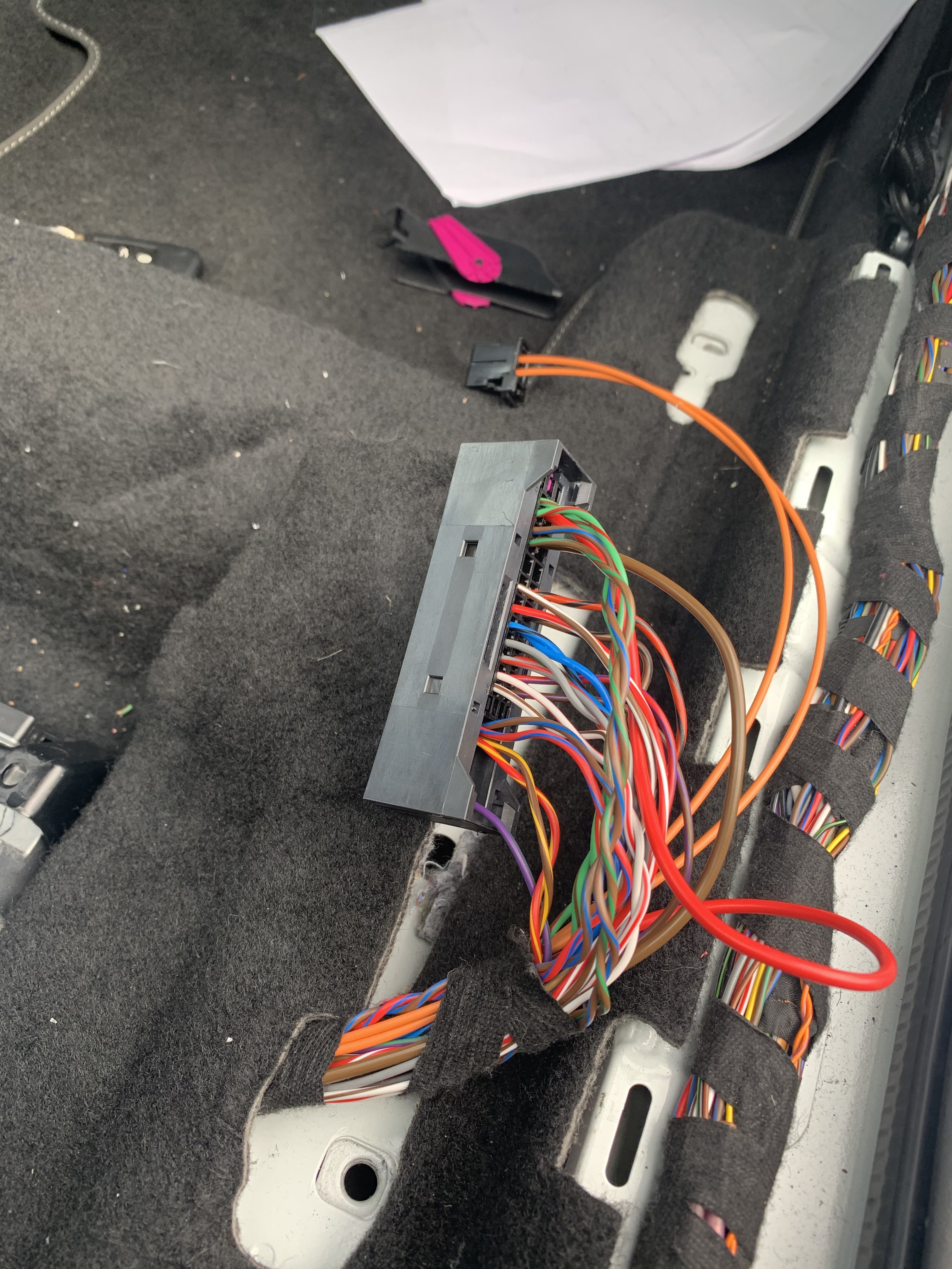

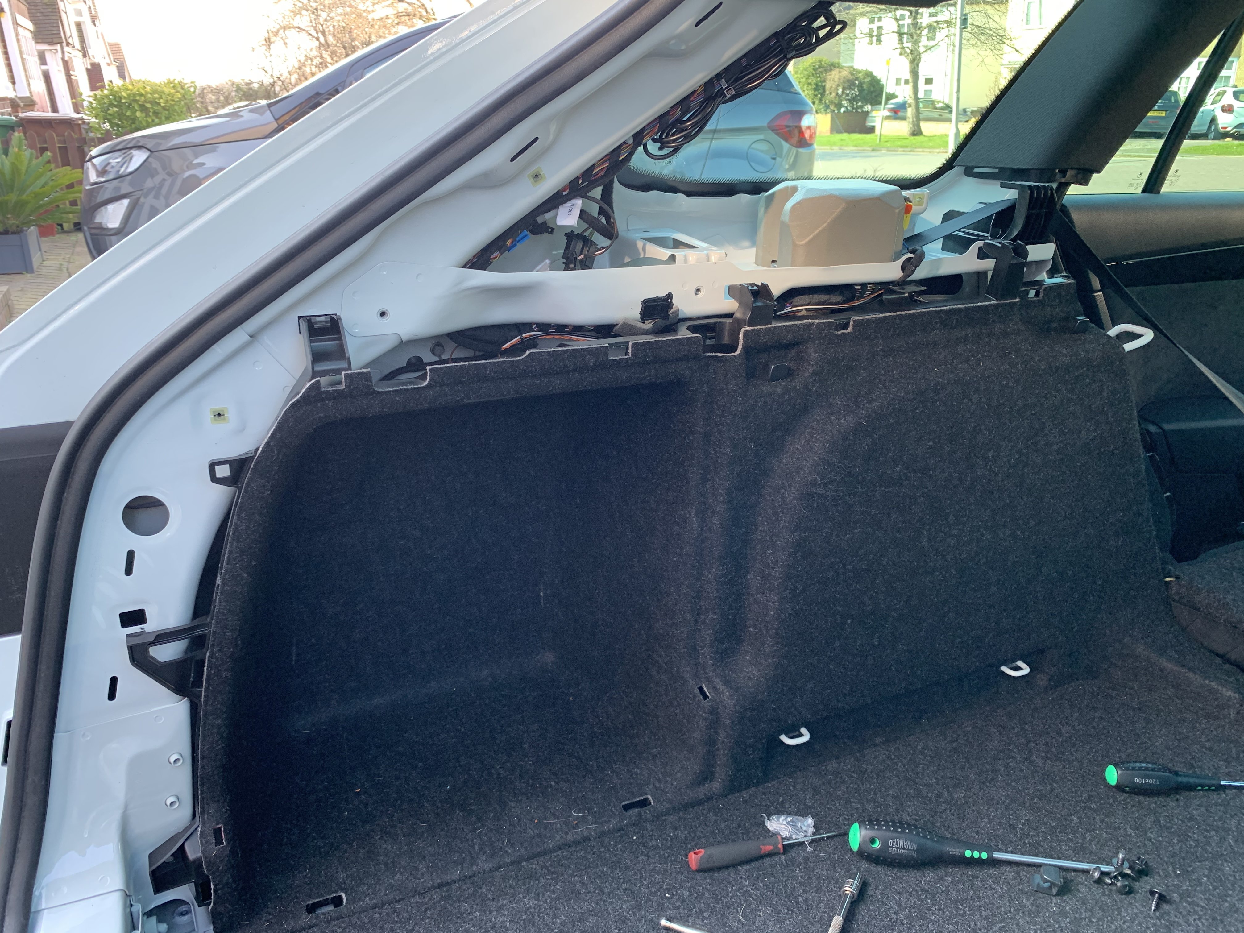

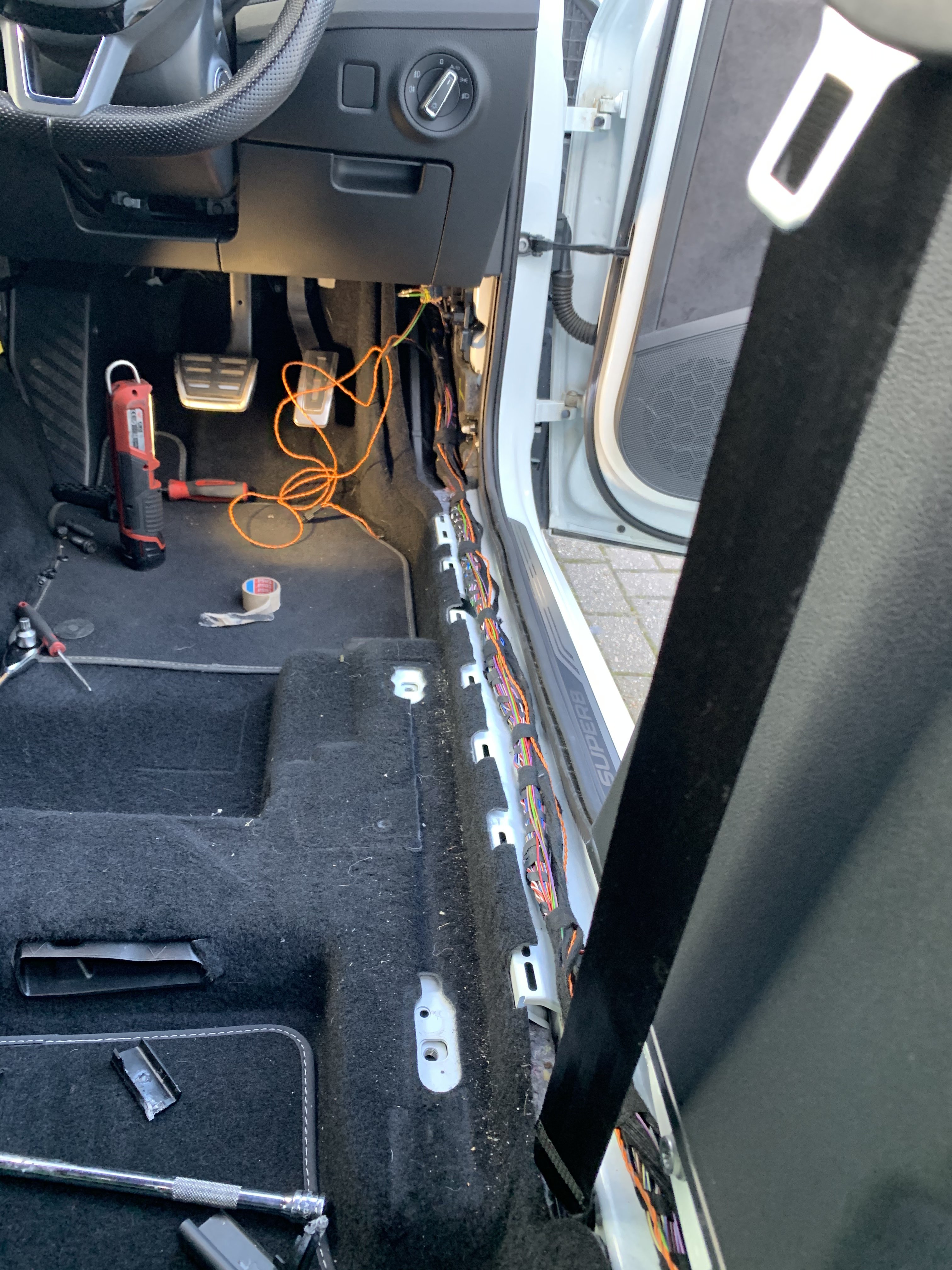

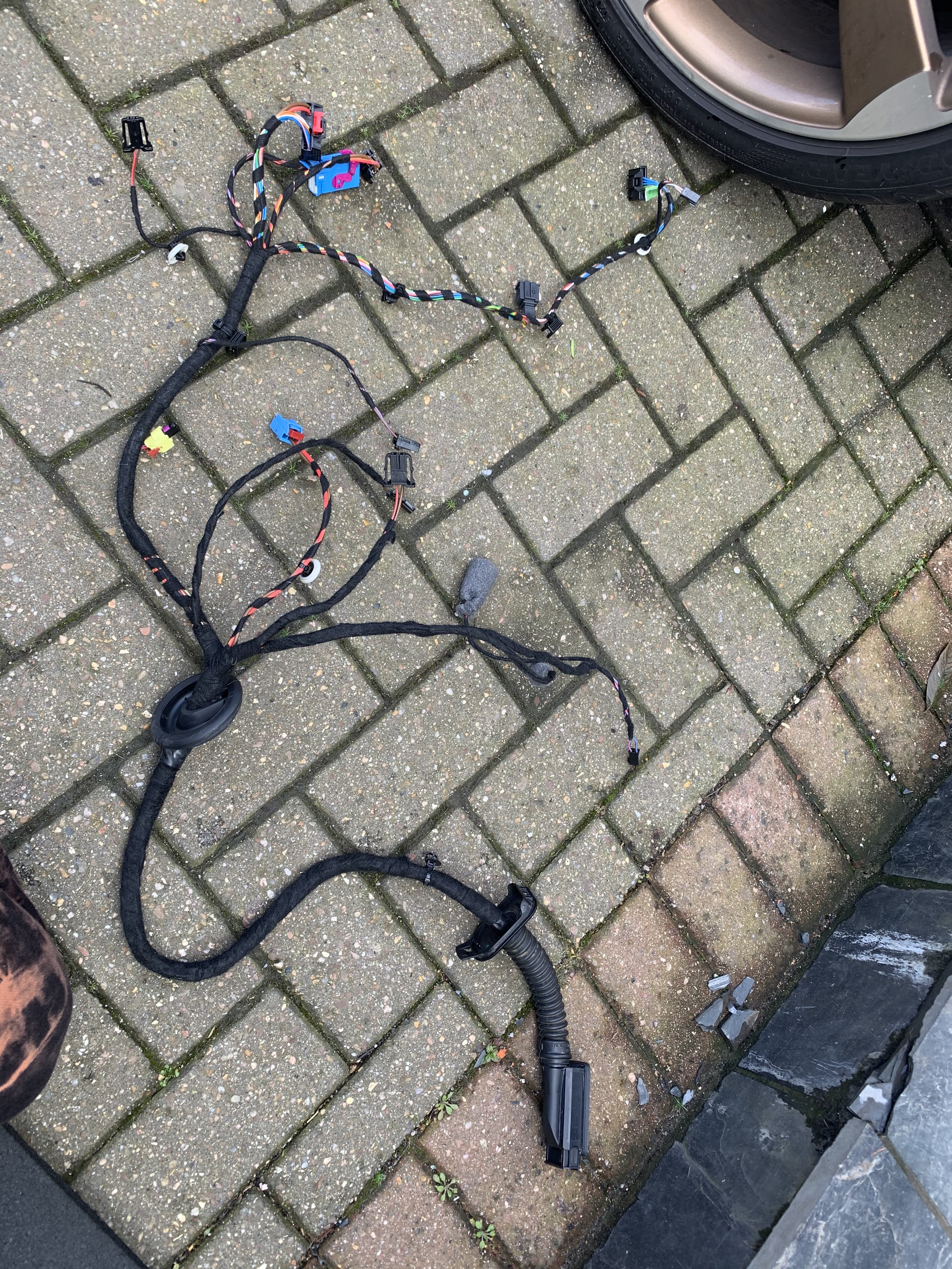

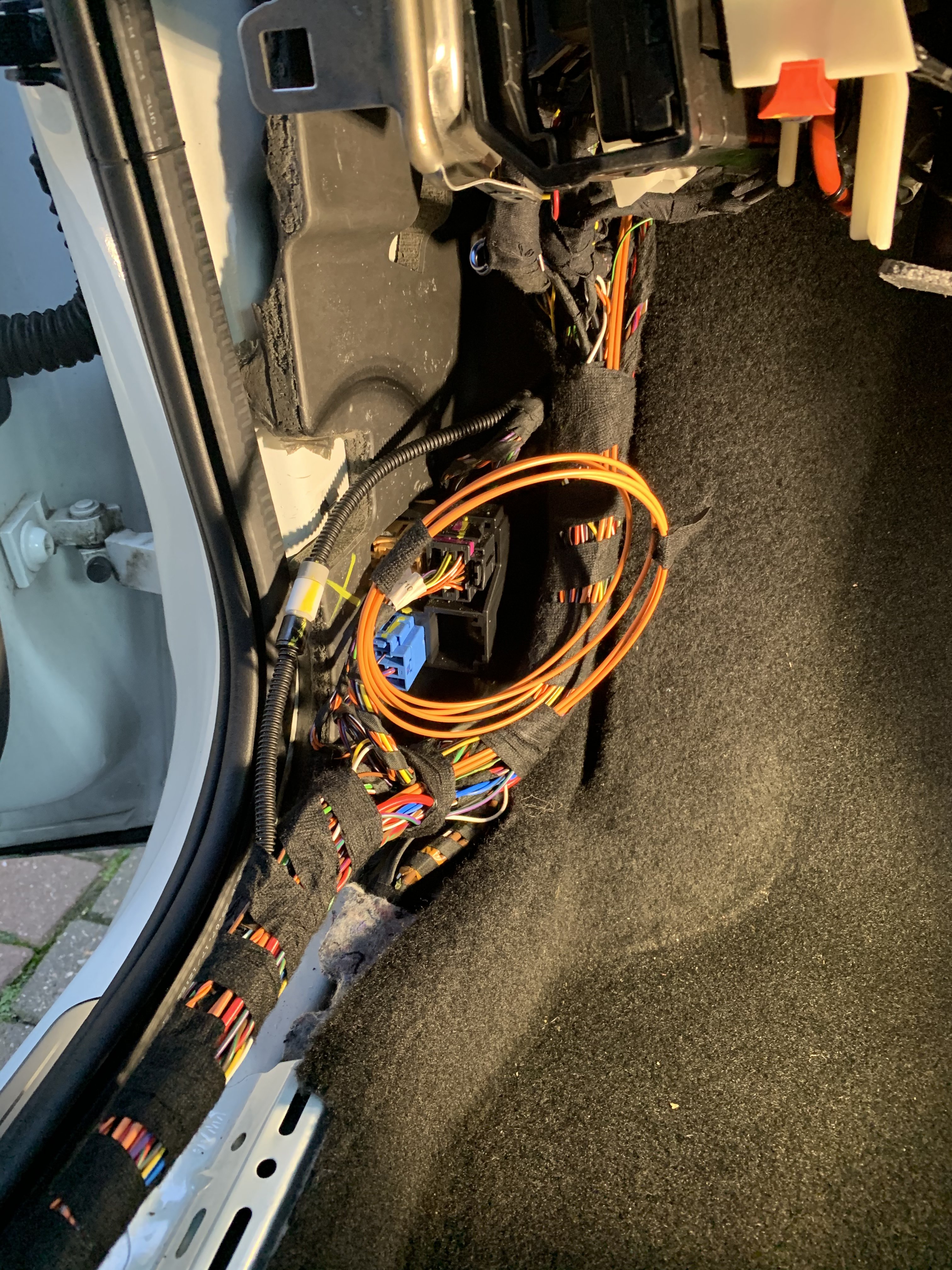

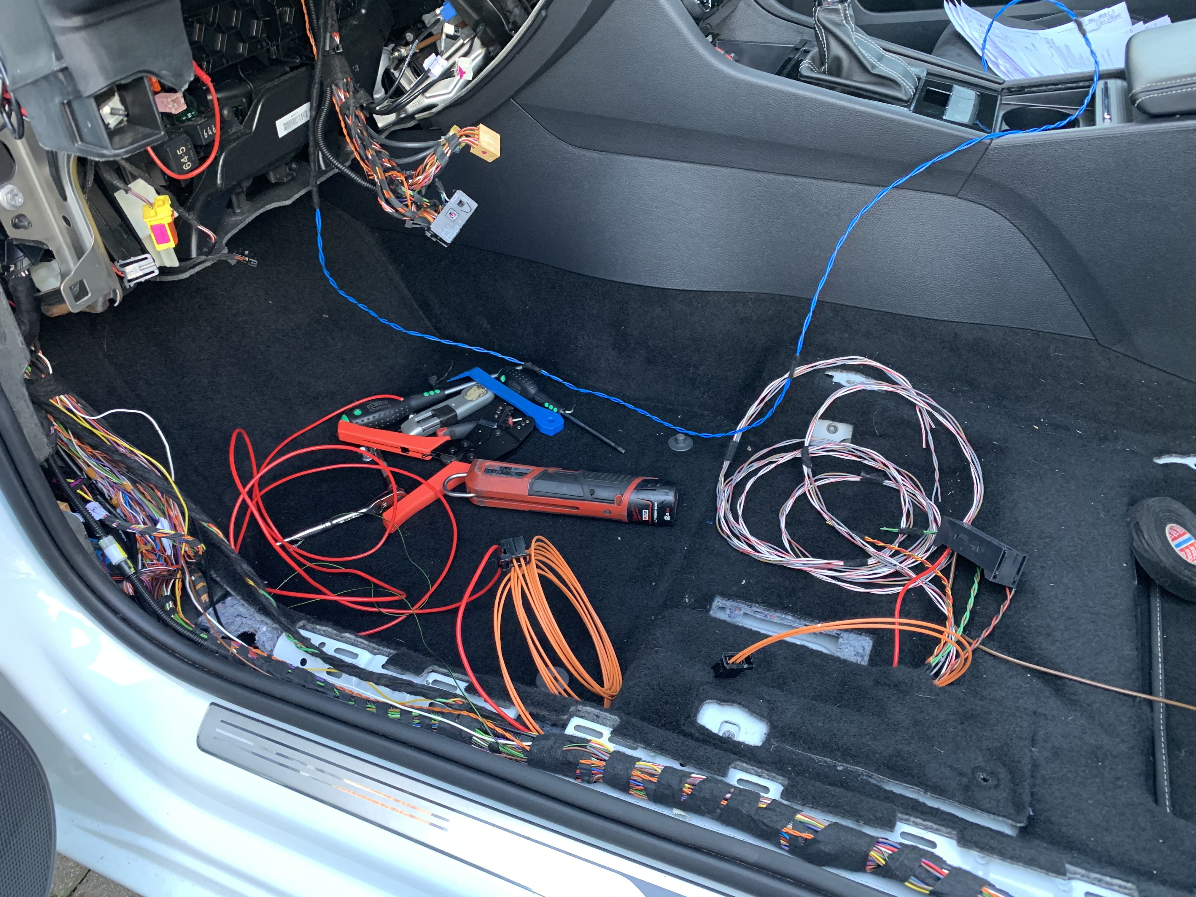

Some more content from the Canton retrofit, this wind and rain is hampering efforts.
Subwoofer fitted and wiring ran for the subwoofer and offside door wiring.
also ran my blind spot assist wiring whilst I was here

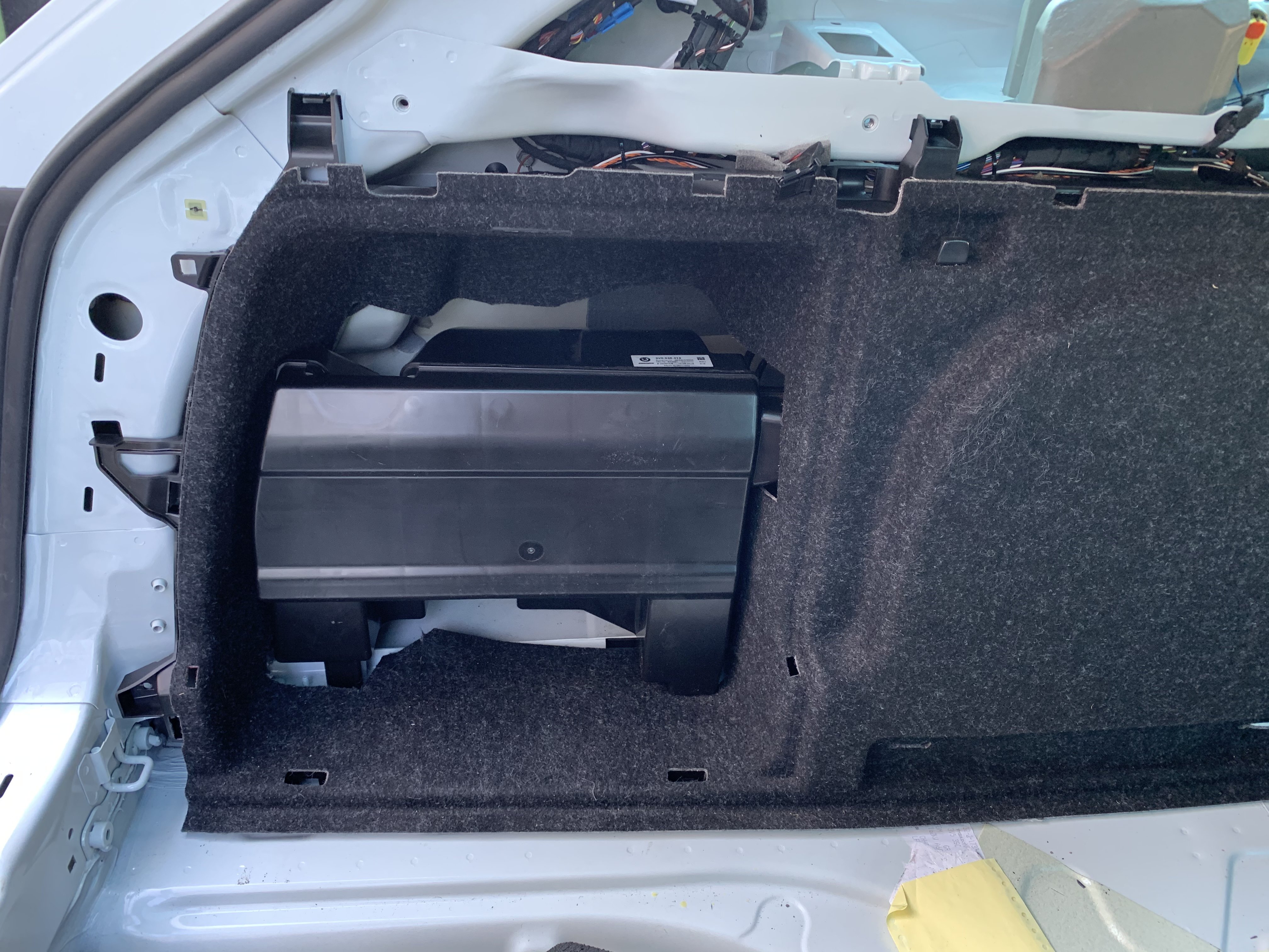

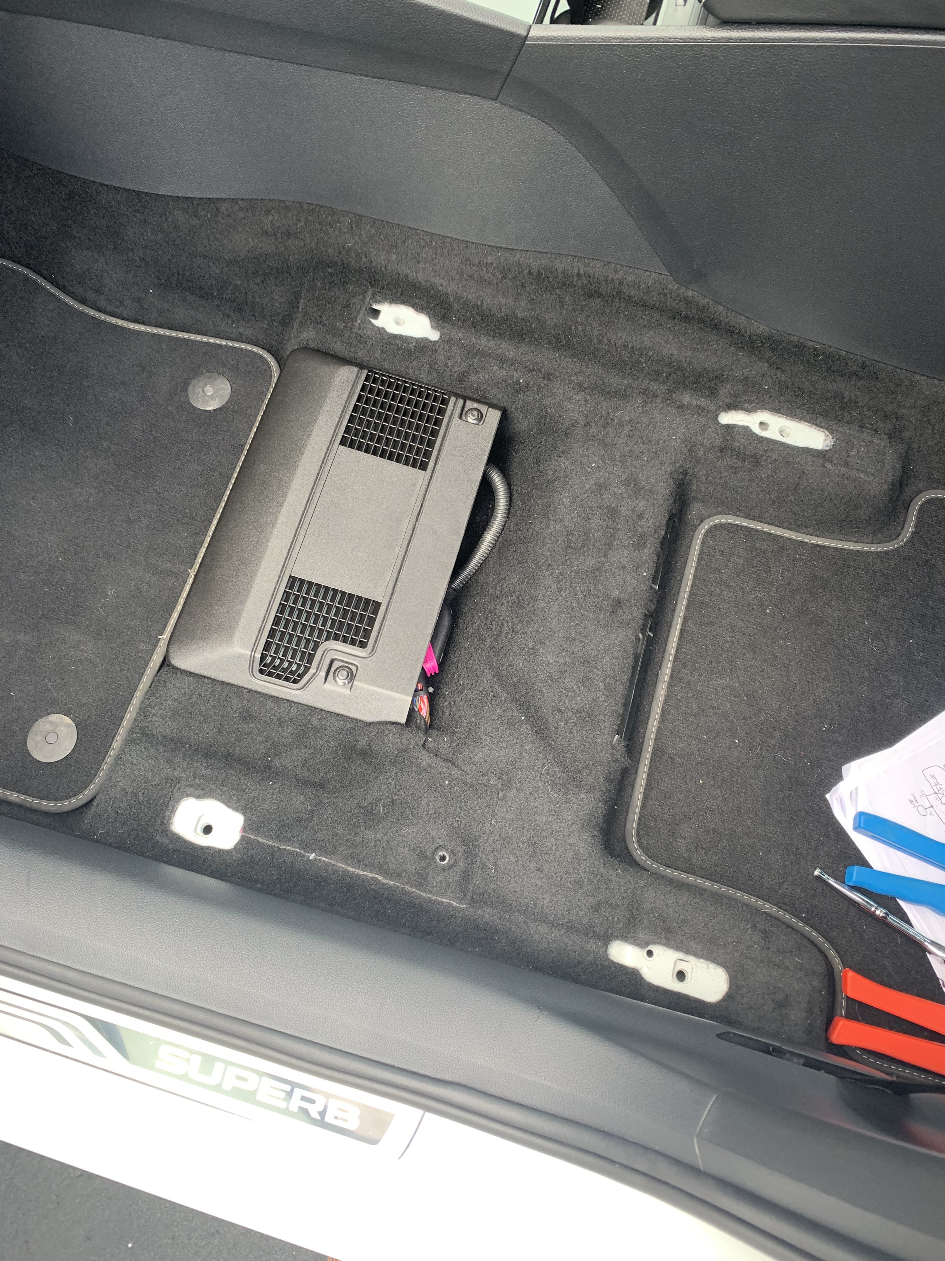

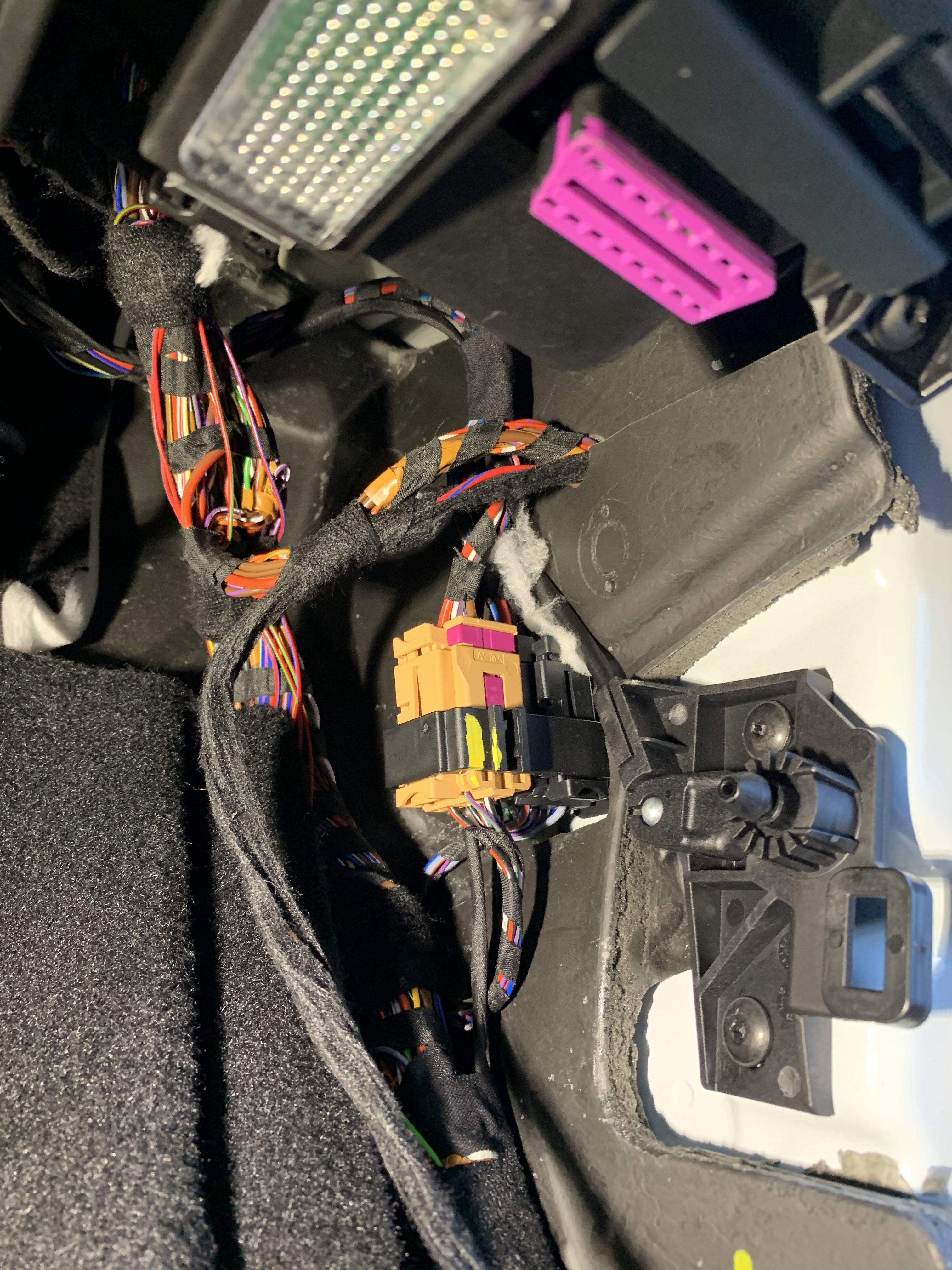

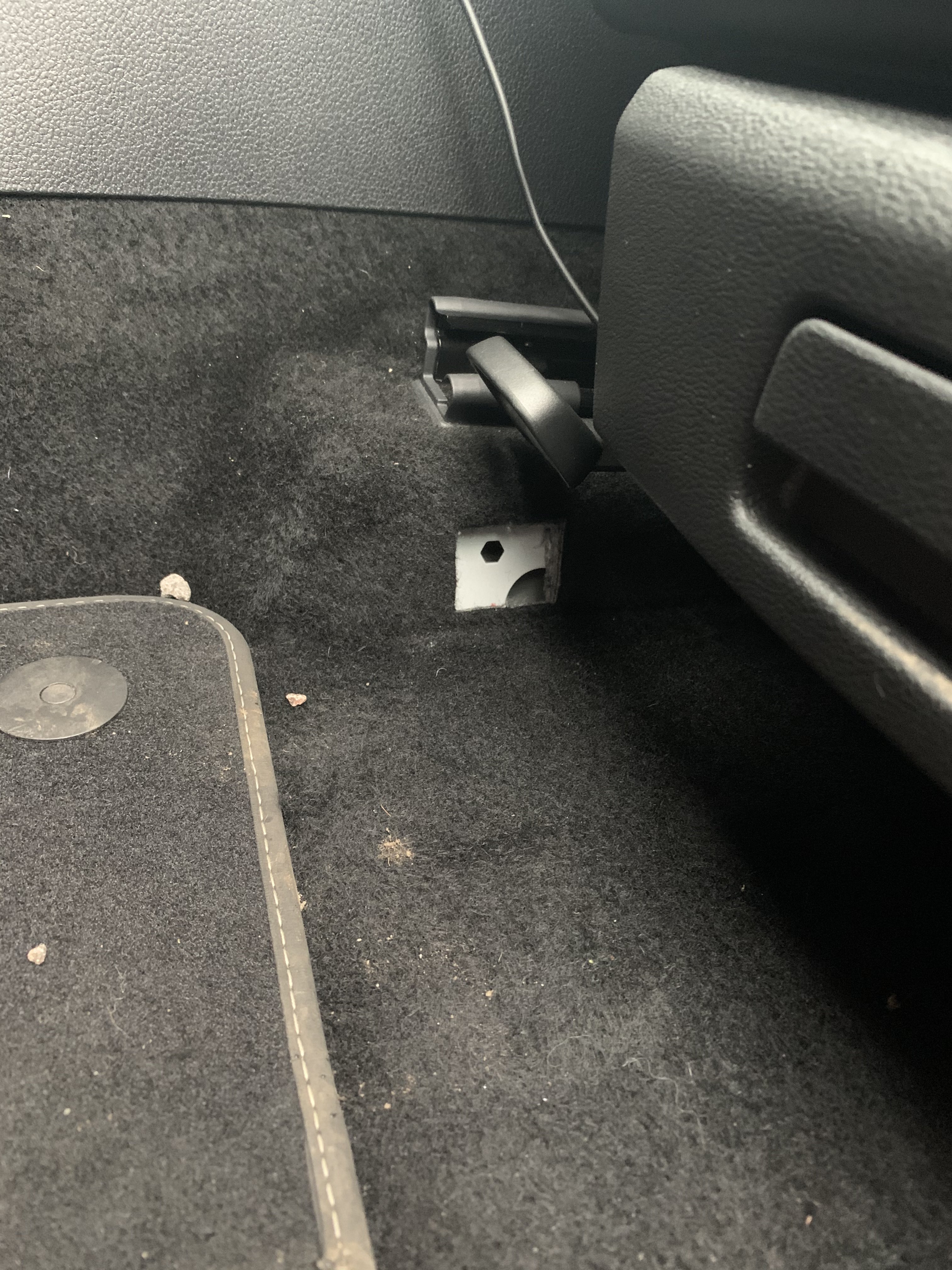

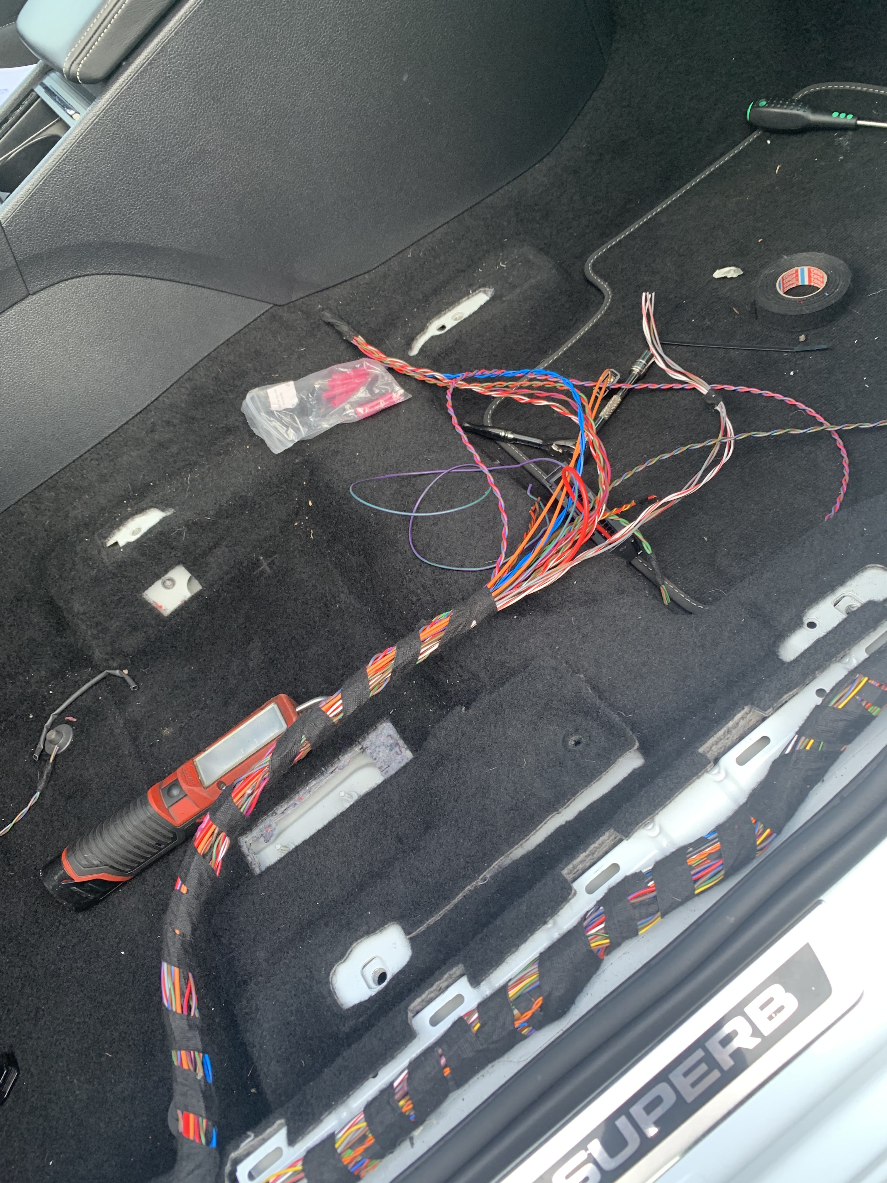

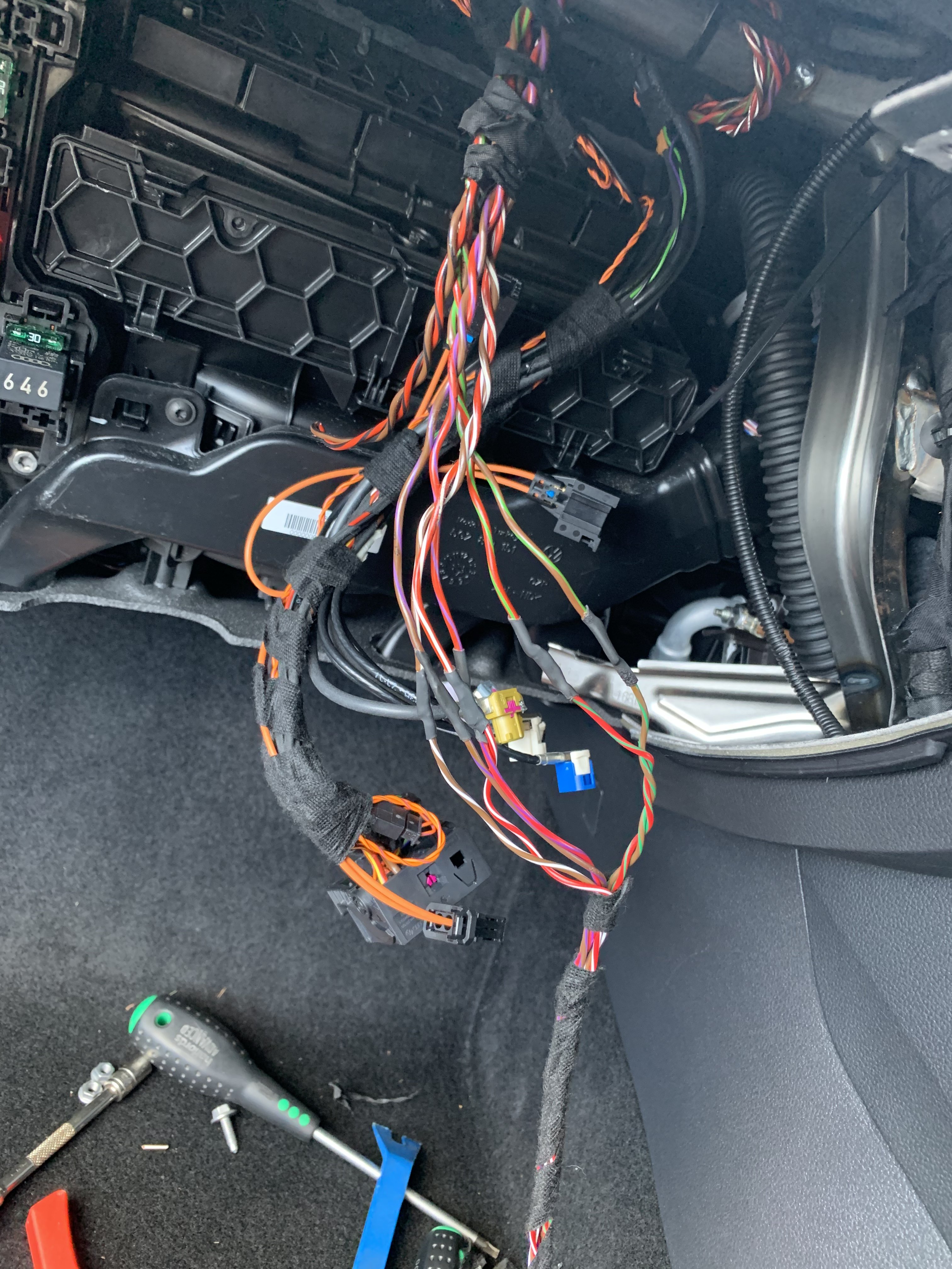

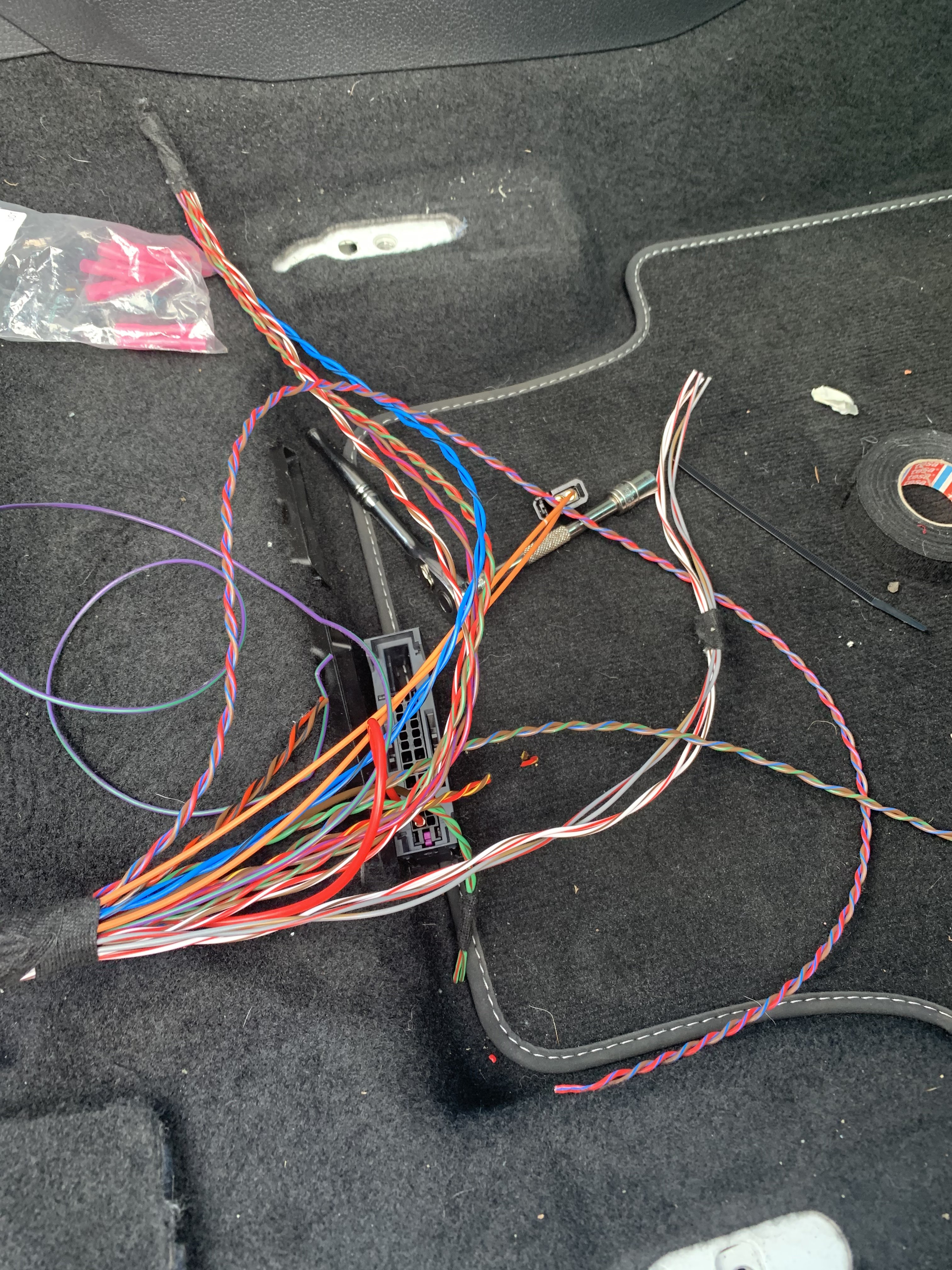

11 hours ago, ApertureS said:
Well finally all the wires are ran, all the NS speakers are fitted, looms modified, dash speaker, subwoofer and everything else fitted. Component protection removed, dataset corrected, all coding done, speakers are working and no fault codes - except the OS speakers still to fit and os loom to modify.
All using genuine wire colours, correct sizes, oem parts and all fitted as if it left the factory with Canton.
Just got to get a hold of a pair of front canton door cards with the swede material.
B256F544-3199-4E6A-838A-FA98F75C8906.jpegFC6CC68D-95CA-4945-A05E-F0AF92C6415E.jpeg48499FD2-3DA5-4CBD-AB15-D97A94804498.jpeg66A01691-7647-4D06-A1AE-CE80F229FBA3.jpegBA318E31-9280-4036-8C2C-2BE4C22EF156.jpeg008395CE-99A6-4687-B890-F8D8415D05FE.jpeg
68158E6D-A4B8-41B6-ACA3-17171C66A53B.jpeg1A575380-4385-479F-BFB0-F6A8E7B7F084.jpeg140A678D-18C6-432F-9468-D9F49FFD3243.jpegEFF59C18-CEF4-47B1-85F0-3D8291D92EAF.jpeg
Wow! Kudos to you for the effort but for me, I'd have to just go and buy a car with the upgrades inbuilt, otherwise were I to try it, I'd end up the sound system moving my seat or nothing working at all!

Cracking Job, a real PITA retrofit that one... Do you understand exactly what's needed on the coding front to code this properly? I can help you there.
All coded, dataset done, coding was fairly simple on that front.
if you wanted to share your sound system long coding it wouldn’t harm to compare the 2 though I suppose?
thanks
