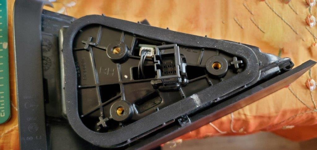

My almost fully loaded L&K had the wiring  up to the door module.
So it needs wiring from the door module to the mirror.

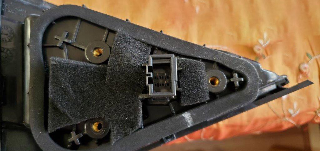

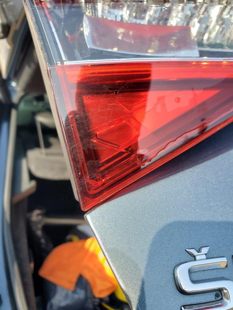

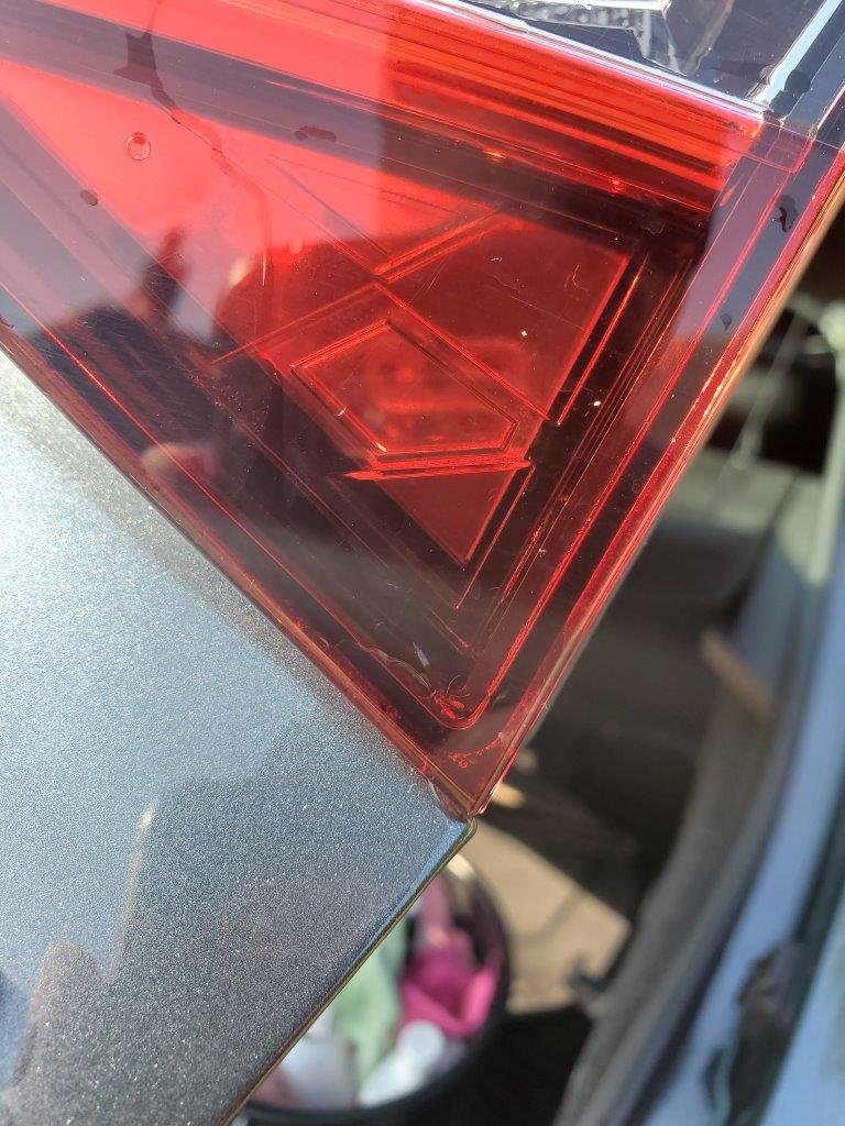

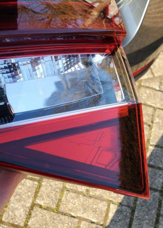

Finally got around to removing these dead critters from the rear inner lights, and put in some foam inserts to stop them from going back in.

How you did it?
I have one spider dead in my right inner light. I cannot see it now, but there is some cobweb in the light.
4 hours ago, elfensin said:
How you did it?
There's a small gap where I was able to shake them out from the red corner into the clear section of the unit and hopefully out. Afterwards I used a vacuum over the open vents on the back of the unit and then covered them up with foam.
I'm not sure how you'd be able to remove the cobweb since it's a "sealed" unit. You might be able to get away with using something like an air duster with a straw to dislodge the cobwebs.

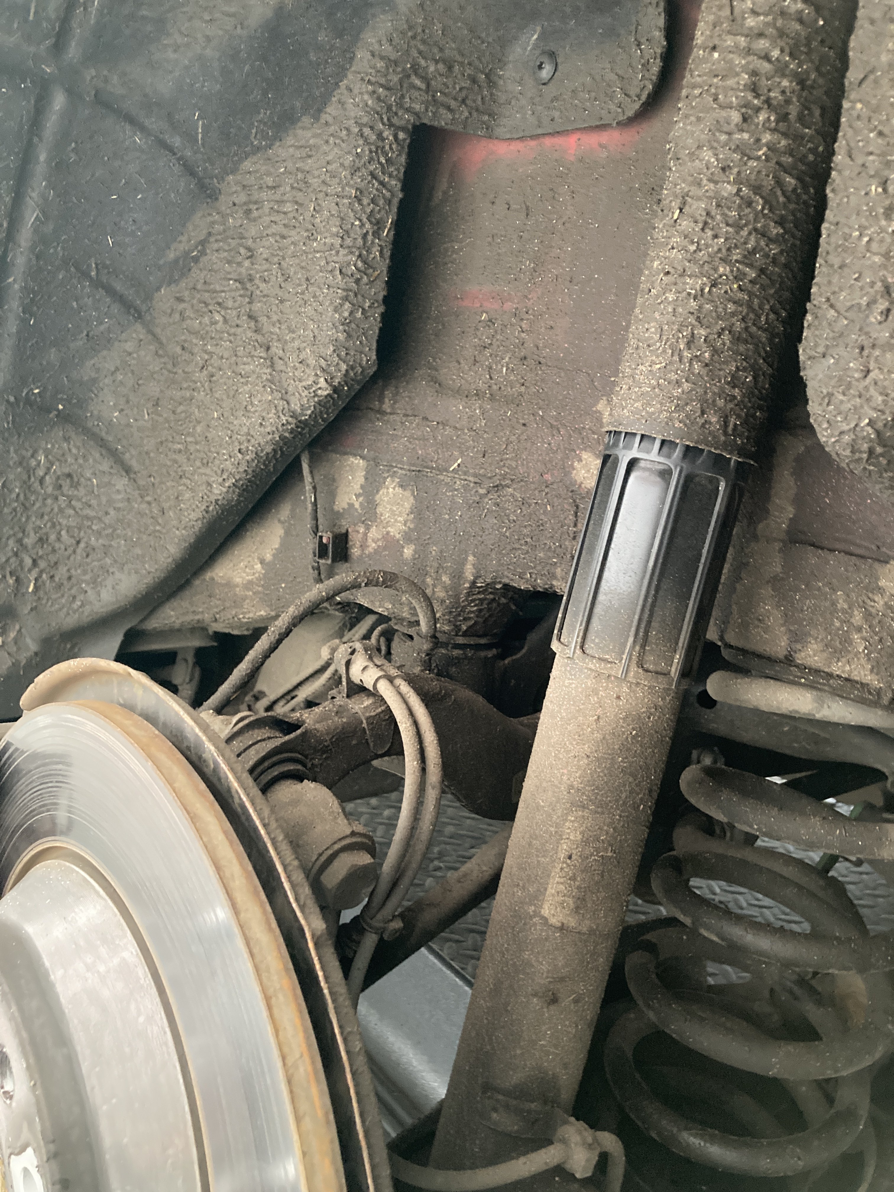

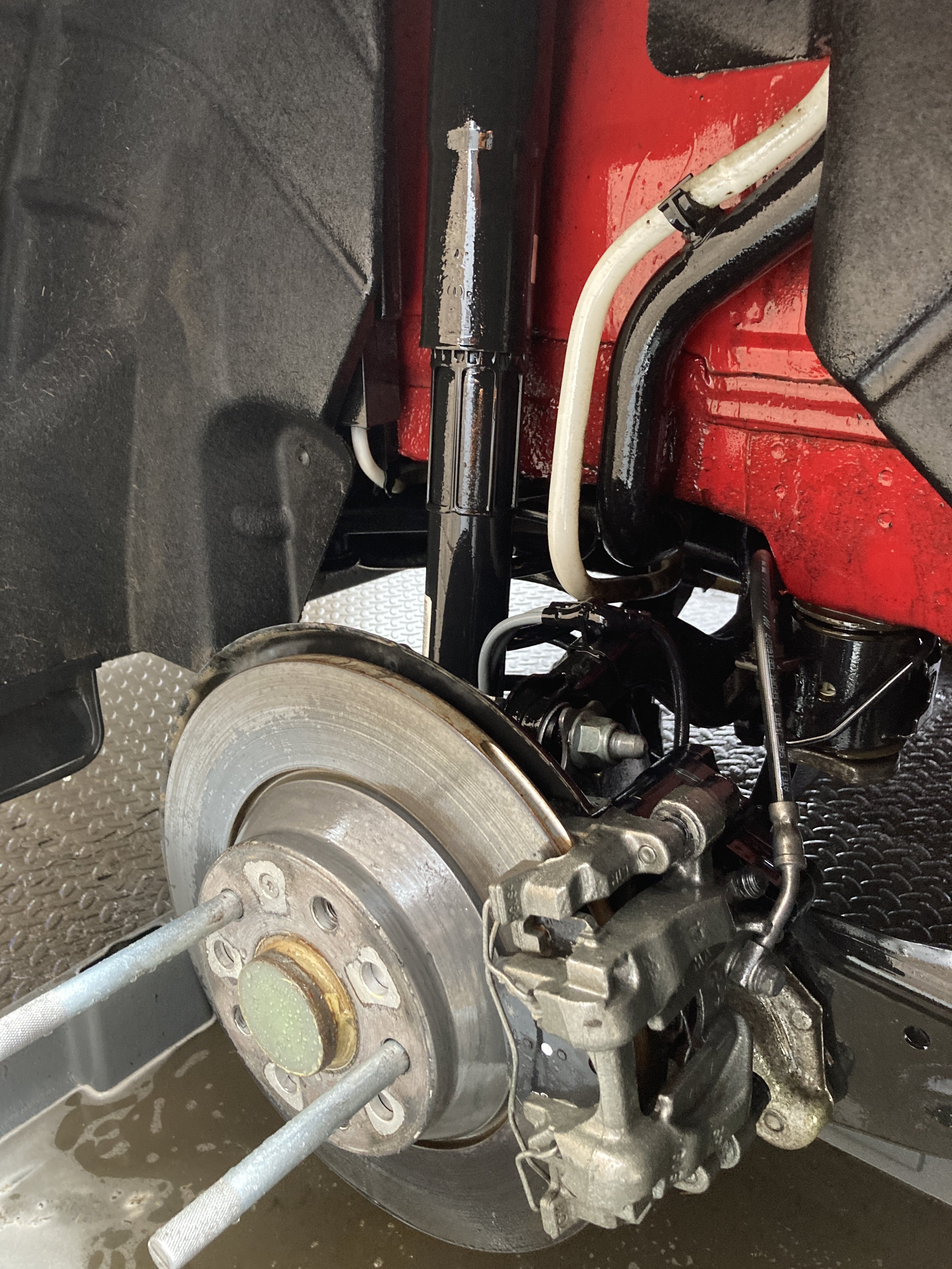

Weekly wash today, summer Supernovas fitted (winters on Vegas) and suspension given a quick spruce up whilst I was there....

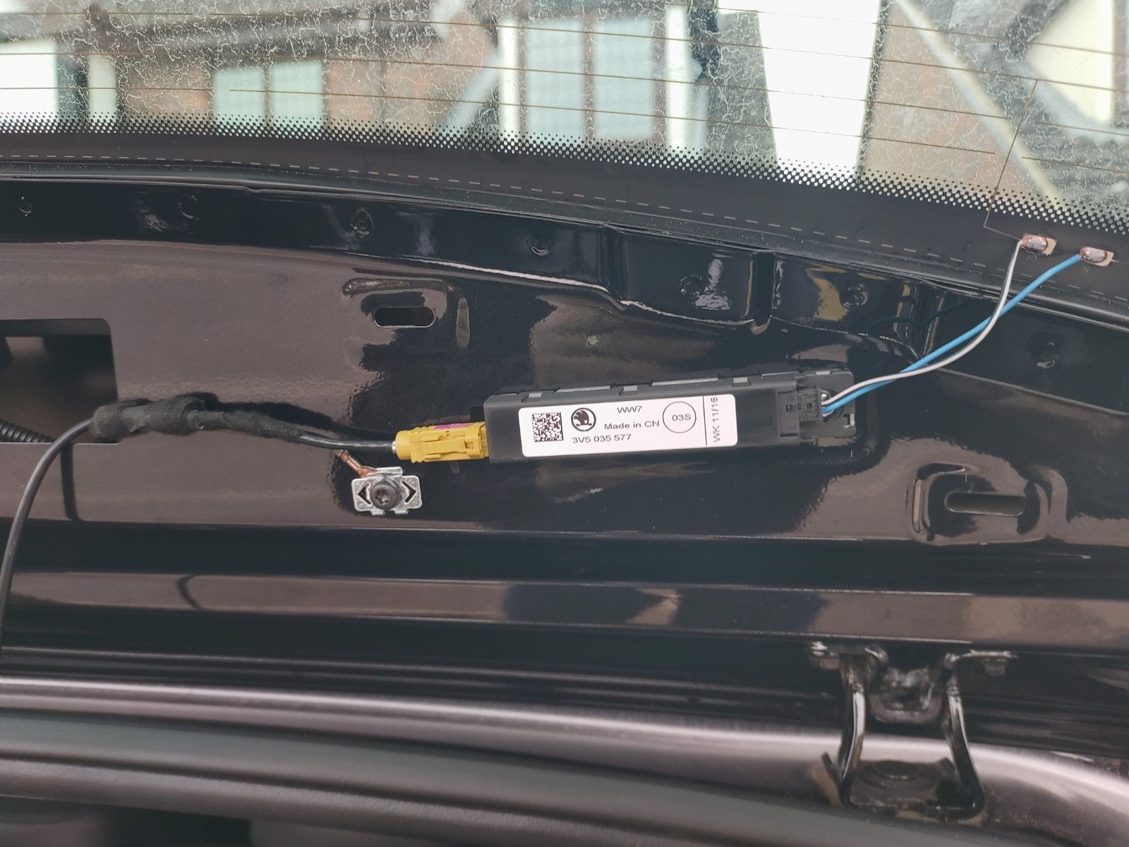

Fitted the ferrite core suppressors which did help however, I have noticed that the nearside tailgate flexy rubber tubing is already full of cables, wires & probably a rear wash water hose to the point where there's not much if any room for an additional thickish cam cable. The drivers side tailgate flexy rubber is a tad smaller but feels like it has way more space available inside it. So, I now plan to rip out the rear cam cable from the nearside & re-route it down the drivers side. This will also mean avoiding the DAB aerial cable which I think runs down the nearside C pillar. The hardest part will be getting the rear tailgate trim off. I've seen a few video's of hatchback tailgate trim removals but no estate models which I assume will be similar & very stiff to prize off.

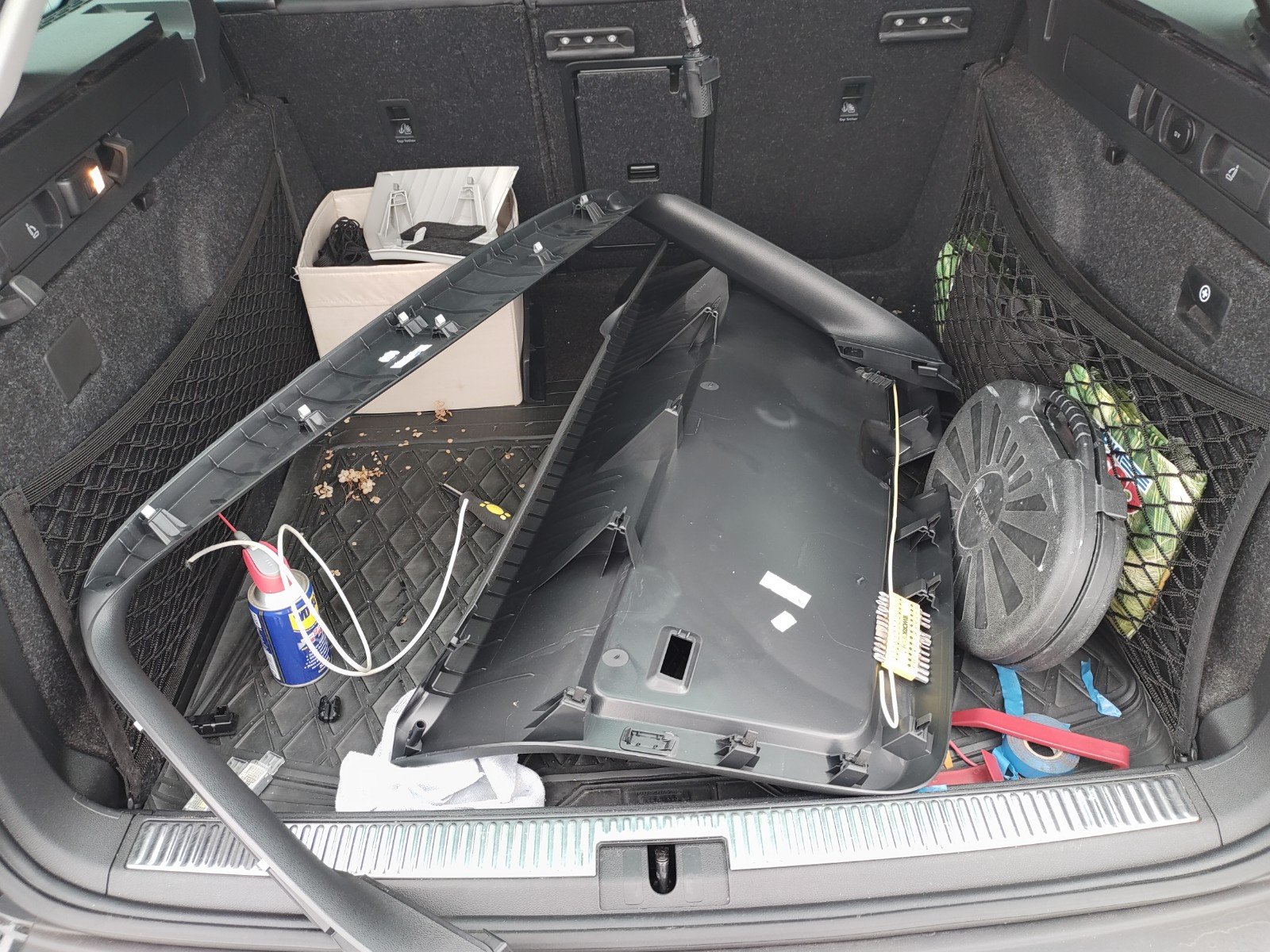

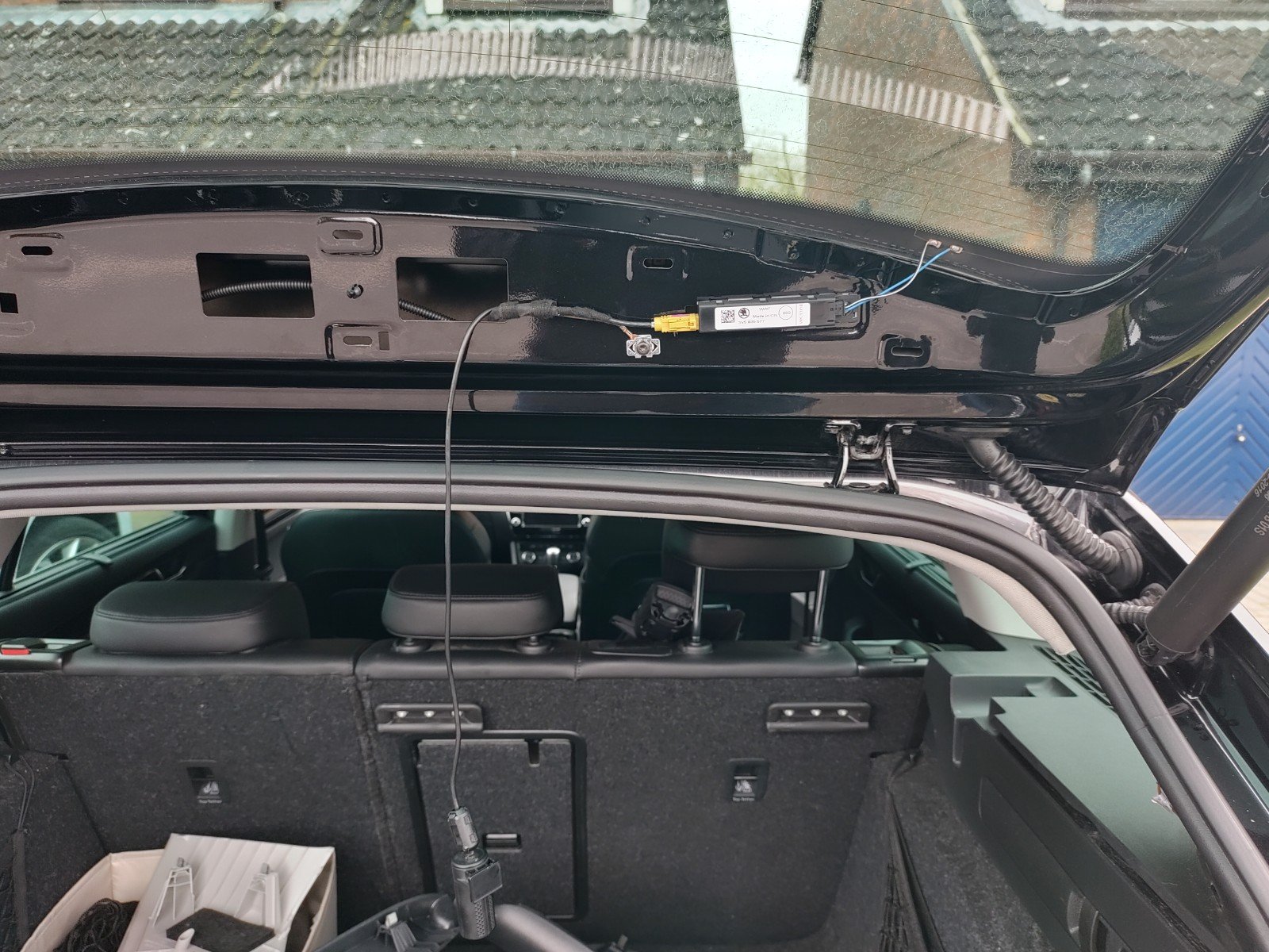

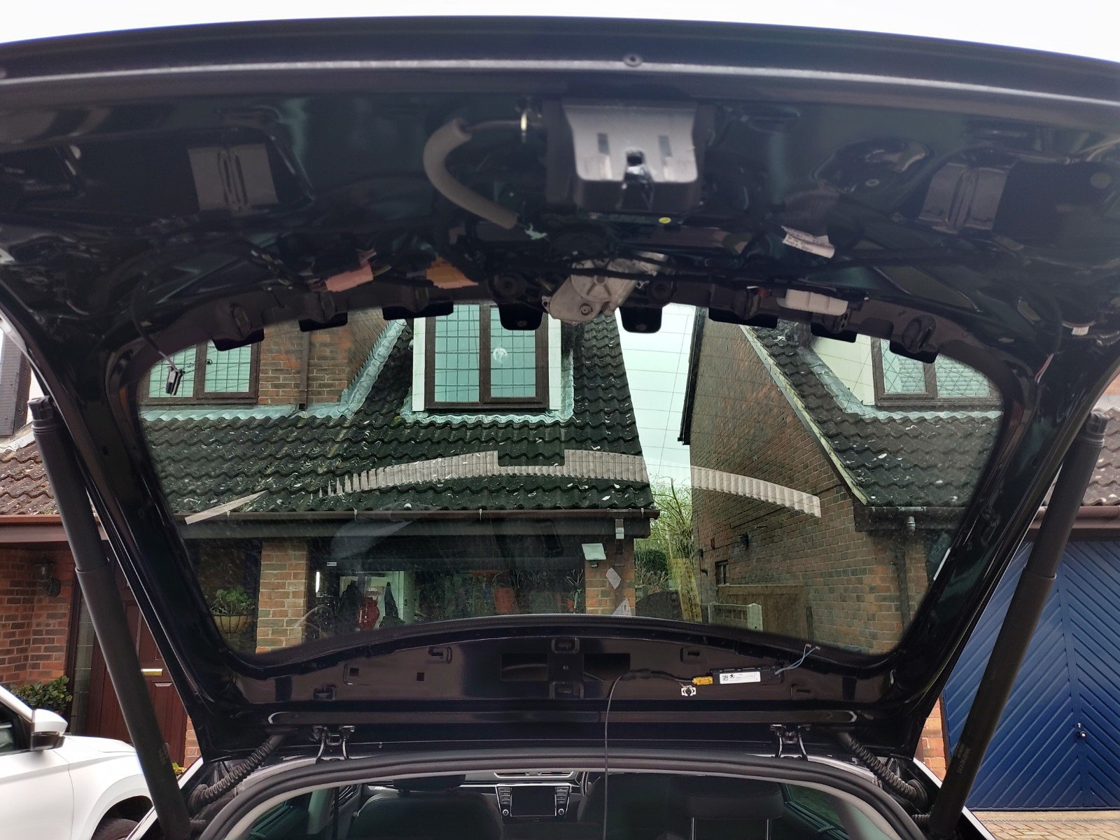

Well as expected that was a bit of a pain.
I re-routed the rear cam cable at high level down the driver side of the car tucking it in all the way to the ceiling trim until the C pillar where I had to remove the trim to fish the cable through to the tailgate flexy rubber. Pics below show where the DAB aerial connects to the rear glass & the camera cable routed behind it. Ferrite core suppressor snapped onto the cable right next to the camera which is hanging at this point.
Getting the rear tailgate trim off proved as difficult as I thought it would be. The lower tailgate panel has to come off first after removing the tailgate light fittings & the tailgate close button. All on spring clips - no screw. The upper part of the tailgate trim has two T25 screws & the rest are spring clips. It was much cooler today so I had to tread carefully in case I damaged any of the clips or their retaining sliders. All went well & they all survived.
Bit of a mess in the boot while all this was going on. WD40 used to get the flexy rubbers off a bit easier & to grease the inside of the flexy rubber for the new camera cable to slide through into the top of the tailgate.

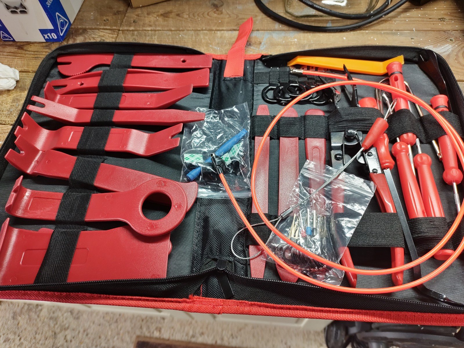

Not sure if I could have removed the rear trim without the use of the vehicle trim tool kit I got on Amazon a while ago. £20 well spent which has come in handy for a few jobs around the car & the house since then.
Putting the tailgate trim back on was reasonably straightforward & the reverse of the removal. Everything snapped back into place with a bit of a thump & no rattles.
I used 3M double sided tape to stick the camera high up on the rear screen. The only snag is that currently the camera is positioned outside the sweep of the rear wiper. Hopefully this won't impede the view too much when the rear screen gets it gets dirty - as it is now. If it does impede the view / picture quality then I may have to reposition the camera a bit lower on the screen - think I'm gonna have to do that anyway just to make sure. There was only just enough cable to run all the way to the back of the rear screen on the Superb estate & there was a push fit cable joint behind the DAB aerial panel which I wrapped in tape to make sure it cannot come apart 🤞 & there does not seem to be any DAB interference now from the camera.
The smoked rear glass means the camera is well camouflaged. As such it won't act as a visual deterrent which is a bit of a shame. I wonder if I should put a "smile you are camera" sticker on the rear glass? 😏. Probably not. The Cobra dash cam screen up front now is spit & shows front & rear cameras. I suspect the overall picture quality might now be a bit lower with the added rear view camera but that's ok.
Well that's just about enough car tinkering for this weeked.
Overnight we seem to have got another bunch of Sahara sand dumped on the cars so I guess I'll have to give them a wash tomorrow. to save money I have decided to stop using the local hand wash car cleaning drive through service as they were getting a bit expensive (inside & out £18 for the Superb & £22 for the Karoq). Instead I have invested in some extra kit to wash the cars properly myself. Time to try out my new swivel short trigger pressure washer gun, foam lance & Bilt Hamber Touch-Less pre wash snow foam. Got some acid free BH wheel cleaner as well which by all accounts is the best of the bunch & won't rot your wheel caps like the hand wash drive through stuff does. I reckon it will take about 4 washes to re-coupe the investment in all the extra gear I bought but after that it will be savings all the way.
@Colin170CR- nice work with removing the rear boot camera.
Just a note though - if u have curtain airbags, then u shouldn't b tucking any cables under the headliner as that will hinder the airbag deployment!!
I know u said the cable is not long enough, but the curtain airbags r now compromised.
