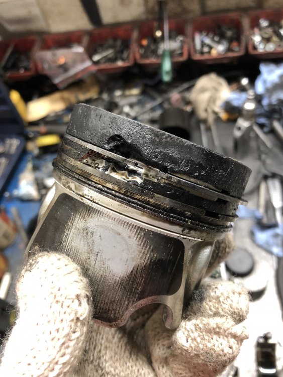

  • Finally found what was causing high oil consumption for my VRS, please see attached picture, this how piston one looked for car with millage 160K. And one more thing, don't do long service intervals,

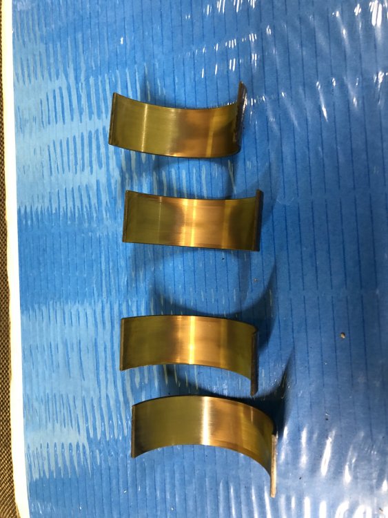

Finally found what was causing high oil consumption for my VRS, please see attached picture, this how piston one looked for car with millage 160K. And one more thing, don't do long service intervals, if you don't want you rod-bearings to look like mine :)
That looks bad. Given that these engines are known to easily do 3 or 400k miles, how sure are you that it has genuinely done 160000km, and what service history has it got ?
Service history seemed plausible enough, when I checked it with Skoda dealer, besides hard to imagine that 3yr old car would done 3 or 400K even km. I just think I draw a lucky lot. Now due to the long lasting oil consumption DPF unit has gone mad and does regen cycles every 30 - 50 km, only options are to remove it or to replace it. Must be honest, at the moment I'm considering option one, as I know that car exhaust levels still should be within legal range.
