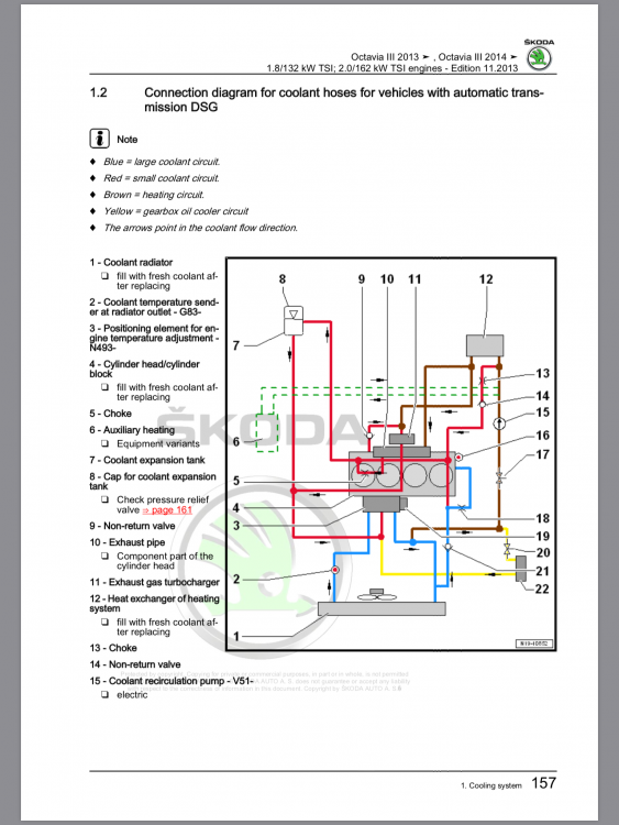

Maybe someone with Erwin can find the coolant matrix diagram for the cabin heaters & turbo charging system?
Edited by Gabbo
I have This diagram
Edited by knudsen
It does look like the turbo is water cooled but I think it is probably mainly to get usable heat out of the turbo for heating rather than a lifeline to keep it alive. After all, most turbos only have an oil feed. I still bet 10p that somebody left a 10mm spanner in the inlet pipe :D
Or even a 10mm nut.
The turbocharger is water cooled to prevent it from overheating. By the same token it also assists the fast warm up, but the primary reason is to cool it. These turbos are on an exhaust manifold which is integrated into the cylinder head and are vulnerable to coolant boiling in the head and turbo particularly after the engine is stopped.

The important part for me is the cabin heater matrix is indeed directly connected with the turbo charger cooling system.

17 hours ago, knudsen said:
I have This diagram
 Very interesting. Is the Mk3 1.4TSI similar? Nice to see what some of those visible pipes and sensors are for. I'd an incipient turbo failure (air raid siren noises) on a Mk2 2litre diesel , replaced under warranty,no arguments. I was asked in a joking fashion had I been racing it. The noise started after a moderately swift departure at a T junction with a lukewarm engine.
