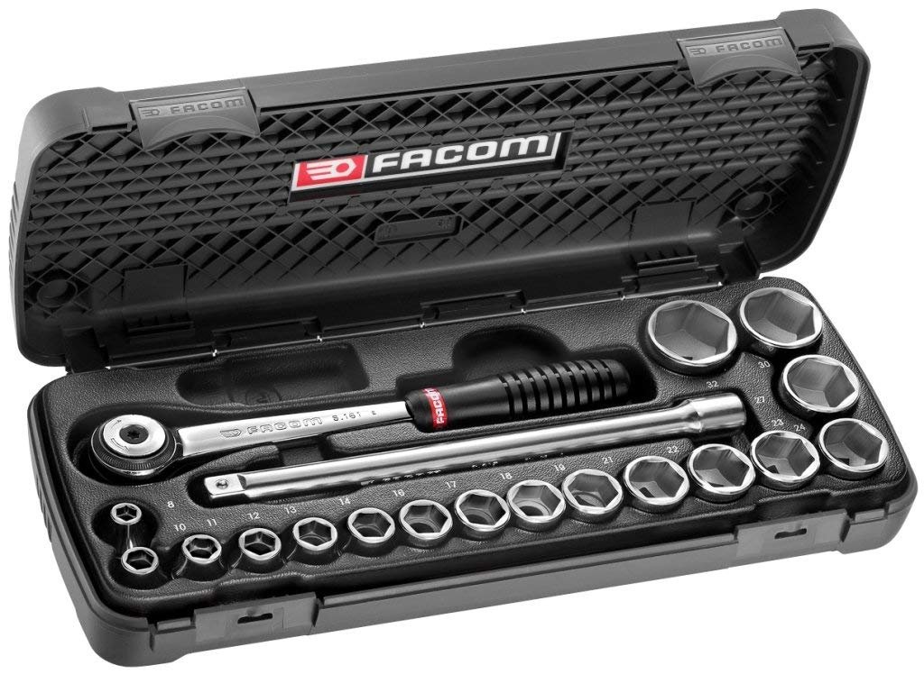

An adjustable spanner (as in your picture) will be OK for the battery terminals, but the clamp that secures the battery to the tray upon which it sits is right down at the bottom of the battery (you should notice on your new battery that there is a lip all around the bottom of it, the clamp latches onto this lip).
Access to the bolt that is used to slacken and re-tighten the clamp is a bit tight, and  I think you'll struggle with an adjustable spanner.
I used a socket set with an extension piece...

1 hour ago, silver1011 said:
Adjusting the time on the clock and reprogramming the radio stations isn't a major issue, just disconnect the battery.
This is the clamp, I'd guess the head size is no more than 10-13mm...
One point to note, be prepared for a host of warning lights lighting up on the dash after you've replaced the battery and turn on the ignition / start the engine for the first time. Most of them will go out, but the steering wheel warning will require a short drive before it clears.
