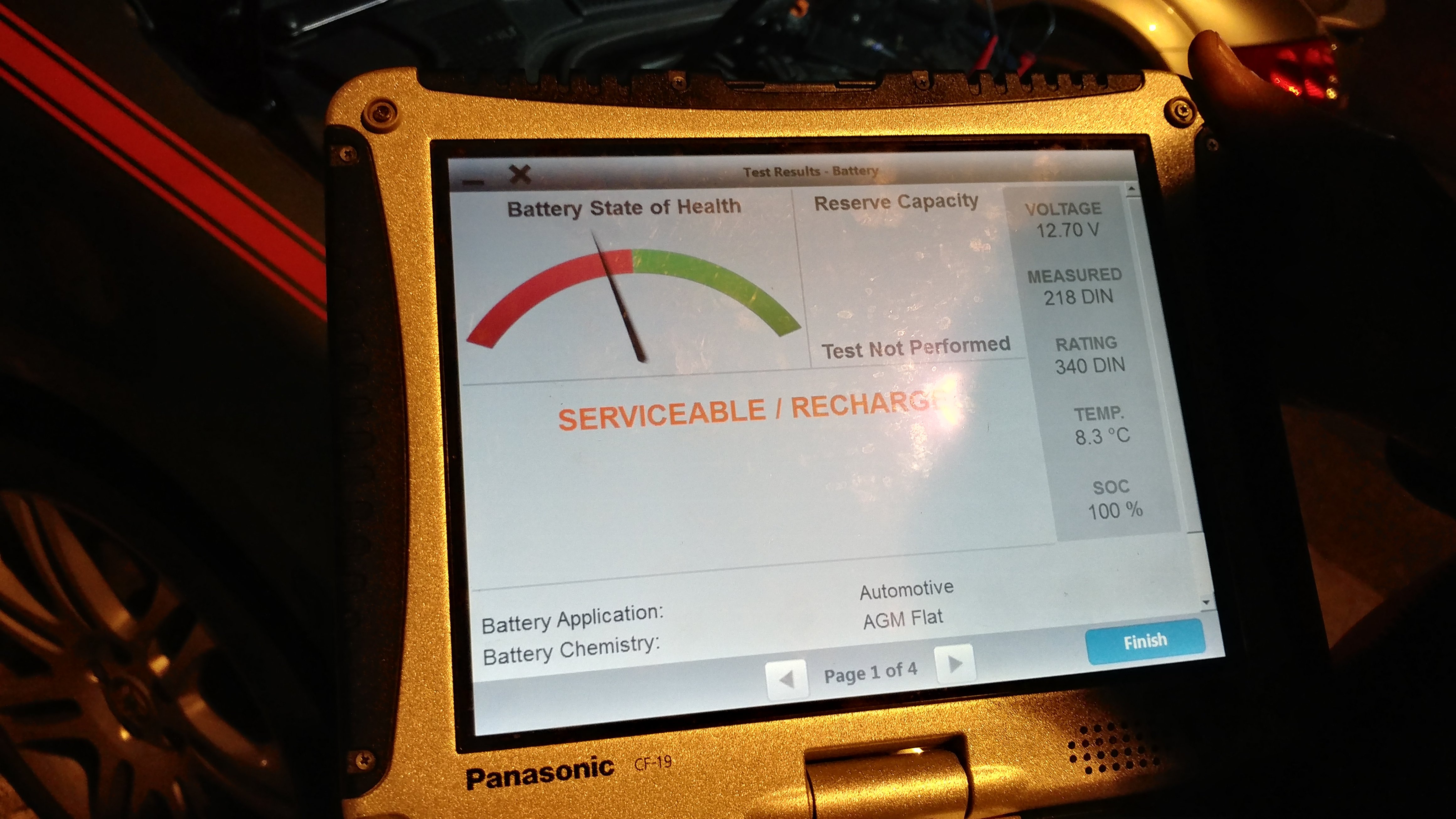

Hi yes, the RAC guy said it was battery, told me to basically get a new one as soon as possible. His battery test wouldn't even work until he connected slave battery to it. Haven't started car up today. Find out in a couple of hours.

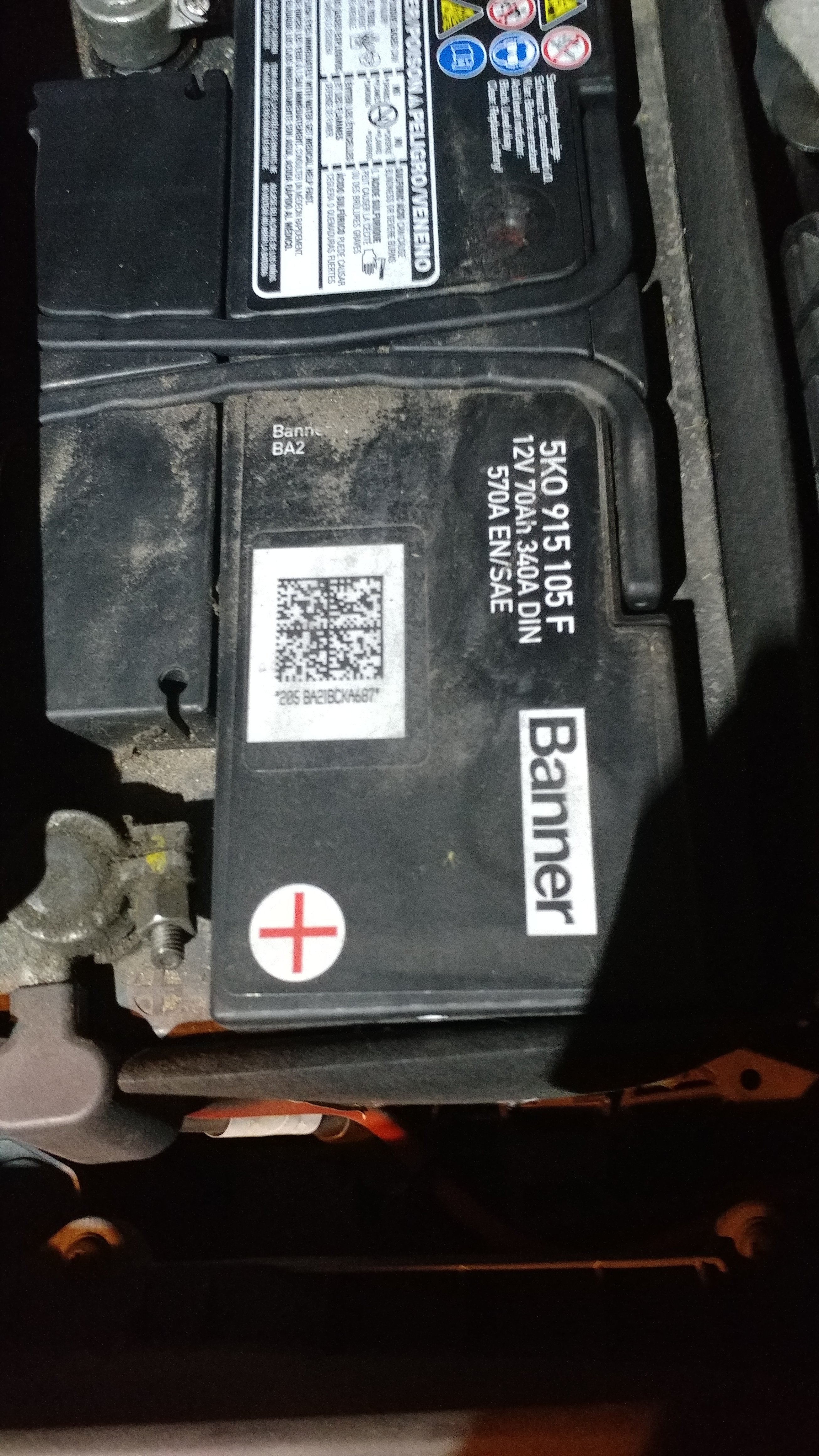

Will the new battery need coding as it's a higher ah than the factory Banner one ?
If your car has a battery control module then YES
Not all cars without stop start have the module.
Only a scan will tell you.

The battery originally fitted to the Superb (including yours) has a capacity of 70 Ah and a CCA of 570 A. This means it can supply a current of 70 A for 1 h, or 35 A for 2 h, etc. Under cold start conditions, it can deliver up to 570 A to the starter motor: the battery would last no more than 7 minutes at this rating but it's highly unlikely you would ever hit this. The engine will usually fire within 1-2 s of cranking.
The experience of many here is that this battery is a bit undersized for the car. The Varta E44 you've just fitted is 77 Ah and 780 A CCA.
