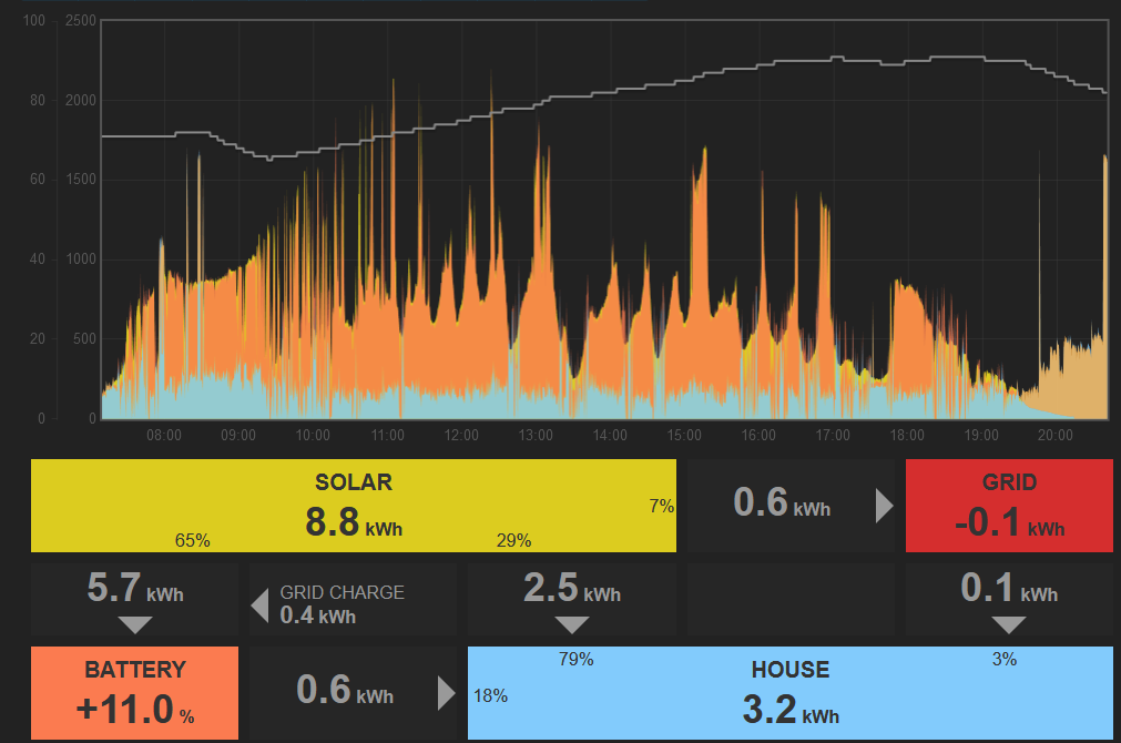

12 hours ago, Stonekeeper said:
They believe they charge for "free" from a solar array.
You are telling me this isn't charging for free from solar array?
edit: for info: the line is battery charge level, the filled lines are solar generation and where it went.
Cost of solar: £7000 about 9 years ago.
Return on investment: about 10 years mark, accounting for inflation.
Effective cost of solar from after ROI: free.
How much do they lose by not getting the "feed in tariff" or "Smart export credits" when they charge the car for the KWs they take, it's a choice but nothing comes free.
Feed in tariff is based on generation, not export. So self-consumed as much as possible. Charge car or don't charge, it doesn't make any difference to the payment.
Edited by wyx087

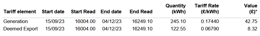

Indeed there's 2 elements to FIT payment: generation and export. But don't always assume what you read is 100% correct, because websites like those usually take shortcuts to describe a complex system.
All people on FIT start off with deemed export because it predates smart meters, older non-smart meter cannot measure export. Deemed export means for each kWh generated, they deem 50% export regardless of how much is self-consumed. Meaning use as much as possible without consequence for people on FIT.
For example, my statement for gloomy autumn/winter days. Effectively it's ~20p/kWh based on generation for me regardless of how much I use, since V2H install, I consistently self-consume over 95%.
Then there's higher paying SEG (smart export guarantee). People on FIT can move the export part to SEG (one way) to get better rates such as 15p from Octopus, currently. FIT still pays generation part whereas newer installs only get paid SEG.
But today's solar PV installs are much cheaper and generate more. So overall ROI is said to be similar. My neighbour also installed 10 panels, but got 4 kWp system (my is 2.9 kWp) installed for just £4000.
Coming back to your view that there's associated cost, it's only true for newer installs as you rightly pointed out. But for FIT, it depends, usually it is completely free.
