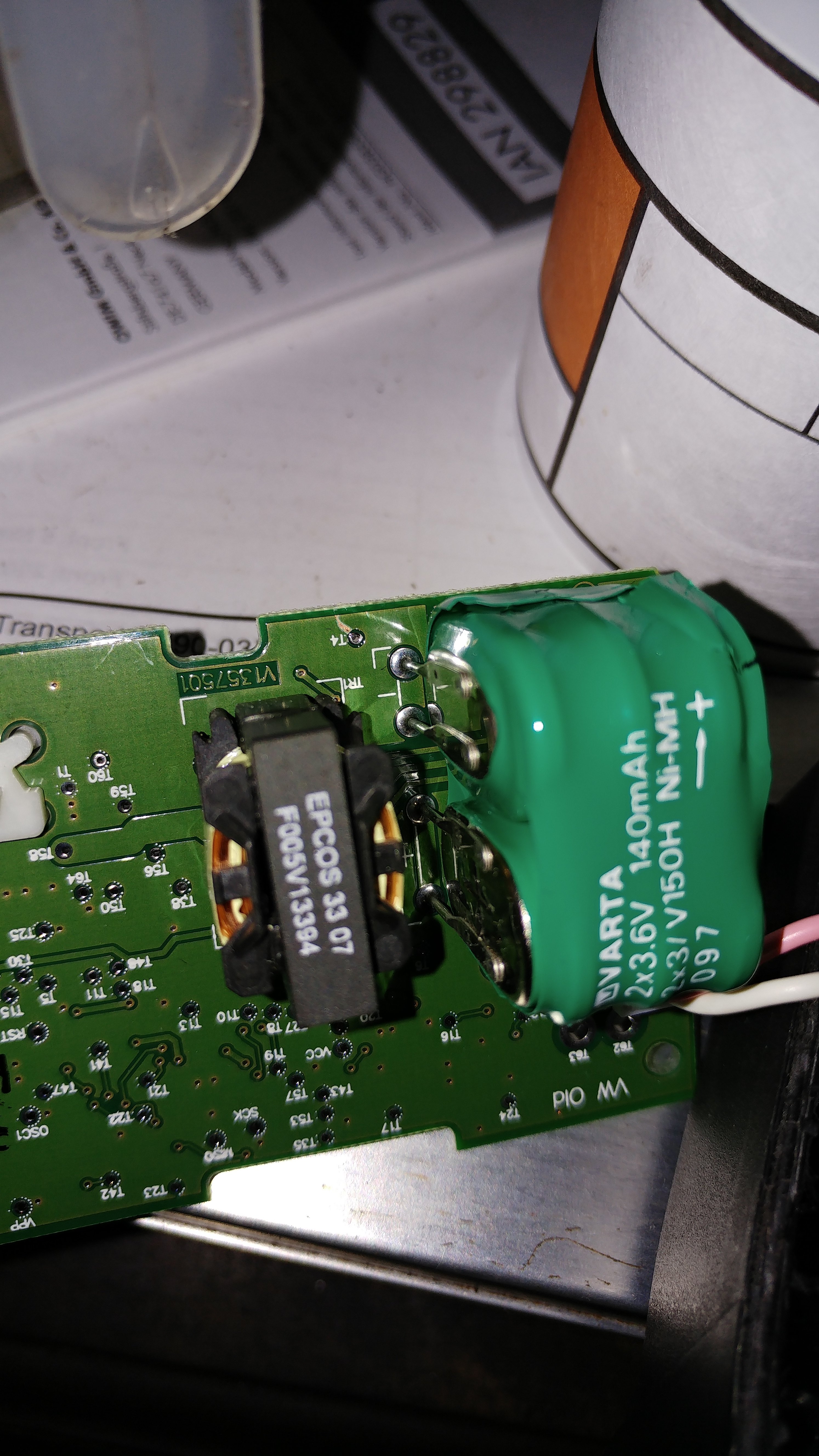

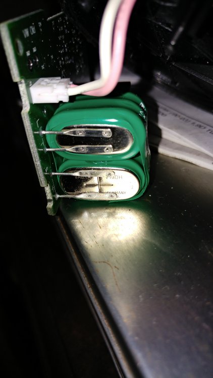

Anyway, I went out a bought 2 new batteries and then set about opening up my siren. My story was different, as the PCB looked decidedly dead. Pictures to follow.
I bought another one off eBay and will install the new batteries when I open it up tomorrow.

OK, so my second alarm unit turned up a few weeks ago and this past weekend I tackled repair #2. The battery tabs were a bit corroded, so I risked it and removed the old battery and soldered the new ones in. That's were things went wrong. The PCB must've had a corroded portion as the batteries and PCB then proceeded to get rather hot. I removed the new batteries and then decided to swallow a bitter pill and ordered a new one via the wonderful discount opportunity we have here at Briskoda. All up price is ~£124.
I could have ordered another second-hand one but who knows how many I could've opened up to get the same result? I'm worried I've damaged my new batteries as well.
This is one I will put down to experience. If I keep the car past 5 years I will check the condition of the alarm during MOT or service time and as soon as things get a bit dodgy, I can replace the batteries. At least I'll know I have a good PCB.
