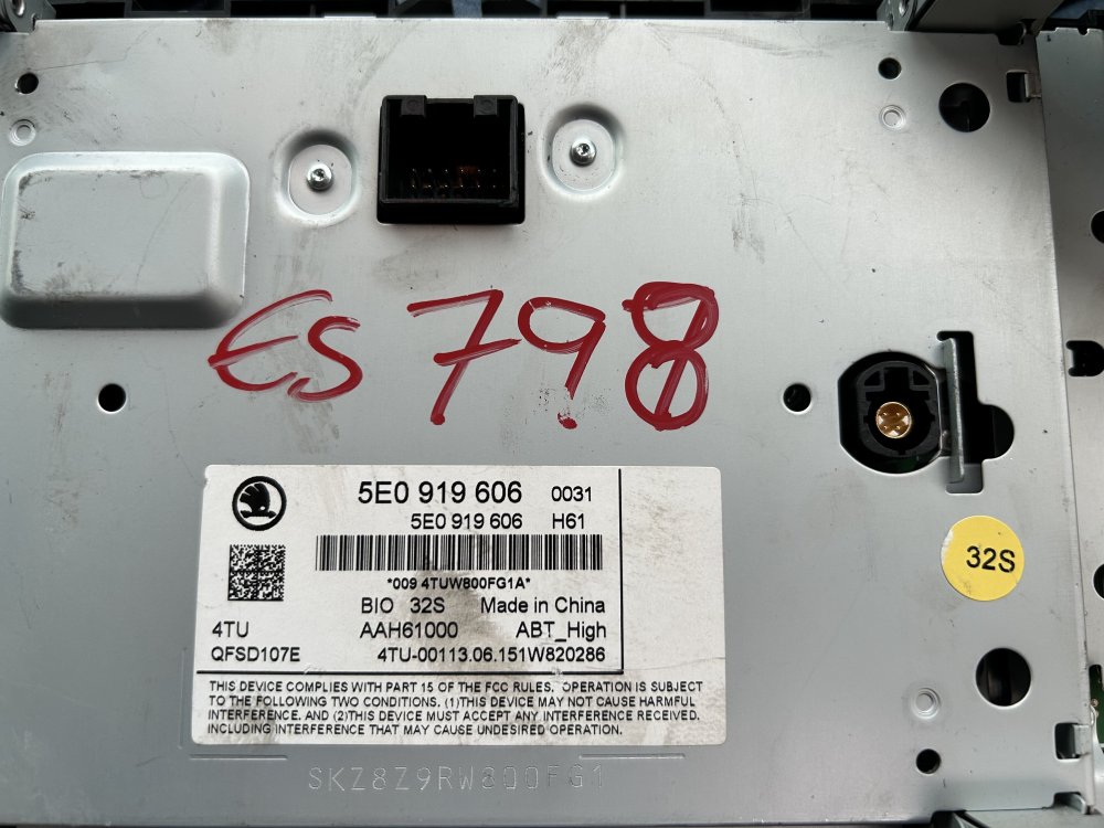

  • It was a 5Q0035874A Amundsen MIB2 with a 5E0919606 8 inch Columbus screen. You could also pair that unit with the latest glass screen for the Amundsen (5E0919605M). You also need a USB (5Q0035726E) an

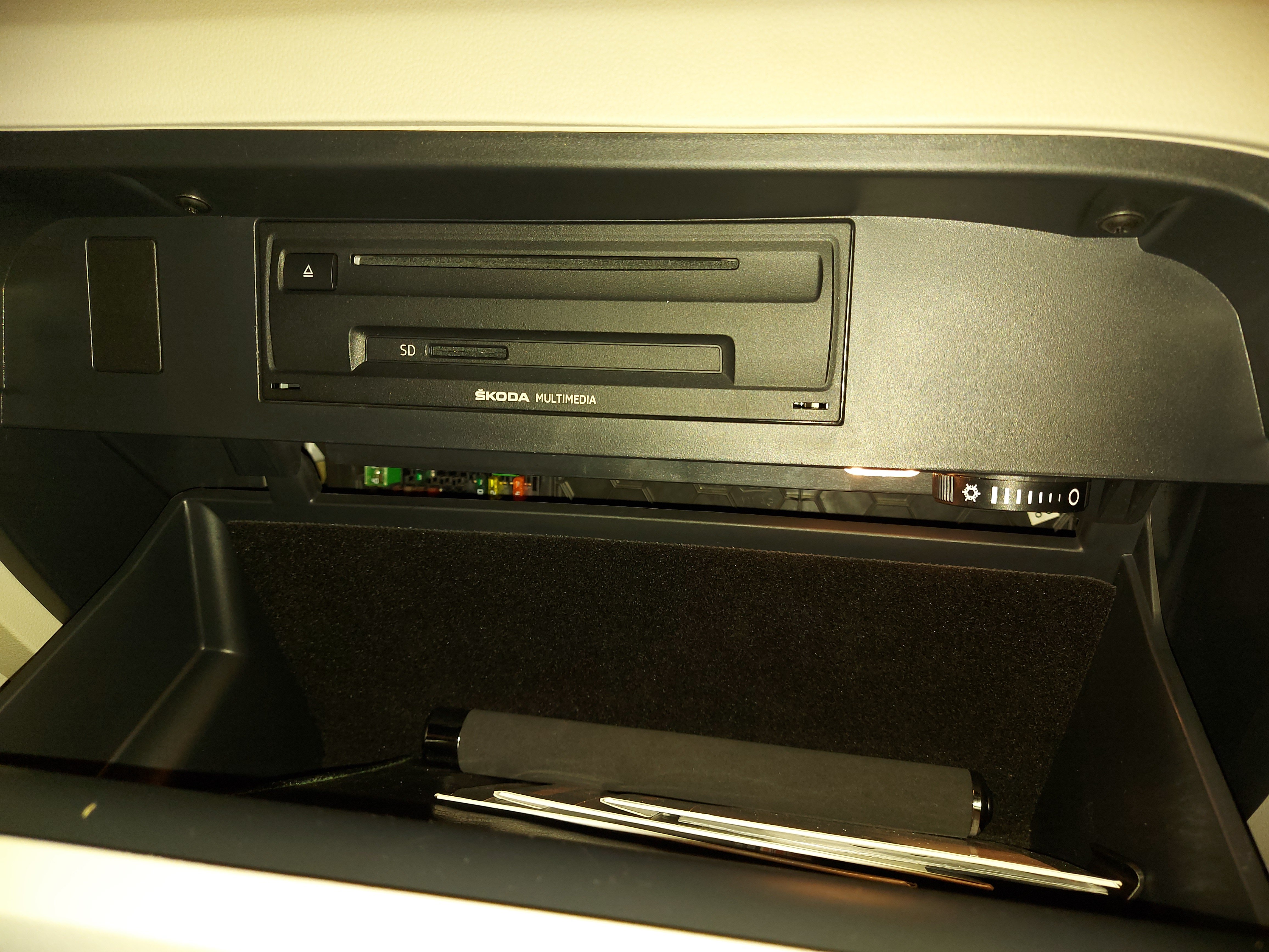

Hi iv got the 2013 octavia vrs iv desided to upgrade the headunit to the 8 inch display Iv got the new headunit and the unit witch go’s in the glove box it’s been unlocked but I persume it’s gonna need coding we’re can I get it done or who can doo it thanks
Hi, I got mine done at the dealers. Was an hour's labour.
It’s come unlocked had cp done and features reactivated what else is there todo?

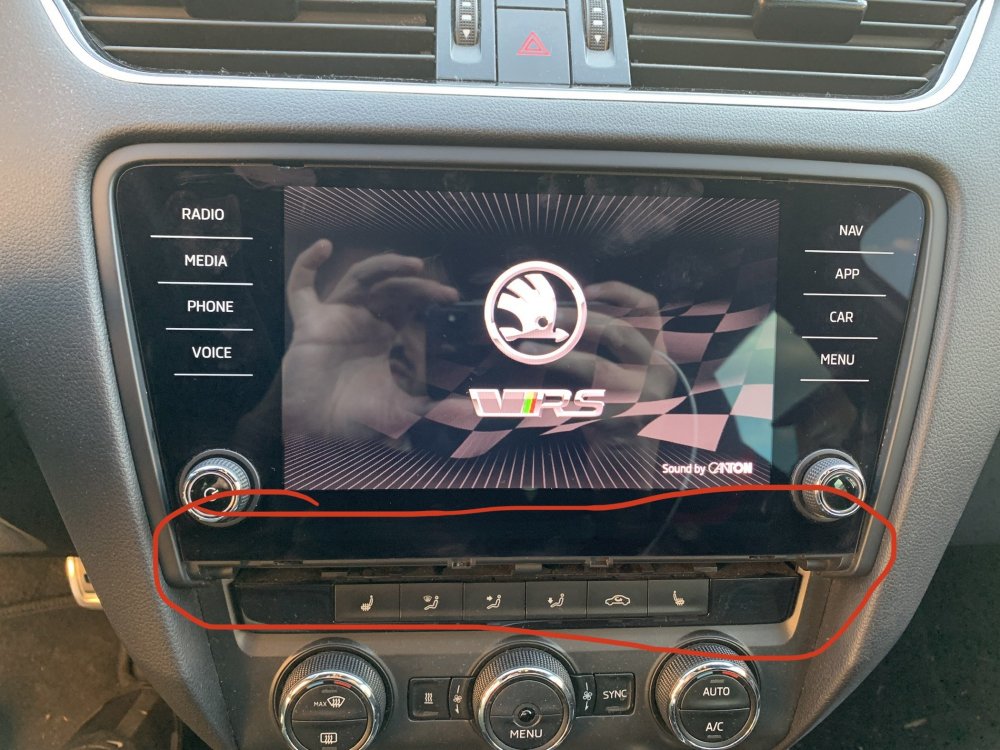

inspired by this thread, I've decided to upgrade my infotainment in Octavia (end 2015.) - purchased second hand 5E0919605N FL Bolero screen to replace my existing 6,5'' 5E0919605H. As said, it was a very easy swap (once I've got my hands on the proper tool).
Very satisfied with the result, but there is a minor issue - screen arrived without bottom plastic fascia, so after installation it doesn't look very nice.
I wonder if it is a separate component, in which case I would appreciate information on the part number. Or, if someone has it and is willing to sell it and send to Croatia, please contact me via PM.
Finally, one more question - is it possible to do something about non-functioning APP button?
Thank you in advance!
No part number I don't think. Best suggestion in the past has been to hunt for a broken screen on eBay with it included.

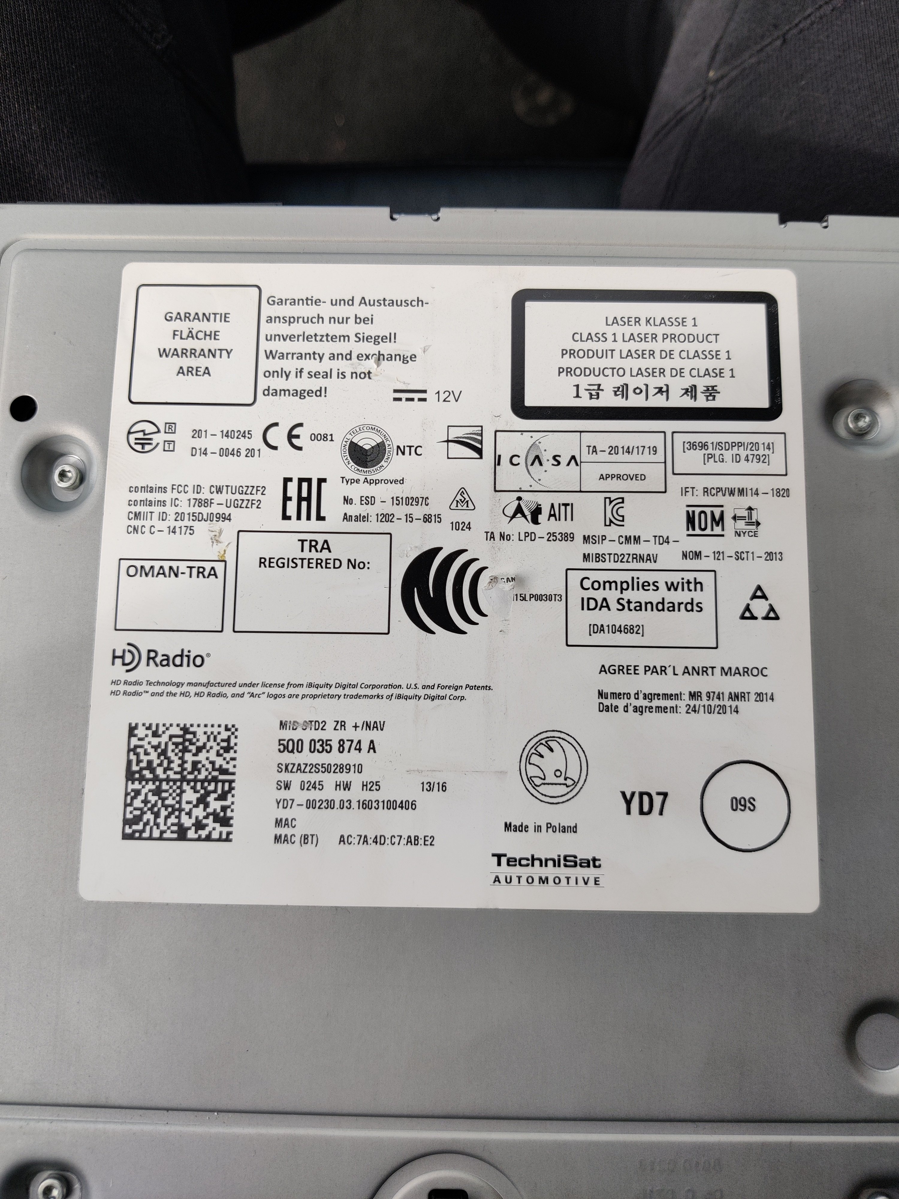

Hi,

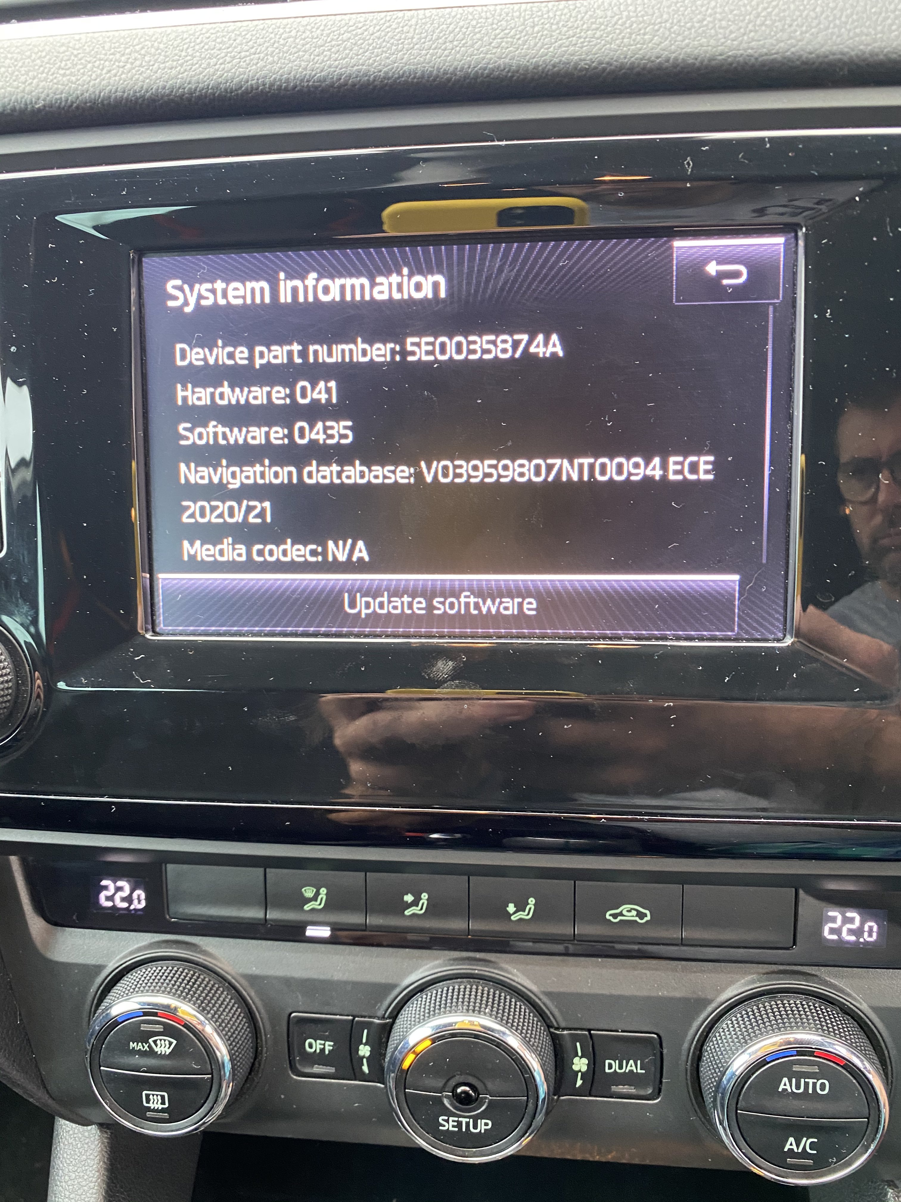

I want to upgrade my screen not sure if i have mib1 or mib2 headunit part number is :
5E0035874A  2 sd slots one for memory card other for sat nav also has cd slot.
Screen is: 5E0919605D it has sat nav
Small screen
What's my options?
Thanks for any help
Much appreciated

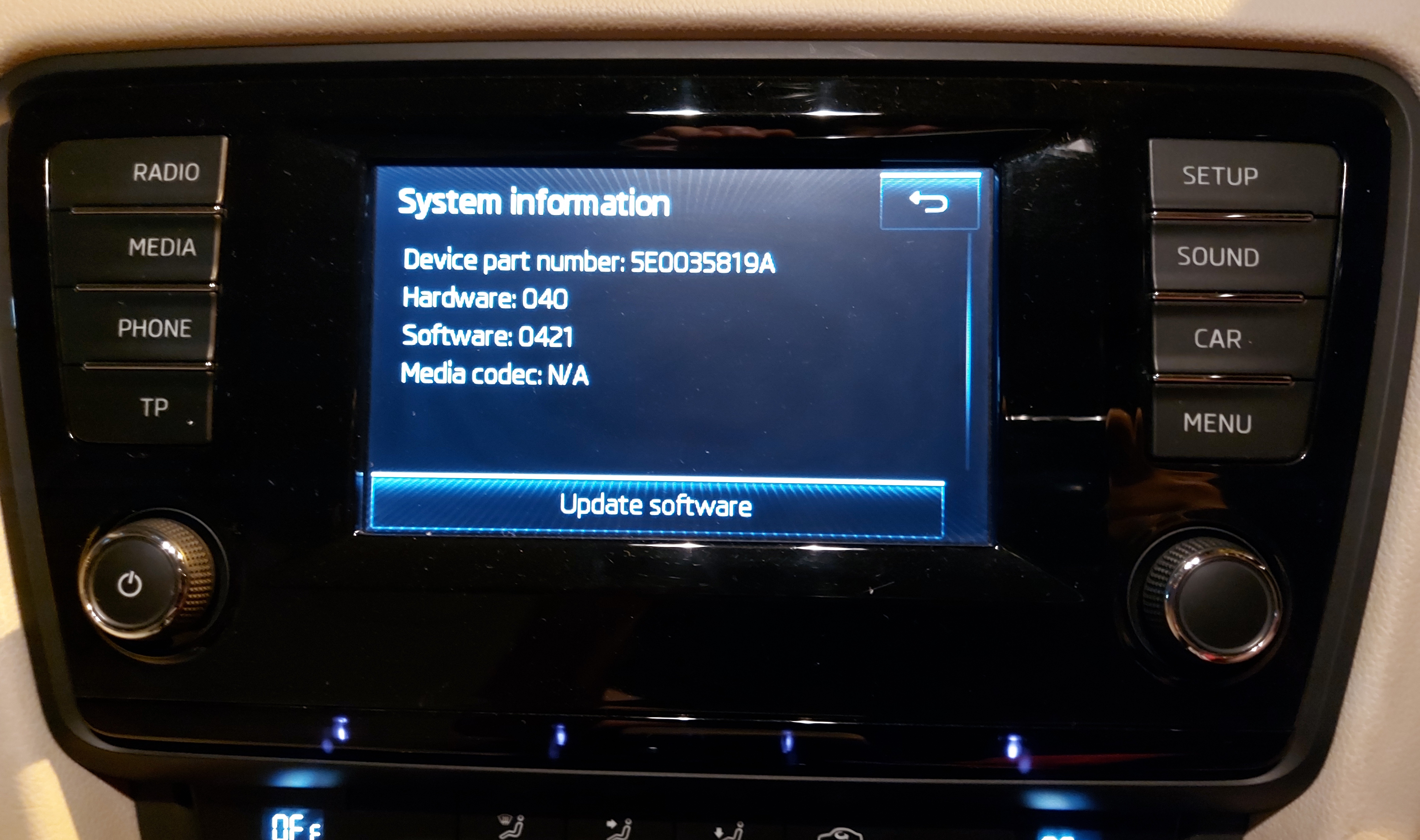

I have Bolero multimedia system 5E0035819A and display 5E0 919 605.
I found MIB2.5  5Q0035874C and display  5E0 919 605 M
As I read here, I will have to find someone to do CP removal and to code it for changes?
Do I need to change anything else?

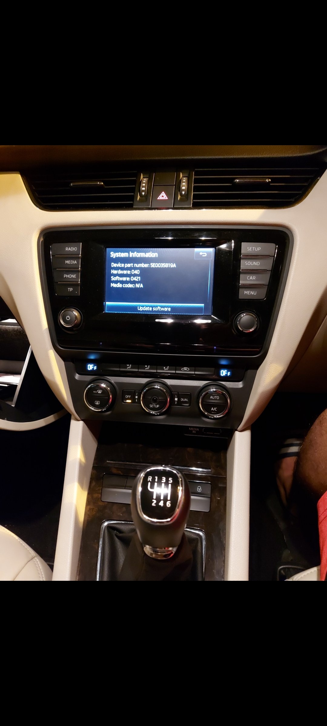

Im interested in upgrading my stereo, is there a list of what units work with what screens etc so I can see wether I can just upgrade my screen or I need a whole new setup.
this is what I currently have in my VRS 7B2DA8F2-5229-4439-ADBA-56DB9E743DF0.thumb.jpeg.203b4a99961c73c7be35c471b9de7b3a.jpeg

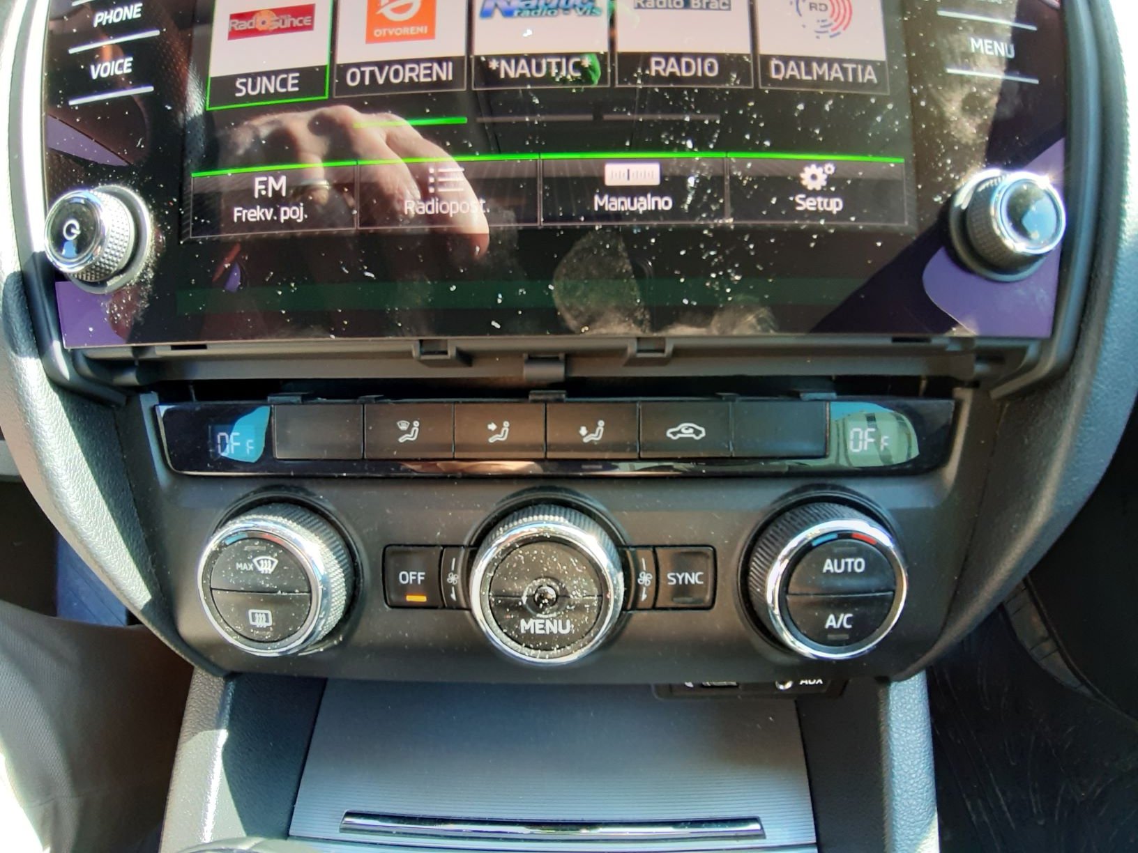

I recently bought Amundsen from 2018, but the display is without the bottom cover from the picture below.
Does anybody know can I buy that part separately or does anybody have a part number? Thanks
