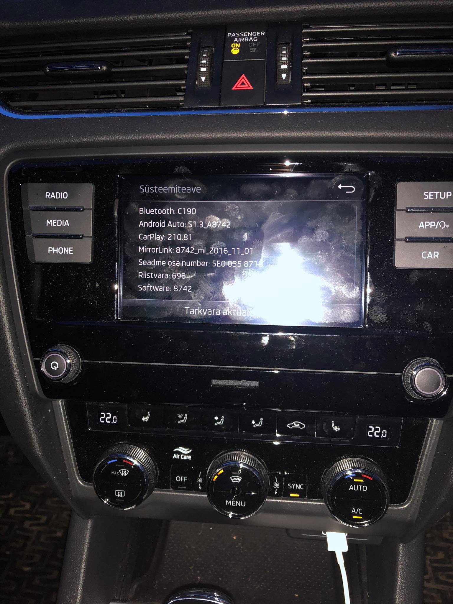

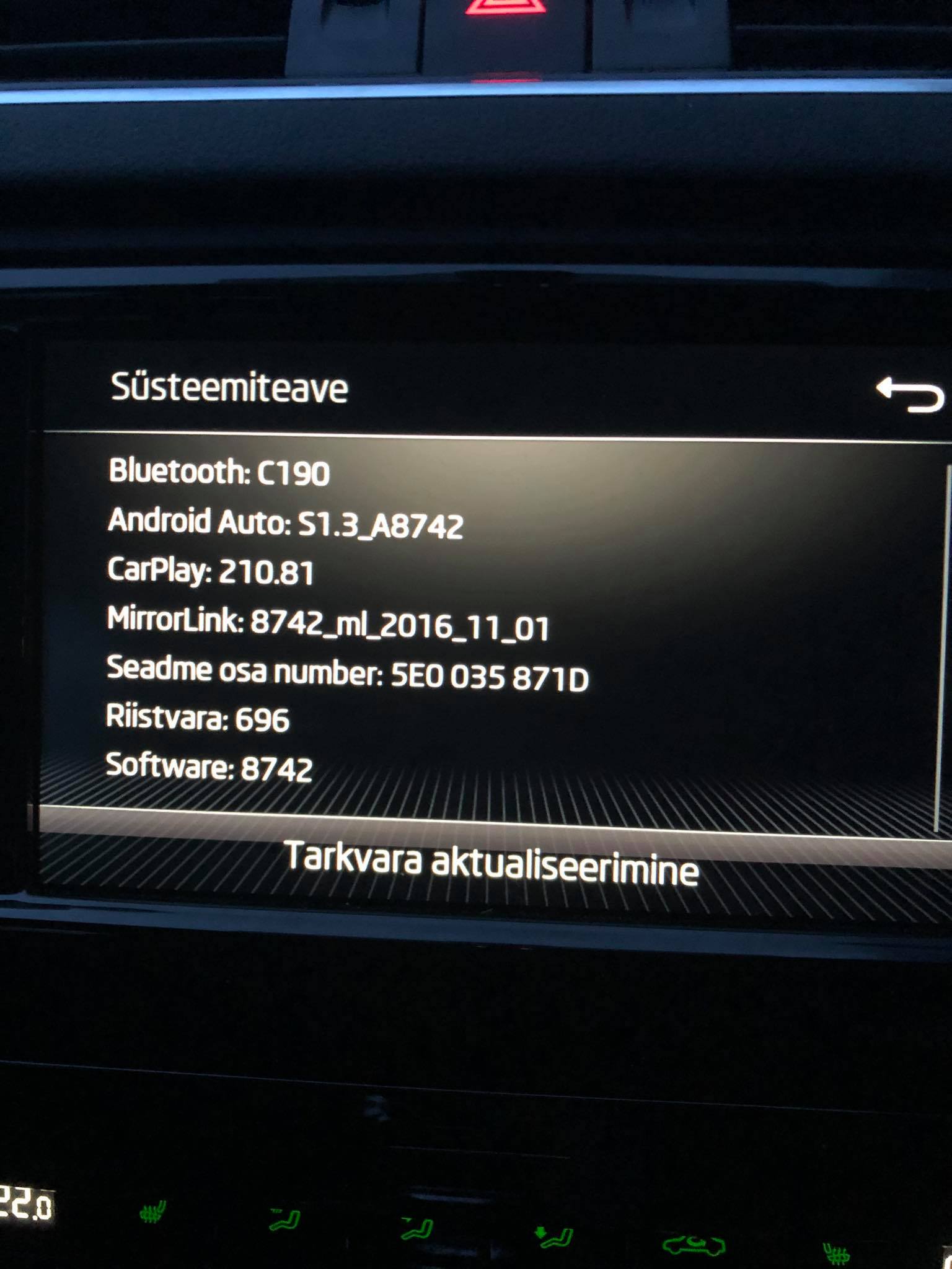

On 22/01/2021 at 09:53, MargusRoo said:
Hi. Great topic. I read it to the end.
I have 2020 Octavia MK3 with a Swing radio - 5E0035871D
There is no radio unit in glovebox. As I understand Swing is so basic that unit is behind of screen.
The question is what my options to upgrade to full glass look? I am quite happy with a functionality of swing but looking more fashion look.
Br
Margus
