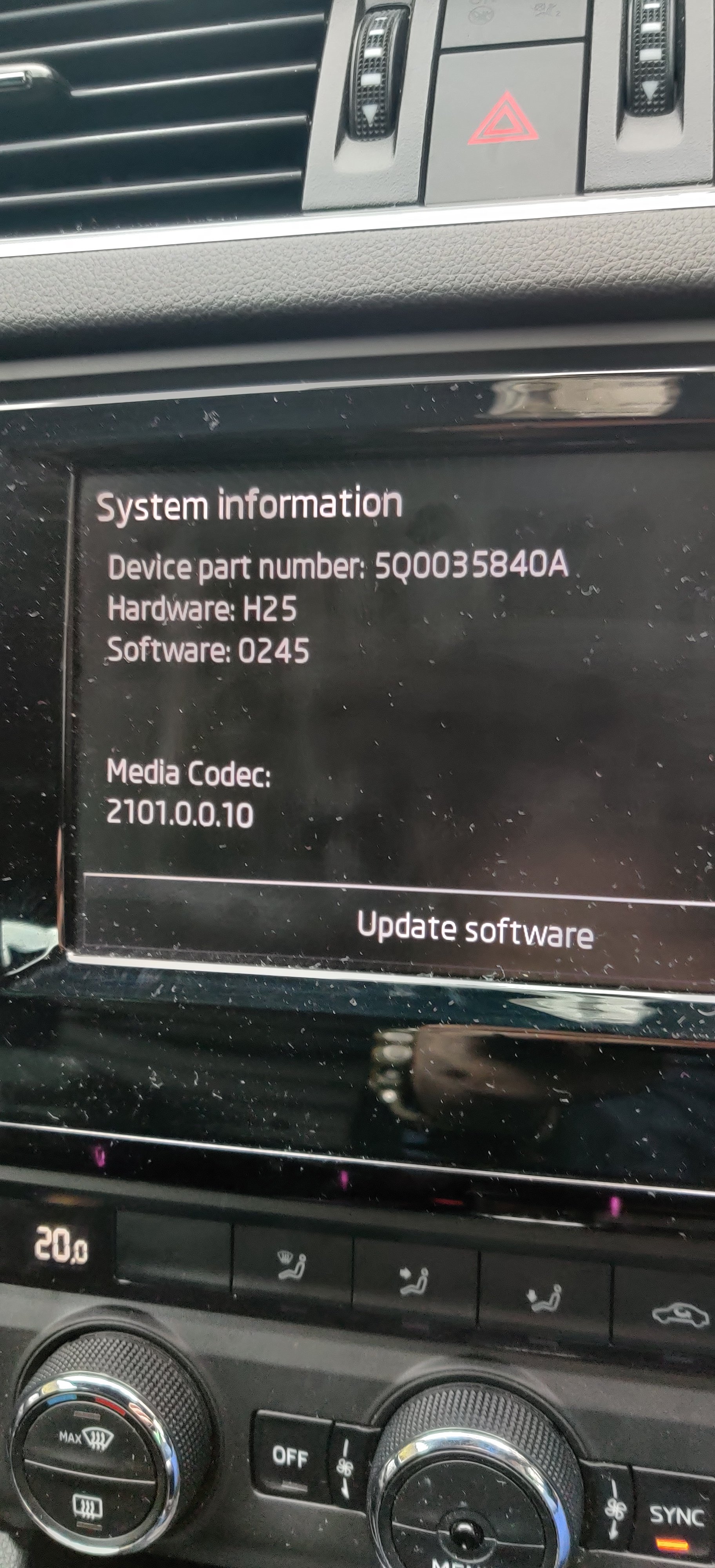

Having read through this thread I was considering upgrading my display to 5E0919605N as it was plug and play. I was almost certain my current system was MIB2 as it has android auto but just in a couple of previous comments I'm not sure. Can some please advise? Pic is of current setup.
@SashaGrace would you know if I am ok to plug and play as per my previous post? You seem to be all knowing in these areas 😀
Yeah that’s a MIB2 Bolero, 5E0919605N is plug and play.

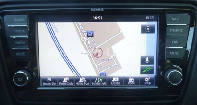

Hello all,
could anyone try and identify this beast? It's from 2014 Octavia (3/5E obviously) Elegance.
It appears to have Navigation and it's pretty straight forward about being Columbus. What could be it's buddy in the glove compartment? MIB1, maybe 2?
I'm sorry I can't provide more info, as this is a screenshot from online car catalog. I'm on the hunt for Octy, and would like to get one with decent equipment - Android Auto or something and big screen being among the top few on my wishlist...
