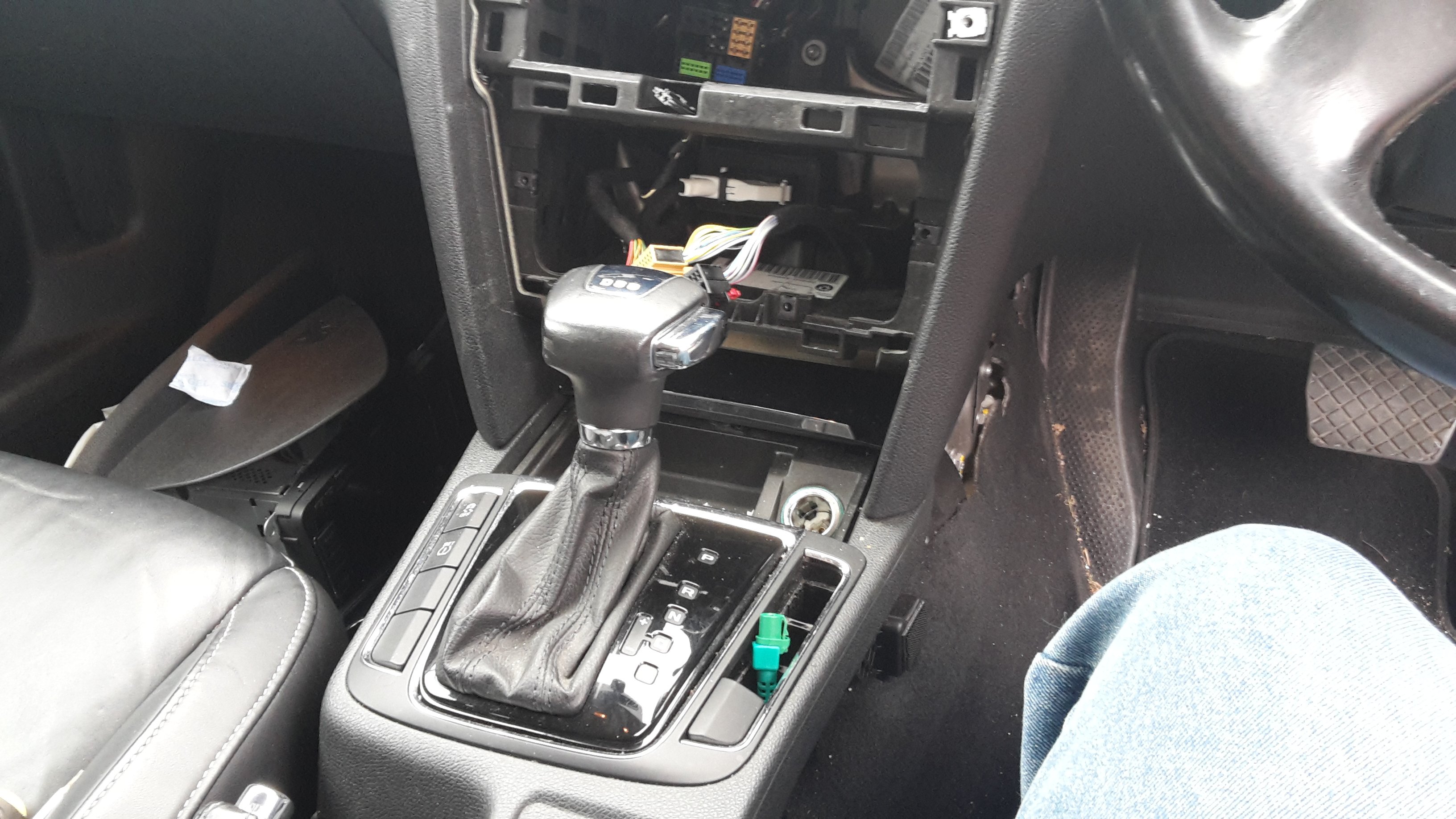

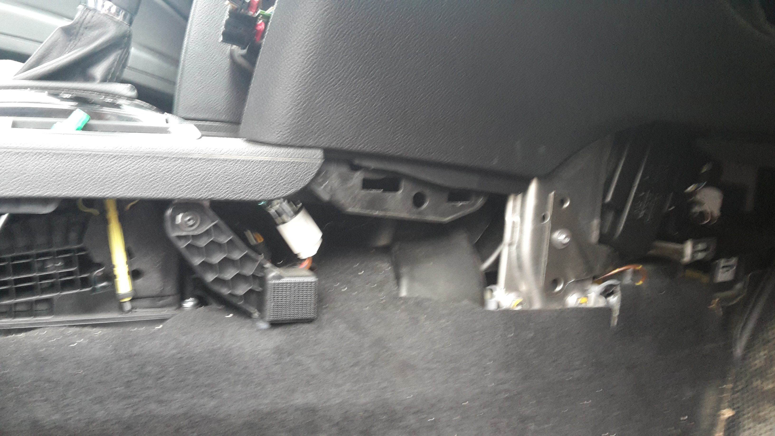

still waiting on the quadlock to arrive so today spent fitting the USB and GPS.
GPS i've placed on DS dash next to the pillar vent, matchbox sized and velcro'd down to move if need be.

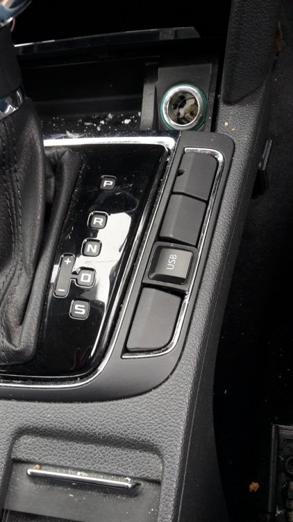

USB sort of fits in the switches at side of DSG stick, still undecided as to whether or not trim it and try to get it further down, not convinced it will go as flush but no great issue if not.

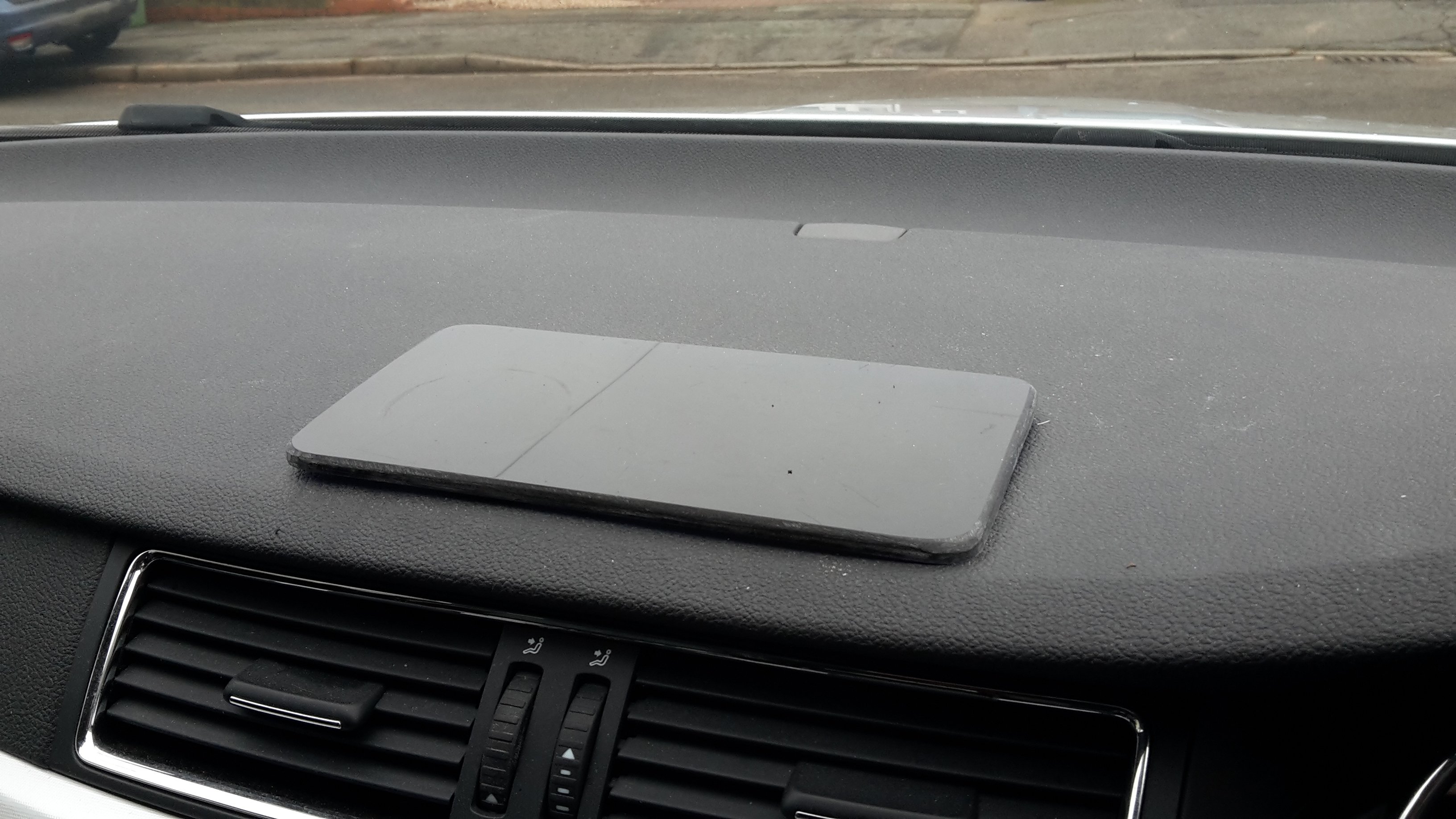

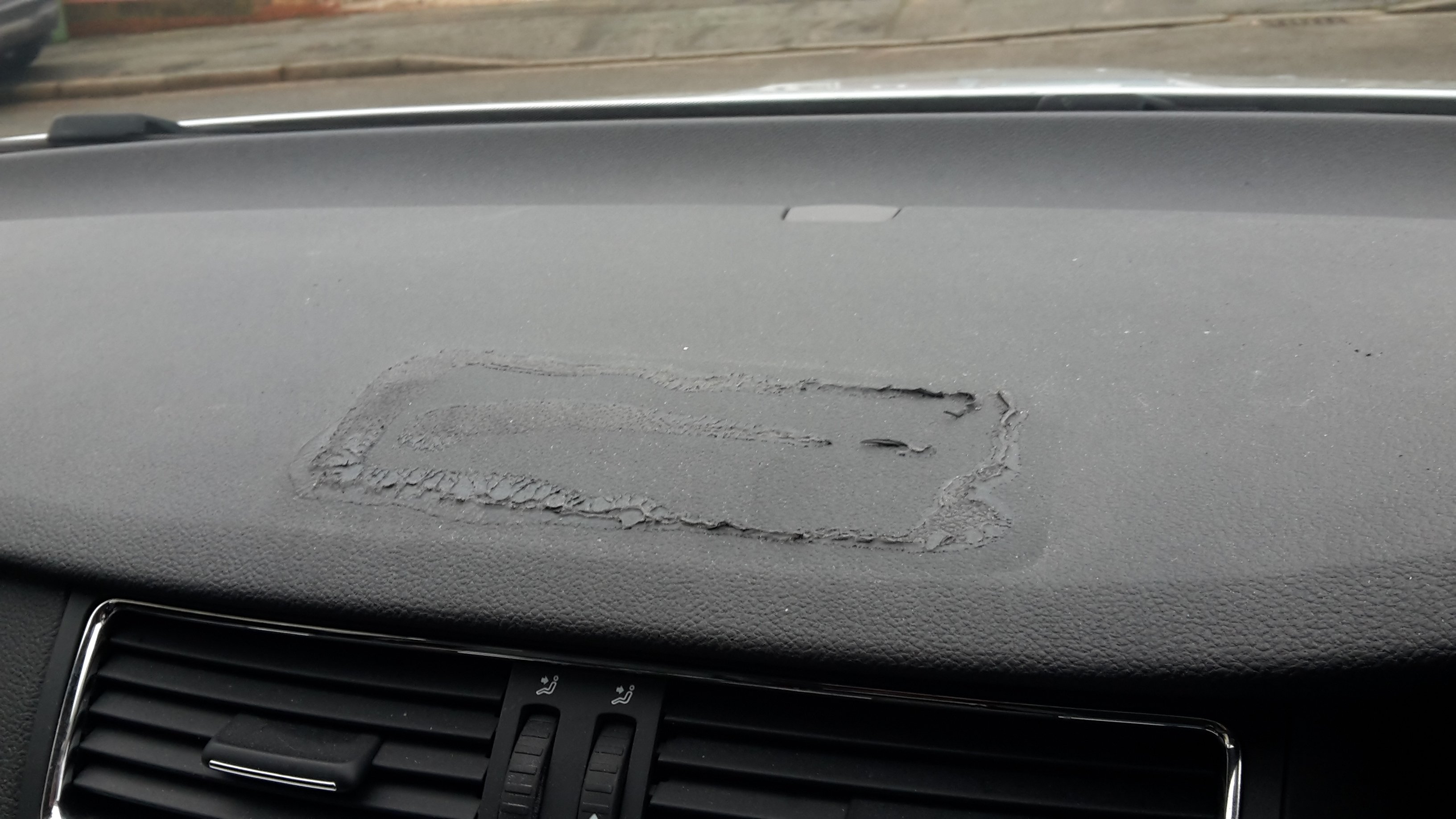

i also have removed this perspex plate off the dash, previous owner used it to mount satNav but i hate with a passion anything in my eyeline centre windscreen plus being shiny you see so many distracting reflections when sunny.
now i just have to try and clean up the dash, easier said then done i think....stand by for a patch of Carbon Fibre vinyl  :blush:

What was the previous owner thing when they glued that chunk of plastic to the dashboard!?

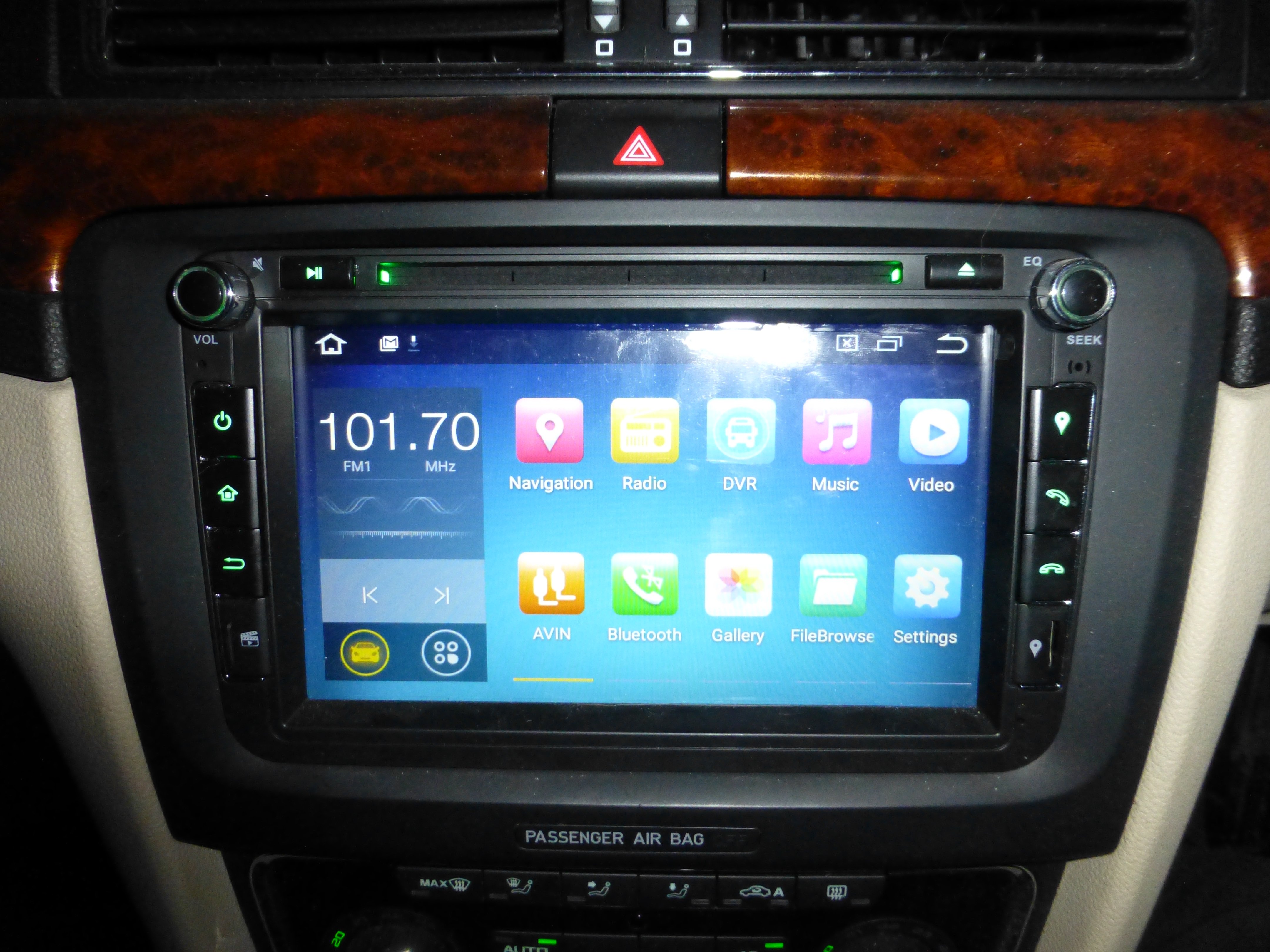

I've installed a pba android HU as well.  The only issue I had was I lost the compass heading in the maxidot, apart from that I'm very happy with it.  I used the existing GPS connection from the roof antenna.  The HU came with all the connectors I needed; the quadlock etc.  It had two fakra connectors for both the diversity antenna connectors.

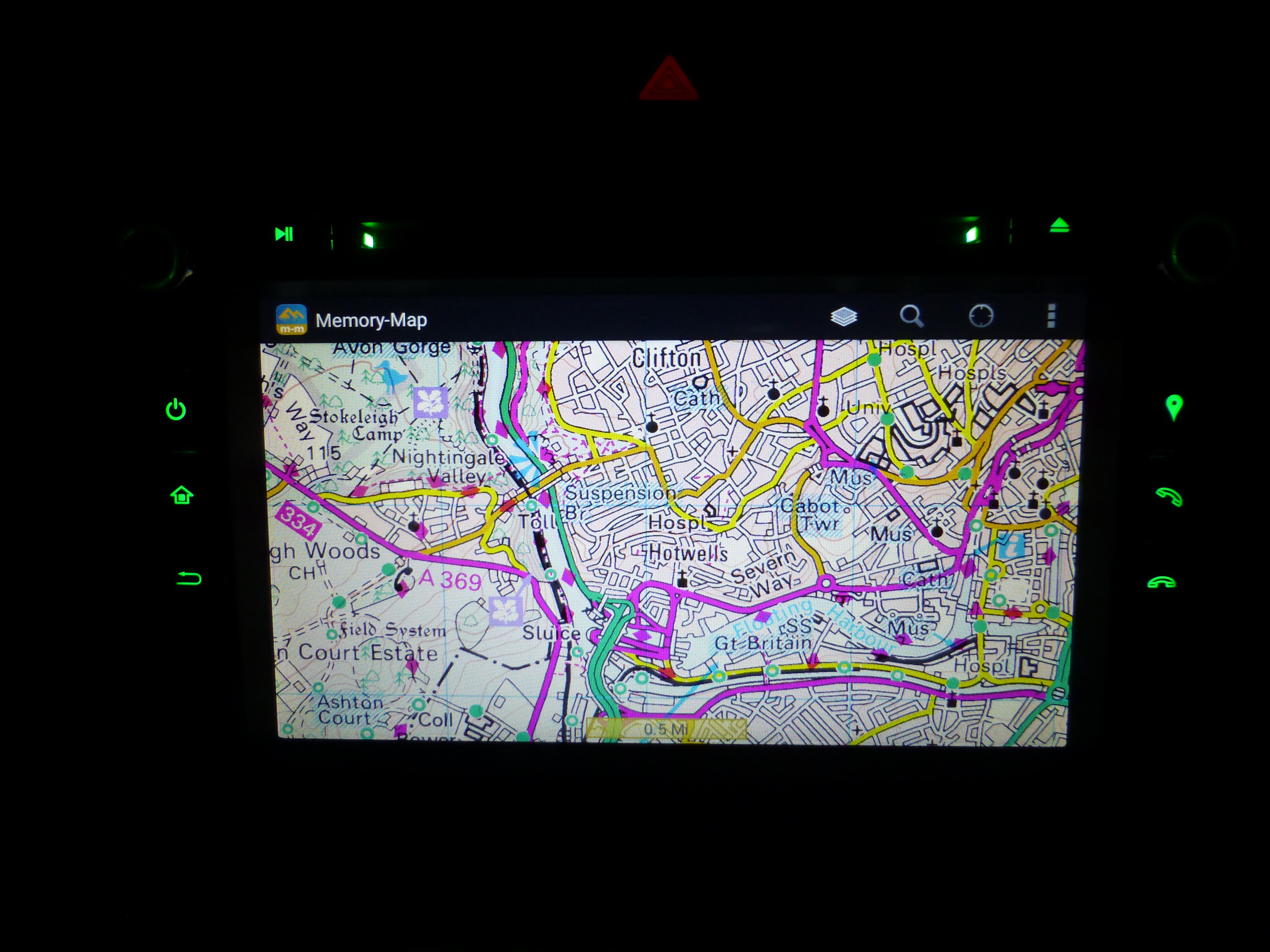

I prefer to use GPS mapping rather that a satnav, that just displays where I am on a map, so I use Memory Map.P1150588.thumb.JPG.cb3870c3c8ad0c38c2b4068816cb42b3.JPG

I can't make out from your picture, does the surround fit well around the headunit?

the surround fits as per the original.

that 'thing' is blue perspex, proper job....nicely routed edges, just a pain and i fear i may have caused more issues than sorted?  got 10 days before the OH is back to tidy it up

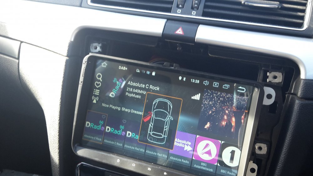

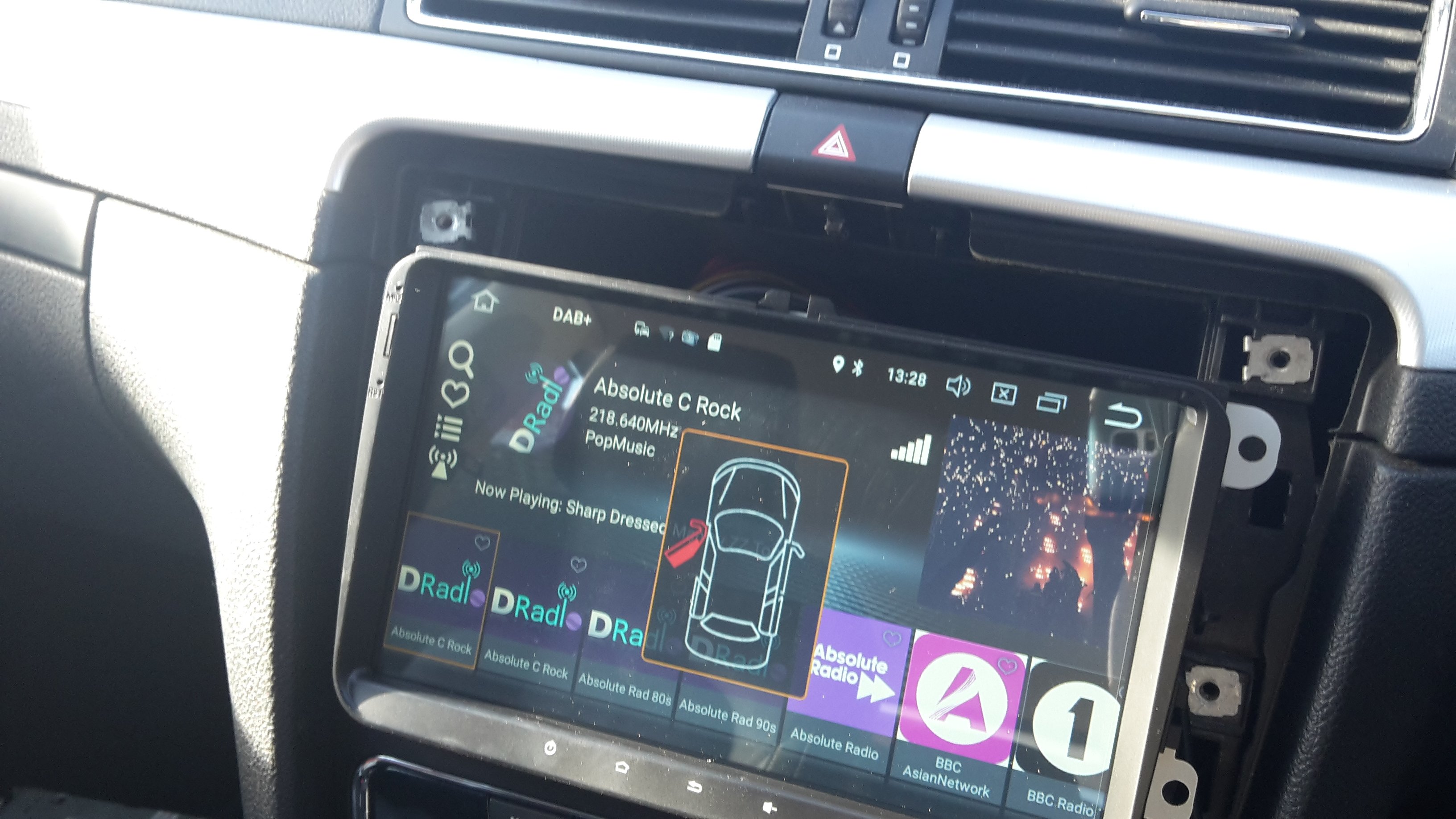

Quadlock ready, breakfast done and out i go for a quick test, i'll update as and when

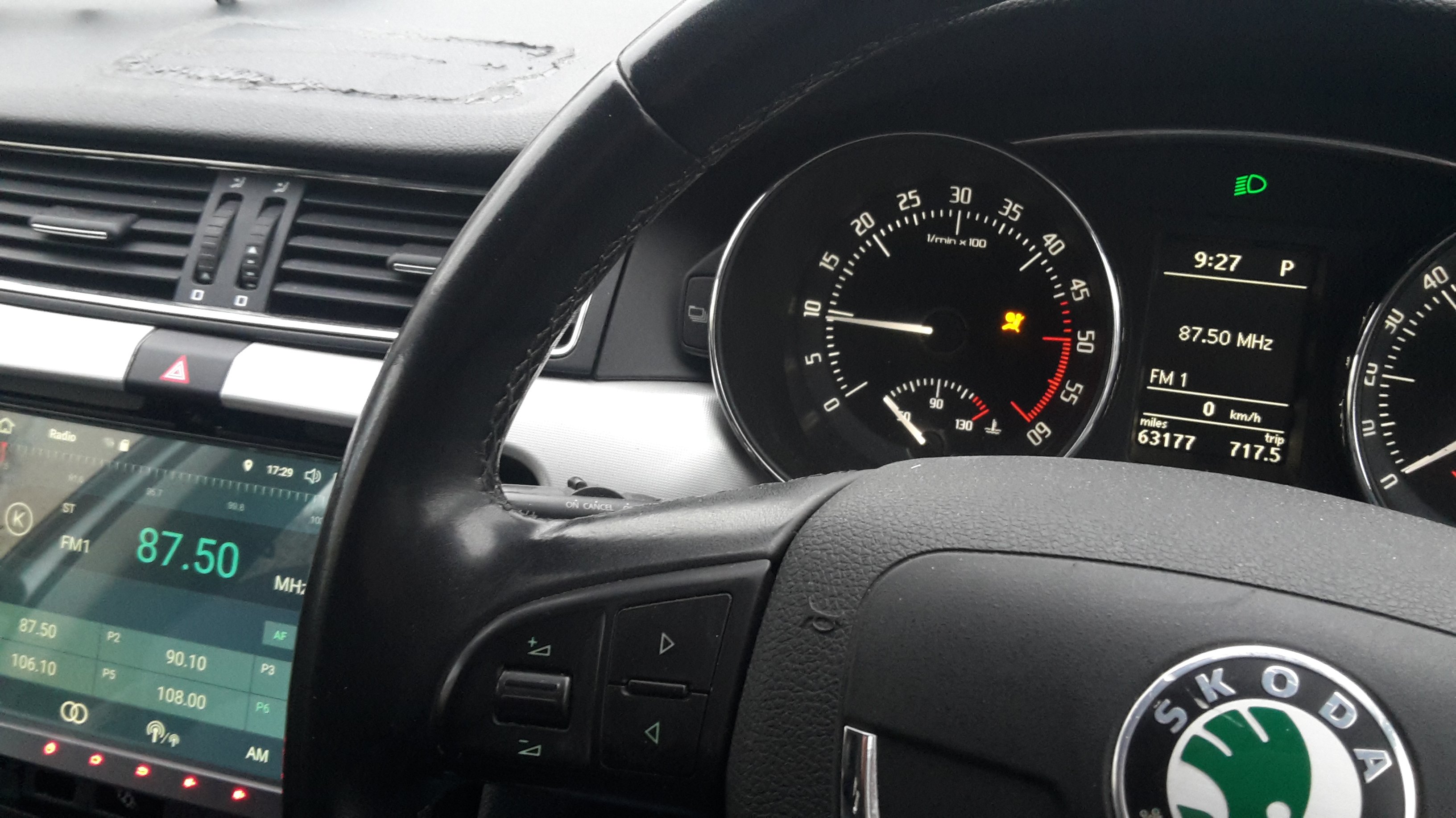

connected up apart from the radio aerial and DAB so i can test the unit, well make sure it works before i get too far!
booted up OK, i'm a few Android versions behind with phones so may take a little getting used to.
volume and station seek on steering wheel appear to be OK, Nav on the maxidot not sure about yet but i don't use that anyway in the Caddy or Skoda.

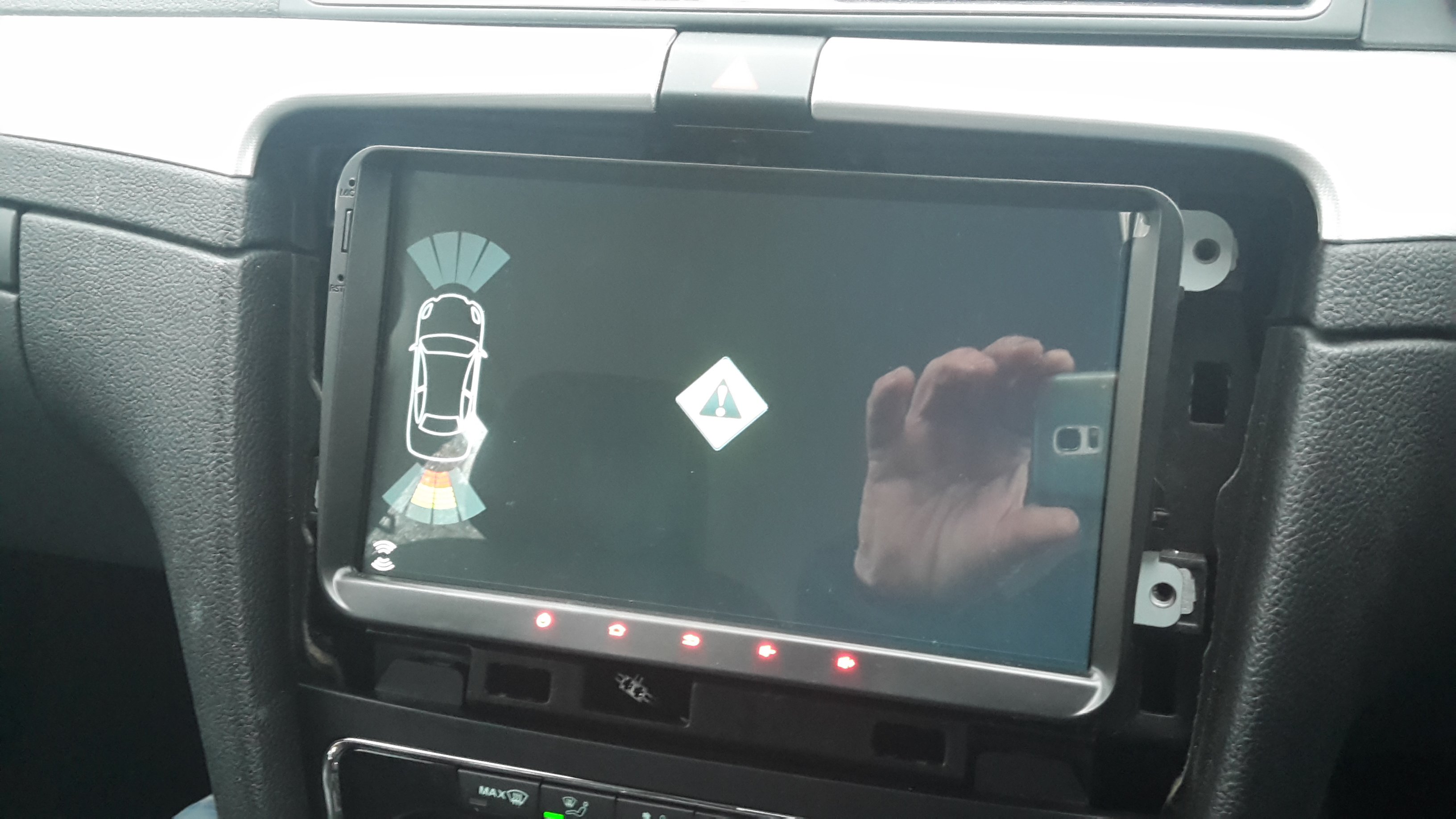

Reversing shows up albeit not as large as the Columbus but as you know i disregard that anyway  :biggrin:

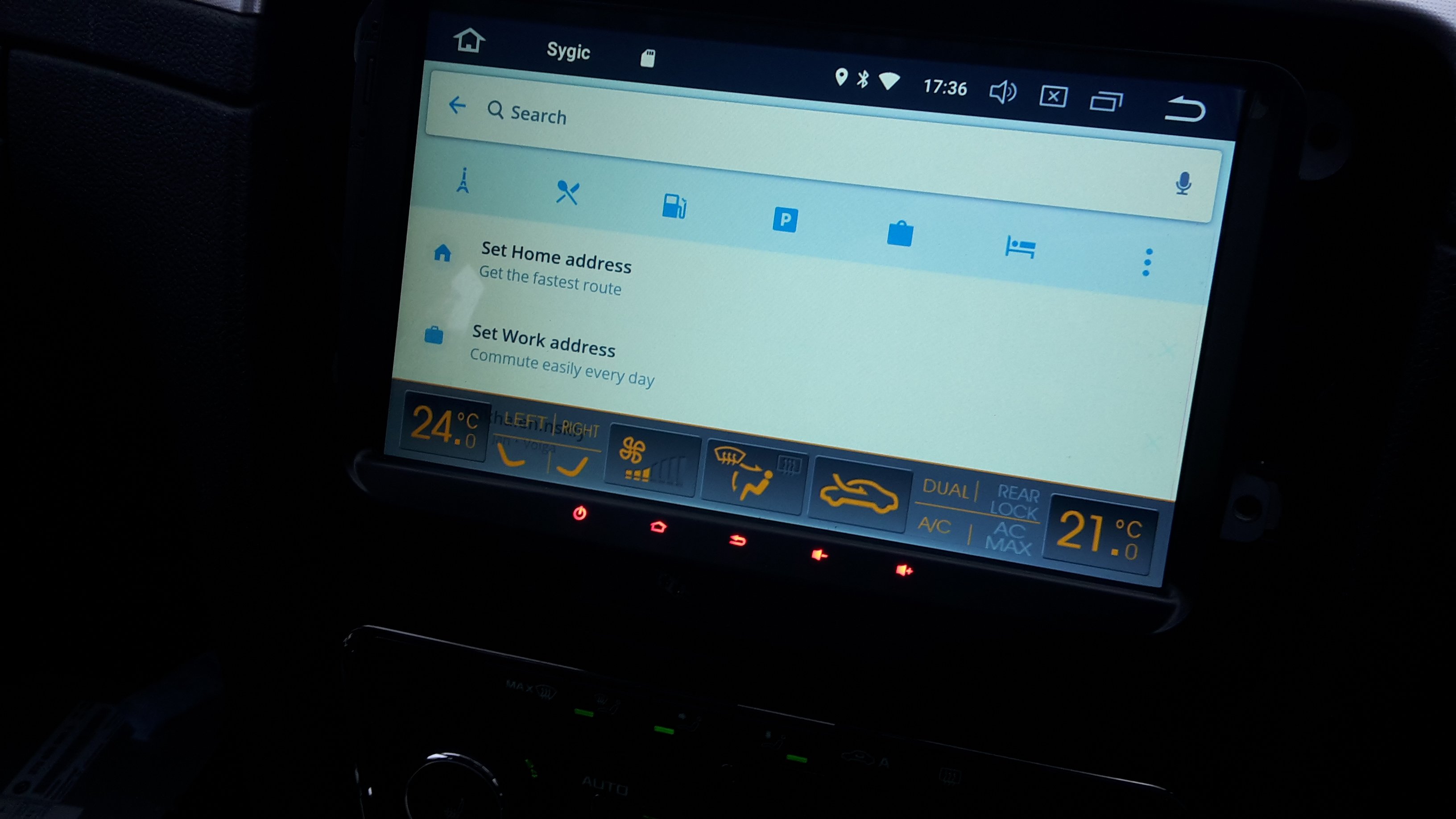

Climate controls are in a strip at bottom of screen, i can't even remember how it used to show! but at least they are there.
plenty of Nav options on there it seems, some i've never heard of, plus any others can be downloaded anyway

Google assist does work, i've never used it but i managed to find an Asda near me.
Phone used as hotspot for the HU to connect to so no need to physically connect, A2DP for streaming and full function for phone calls, nice big screen and buttons as well
door open display on the front doors at least is reversed for some reason, i'll probably find it says the bonnet is open when estate is opened!

DAB is in and out but may just be where i am signal wise although i am up quite high but we'll see.

USB retrofit isn't working as yet, again needs a check over at some time.

You can reverse the doors somewhere in the configuration options - mine was reversed too initially.  Check the manual or email audiotechdirect.

i've sort of sorted the door issue, front ones are right but rear passenger doors are still reversed, tried all sorts but hey ho how often do i get out of the rear doors?

the USB is still playing up, even plugging in just a lead into the spare slots isn't charging a phone let alone passing data, some more investigation/emails i think. i couldn't see any activation options on the factory settings menus other than DVD / DVR etc.

doors all sorted, numpty forgot to press apply after each change  :blush:
all 3 'normal' USB outlets are working, it's possible i may have some cables that are charging only not data - i think from Garmin days to try and stop it thinking it was connecting to a PC in the car
used a cable that came with it and works.
the OEM USB outlet still not working, cheapo cable ? but thinking aloud is it possible the Canbus needs the rSAP still connected? i unplugged it to stop my phone auto connecting.

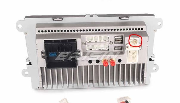

I found that the pba HUs from AudioTechDirect seem identical to models sold by Erisin at https://www.ebay.co.uk/str/erisineu88
My unit is  https://audiotechdirect.com/pba-vw7815v-8-android-8-0-after-market-radio-for-vw-seat-skoda/  which is identical to https://www.aliexpress.com/item/Erisin-ES7815V-8-Android-8-0-Octa-Core-4G-RAM-Car-DAB-GPS-Stereo-System-for/32860357803.html
Olduns pba VW3818v looks very similar to Erisin's ES3818V at https://www.aliexpress.com/i/32953864792.html
i reckon they're all the same, looked at Pumpkins as well and Xtrons, i just went with someone it appeared i could at least email or shout at over the phone if needed :)
mine is the Erisin one, back is identical, picture on Audiutechdirect is different.

OEM USB connection is where the red circle is
