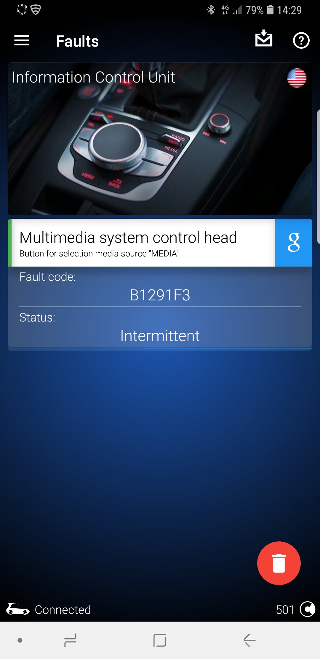

Alan - this is normal for the GVN60 retrofit.
You are correct, the error is from the Media button having an additional designation. The "fault" is nothing to worry about and does not need to be reset. You can clear the fault however, it will return every time you use the satnav.
Picture from my car:
Thanks for your help, much appreciated, Alan
