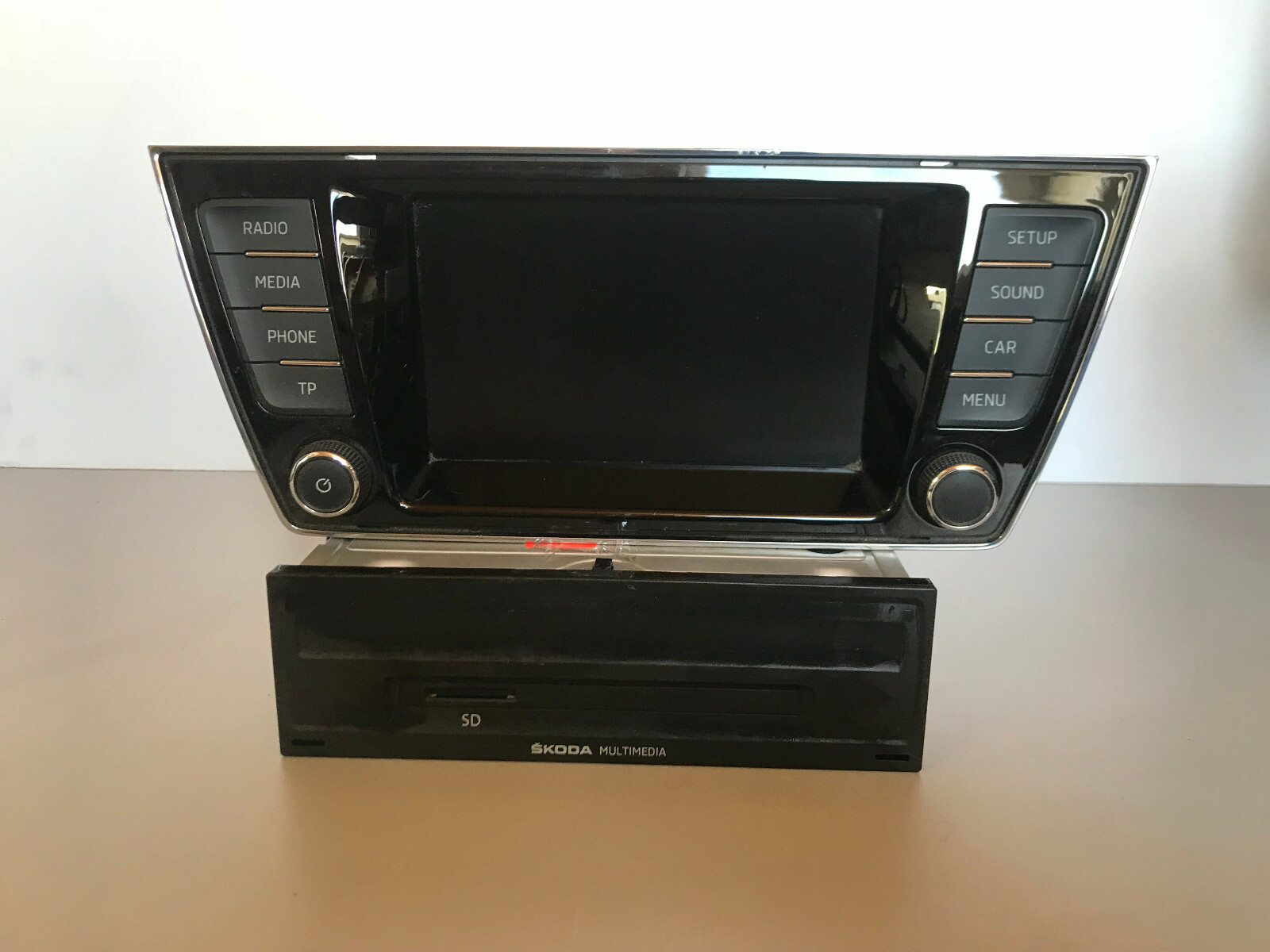

Got a picture of your radio? Curious to see whether it's the same style as in the OH's Polo versus the style in my Skabia.

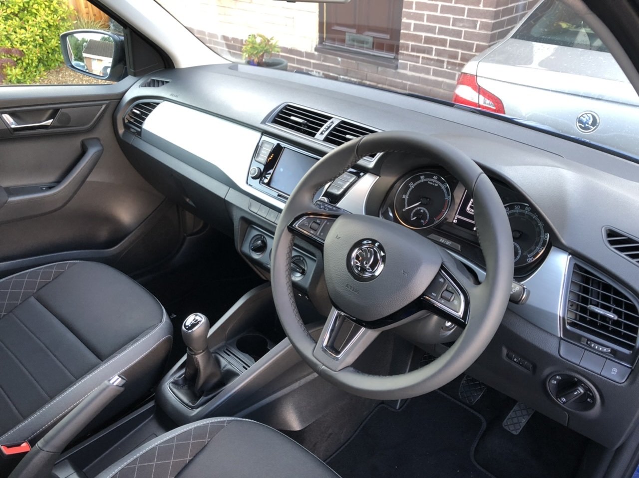

I'll get an image at some point of the unit in my car, but it's the larger display, no navigation but it has full android auto/apple carplay support. 2016 SEL with most options.
This is the style in her Polo, FYI. @FabiaGonzales
Mine is like in this image;
There's a newer version with different buttons & voice control;

This is a picture of our HU in our car and is the model that has worked perfectly with an iPhone 8 Plus, iPhone SE and iPhone SE (2nd gen) with a 30cm Anker lightning cable for the last 12 months since the car has been on the road.
