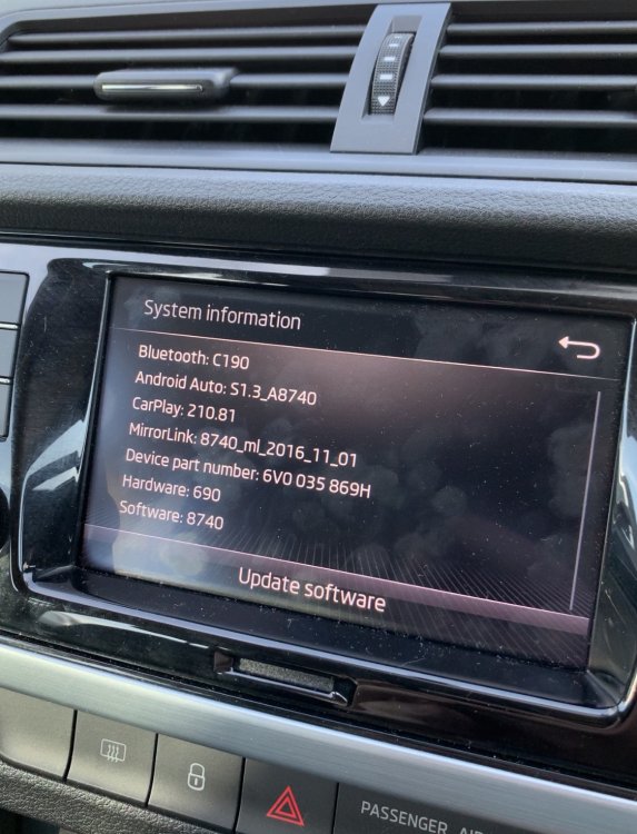

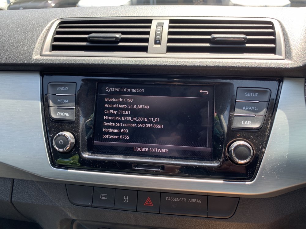

I’ve recently bought a 19 plate Fabia Monte Carlo and can also report this frustrating issue. I’ve experimented with 2 different iPhones, and 3 different lightning cables (1 original Apple cable and 2 aftermarket MFI cables). The problem is actually worse on an iPhone 11 with iOS 14.1 than on my iPhone 5S with iOS 12.4.8. I’ve deleted the car from CarPlay on the phone, reset the Smartlink settings to factory on the car head unit, and reestablished the CarPlay connection, all to no avail.
I’ve entered my VIN at https://updateportal.skoda-auto.com and it says there’s no software update available for the Swing head unit in my car so I’m really interested to learn more about the software version referred to by @Rizzoed. I’ve contacted the dealer that sold me the car in October to see if they can offer any help. Fingers crossed as they’ve been very good so far resolving another minor issue rather than fobbing me off as is far too common.

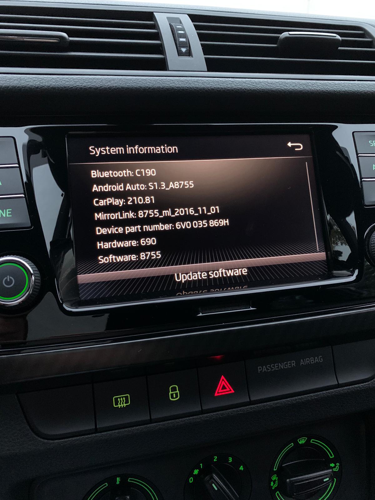

My software versions match those photographed earlier in the thread so it’d be interesting to know if there’s a later version otherwise CarPlay is practically unusable for audio playback.

I was at the dealer for about 1h30m. Haven't used it much, about 500km in these past 2 months but yes the playback seems to have been fixed, can't say much about the call quality. In the end i decided to sell and now i'm searching for an S3.

Skoda dealer had my car for an hour in November and updated the software to the version shown in Rizzoed’s latest photo. 3 months down the line and I can confirm the issue is  resolved. Why this needs a visit to a dealer and not a download and home install is another question...
