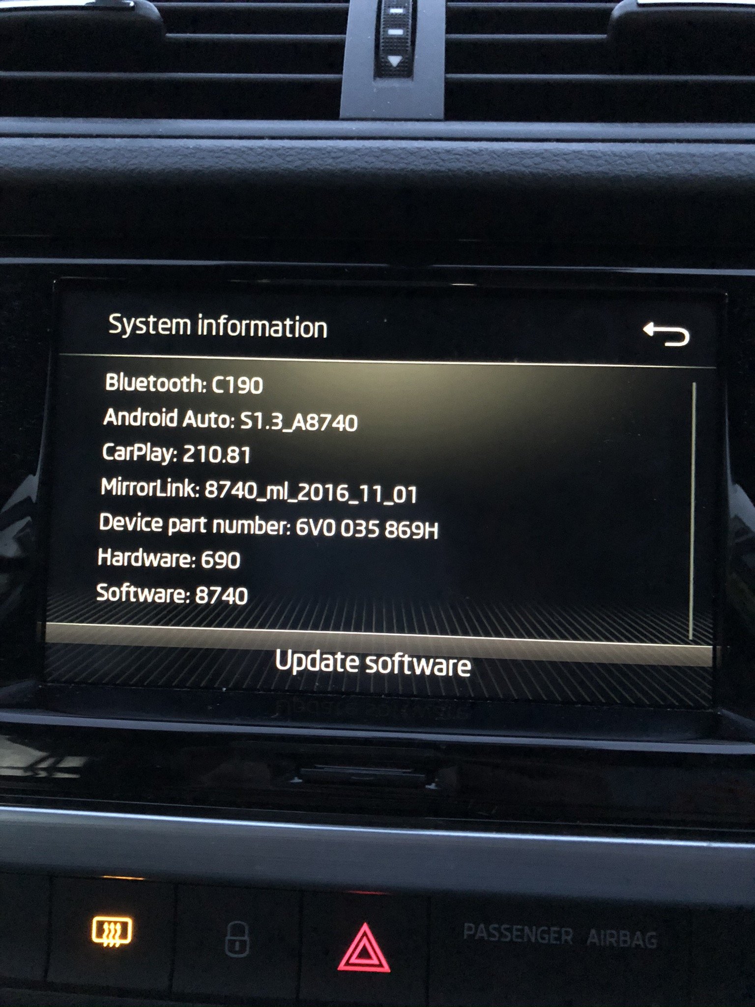

Just wanted to add details of our system which as mentioned previously doesn’t seem to stutter.......
Do these match up with others‘ systems which are having issues?
I have the same details as you and I have the stutter issues.
I have the same details as you and I have the stutter issues :-(
Same as above.
interesting...... So if it is a software issue as Skoda are saying then it must be only affecting systems that are connecting to a certain handset or iOS version....... Or as FG says could it be the cabling between the socket and the HU that is at fault depending on what quality of cables the current batch are when they are installed in the car in the factory?
It certainly doesn't seem as simple as first suggested and may explain why it's taking them so long to try and rectify.
