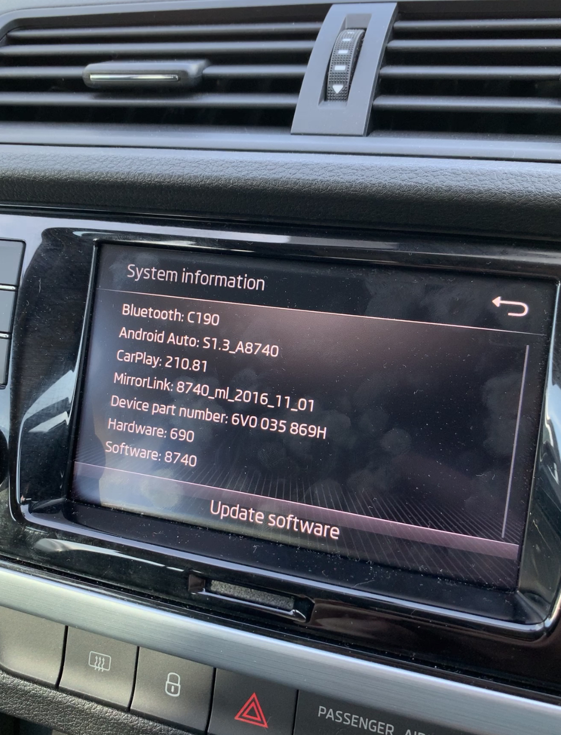

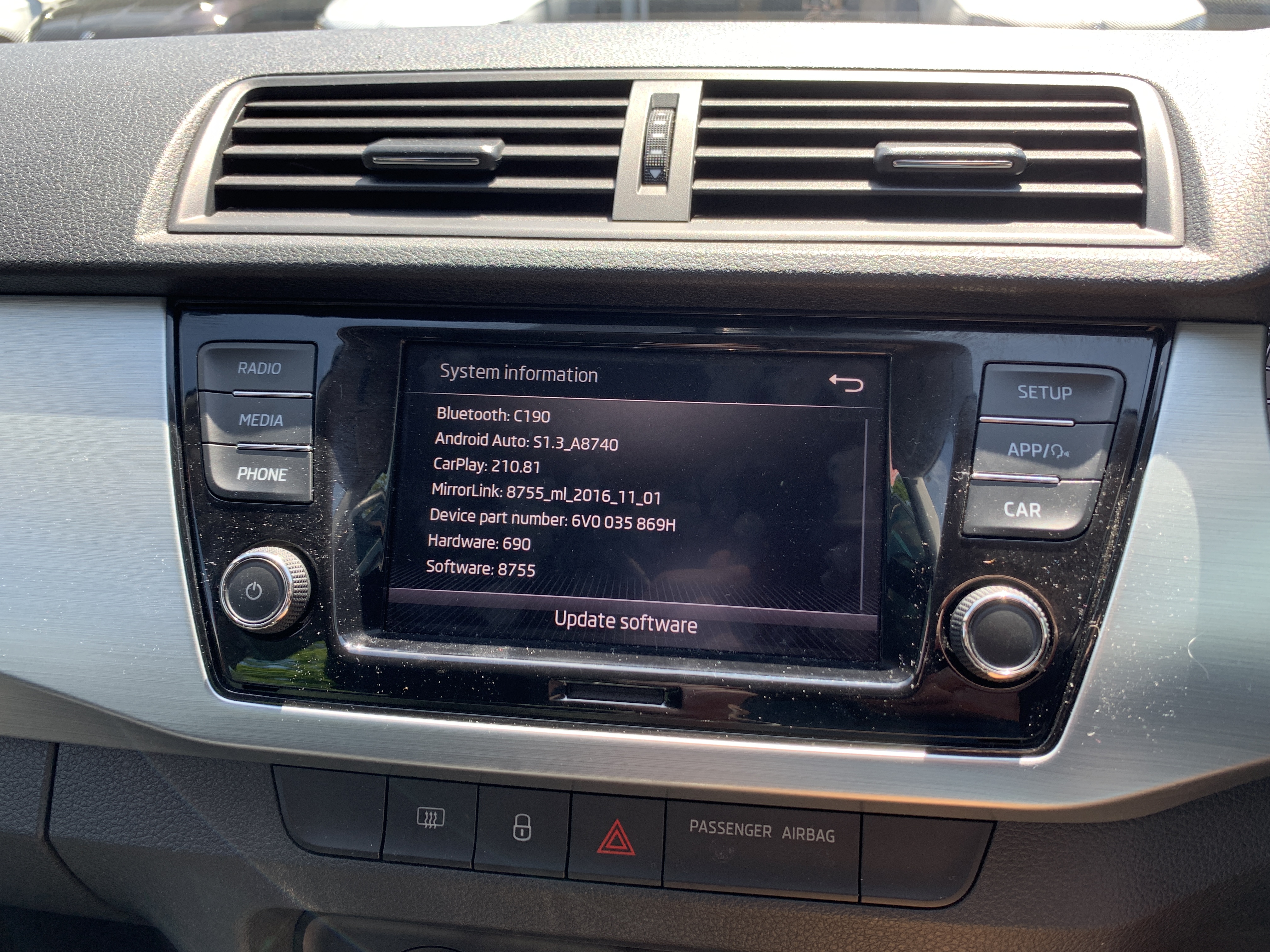

Just had my car updated to 8755 at Johnson’s Skoda Birmingham with no issues.
On the 25 minute drive to the appointment CarPlay stuttered 8 times. No issues at all on the 1 hour drive back, apart from traffic!
Before and after system screens for reference...
