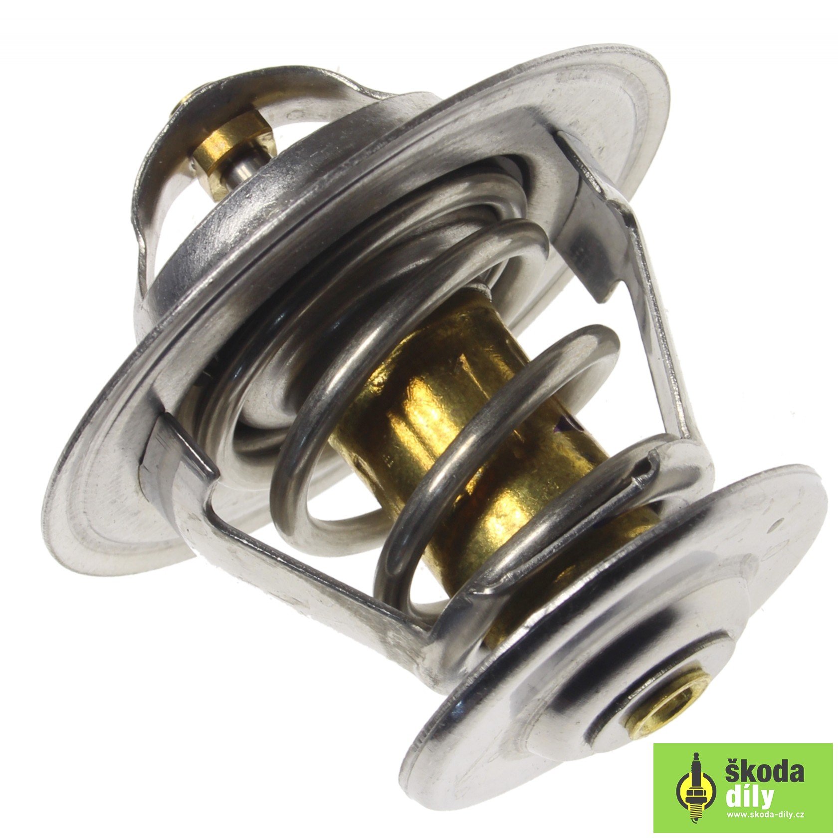

HI Ken... I will change thermostat, 10€ is part, no problem. Few services that I visited, all repairman said to me that is thermostat is OK. I have one more question, regarding thermostat, I have two options to buy, pictures are enclosed. By chassis number, shops can't really tell which one goes in my Skoda.
Thanks again.
This engine has been in production for so long that you need to be able to identify the part in this specific unit. If the chassis number is returning 2 different stock codes, you'll need to examine the actual part fitted, and I can't do that from the far side of the continent.
Yea, I understand you. :-) Will do. I'll send remarks after I change Thermostat.
Regards and thanks Ken.

Should be the lower photo, I think. Item 8 here: https://skoda.7zap.com/en/cz/felicia/fel/2001-101/1/121-121013/
Part number 044 121 113
Thanks Mr Wino.

Hi all... thermostat is with me, 750 rsd or little less than 6€. On Saturday morning I will change it. Fingers crossed.
Hi guys...
Thermostat was partially stuck, so temperature is in OK range now.
Can kicks in at around 100C, but rarely temperature gets above 90C.
Thanks all for your time and knowledge.
