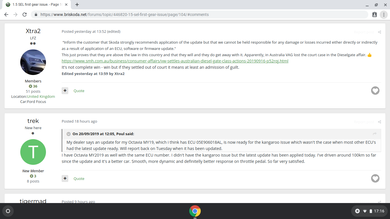

7 minutes ago, Roottootemoot said:
When it is a real RECALL then it should be on the DVSA Site and Skoda / VW Sites and all Registered Keepers contacted with info from the DVLA,
if just a Recall Action and not a Recall then they are just playing with words, and no different from a Service campaign.
Ah, but this is Skodaland where words mean anything that you want them to mean! 😉
Which is why you need to always ask them to confirm in writing and to put their job title and name and sign it.
If they are not prepared to they can find someone that will who can take reponsibility for their actions on behalf of their employers and who they are carrying work out, so VW Group.
Especially as Skoda / Dealership are asking owners / customers some dodgy form of permission to experiment on their property.
