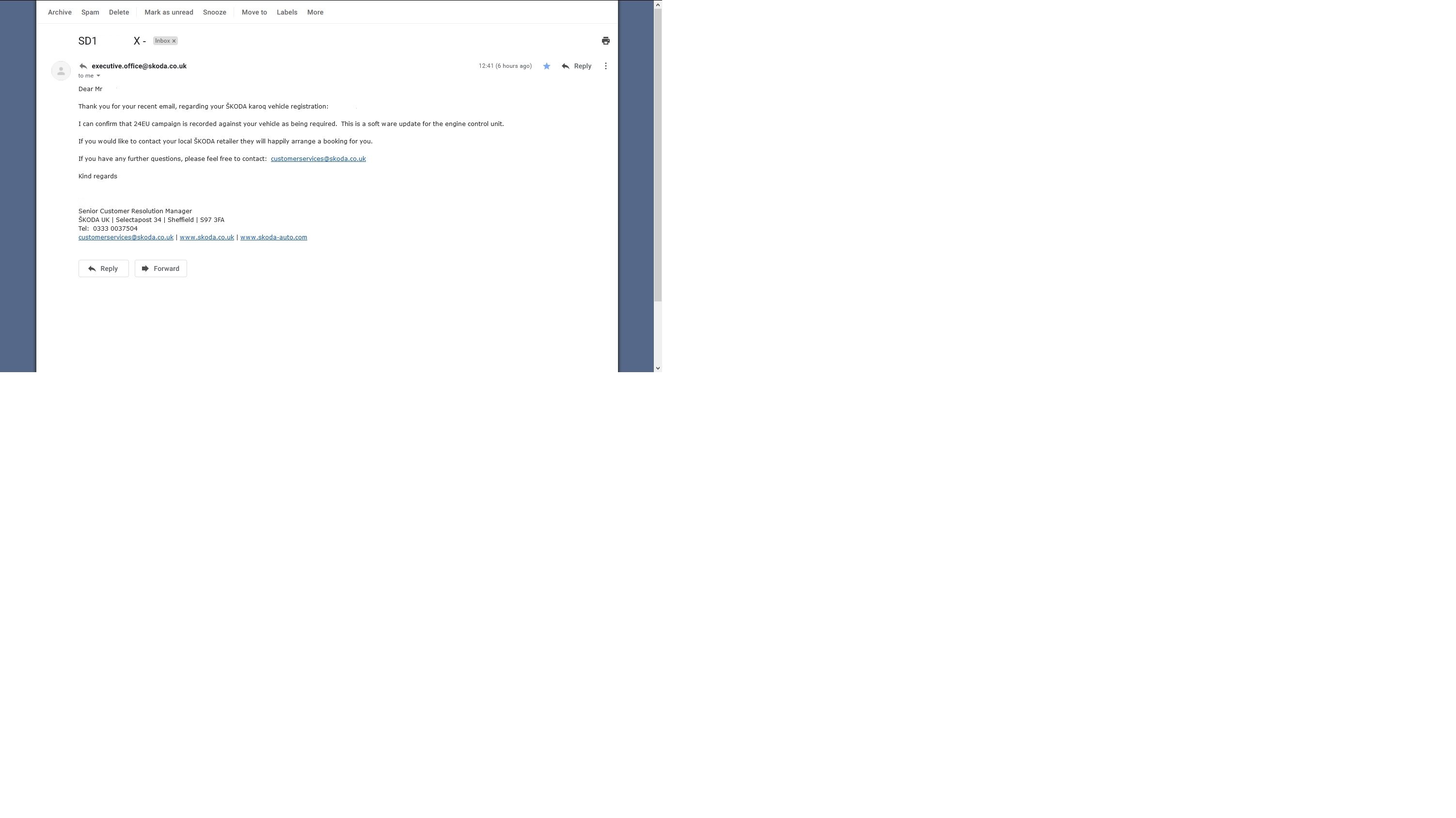

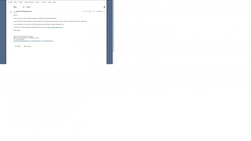

I used the SUK online Chat recently to find out if my Karoq required the 24EU update, after giving the CS person the VIN I was told it would require the update which was also confirmed when I contacted SUK by email, for the time being I will not get the 24EU update applied until I find more about it from my local Skoda dealer/retailer and maybe not even at all as the engine is running fine just now.
I wonder if not taking the update could make a certain claim on the warranty invalid e.g. engine related?
