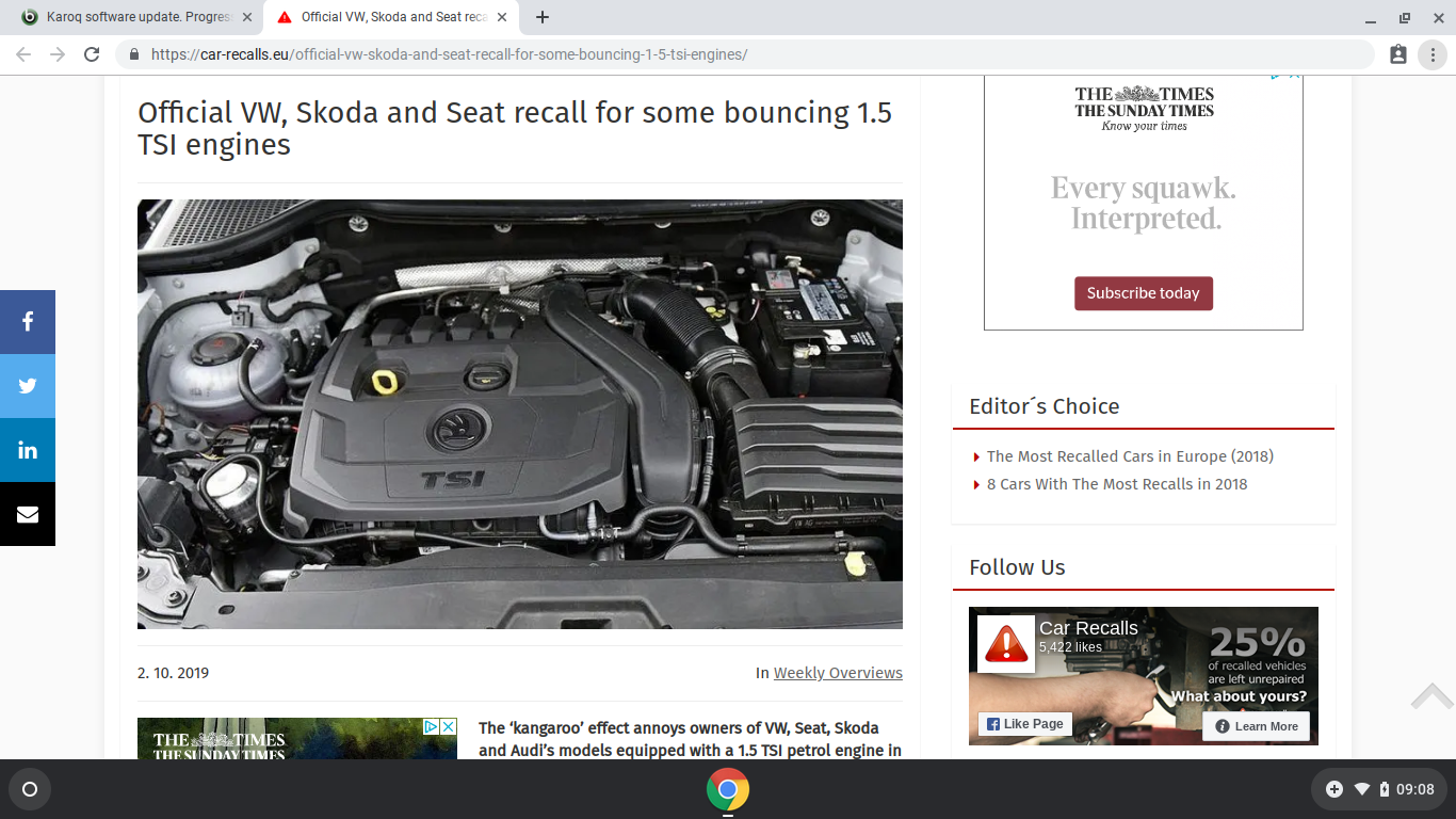

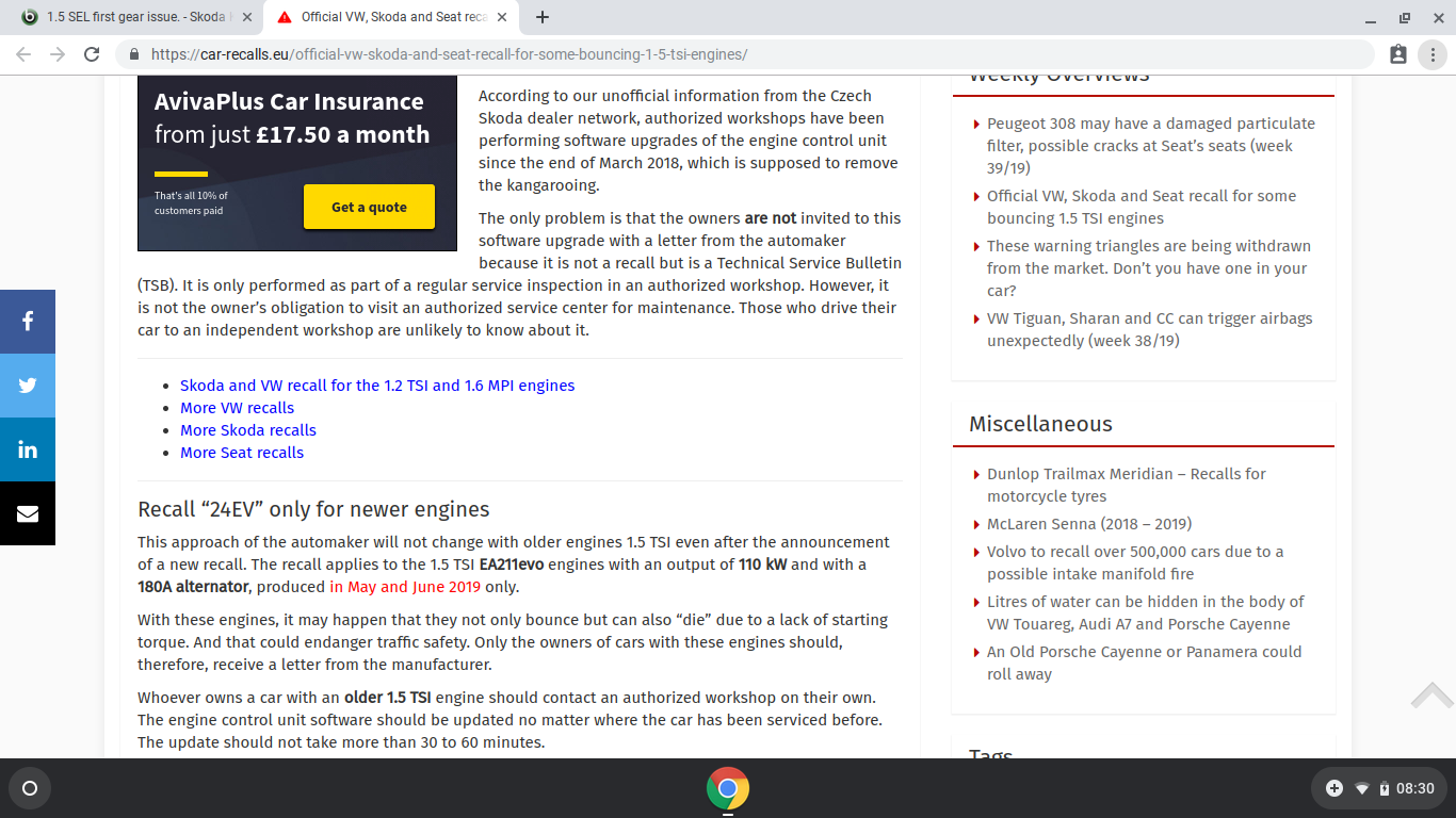

When is a Recall or Recall-Action not a Recall ?,
when VW Group do them and they are 'Service Campaigns / Skoda Secret Service recall actions that you need to do the finding out about as Skoda are not contacting you.
Just pathetic that,
People need to get Un-official stuff from various places rather than given the info from the Manufcturers / Main Agents / Importers.
Edited by Roottootemoot
It's  now quite obvious that all this maneuvering by VAG is 'damage limitation' recalls applying only to the lowest volume of engines affected by manufacturing date and 'software maintenance' to the other thousands and thousands of earlier production engines.
Disgraceful treatment of customers.

Hmmm not sure there is a difference in approach the software maintenance is for all?
Maybe I am missing something?
Is there a software update available for all vehicles with issues then?
If so, it is,
Forall that are putting a car into a Main Dealership for Servicing where they might be informed.
But seeing as a car is in Warranty get booked in without and extra service expense required.   Recall Actions.
Makes you wonder!
What about people who have had a service before the updates are released? They will  not know of the availability unless the dealer contacts them, what a shambles this whole debacle is.
