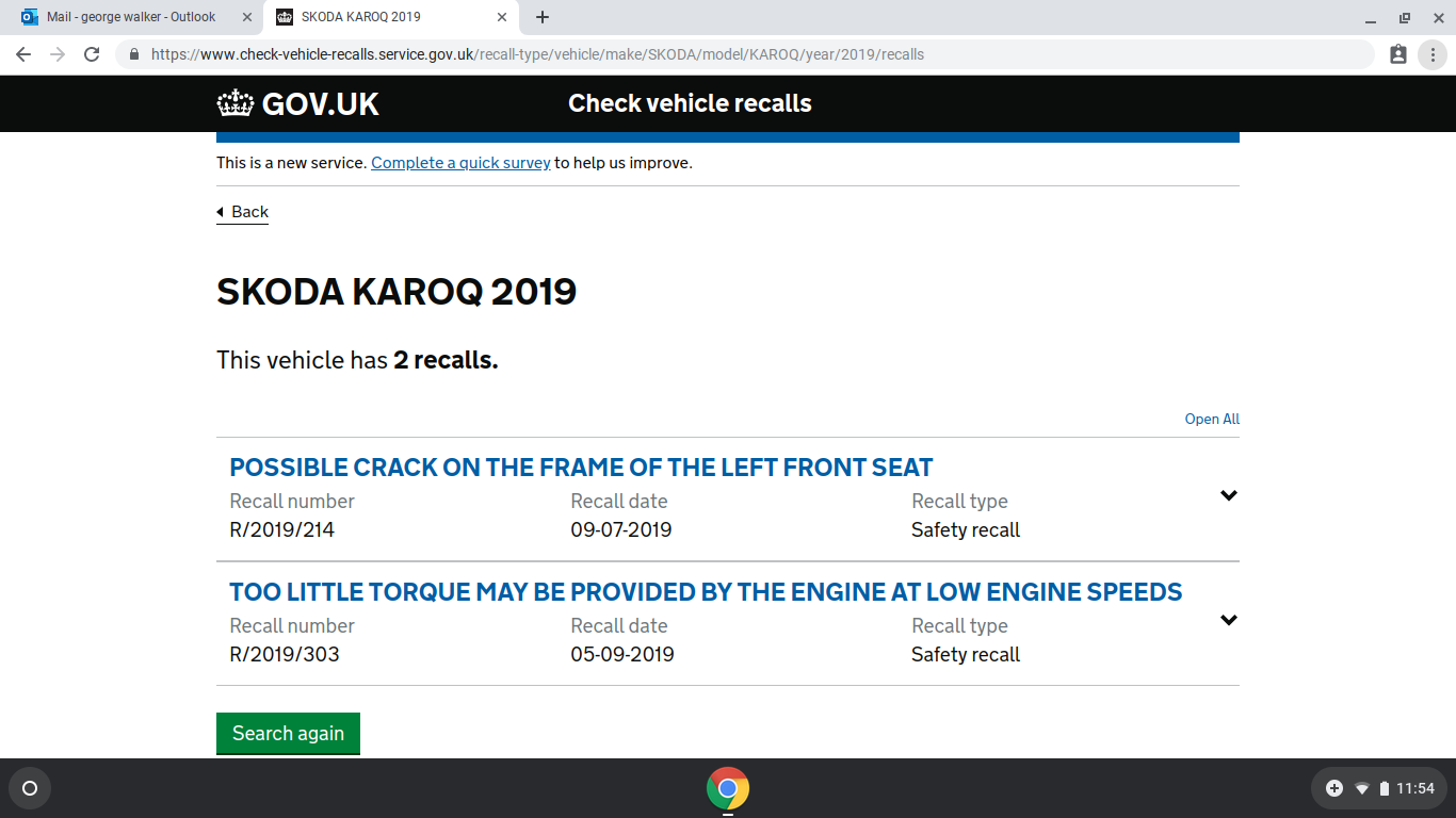

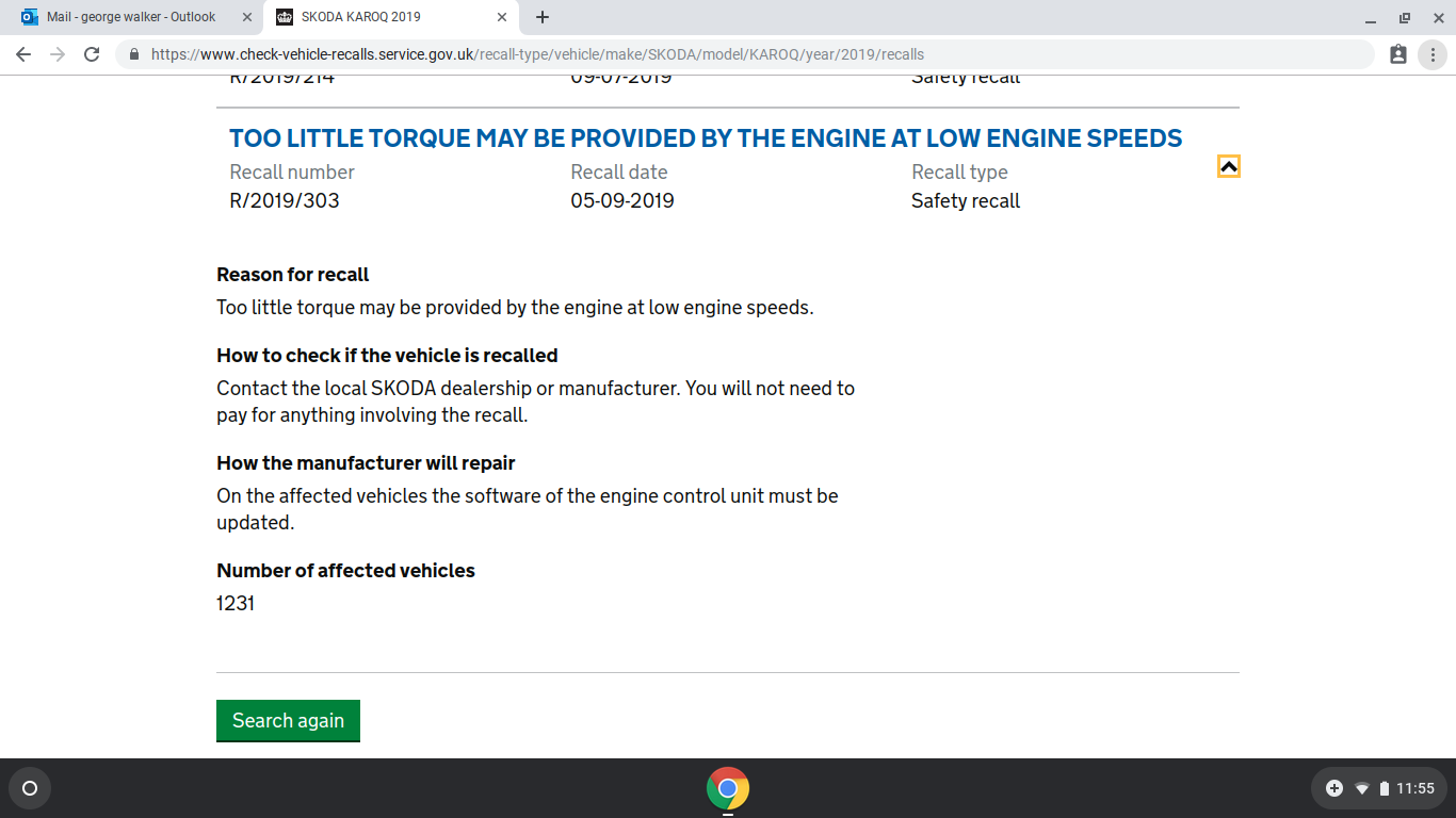

So strange that if you check the DVSA Recall site it shows for Karoq, Octavia, Superb or Kodiaq that 1231 vehicles are part of the recall.
That is for 2018 & 19 when checking.
DVSA & Skoda might need to explain that one.
Is that the total number of 1.5 TSI engine Skoda across 4 models that might be affected?
Doubt it!
If Safety Critical and a recall then Letters should be out to Registrered Keepers, so have 1231 letters gone out?
