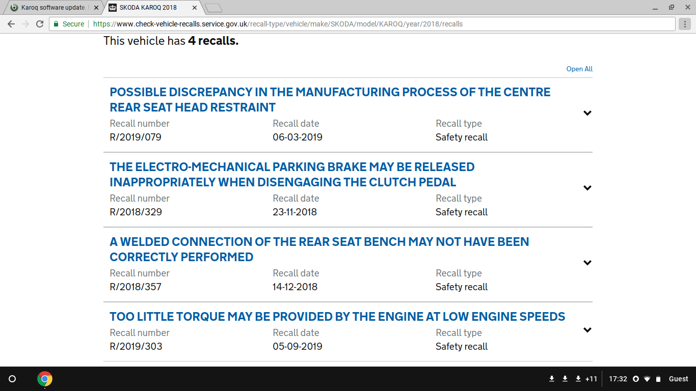

Unreal how people who work full time in Dealerships do not know what is a Safety Critical Recall, or a Recall Action or just Service Campaigns which is all they are doing with Software Updates.
Safety Critical is what engines dying or DSG's losing drive is though and the DVSA in the UK know that.
http://car-recalls.eu/make/SKODA
http://skoda-auto.com/services/recall-actions
http://gov.uk/check-vehicle-recall
Somehow VW Group get the DVSA to believe the issue is just with manuals, they have it all in hand, yet agents for them in Dealerships are mumpties quite often.
