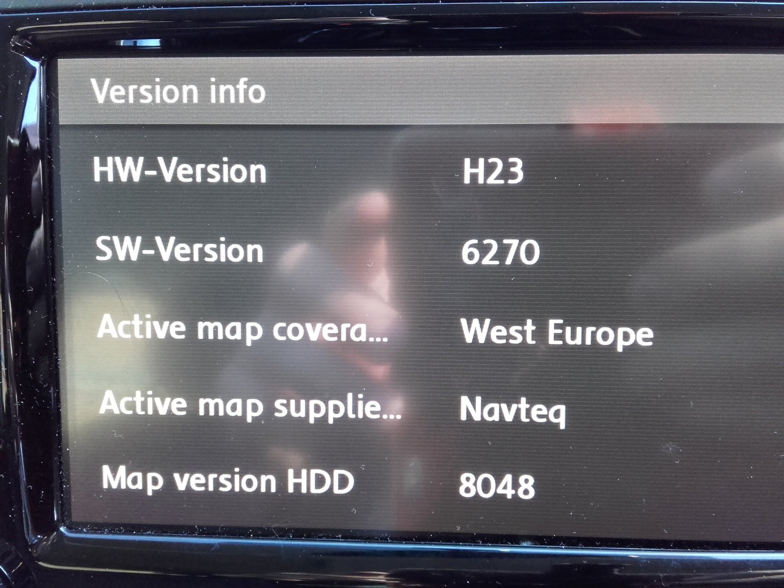

Version inof shows HW version H23, SW Version 6270 , Map Version 8048.

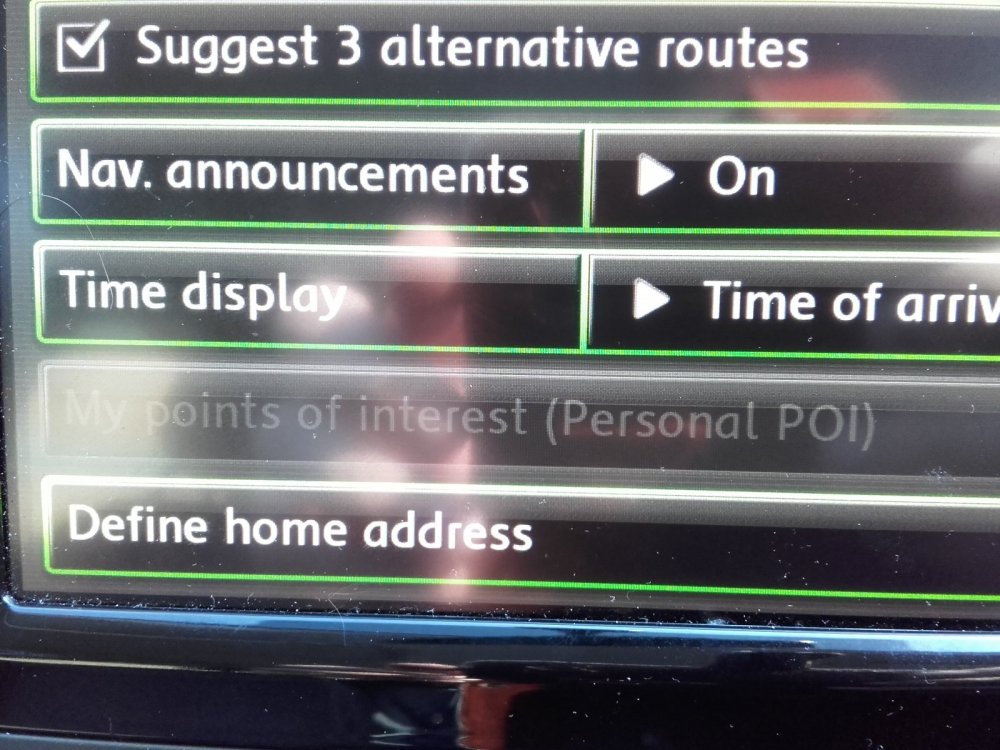

Press "Setup", then touch "Navigation", then touch "My points of interest (PersonalPOI)" and see if it has "Details" highlighted or greyed out.
Hi " my points of interest " is greyed out in Navigation setup as i mentioned in my first post. Clicking on it doesnt change it , it still stays greyed out and inactive. Any further suggestions
Did you follow the steps in my previous post?

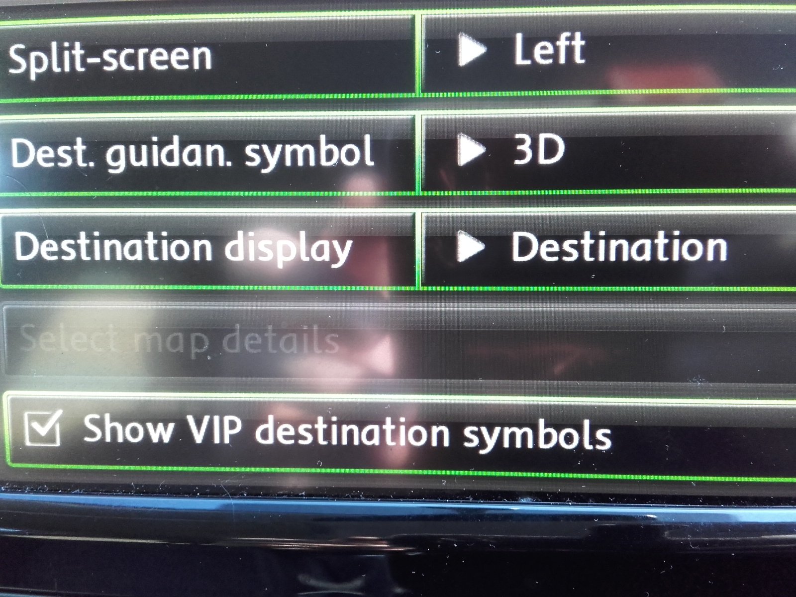

Yes I did what I think you mean . See images . Poi greyed out and map details too.

For what it is worth the software version numbers ( it's a 2014 car. A later mark 2 ).

Press the "Setup" BUTTON, (bottom right hand side)  and then follow the rest of the instructions I gave you.
Thanks for trying to help . Wherever I try to access points of interest including what you have suggested the option is greyed out and pressing it makes no difference.

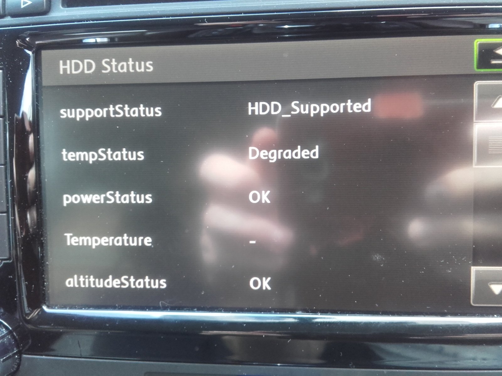

I wonder if a corrupted file as found this as pictured further into the setup "secret " display. ( Hdd status )
Would reloading an appropriate firmware disc ( and then map disc as I hear using the furmware disc is likely to wipe the maps ) solve things by overwriting any corrupted Poi files if that is the issue ?

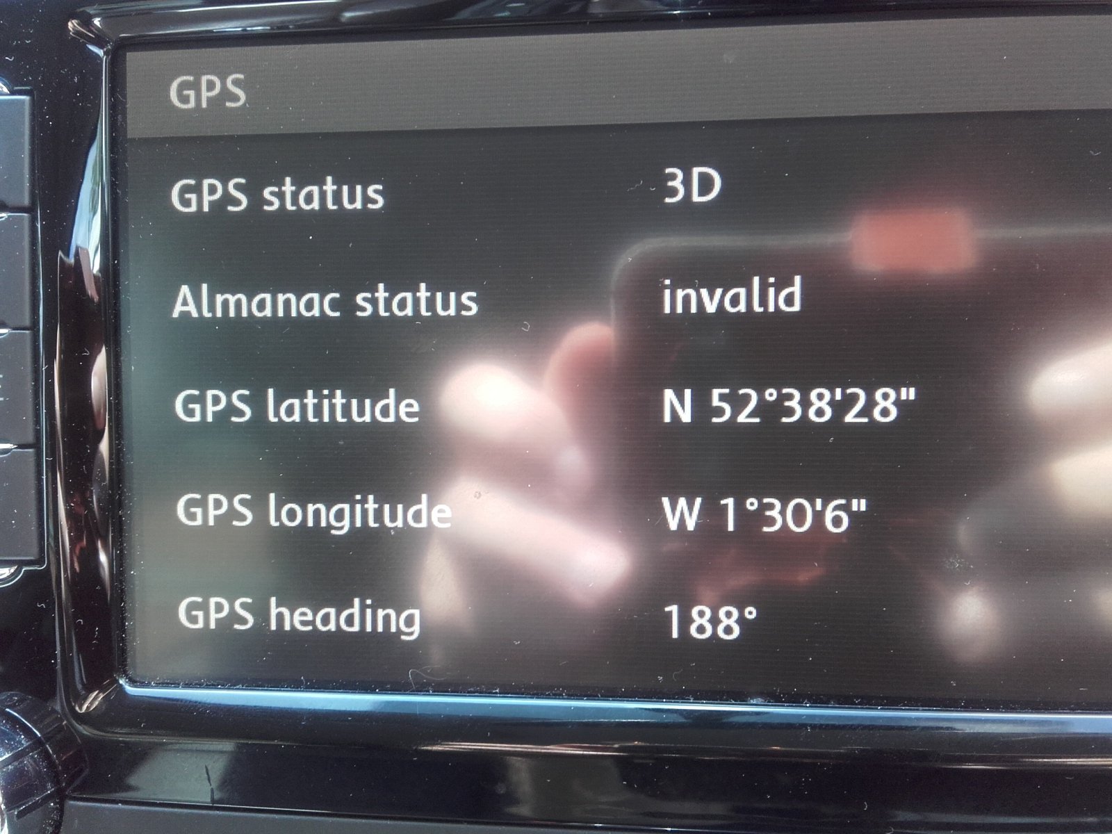

And this "Almanac"whatever that is on the GPS  section showing invalid
Edited by cng
It does rather look like a software issue rather than mapping. The POI are stored on a separate HDD  partition to the maps (& music is also different), so it's also possible the hard drive if failing, but unlikely. Almanac status invalid is unlikely to be related to mapping as that data is stored in flash memory on the mainboard so it's pointing to software.
So on balance of probability updating with discs likely to solve it ? Sat NaV otherwise working ok and music on Hdd etc. It shows that I have 3 partitions on the HDD screens.
I'd say a software reload will sort it unless it's hardware related.
