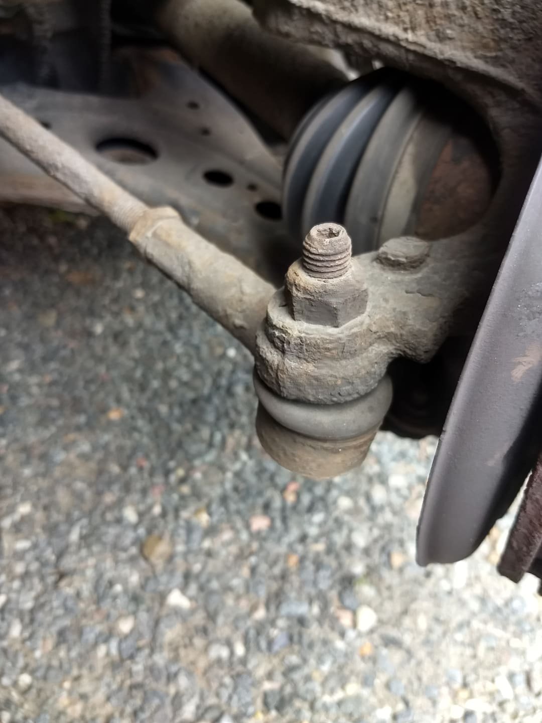

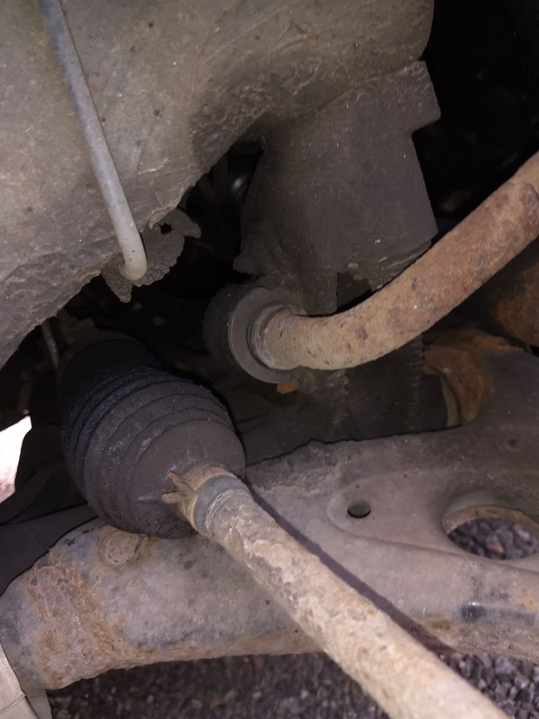

track rod ends - jack it up wheels off and then try pushing the track rod end up and down. If it moves then it’s done and needs replacing.

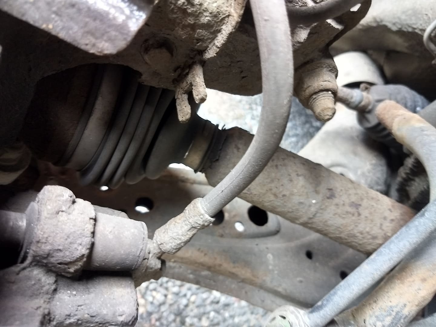

Drop Links - no movement at all, tried to tight them hard couldn't so I guess the issue not there

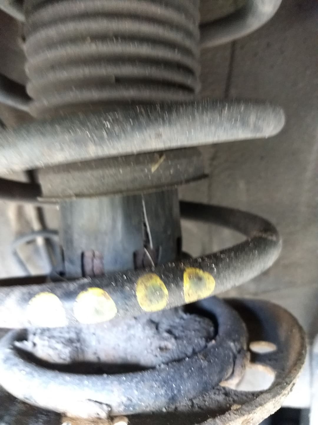

ARB bushes ...donno I have attached photos so maybe you can tell me more, in my opinion, they look decent

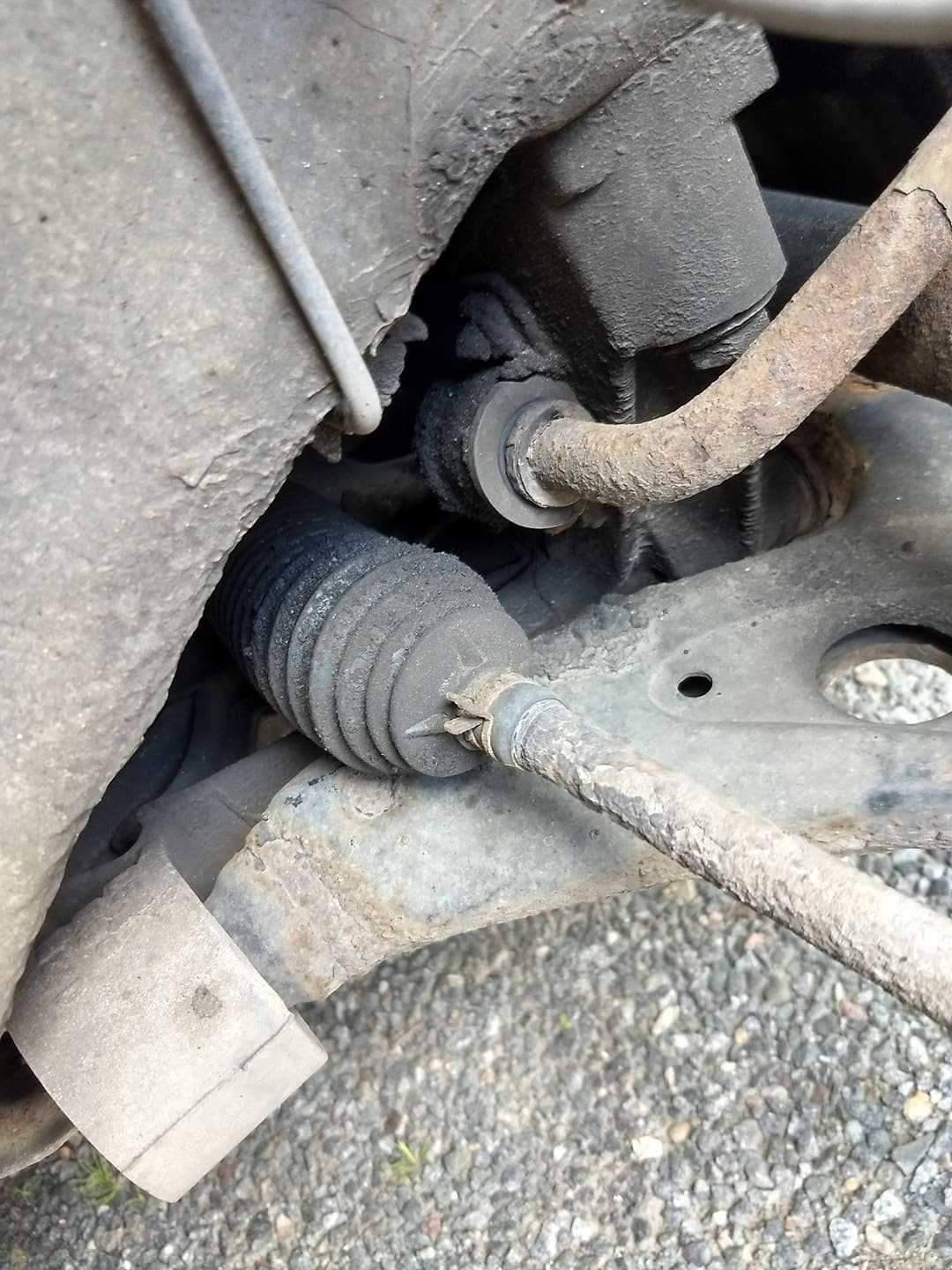

Track rod end  - up and down no movement, they move tho, on a circular trajectory, but I suppose that's how they are supposed to move, they look ****ty tho :)) again photos;

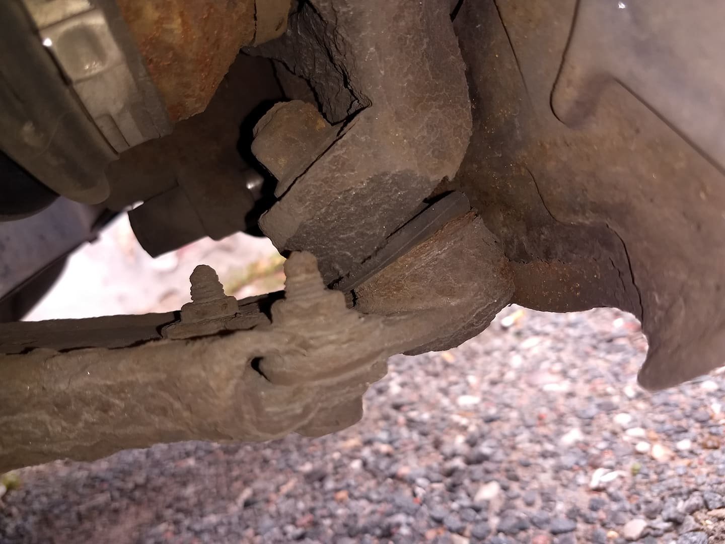

The steering rod (the one with 3 bolts down, did not look very well tho....
on 12 and 6 o'clock hands, no movement when the wheel was up;

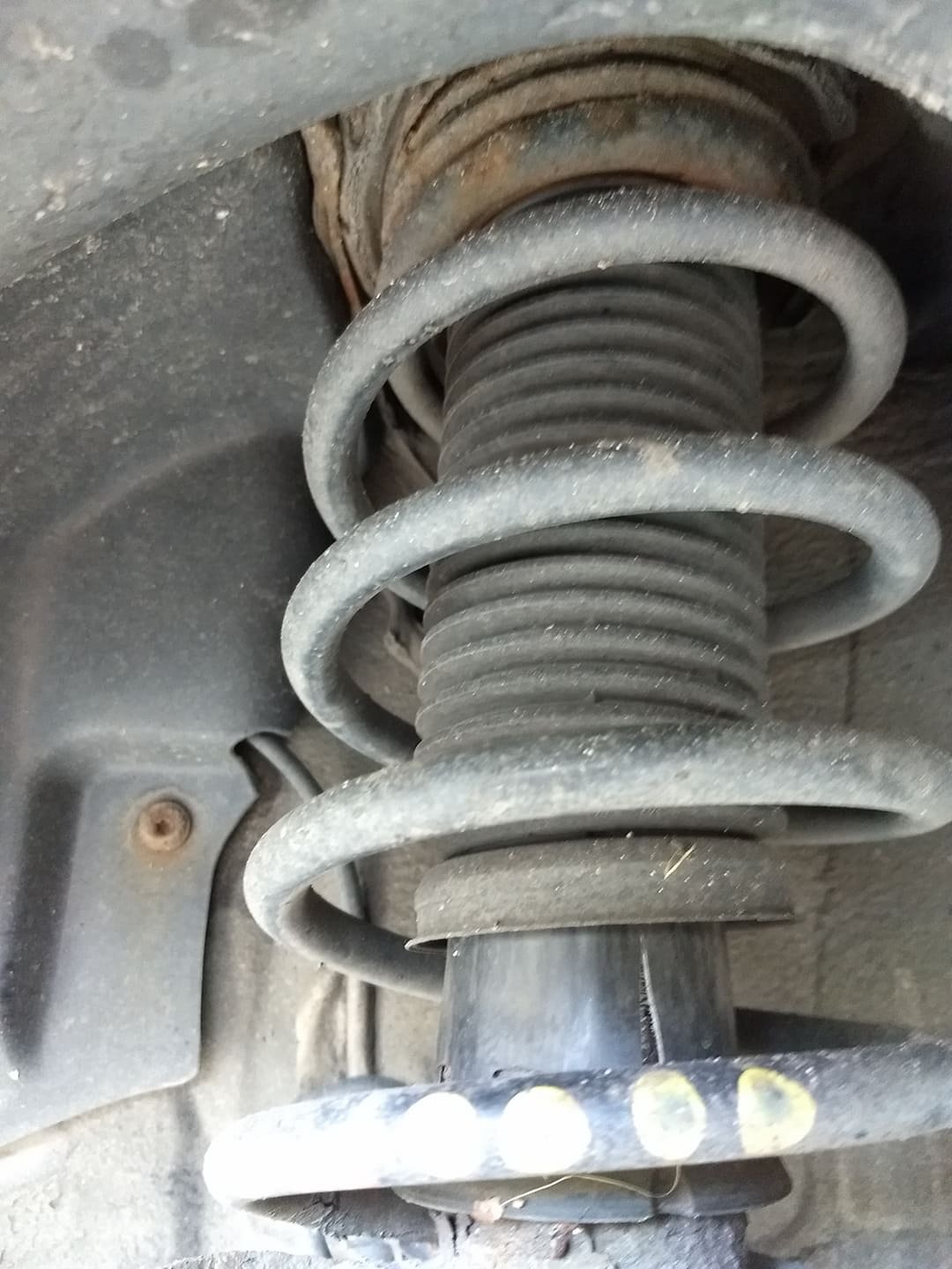

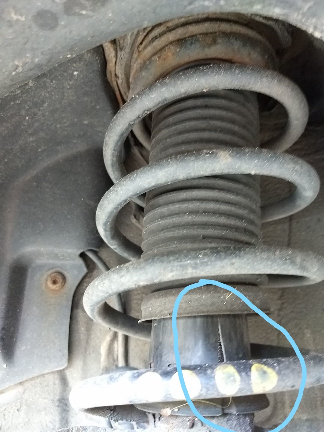

there was a bit of movement, on 9 and 3 o'clock tho, and the weirdest thing that the entire shock absorber was moving as well, very little movement, I initially did not observe that the movement is also in the shock observers, but then I check and rechecked and they were moving slightly as well, also there is a crack on a thing on the shock absorbers, donno if it is bad, under the rubber, it looks fine, no leaks or smth. For the last two weeks (did no rain) could not hear the knock, yesterday rained, started again, so I know it is stupid but it is definitely related to it somehow...
That one? That's the lower ball joint. Also for the most part you will very rarely be able to feel anything in a defective ARB drop link, but they knock like hell.

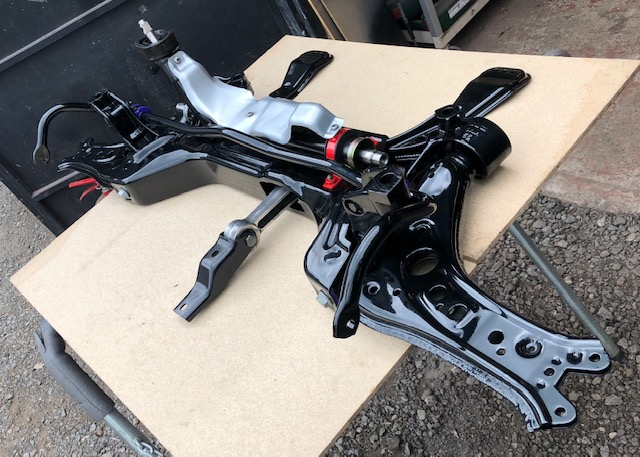

Looks like you could do with a bit of an overhaul, but then I do tend to take things to the extreme when doing mine.
That looks amazing...I wish I would be able one day to do the same to this poor car (being the first car, it is a special connection) but sadly I don't think it will happen 😞

ARB bushes look worn to me, they cost nothing so just replace them.

Do you mean the entire strut has movement? Have you checked the top mount?
Depends how you try to check for that, a well worn/split TCA rear bush will allow the "leg" to move back/forwards - at its lower end.
