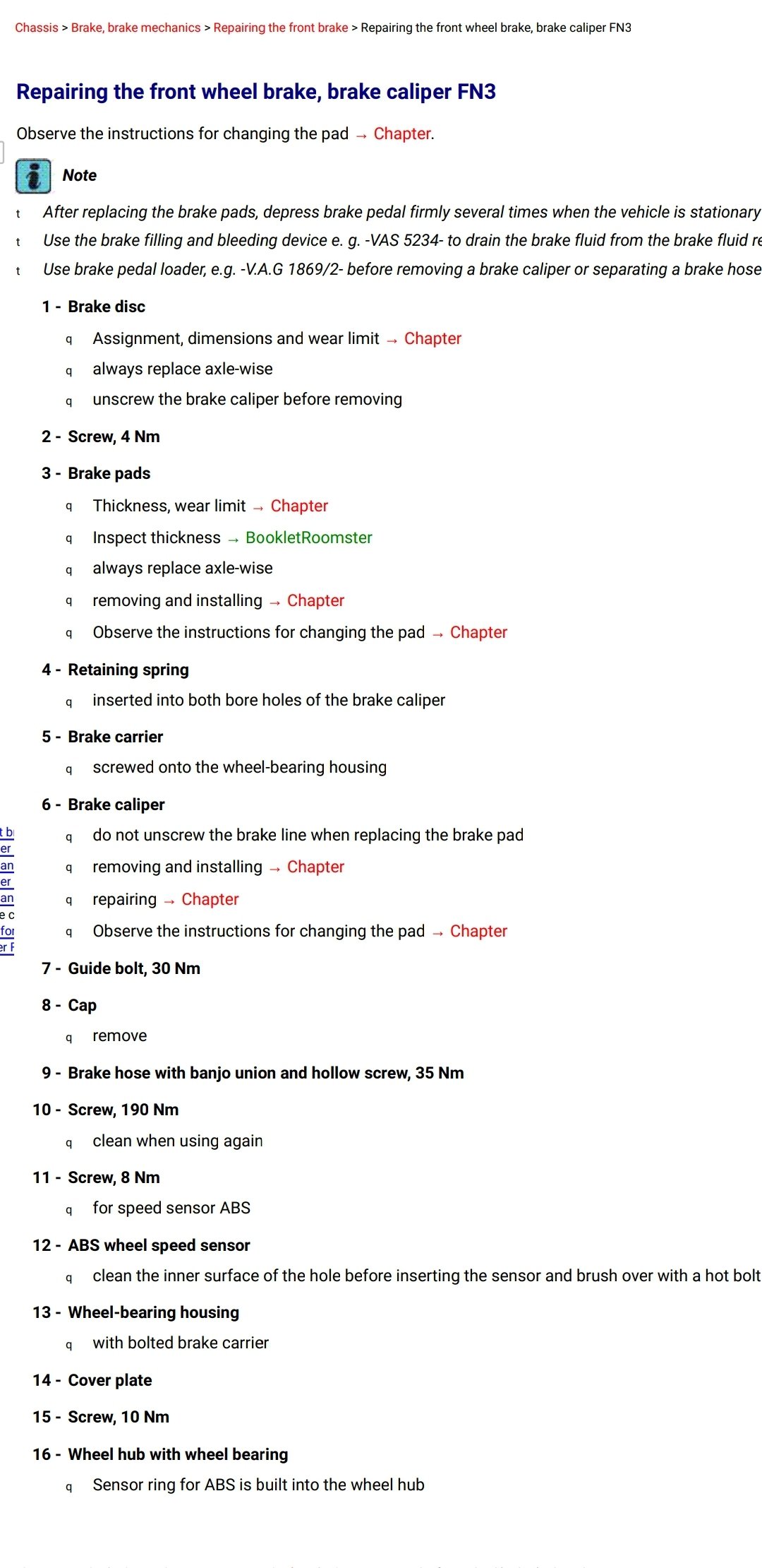

Does anybody know the recommended torque Settings for the two M12 bolts for the front brake carrier. I've looked on the workshop-manuls.com website and they specify 190NM which I think is a bit excessive. I've look at a few posts on this forum and some people are saying Skoda recommend 125NM?

That's strange my one says exactly the same thing apart from number 10. Which says 190NM

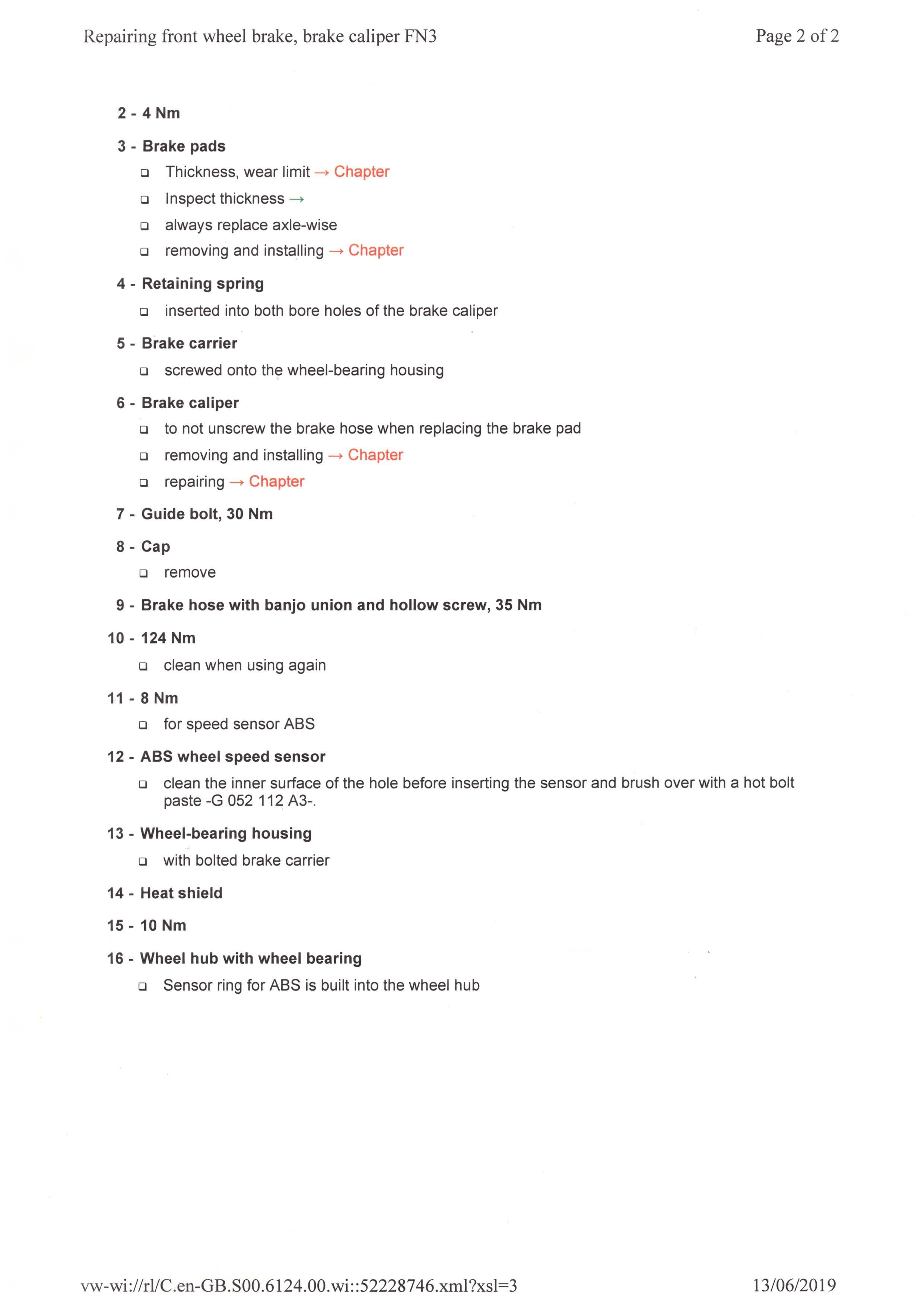

What version of Elsawin ?  Strange thing, if you look at the MK2 Octy with FN3 then it does show 190Nm but all years for the Fabia with FN3 it's 124Nm

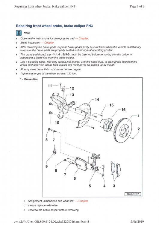

i've checked various sources  including erwin and C54 it is 125nm and FN3 124nm
