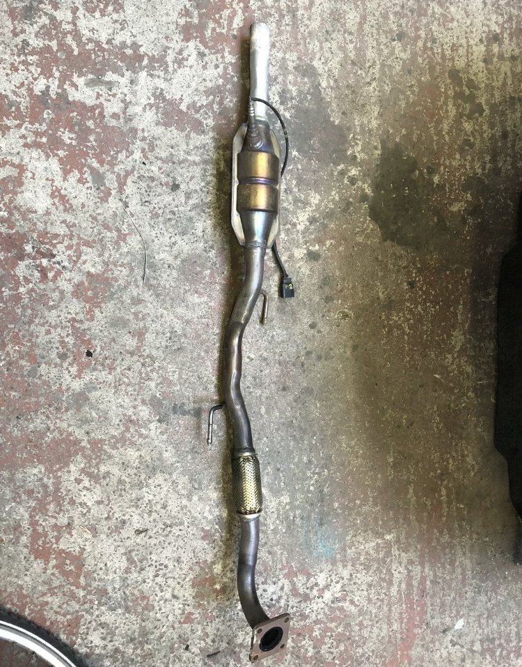

I have a BBZ/BBY downpipe and cat spare. Nearly new with very little use.
Edited by Tech1e
Hi Techie
Many thanks for this - excuse my ignorance but is this a like for like replacement for the OEM part or is it an aftermarket piece (will it need any modification to fit to my standard Fabia? I see your in Worcs, possibly a little far for me to collect, what price would you be looking for please buddy? Thanks
