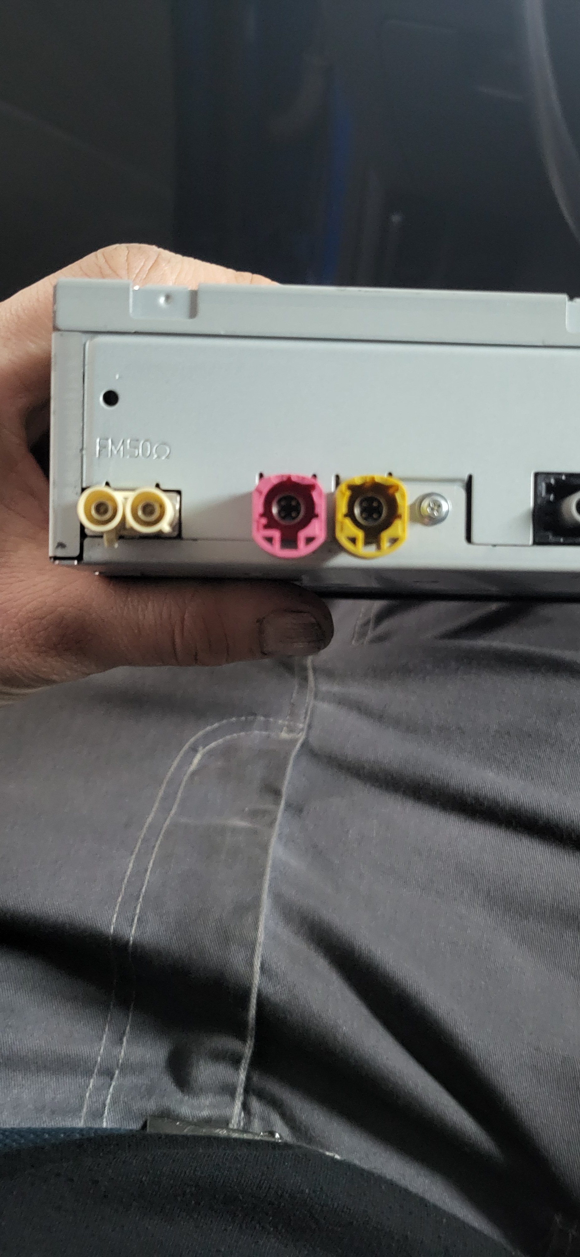

Can you advise me the description of the connectors pink and beige, thank you.
5E0 035 840 A unit
Beige = fm antenna
Yellow = usb cable
Pink = screen

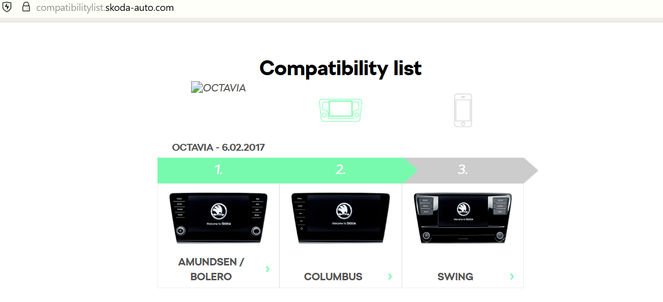

Hi.. I need some help on swapping Swing plus w/ Columbus (picture below). I bought a used Skoda and information about possible Infotainment systems on a MY17 O3 1.6 TDI is as shared. Is it something affordable? How much euros? Can Local (Turkish) Skoda garages help with that? Thx image.png
Hi,the swap is not a straight swap.at the moment you have a display and unit together,if you want to upgrade to colombus or amundsen you need to change the glove box insert to acomodate the new unit,you need a new cable extension and most importantly you will have to deal with component protection and the radio itself can be very expensive,a used unit amundsen coast around 600 euros.plus the insert and work.i would say around 1000 euros for everything.

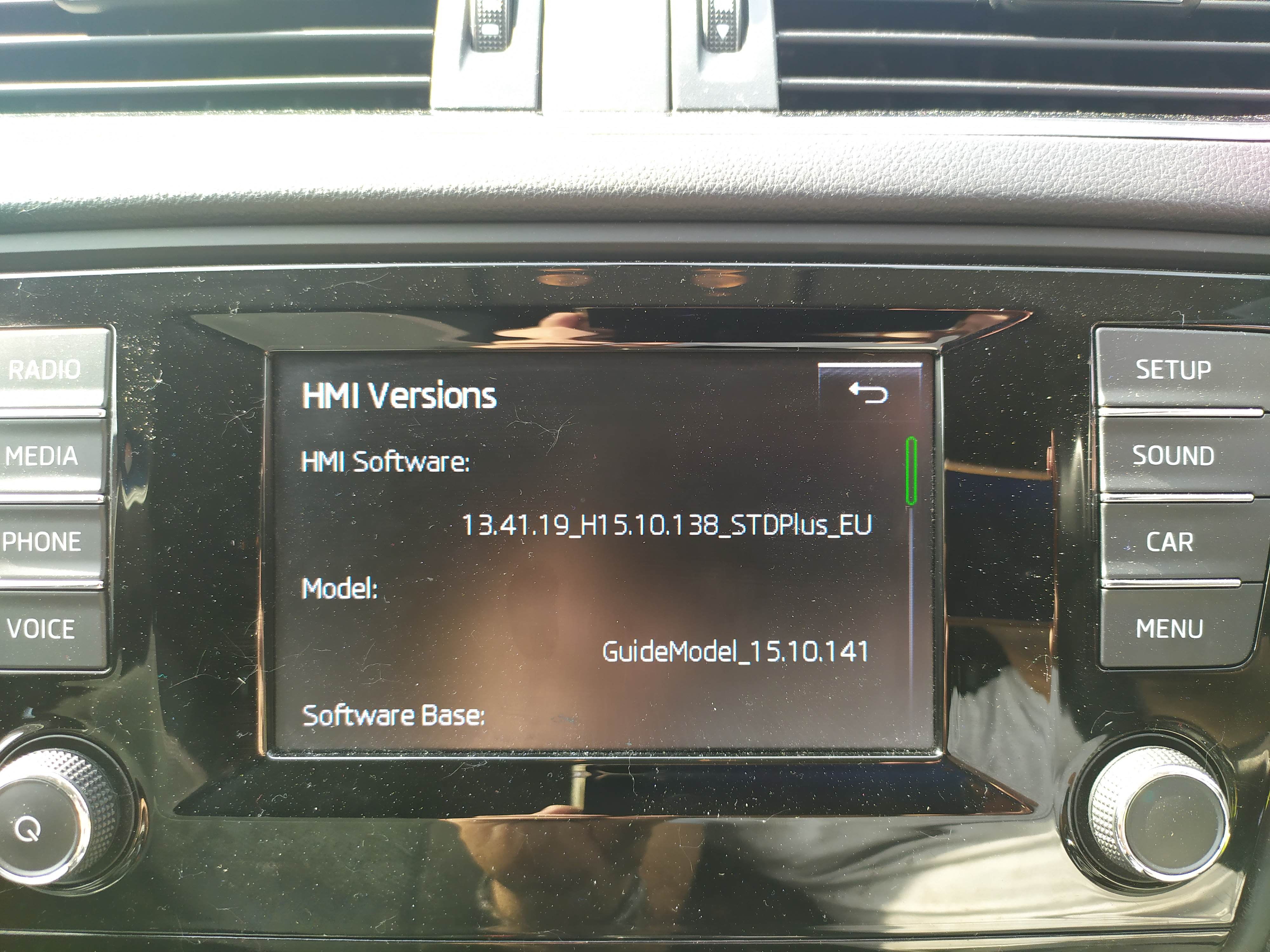

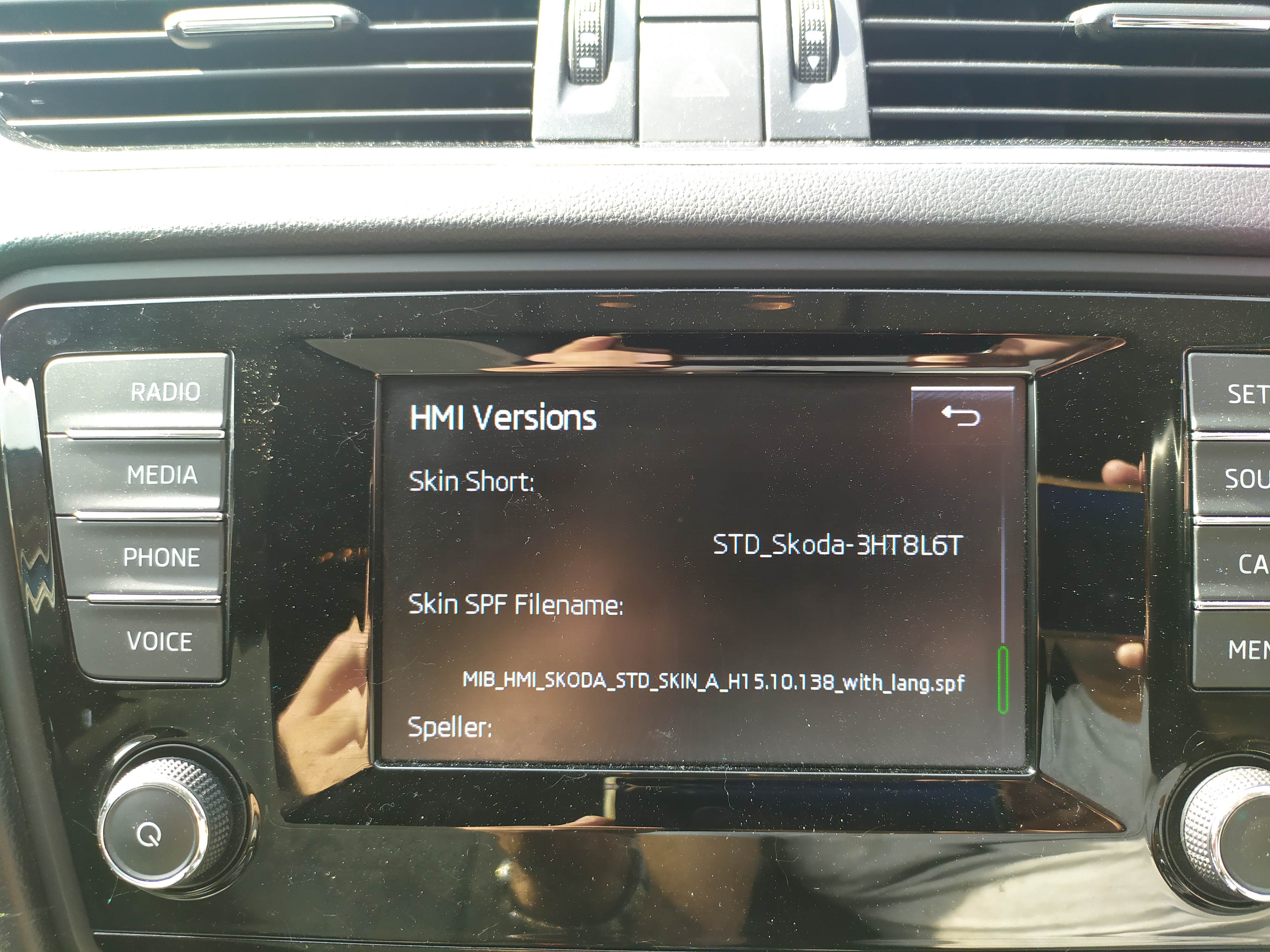

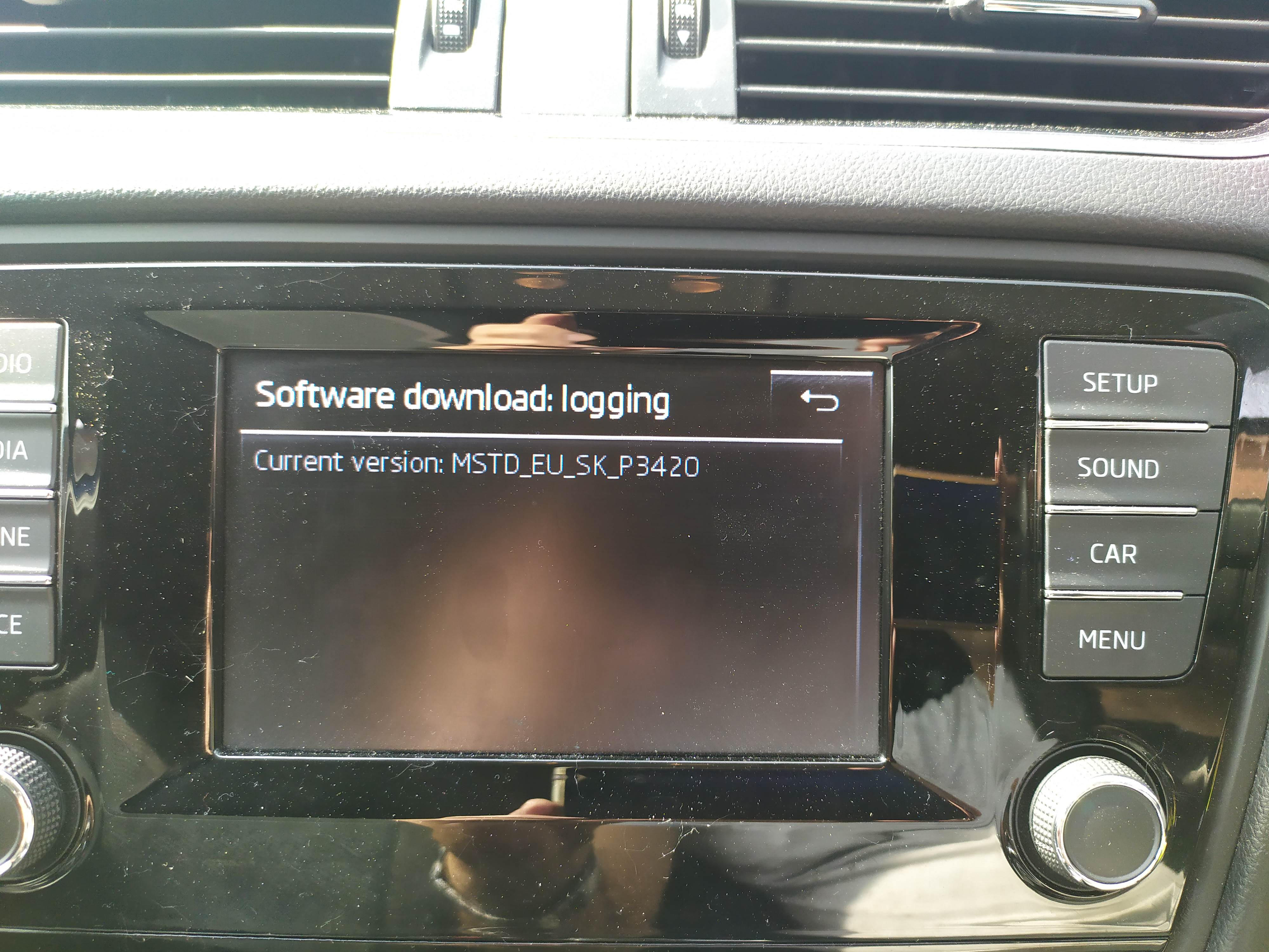

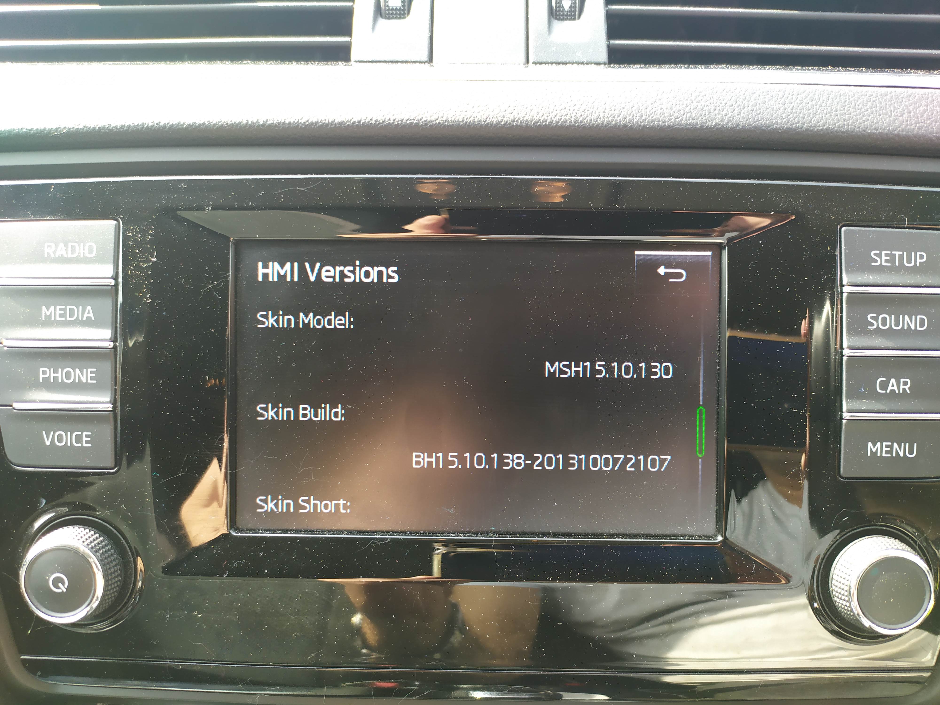

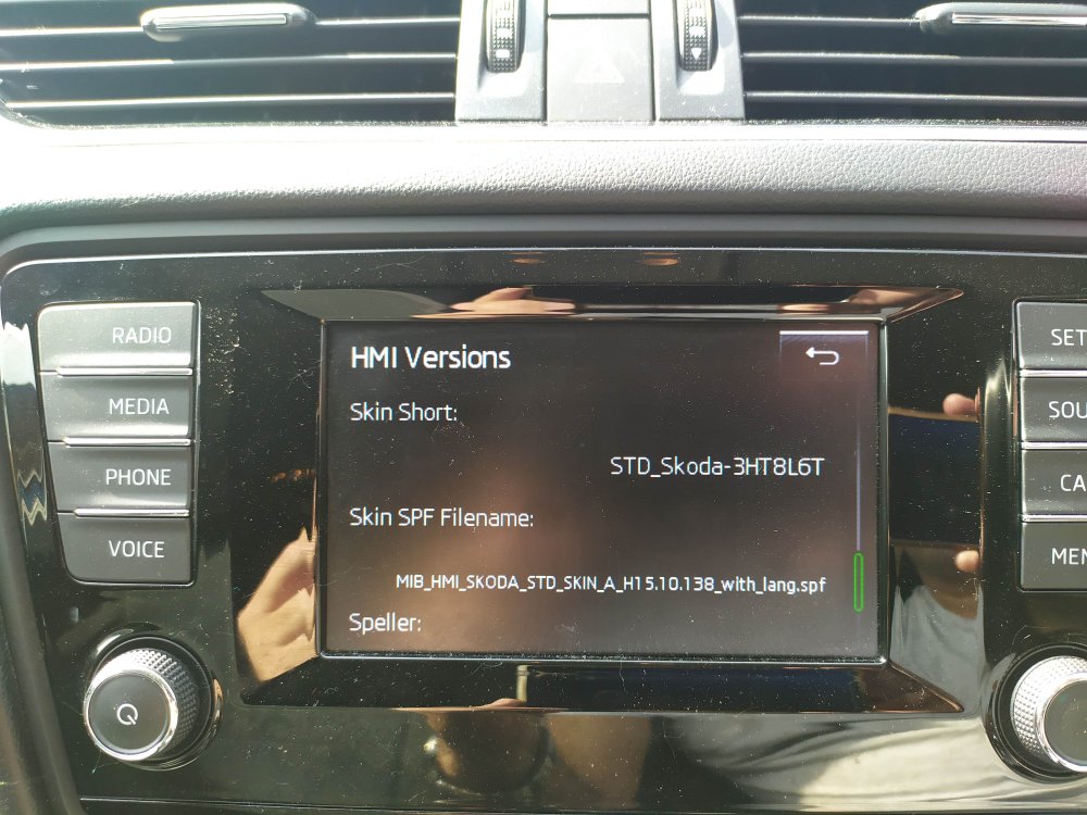

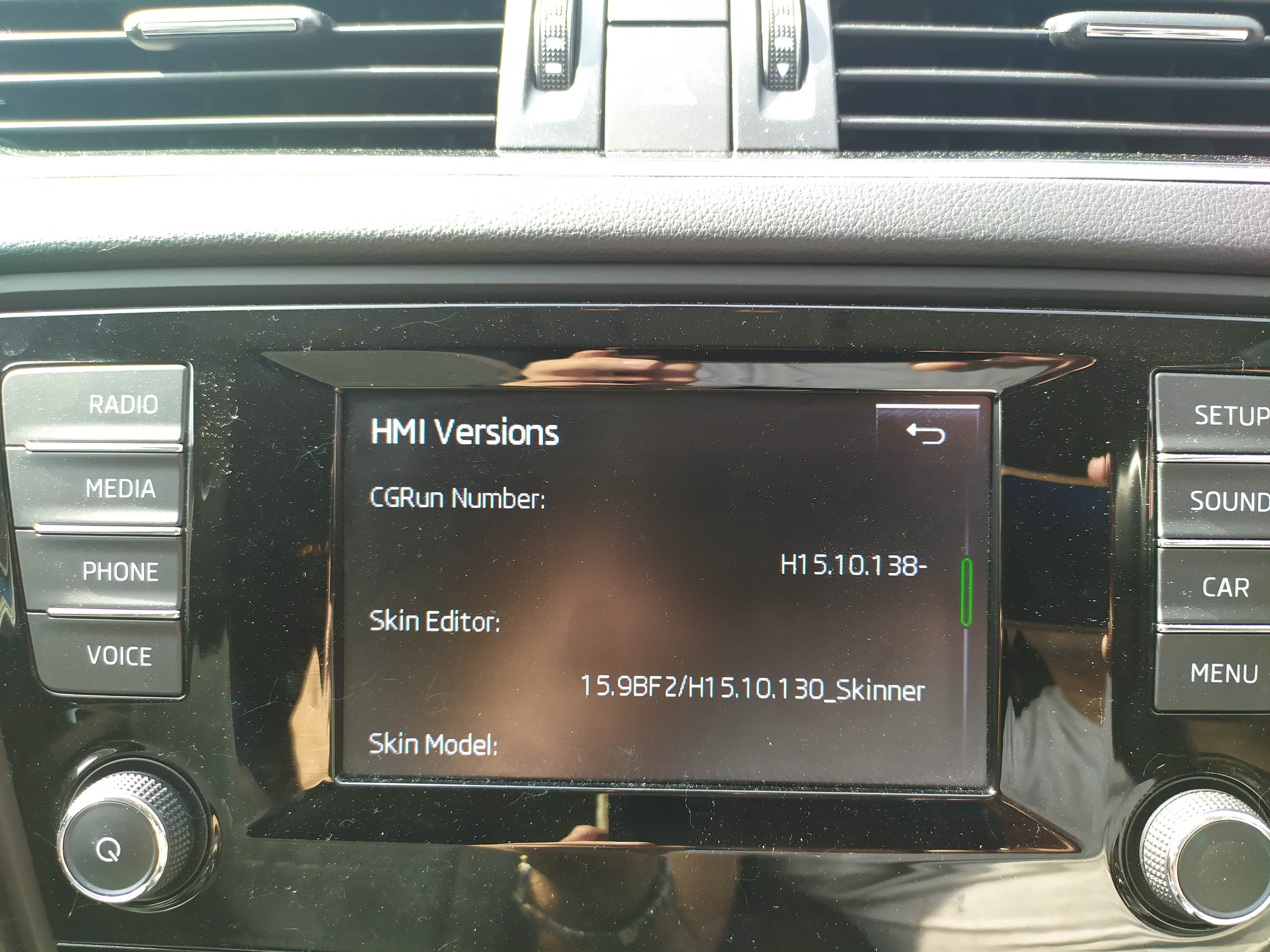

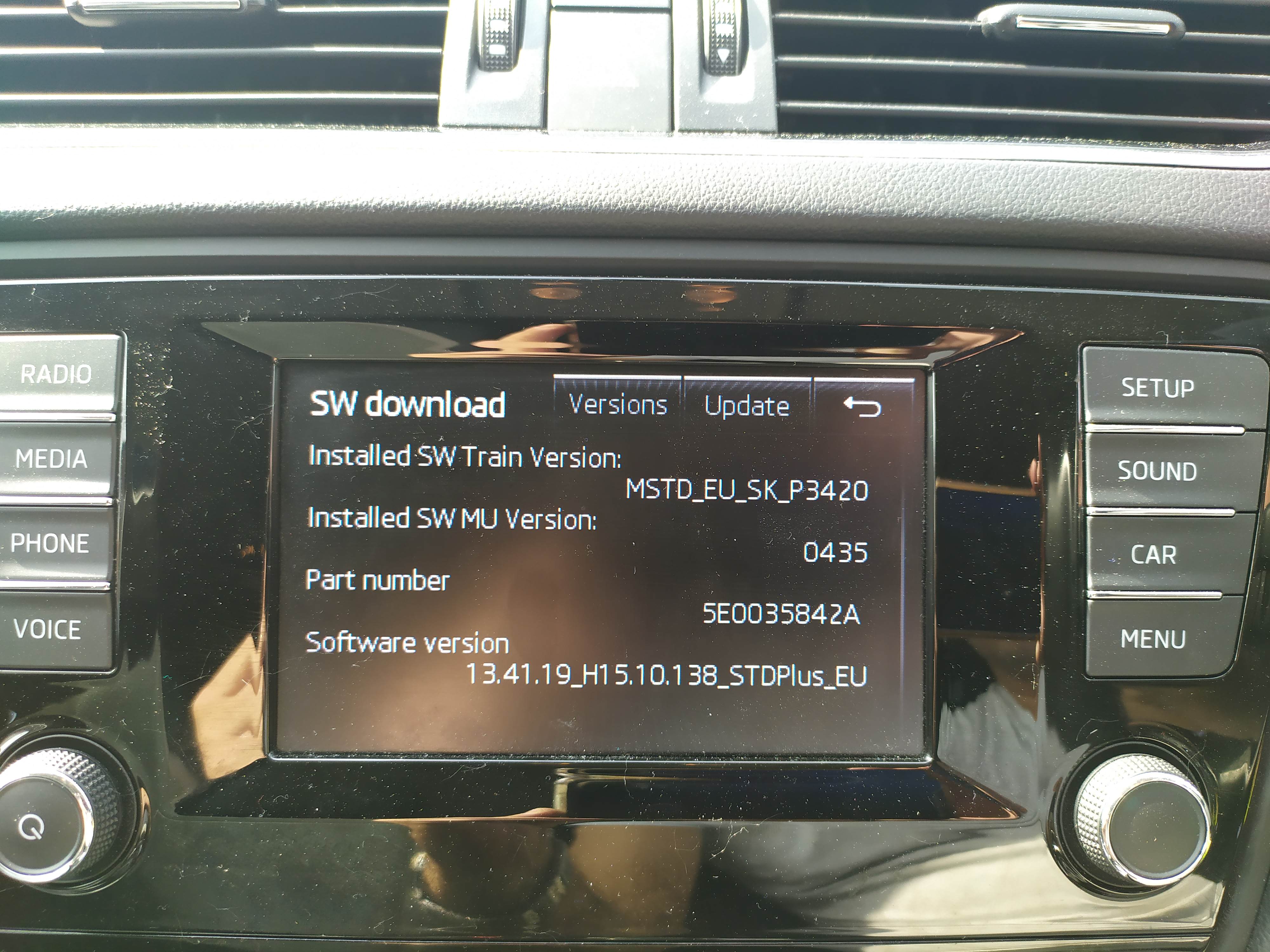

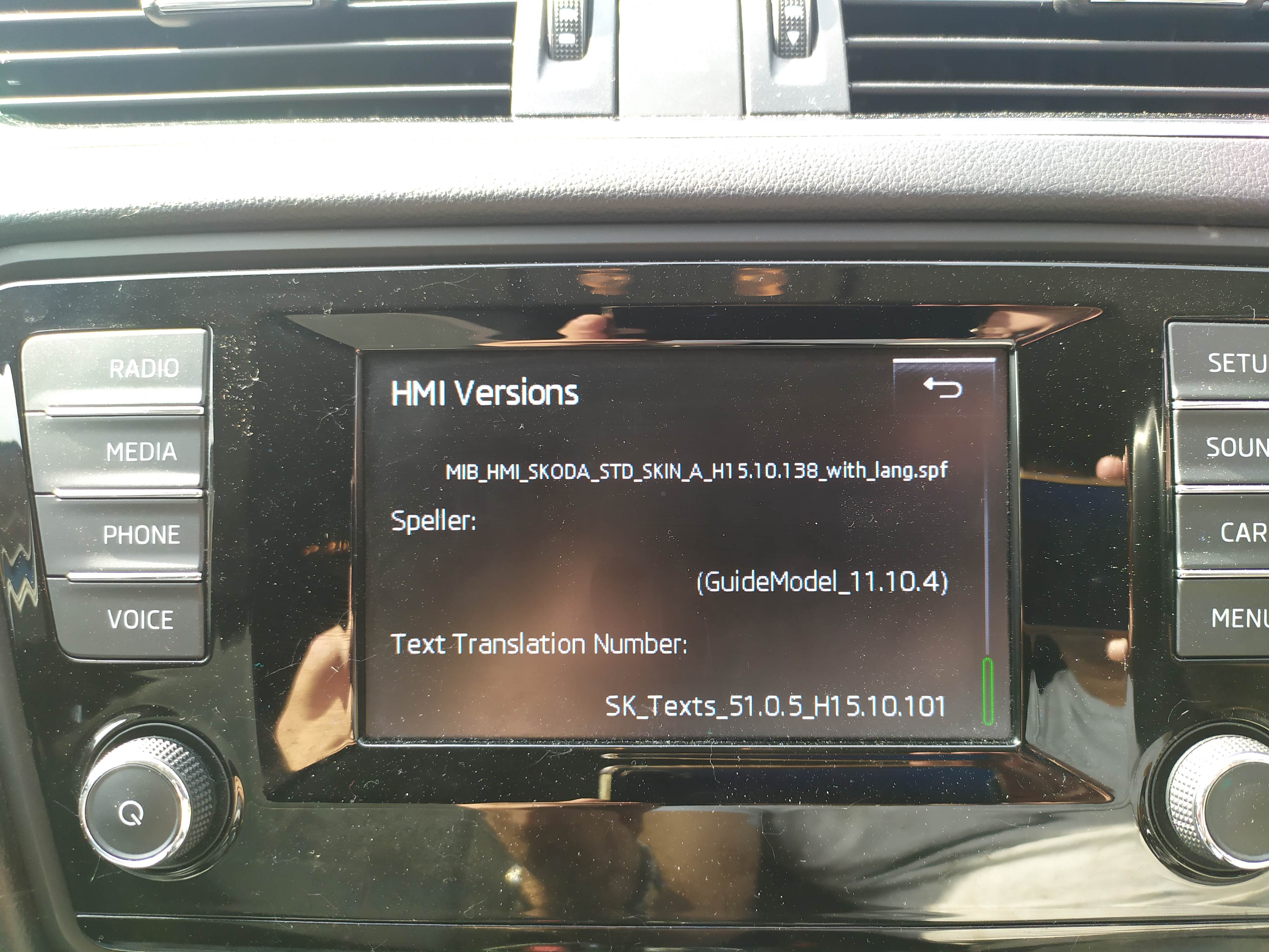

Just curious if you've come across anything for our system. Mine's the same version: Part number 5E0035842A, Software 13.41.19_H15.10.138_STDPlus_EU. Any luck finding updates or info?
