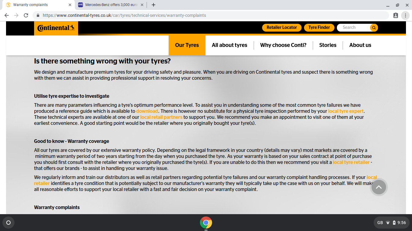

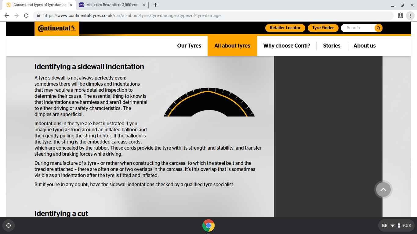

I  cant readily find Continentals Lifetime Warranty and Insurance on tyres.   (Tyres fitted as OEM by Manufacturers.)
They have a Warranty and T&C's

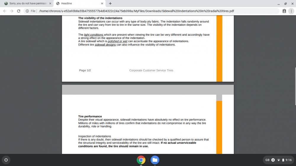

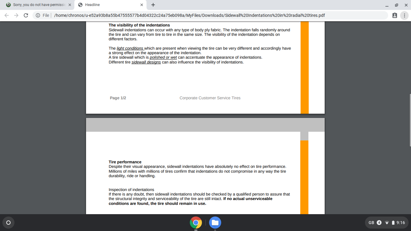

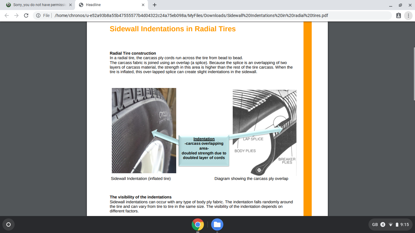

Even greater news.
I just had a reply from Continental which includes a Service Bulletin from September 2010, so I guess I'm not the first person to ask about these dents.
The Bulletin is attached.
My thanks to all who replied to my initial query.
Stewart
Sidewall Indentations in radial tires.pdf

I understand what is said in the bulletin. But not why it causes a dent.😞
@Stewart7
Thanks for that.
Thanks again.But I'm wondering why a dent and not a bulge, as the cord layer is doubled? True obviously, but not instinctive.
Edited by gregoir
Makes perfect sense when you read their explanation, its stronger there so does not expand so much under inflation, I am never concerned about a depression in a tyre, a raised bump, yes that gets removed from service immediately, dont need anybody to look at it or pronounce a diagnosis.
Thanks JR- makes sense now.😀
Try think of a bike inner tube.  Once you put the puncture patch on it does not expand in that area at the same rate so is constricted, smaller diameter.
