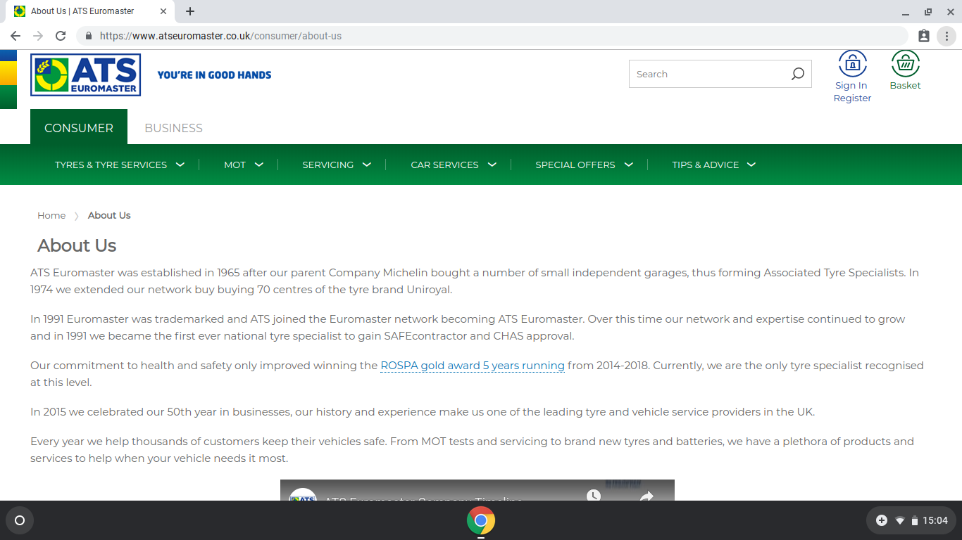

@micro
Did your mate tell you that Michelin own ATS Euromaster, and Blackcircles?
I get my tyres fitted at ATS Euromaster, sometimes i buy at Blackcircles and have them delivered to ATS Euromaster,
as i do with my CrossClimate as cheaper at BlackCircle than the computer / staff at ATS Euromaster can give me.

7 minutes ago, Roottootemoot said:
@micro
No I never knew that! I wonder if that has anything to do with it 😆
