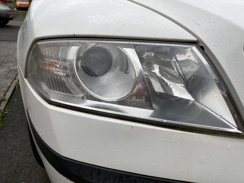

I've just upgraded my headlights to HID xenon
I've just upgraded my headlights in my facelift octavia,
Honestly it's amazing, took about 20 minutes and as the octavia facelift uses projector lenses the Zenon lights don't need any adjusting, and as far as i can tell won't get you pulled over as they look original.
The balasts actually fit snugly into the headlamps themselves and no movement, also the original rubber cap still fits on.
I did however have to cut the small metal clips the slot the cable into and allowed me to use the original mounting, they are however still sturdy enough for me not to worry.
Also a plus side this kit cost me £26 where as 2, 150% bulbs from halfords would've come to £32
I can add pictures here but I can't see anyone being too intrested I just thought i'd add my comments for anyone looking into doing it themselves and if anyone needs any help I can try my best.
