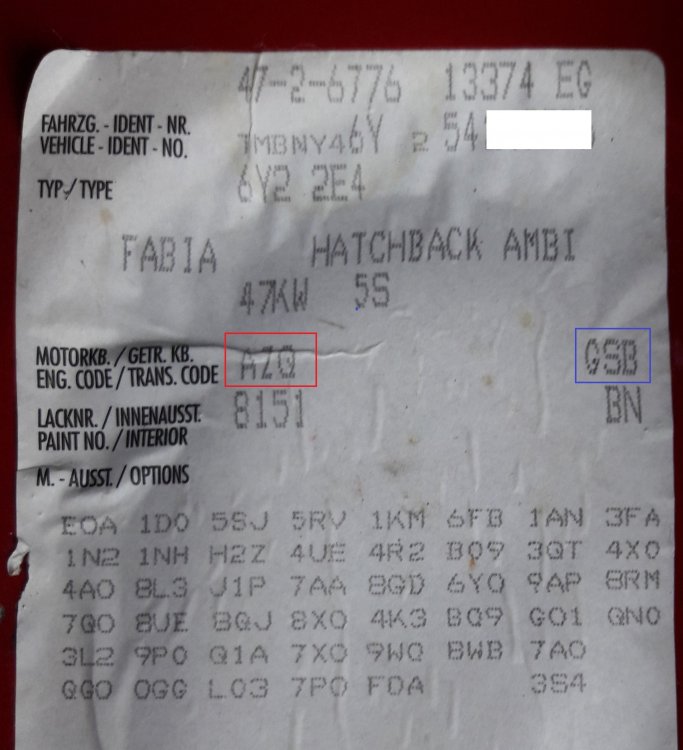

Need to know the gearbox code. Look at the build data sticker in the boot, or service book. Gearbox code is shown in the blue box in this example:
Will check and get back to you 🙂

Gearbox Code is "GDR"
  • Sponsor
Then it's one of the boxes covered by item 6 here, an 02T type, capacity 2 litres, with oil being item 6A part number G 060726A2.  RRP is only a touch over £10 a litre inc VAT for genuine, I got some from here last time I needed it, £20 delivered, for 2 litres. https://www.audipartsdirect.co.uk/product/genuine-audi-manual-gearbox-oil-1l-g060726a2-g060726a2
